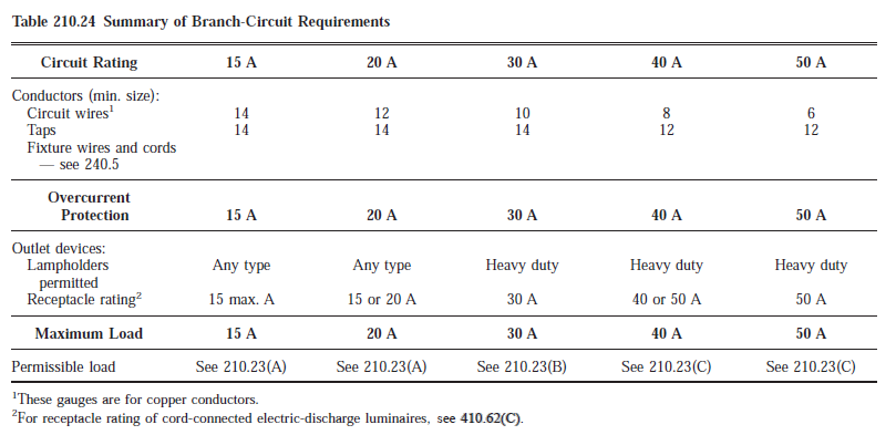

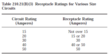

                    In my travels, I've only ever seen 15A breakers feeding residential branch circuits. Of course I'm not an electrician. Copied from Mike Holt's forums:
                    Use of multiple 15 amp receptacles on a 20 amp circuit is permitted. A duplex receptacle is considered as multiple receptacles and is therefore permissible to use as the single, or one of several, multiple type receptacles on the circuit.
                    Receptacles rated higher than the circuit rating may not be used, so 20 amp receptacles are not permitted on a 15 amp circuit.
                    http://www.lowellmfg.com/tinymce/jsc...owellPlugs.pdf
                    For your GFCI tripping on the bathroom fan, the GFCI output is a dedicated hot+neutral going out to loads. I would say the fan is getting hot or neutral from another circuit, in other words not fed exclusively by the GFCI and so it trips but the fan keeps running.

                        For the GFCI, yes, that's what I meant by it not being wired properly. I don't know the official word, I just call it daisy chaining them. I believe you gotta do it on the line side. When one trips, it should kill power to all the devices.
                        This isn't the reason the GFCI needs to be replaced though. There's something physically wrong with it, according to the inspector, and per his recommendations, we're going to replace it. I'm going to go for the 20-amp GFCI outlets though. I went down the panels and I have two 15-amp breakers. The majority of them are 20-amp, but there's one 60-amp and maybe a 25-amp.
                        According to what you posted, it says a 20-amp receptacle is not permitted for us on a 15-amp circuit. Is that referring to the NEC? If not, who's not permitting it? If it is the NEC, remember, there's different rules for commercial and residential. That's not to say that what you wrote isn't true, I just wanted to make sure that was for residential and not commercial.
                        Also, I think it's a horrible idea to upsize a breaker, without making sure the wire for the circuit can handle the higher amperage. I think that's how people start fires. The breaker is tripping for a reason. Something isn't right. Find the issue and fix it, you know? Kinda like my friends car. Radio kept on blowing a fuse so he put a 50-amp fuse in there. It started smoking and the stereo broke. Maybe if we wasn't there, it would have caught fire? I dunno.

                                      I find NEC Article 210 Branch Circuits is saying "no" to a 20A receptacle on a 15A circuit. I don't see clauses differentiating residential or commercial buildings.
                                      NEC maximum load on a circuit is 80% of the receptacle rating/circuit rating. So this would not be met. It's probably to prevent nuisance trips when running a 20A load, which a 20A receptacle invites on a 15A circuit.
                                      There's no hazard with a 15A breaker as the limiting factor- it's just drama I think the standard is trying to avoid?
                                      Note you can put a 15A (duplex) receptacle on a 20A circuit, and 50A receptacle on a 40A circuit.
