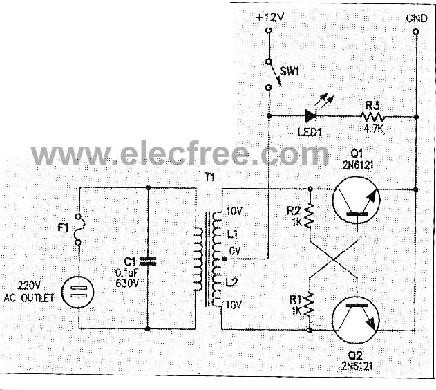

      1 or 2 18650
      CCFL on a 9 Volt battery at 600 Volt output. Schematic diagram in description
      https://www.youtube.com/watch?v=D_vSAP3nJcU
      PS: Look this guy I don't think that potentiometer will last.
      How to build a power supply to test LED strip for LED TV. Home made device. All brand.
      https://www.youtube.com/watch?v=KxIwwXKmQP8

        Re: Poorman's LED TV Backlight Tester.
        O_o Not isolated from mains...... bad idea (but dirty cheap though).

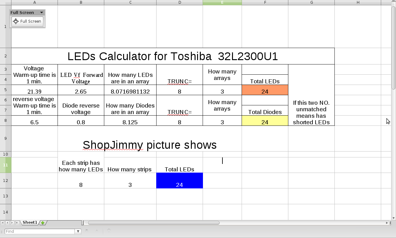

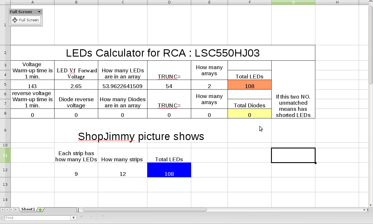

          dirty cheap ( muchísimas gracias, at that time my budget is $5), precise, and accurate..........I'm using it....everyday...For 3 months it never shocks me..... before..Yes, twice.......
          EX: I test RCA LED55C55R120Q TV, I got 143v (pic3,4. Look at pic3 backlight is on). I know TV has 108 LEDs by pic5 ( This leds have no diodes protectors)
          You can count the LEDs over here:
          http://assets.shopjimmy.com/media/ca...8409b1-top.jpg................................
              Thank you , One question : Look the #24 pic3 LED testing voltage is 143.0 v, and pic4 is at 142.8 v.
              Because of constant current source, so R=V / I means LEDS changing it resistance (went down) by the heat? Is this proved LEDs are non-linear and non-Ohmic loads?
                    Vf of semiconductor is affect by temperature.
                    One application is using diode as temp. sensor.
