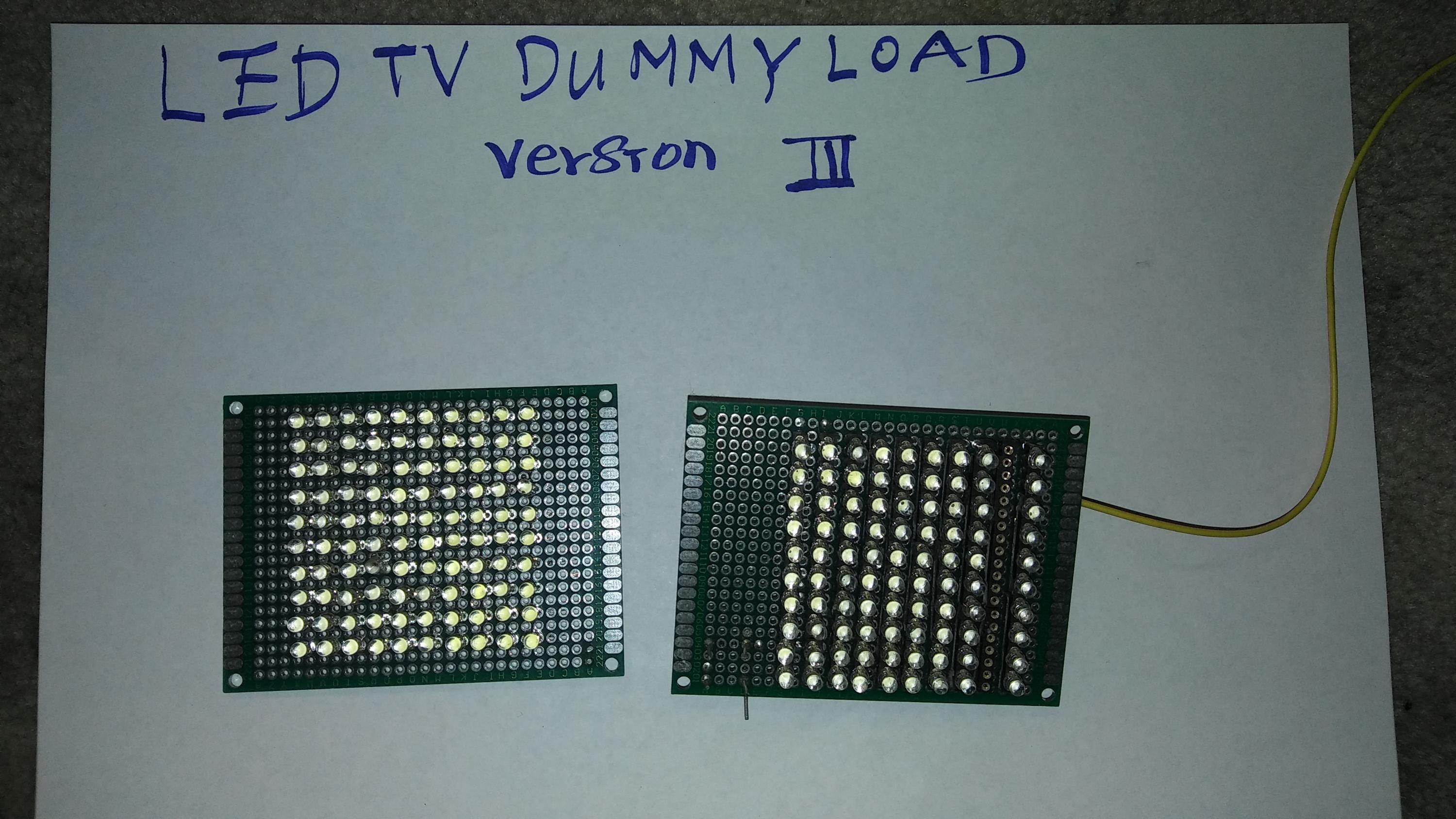

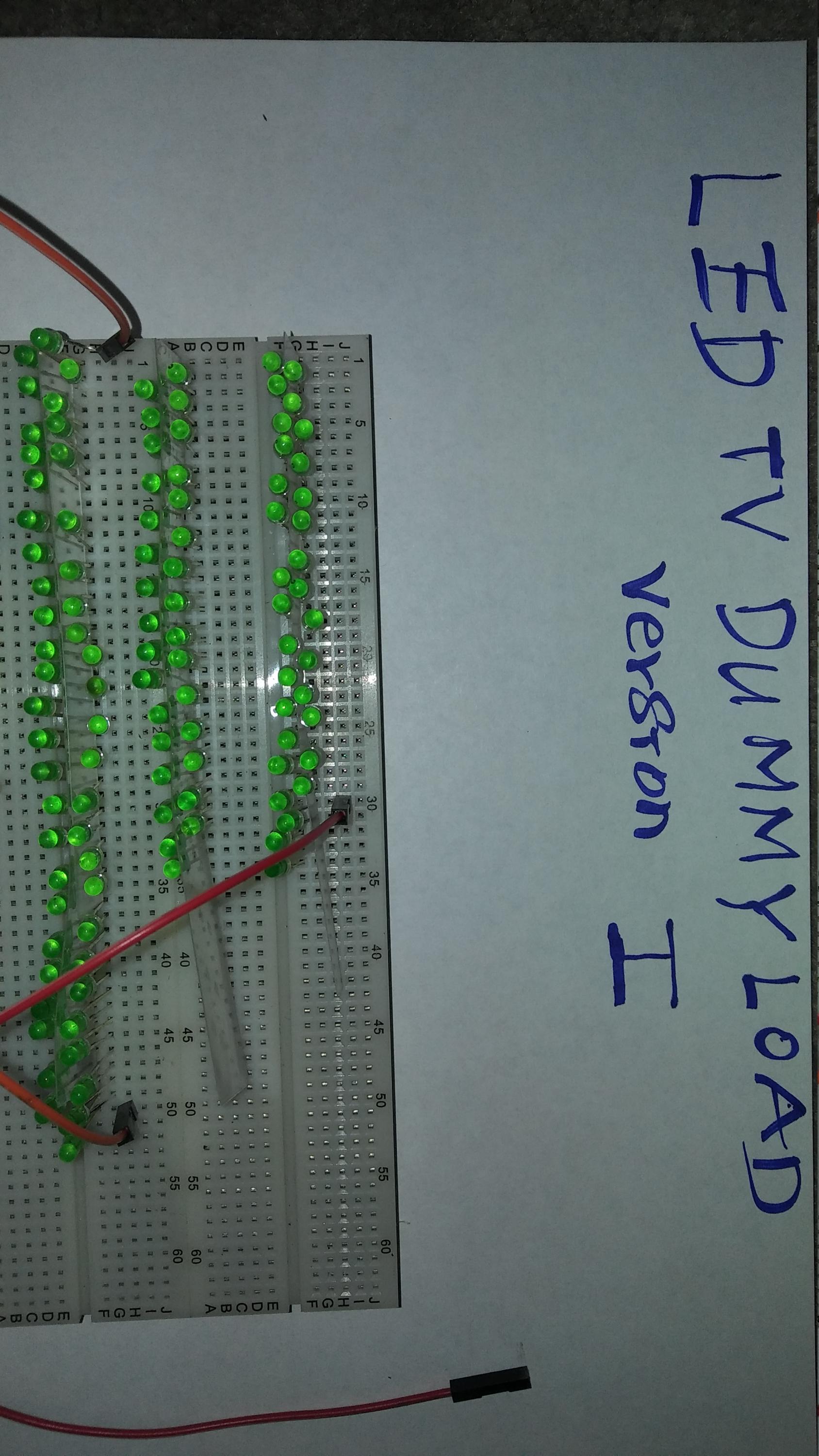

      TV LED screen dummy load version I : This is work OK, but customer will think you still in school.

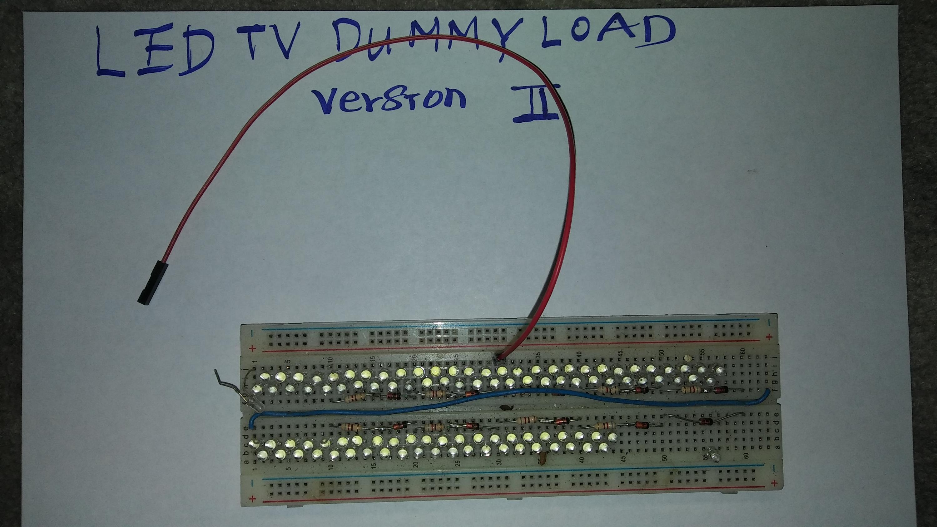

      TV LED screen dummy load version Il : add some protection.
      TV LED screen dummy load version Il: 10 x10 =100 leds, some TV have 8 strips, I need 8 of them.

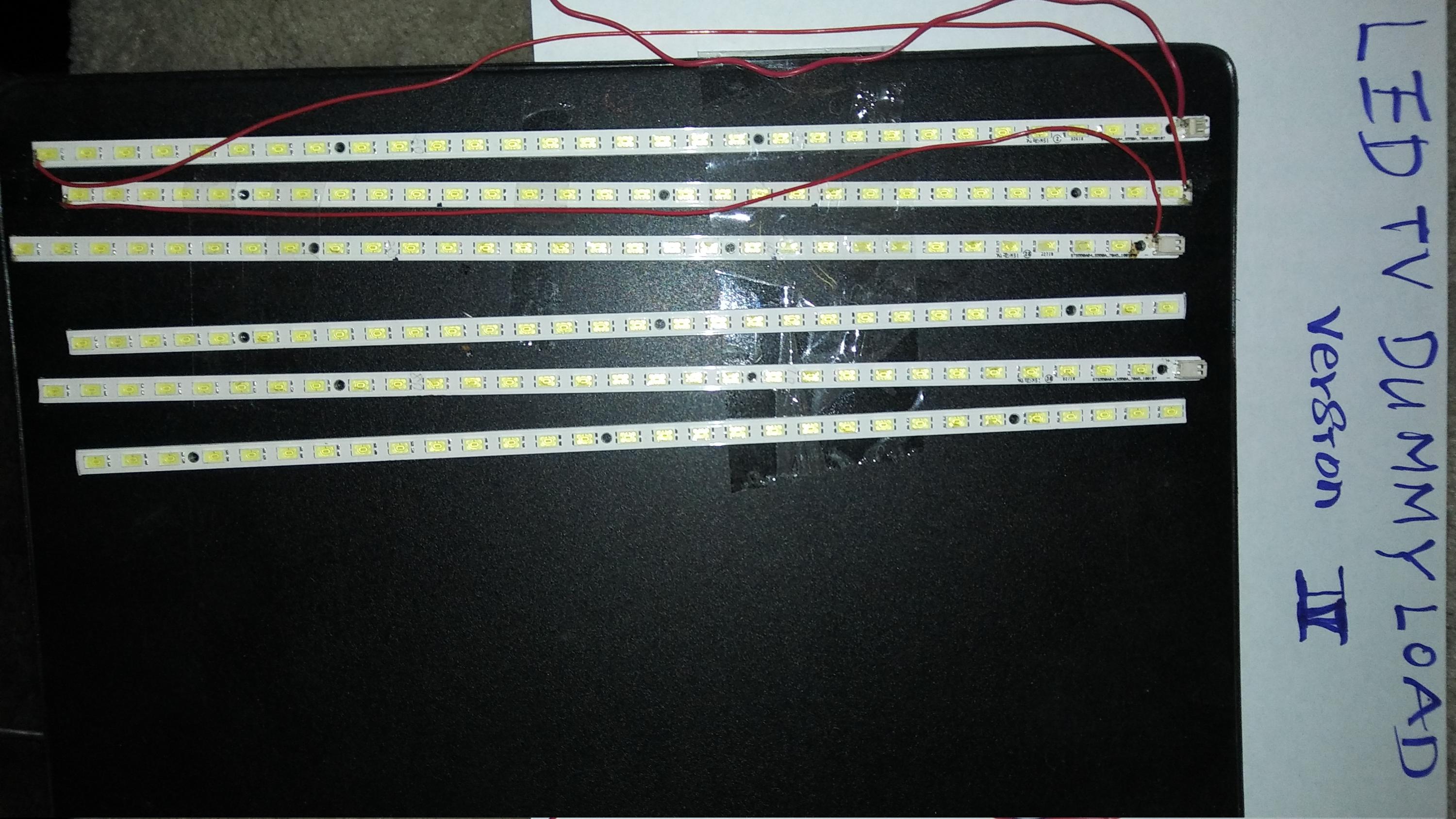

      TV LED screen dummy load version Iv: use Edge tv strips but is hard to solder
      Best way to do it probably have customer made PCB . (last two pic)

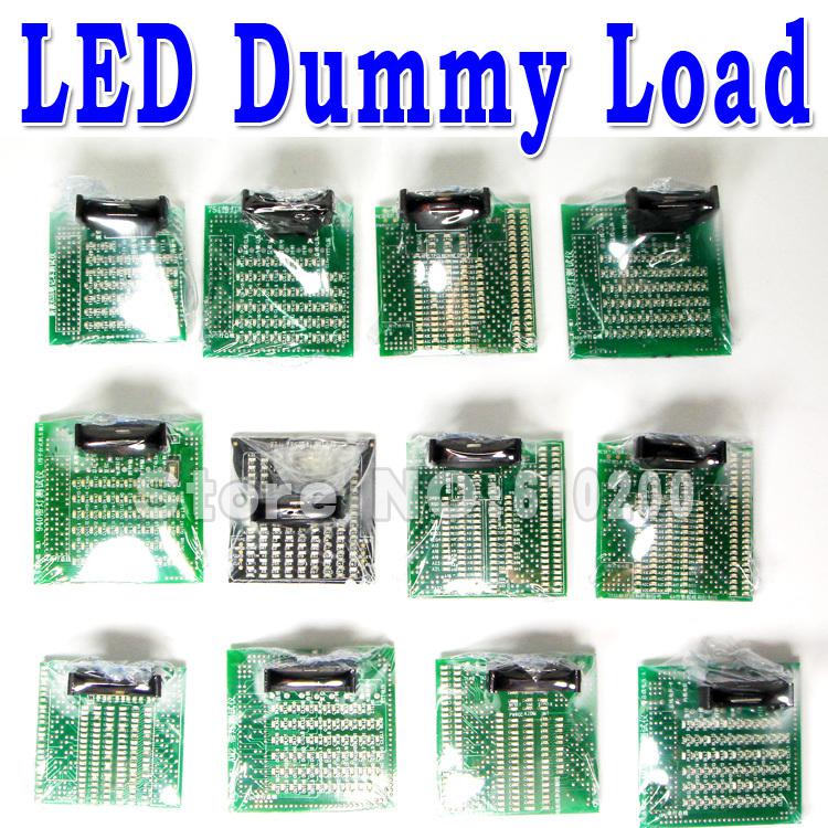

          Maybe modified form this. cheap. Pic 1
          https://www.aliexpress.com/item/SMD-...999.414.kjp8Qb

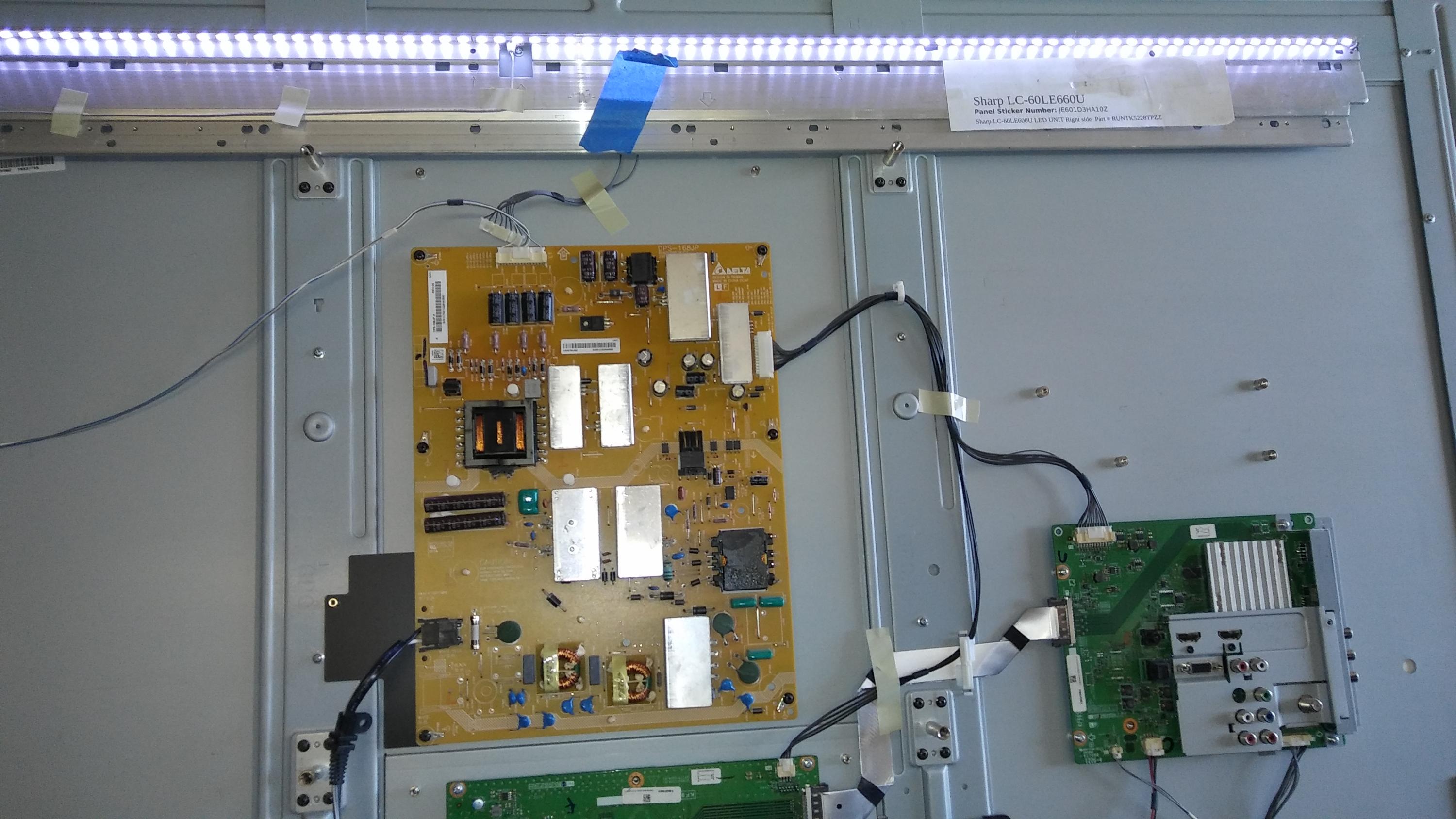

              Must-have Sharp LG Vizio edge led tv dummy load.
              I need to make 100% sure Sharp LC60LE660U TV problem is caused by edge LEDs .
              The easy way is to use the same one as a tester.
              What happened to test different size TV, I will need universal LED dummy load!
              Sharp LC-52C6400U LC-52LE640U LC-60C6400U LC-60LE640U LC-70C6400U LC-70LE640U LC-80LE633U

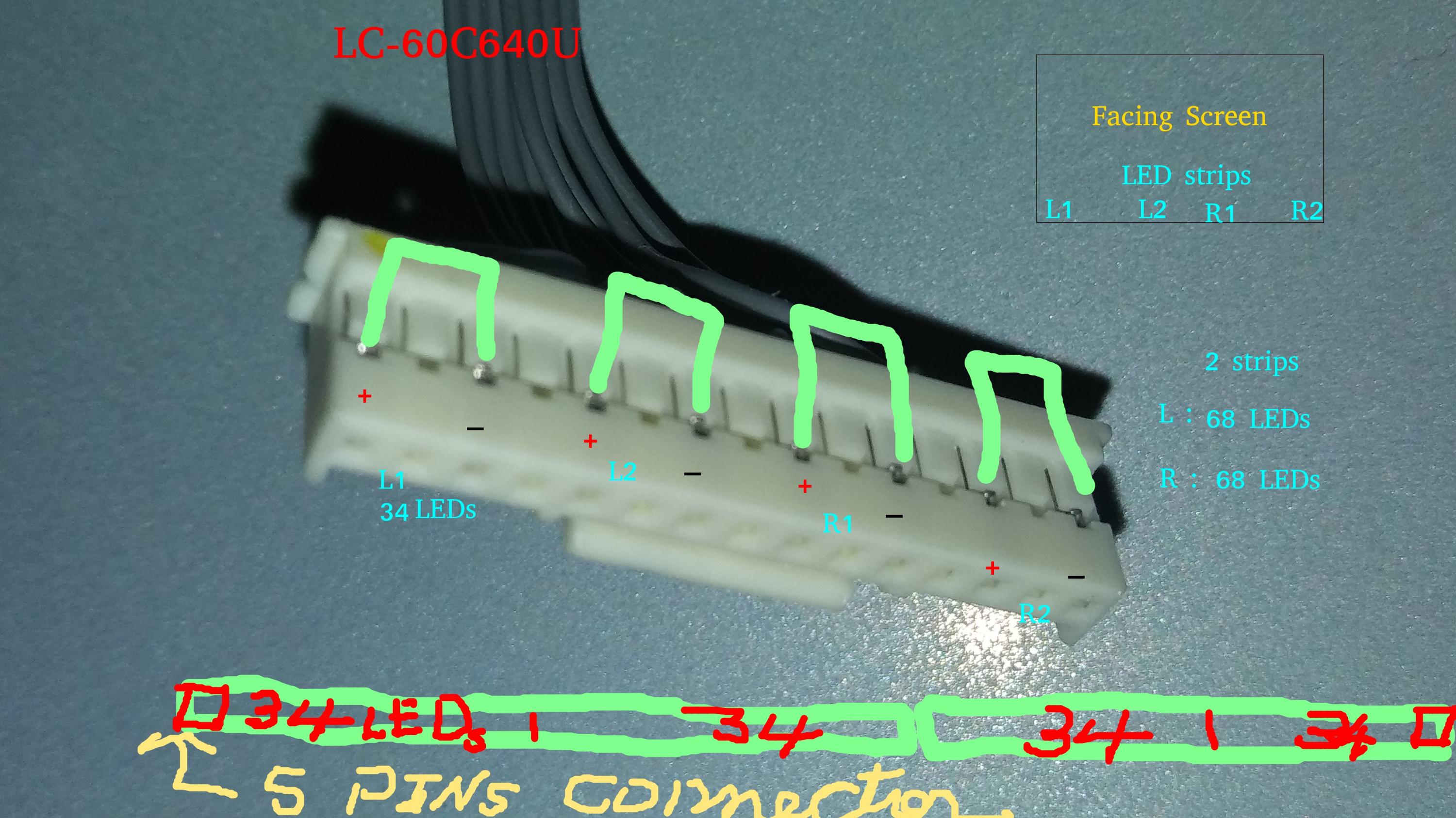

              at picture 2: the tester got hot in second will needs heat-sink like pic 3 (too long to carry around.)

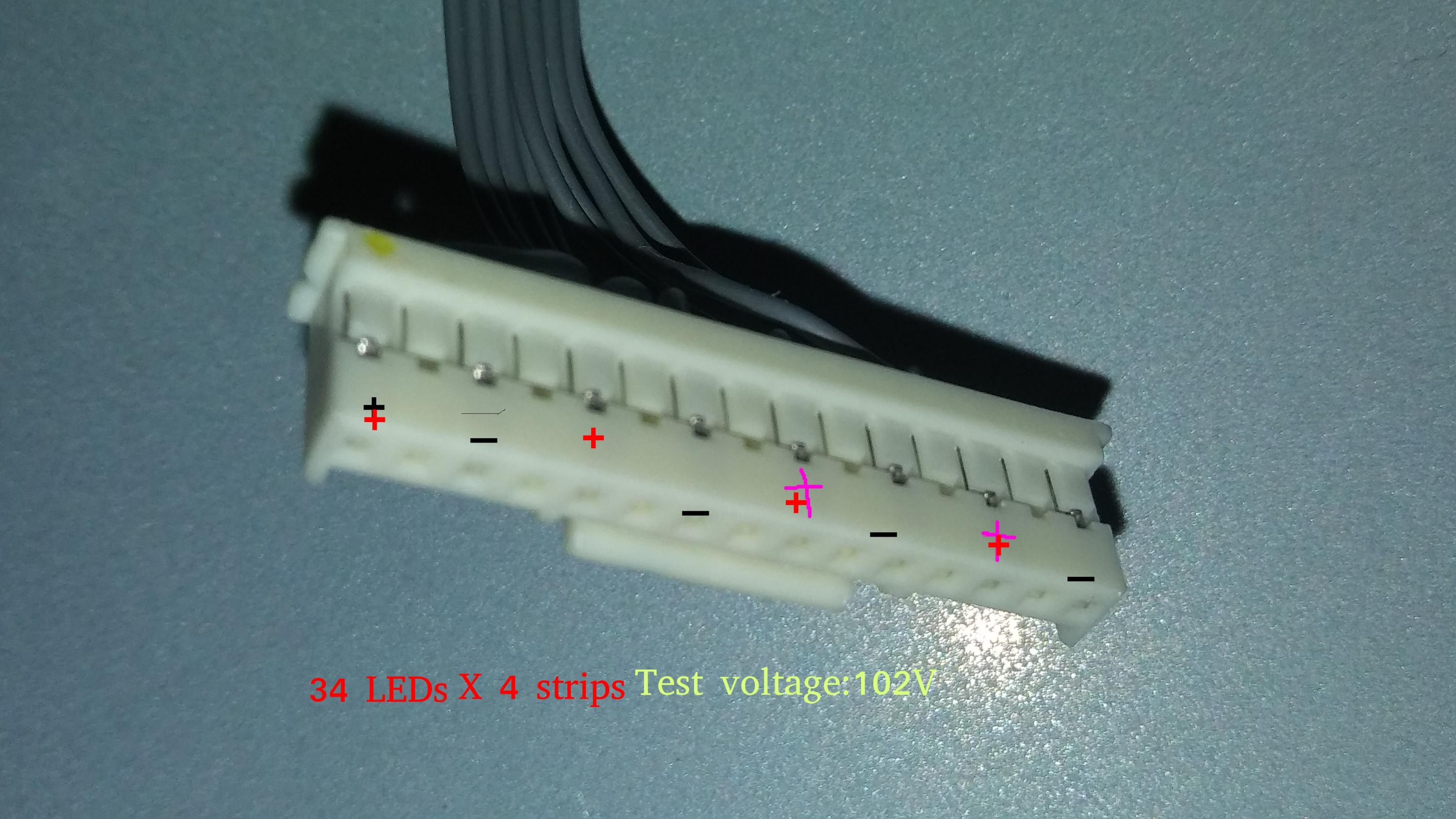

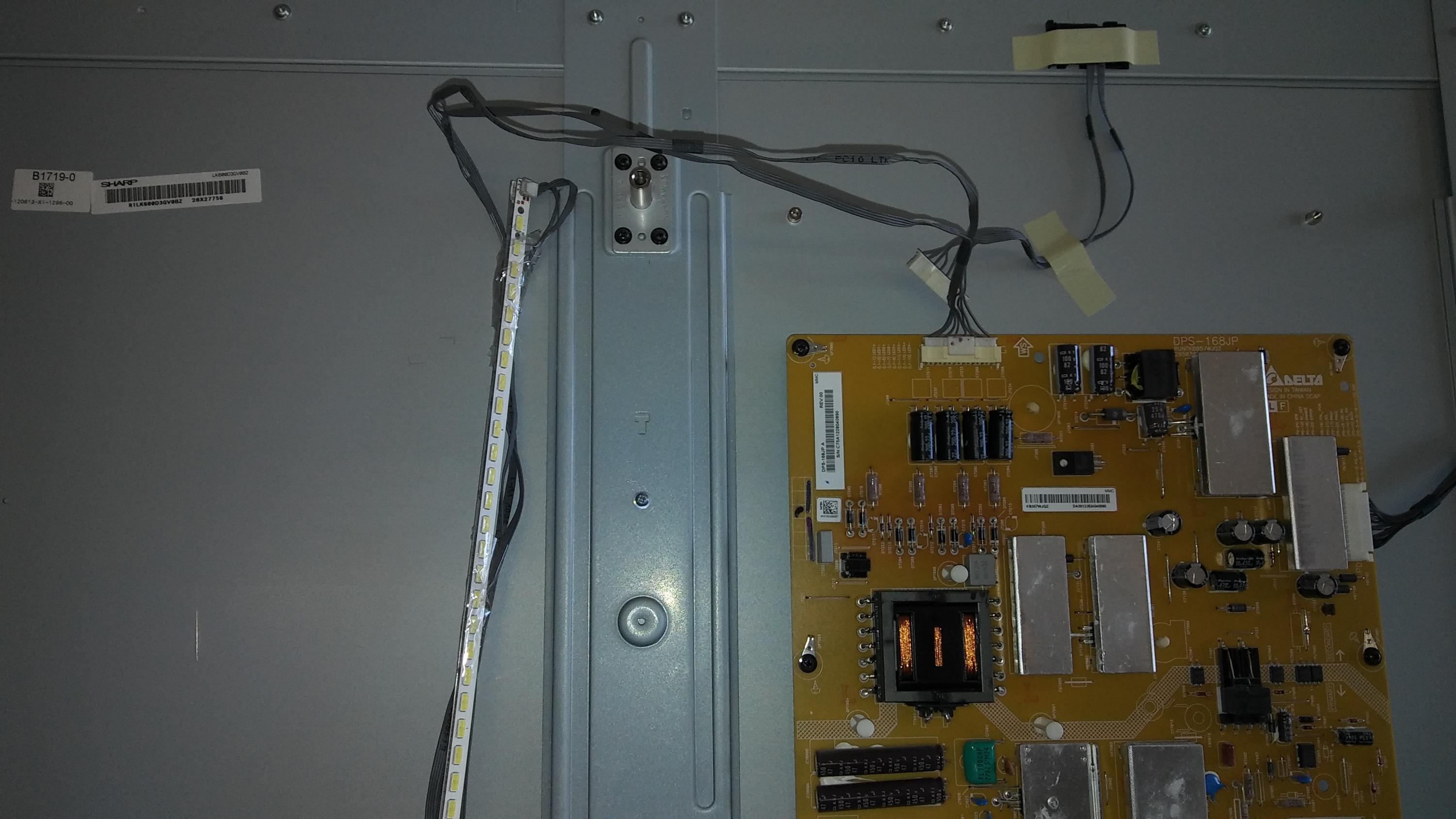

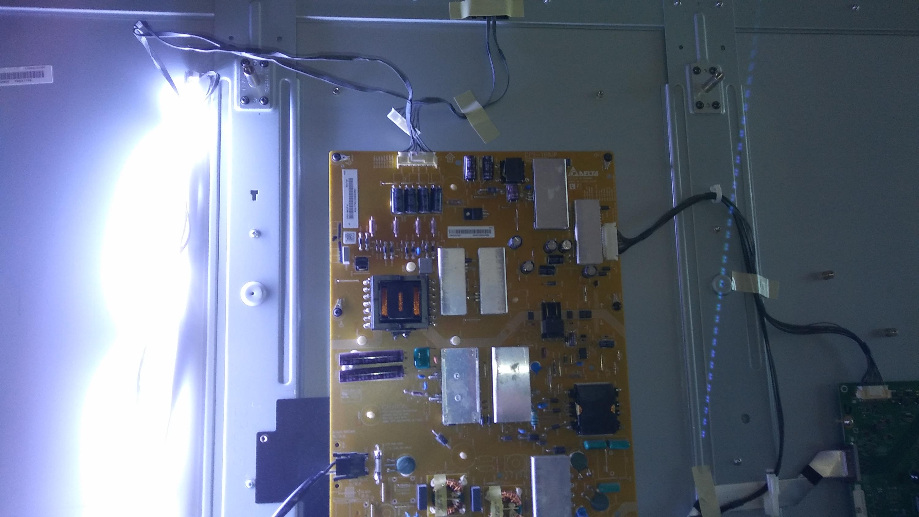

              Pic 4,5 : Connector pin out

                The key is trying to figure out how many LEDs there are in the string without taking the panel apart to get to the LEDs.
                Also need to find out if the LED strips are connected in series to form one big string or each strip is driven by its own driver.
                You can tell by looking at the PWM Controlled MOSFETs for the Cathode return for the LED string, if it has two PWM controlled MOSFETs then two drivers circuits are used.
                https://www.badcaps.net/forum/attach...5&d=1481642097
                I can see that it has four drive circuits for the LEDs' strings.

                  Over this Sharp tv has 4 drivers 34 LEDs each.
                  Can I use something else instead of LEDs to test ?
