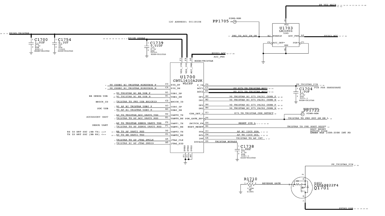

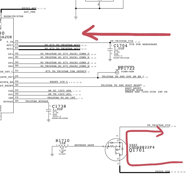

    Am I understanding this circuit right?
    This is from an iPhone 6. I'm having a hard time understanding how q1401 controls the "handshake" to Tristar_pin to allow charging.
    I don't see anything controlling the gate of q1401 either. Am I write to assume current flow that I've traced in red?
    Re: Am I understanding this circuit right?
    Do you mean Q1701?
    Voltage Source is fed to the Source pin of that P-CH MOSFET (Positive is applied to SOURCE pin so DRAIN has to be less positive than the SOURCE pin), when the Gate Voltage is 3~5V below the Source the MOSFET will be turned on then you will have Voltage at the Drain pin.
    Do you see that NETLIST named 'REVERSE GATE'? That pin goes to other circuit that has the same NETLIST name that you need to find, that will be what control the MOSFET, that NETLIST named 'REVERSE GATE' may go to more than one place.
    May be you should upload the whole schematics for people to see.
      Here is full schematic. I don't see netlist 'reverse gate' anywhere. Even searched entire PDF
            BTW, so what DCV do you have right now at S, G, and D?
              • 31020
              look more closely.
              the fet is bypassed with a diode to allow INCOMING power to reach the chip,
              the fet is only used to enable OUTGOING power for USB-OTG use.
                Originally posted by stj
                look more closely.
                Could you explain this more?
                @budm I don't have one to test I'm just trying to understand the operation
                  • 31020
                  usb-otg = a usb port that can act as a master supplying power, or a slave like a memory stick.
                  the device needs to be able to detect 5v on the connector to know if it's plugged into a pc,
                  but also needs to be able to power it up with 5v incase you connect a memory stick etc.
                  • caphair
                    • Nov 2011
                    • 1249
                    So the p_in terminal acts both as an input and output? It's confusing because it's tagged "p_in" and the line "handshake" so makes me think USB 5v flows into it.
                    But if q1701 is a p channel then the source pin (Tristar) would mean 5v USB is being provided to the drain

                                  So in my original post, are the red arrows I drew the wrong way current flows into that line?
                                    On the phone is little hard to follow schematics.
                                    But from a quick look I don't see any protection to reverse voltage.Could be in dock flex connector,but not sure.
                                    Also looking on 5S schematic,looks similar and 5V usb protect.
                                    As result if voltage right aplied tristar may enable charging and usb data,if reverse voltage aplied tristar disable charging and other circuits to protect.
                                    • caphair
                                      • Nov 2011
                                      • 1249
                                      What do you mean by reverse voltage applied?
                                      • gabiz_ro
                                        • Mar 2011
                                        • 167
                                        • Romania
                                        Reverse voltage,when you doesn't use genuine cable,chargers,etc.
                                        When right is + to + and gnd to gnd,is right,reversed when reversed.
                                        If you take a look at iPhone schematics from iPhone 3 to newer ones,you'll see that first ones use two transistors.If voltage applied right,then 5V from USB or charger reach to phone internals.If wrong or reversed voltage applied,then nothing.
                                        Seems like newer ones doesn't care if power line are reversed so only protect circuit is for tristar,if OK will power if not just do nothing.
                                        Seems hard to explain,but take a look at +5V from USB on iphone 3,3GS,4,4S...
                                        On all seems to be something that prevent reversed polarity,on 6 except circuit you ask in first post,nothing.
                                        This is not first post where you ask something iphone related.
                                        As you may noticed,for many components there is no generic info or datasheets available.
                                        So we may only guess what is about this.
                                        Short answer.
                                        Tristar P_IN pin needs to be powered with +5V to start charging and power on.
