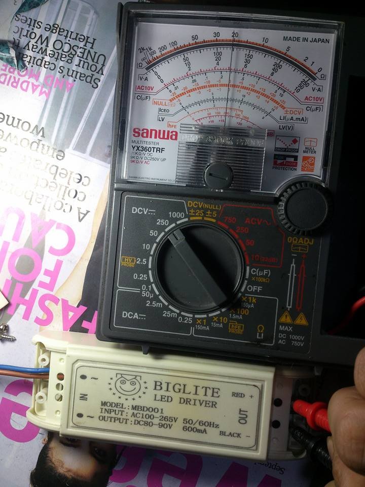

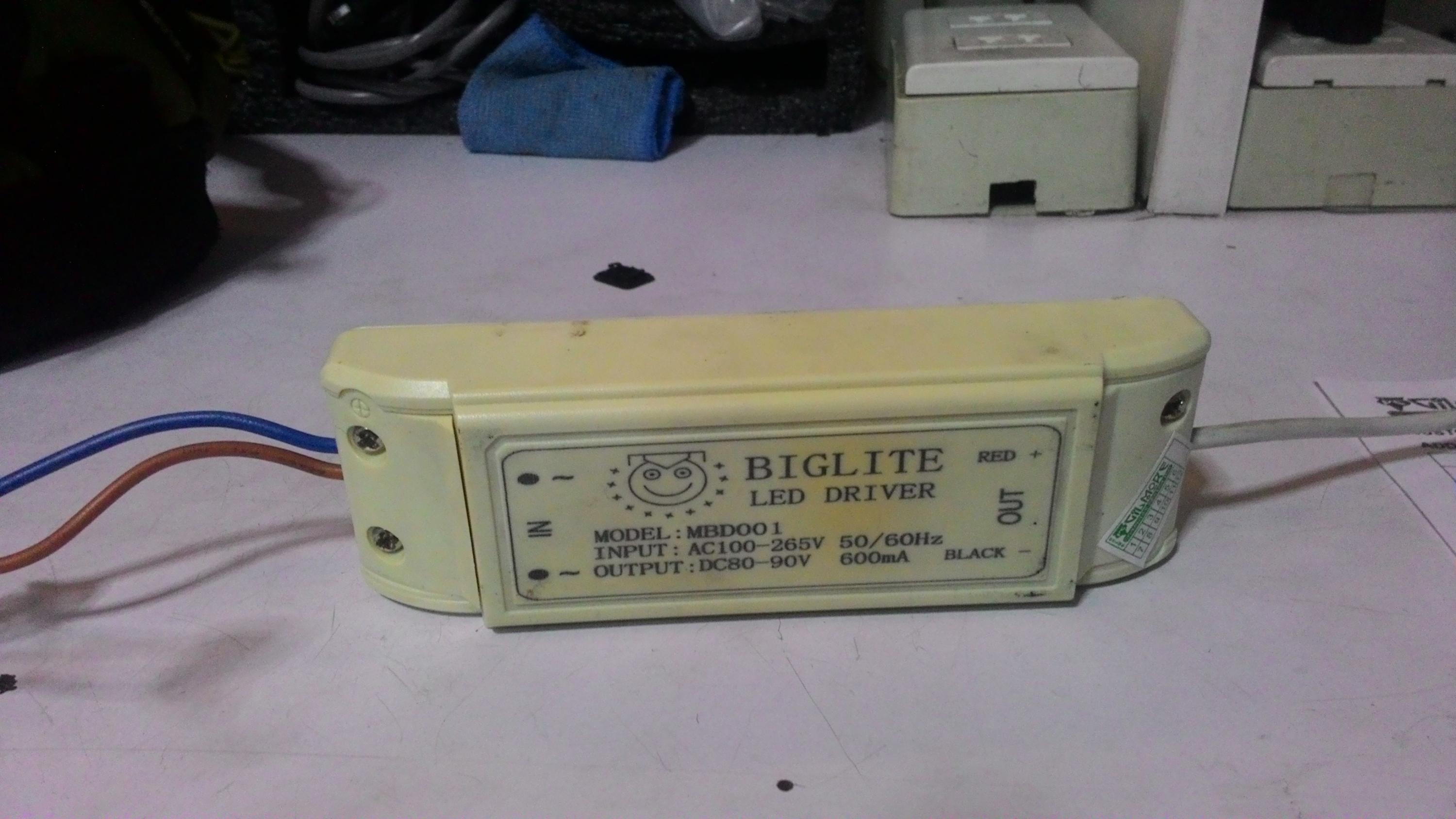

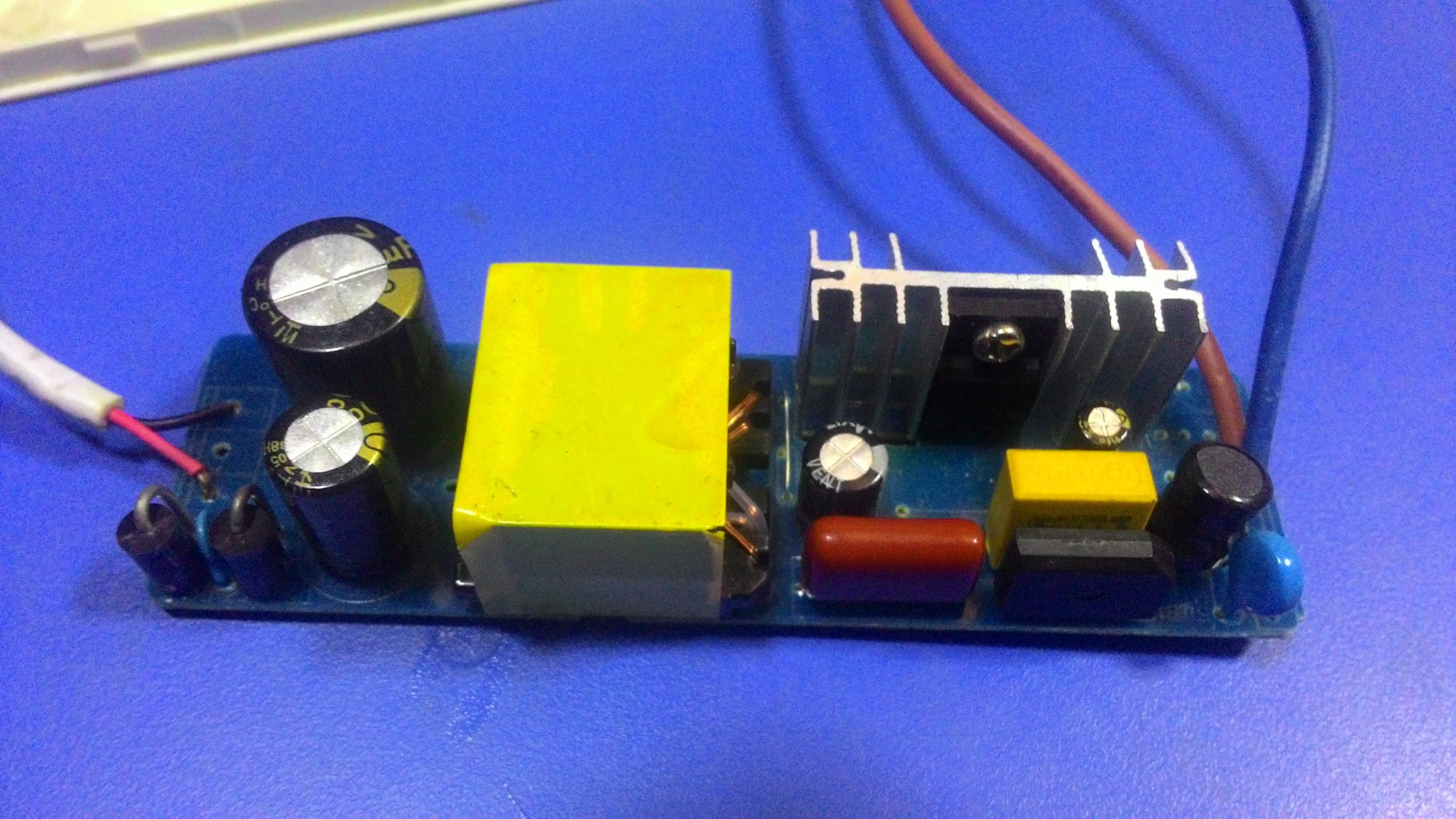

    i have a Biglite led driver.
    specification
    model:MBD001
    Input: 100-265VAC 50/60Hz
    Outout: 80-90VDC
    how come now the output is 125VDC...
    how can i fix this?
    first i check the 3 caps. all has been ok
    Any Solutions?
    TIA
    • 31277
    Re: Biglite led driver mbd001 Over Volatage
    is this 125v with the leds connected?
    btw, you have some cracked solder joints, resolder all the ones with a faint ring around them.
      Thanks for you Advice.
      i do it. not luck.
      i check the voltage out. i notice fluctuate the voltage the meter 125v reading prove the 123V the 125V...
      advice to fix this?

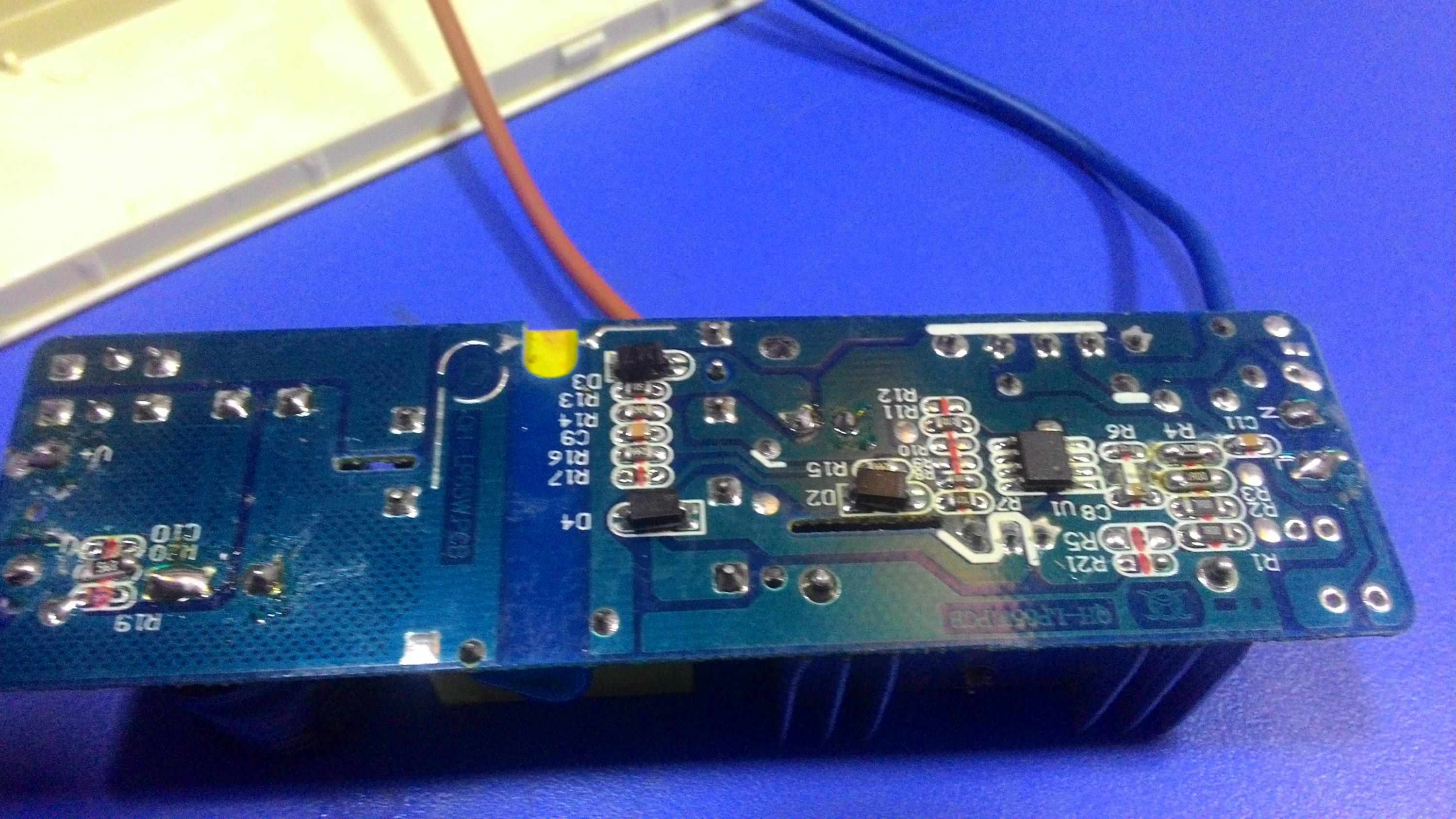

        I think you are getting 125Vdc because it has no load, the 80~90V rating is probably if it has working LED string connected to the output, LED power supply is the constant source power supply. Did you verify that the LEDs are OK?
        Any more details you have about this LED driver and the LEDs strings?
        You should also provide good clear straight shot pictures of the top and bottom side of the board.
          Thanks for your fast Response.
          I test new used working LED Panel. same problem if i used this led driver kit? Flicker then normal then after 3 sec. flicker.
            Is the LED panel made to be used with that power supply? What kind of panel is it?

              Yes Done. i Change The Caps..
              Thanks to stj and Master budm.

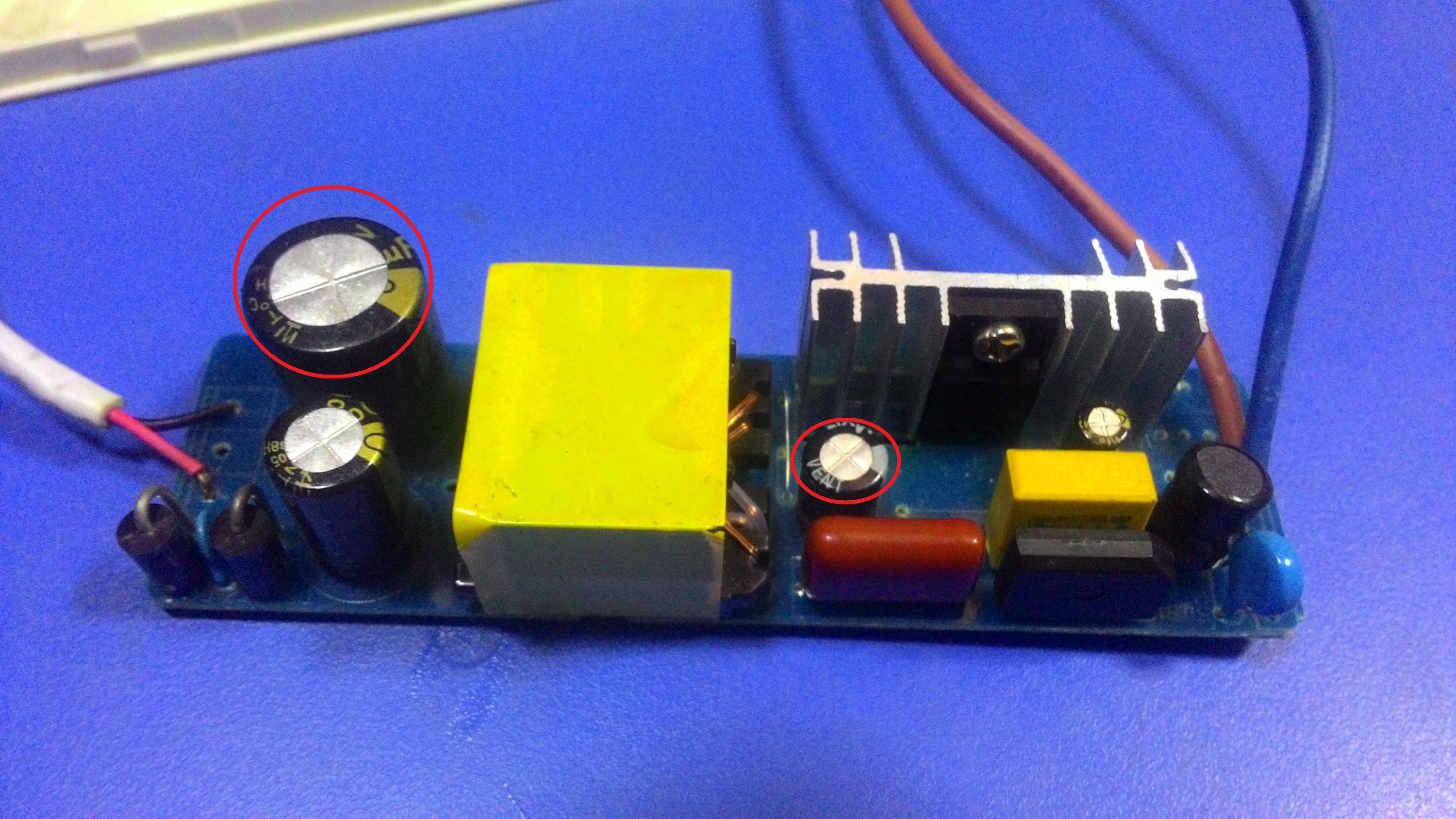

                  Originally posted by sam_sam_sam
                  So is the power supply working good now that you changed the three caps
                  Thanks For Additional Info Men... I appreciate For your Answer i dont have a Esr Tester Someday i buy it.
                  Now My Boss Happy i fix this Stuff from China Made
                  Now I know how to Fix and I Share the Simple Knowledge to newbe's and other not know how to fix this BigLight Led Light Driver.
                  Flickering Problem. replace 2 Capacitor on the following area main filter 150Uf/400V and output Filter Cap 100uf/100v. with Circle Red see. the image attach below
                  Other info I Used The Name Brand Rubicon
                  Thanks Again. specially to Mr. Stj and Master Budm And to This Forum Site Owner and All Members More Power

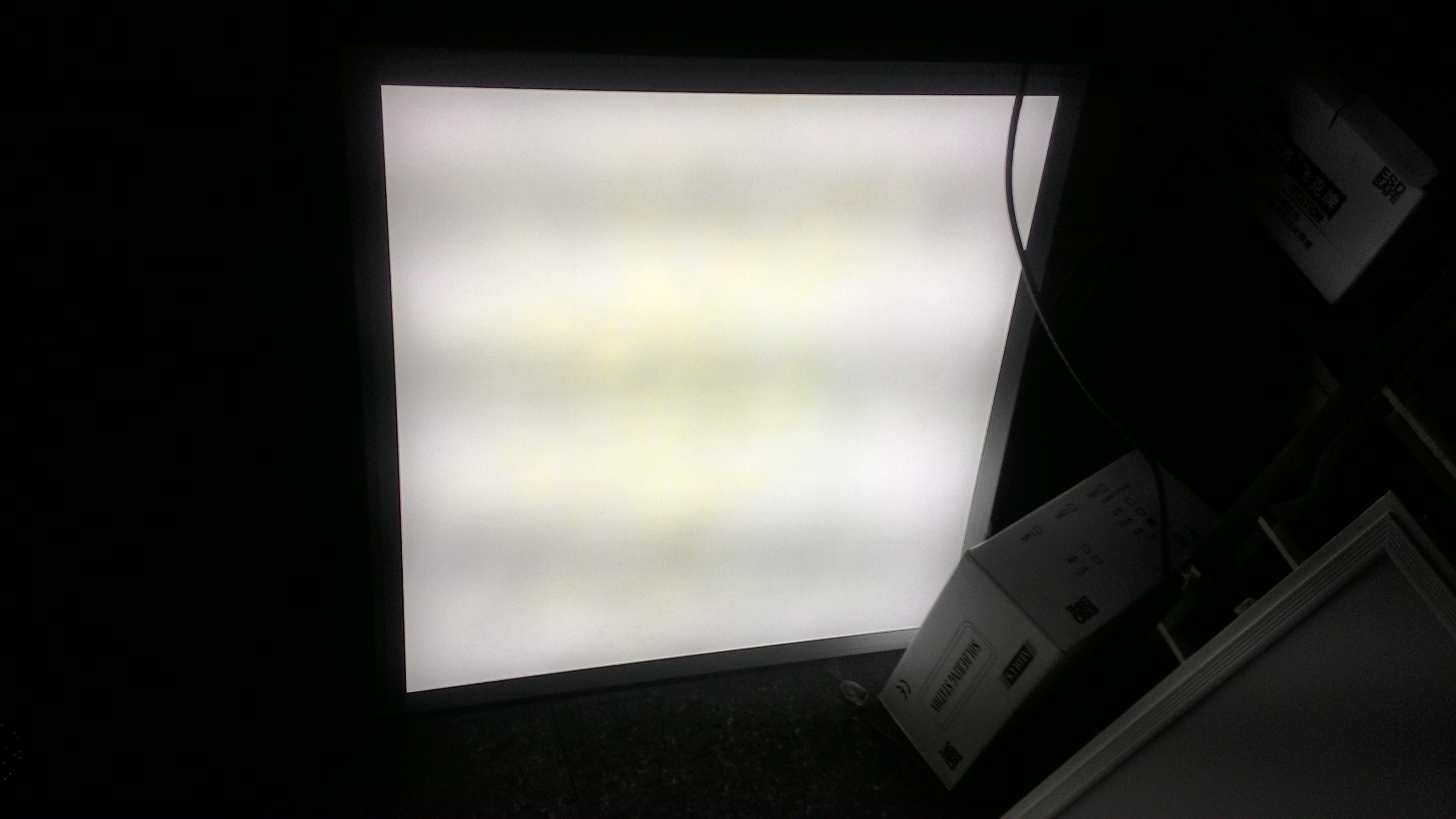

                    Master budm sorry for late response for your question...
                    Here the Image
                    LED Light Panel
                    BigLite LED Inverter Driver
