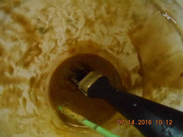

    Guys,
    Does anyone know where I can buy liquid flux ?
    The one I have is paste one...

          Re: Liquid flux question ?
          I use a no-clean liquid flux made by a polish company, AG Thermopasty, it comes in bottles from 50 ml to 500ml and prices from under $2.
          TME.EU distributes this brand in Europe, it's a reputable company.
          However, for bga and reflow you'll probably be better served by a flux that's more paste-ish, no water like liquid.
          Louis Rossman has a Youtube channel where he repairs Apple products and took it upon himself (and his company) to buy big quantities of flux from Amtech (which have an antiquated sales mechanism involving signing and faxing authorizations and crap like that) and reselling it in his online store.
          Here's the store link : https://mailin.repair/amtech-nc-559-v2-30-cc-16160.html and here's a video he made about this explaining in more detail: https://www.youtube.com/watch?v=9skxEr1eQ9o
          It's expensive (for quantity) but genuine stuff.

                      I've been used Organic fluxes for 6 years, I collected pine tree rosin+alcohol +Lard or tallow +Olive oil then mixed it . (see the picture,look horrible but taste good.)
                      Tall oil rosin finds increased use due to its higher thermal stability and therefore lower tendency to form insoluble thermal decomposition residues.
                      One of the early fluxes was a mixture of equal amounts of rosin and vaseline. A more aggressive early composition was a mixture of saturated solution of zinc chloride, alcohol, and glycerol.(add acid, u can make a bomb.) (from WiKi)
