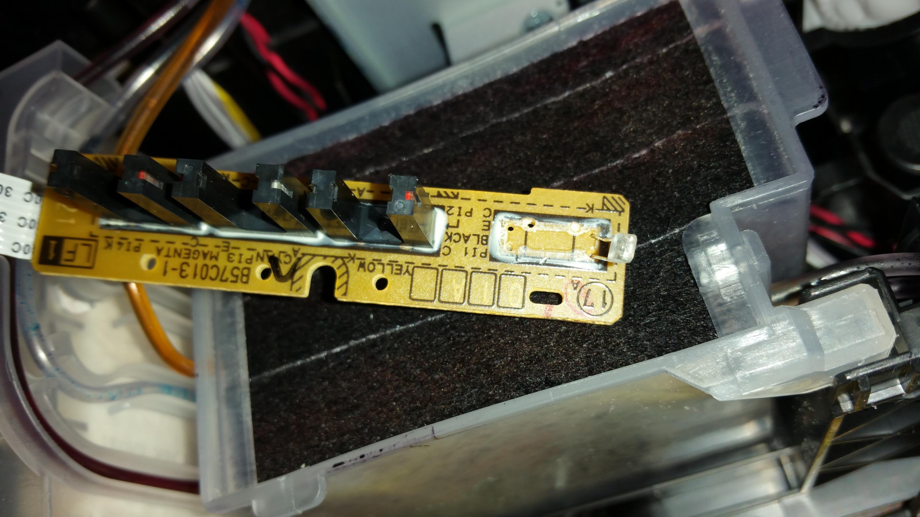

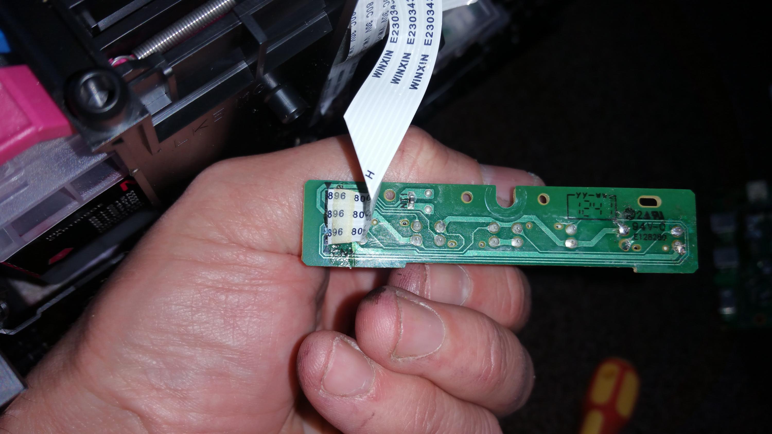

    Hi

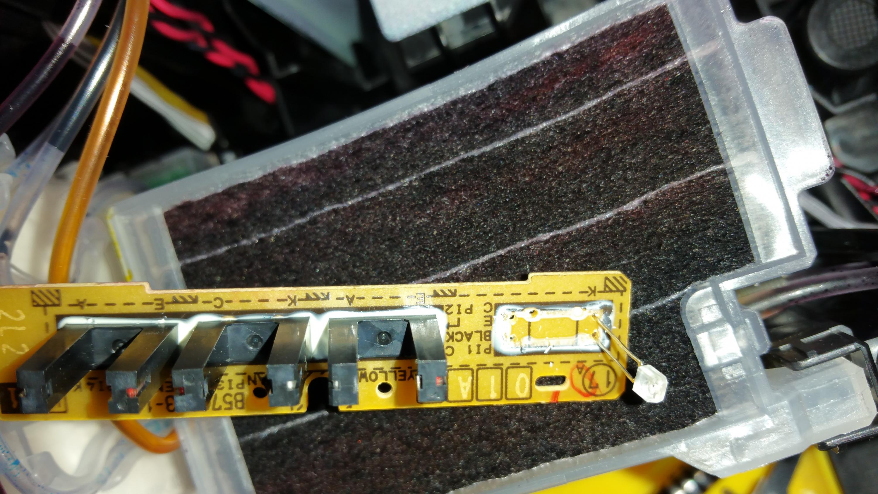

    I need a bit of help with this board. This board is one of two that work similarly. One which is working detect a printer cart being inserted when a bit of dark plastic goes between two sensors. The second pictured works the same way but detects if ink is in the cartridge through a window in it. Anyway. Its not working but I don't really know how to bypass it.

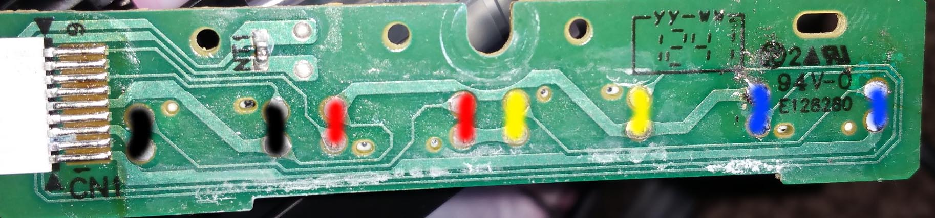

    One the back of the board represented by the colours on the pic are the sensors each colour is the pair for each cart. I could do with help trying to understand how to solder this up to make the board think the sensor can not see the other i.e. there i ink in the tank.
    Also what would NT1 be?
    Thanks in advance
    James

    no idea on NT1, mer the resistance on the working one.
    as for the rest, they are pairs of an led and sensor.
    to see which is which - look at them with a camera.
    or show the other side of the board.
    what printer is it, brother?

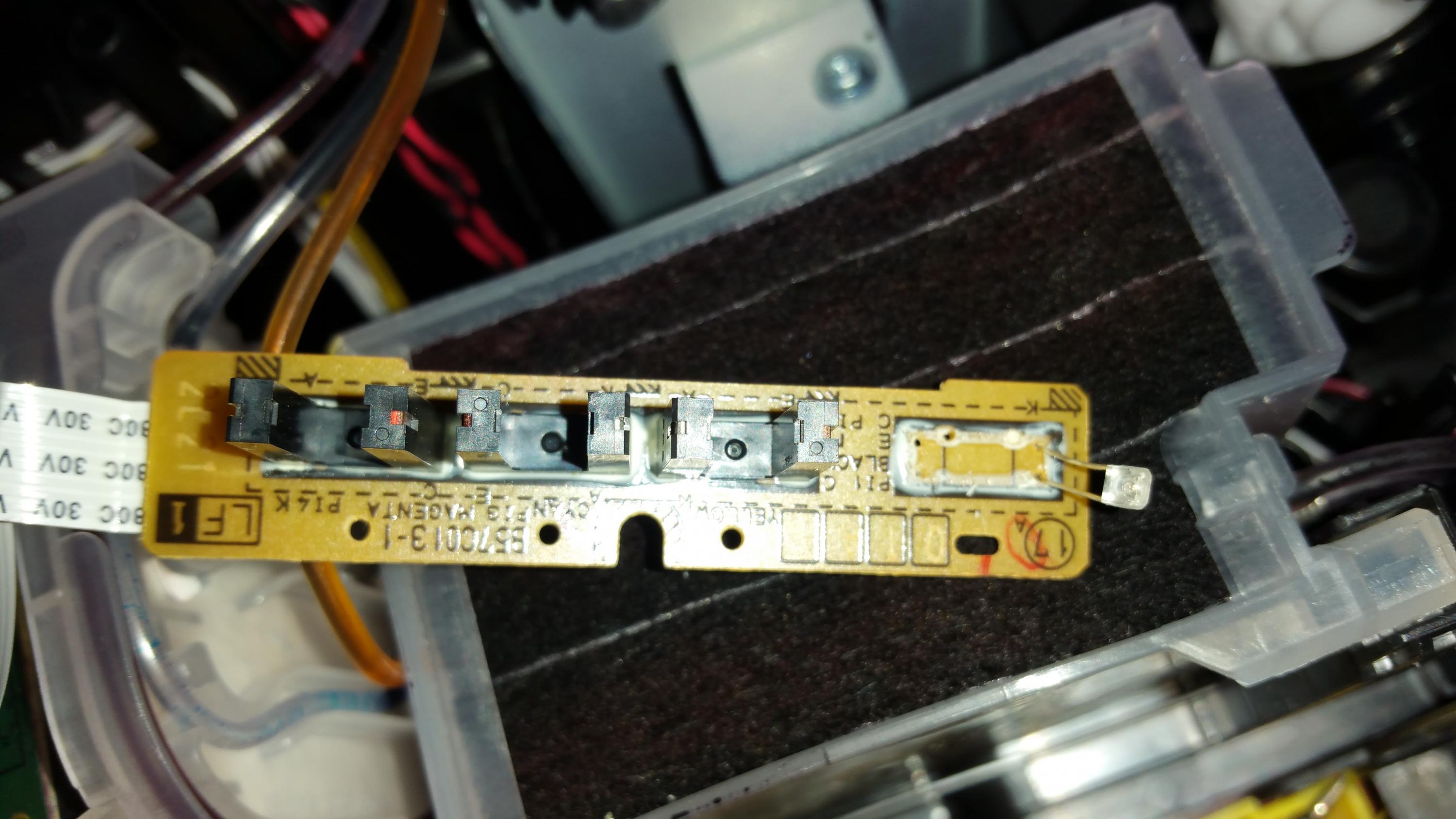

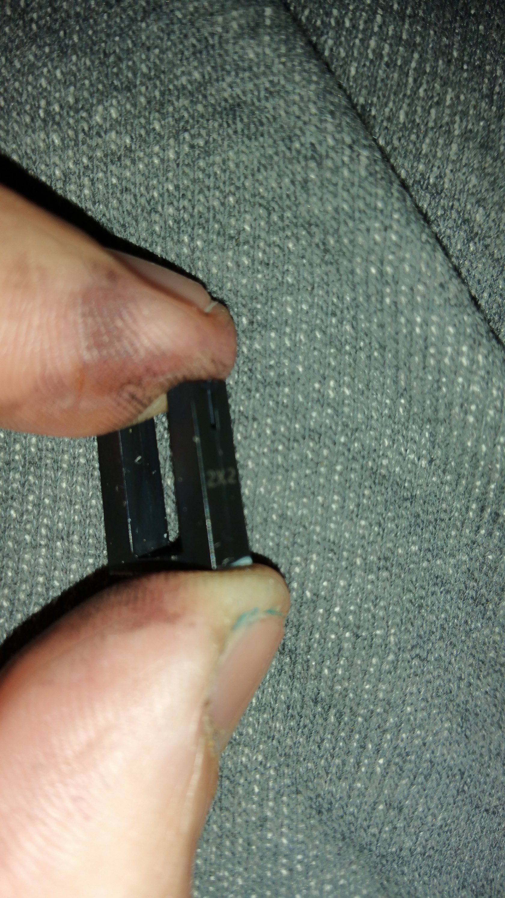

        OptoInterupter! Thats what I should have searched for would have saved me a lot of time lol! Thanks. As for P/N - it says N73 on the bottom and 2x2 o the side. attached is a pic of the top side.

          Can you show the pictures of what are printed on the body of those Opto?

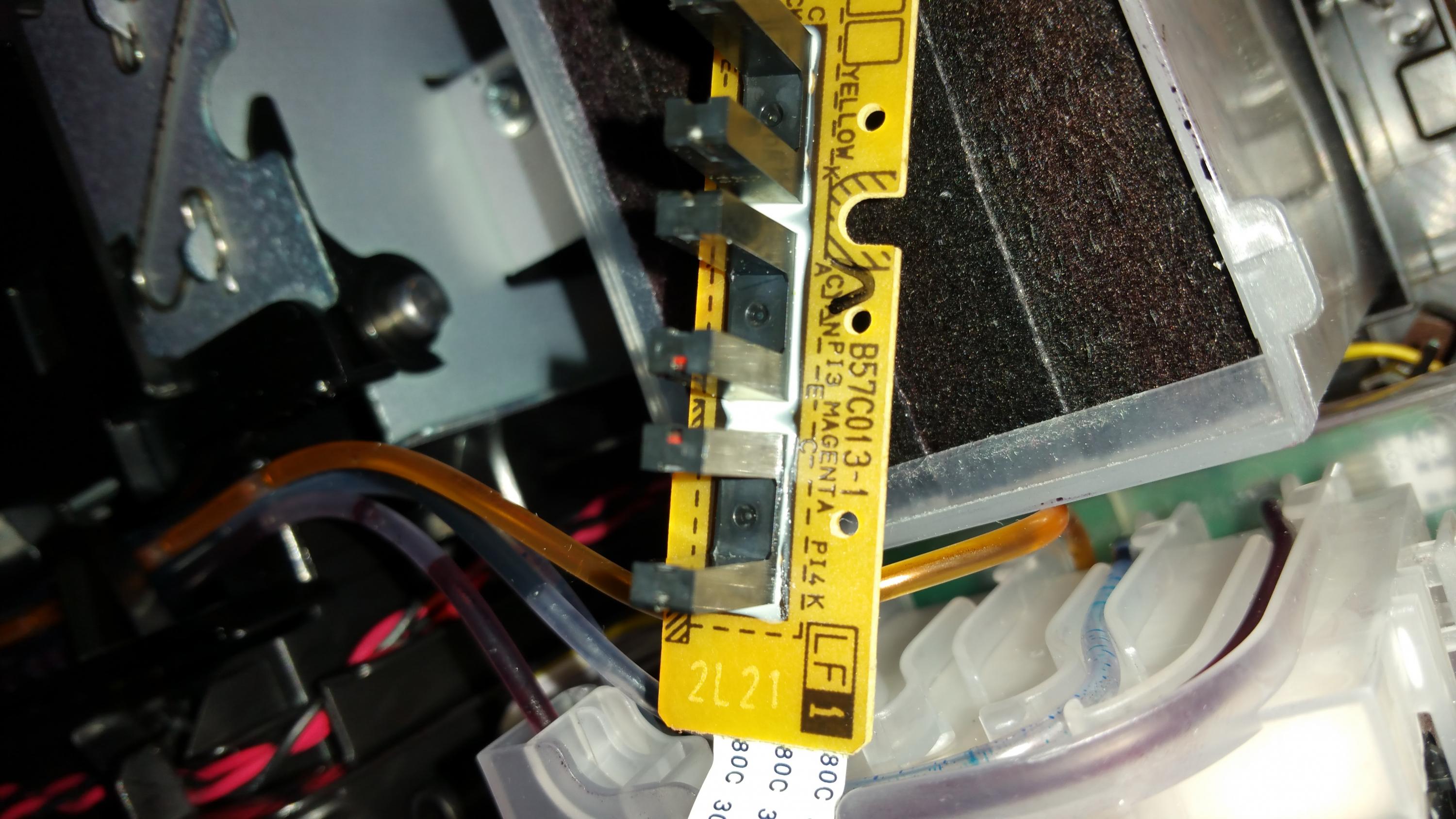

            Re: Basic Board Help
            This a few views of the board

                    OK based on this picture:
                    https://www.badcaps.net/forum/attach...0&d=1461868467
                    That part to the right of the board is the LED for the P11 Photointerupter, and the two holes with 'E', and 'C' marking are for the Phototransistor.
                    So look at the other sensor and look for E, C markings on the board.

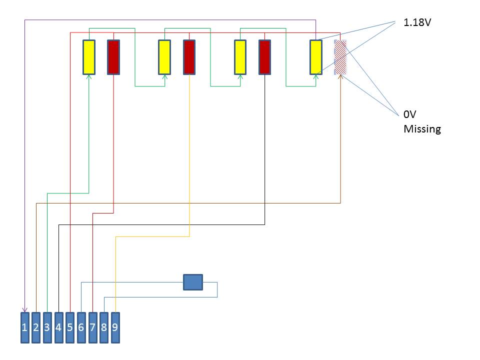

                        OK done a few measures but get nothing on the damaged board across the phototrans. The working board however does as you say and ramps up when blocked.
                        This is the best I can work out for the layout of the board attached. I can see the 1.18 v supplying the LEDs but cant see any v on the phototrans. That said if I put one lead on the phototrans and the other on pin 3 or 4 of the ribbon I can see it go above 2.5v.

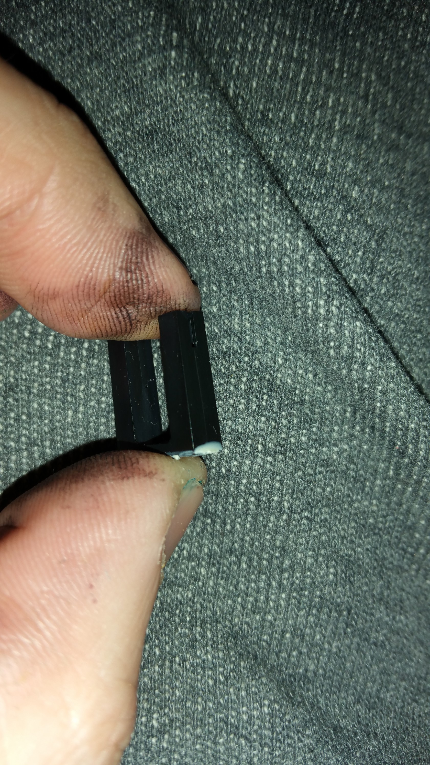

                          On another note the missing part was there and it wasn't detecting the black cart. Now its snapped off its the same error. Do you think I just need to jumper 3v to pin 2 on the ribbon?
                            So you put the bad board in the good working machine and the Voltages do not look right compared to the good working board?
                            The Photo transistor is turned off when you have blocker between the slot so the DCV between E-C will be high. So the one that showing 0V between E and C when blocked means that the transistor is bad and not being turned off.

                                  To simulate that the Photo Transistor is turned OFF (Blocked) you will need to remove the E leg or the C leg off the board so the transistor will no longer be in the circuit.

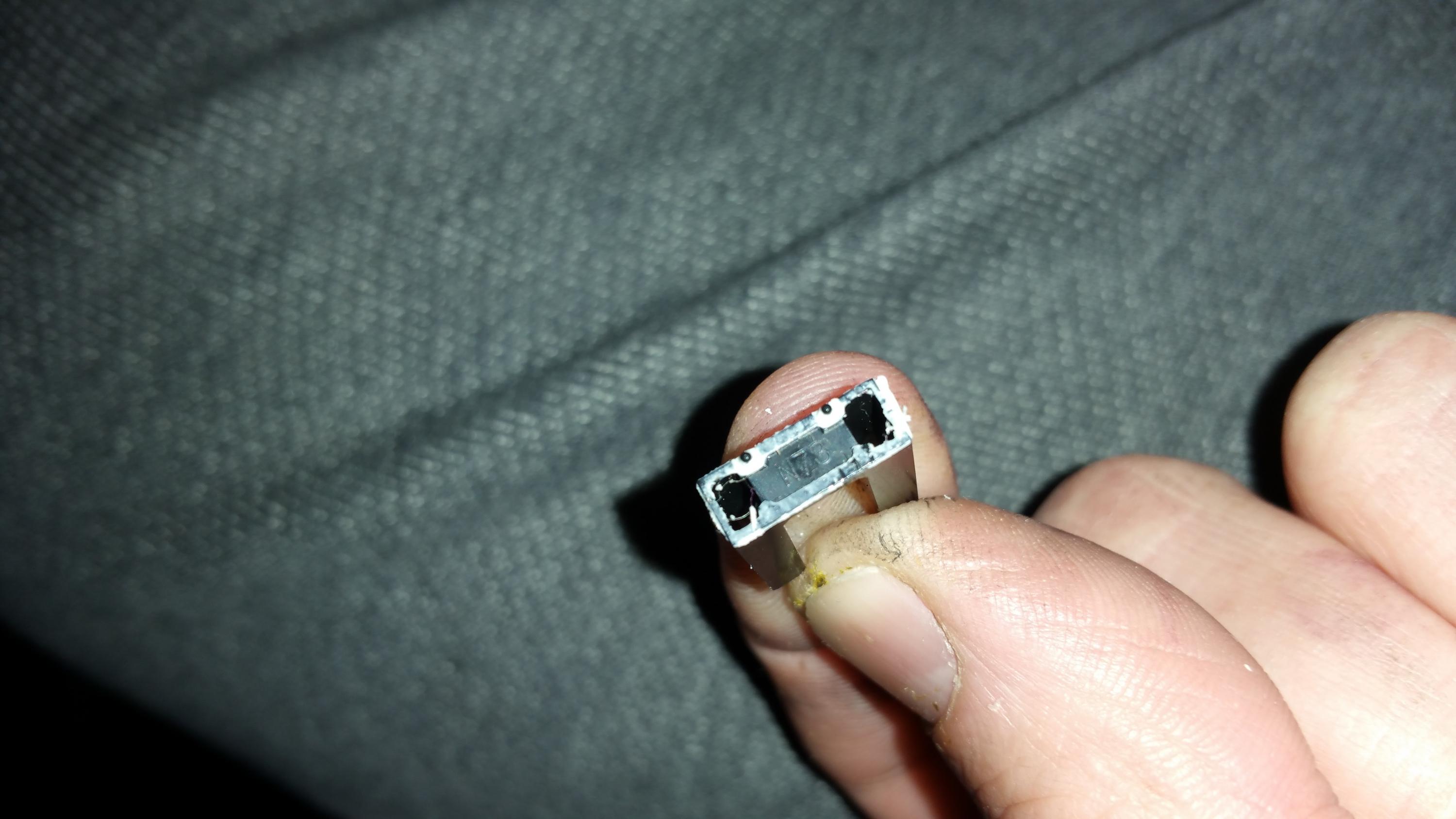

                                    looks like the problem may be somewhere else then as the black cart PT is not even on the baord any more lol and it still says cannot detect black cart.

                                        I can't understand how you can measure 0V between the E and C pads in the black circuit if the transistor is not present, unless there is a problem on the main logic board.
