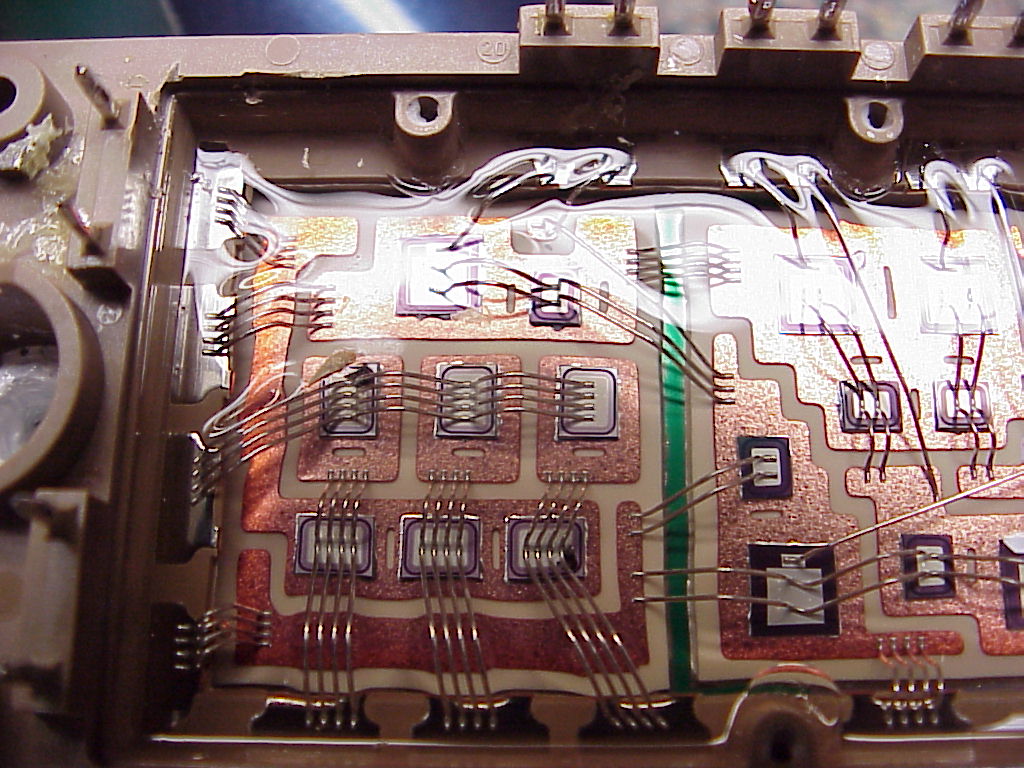

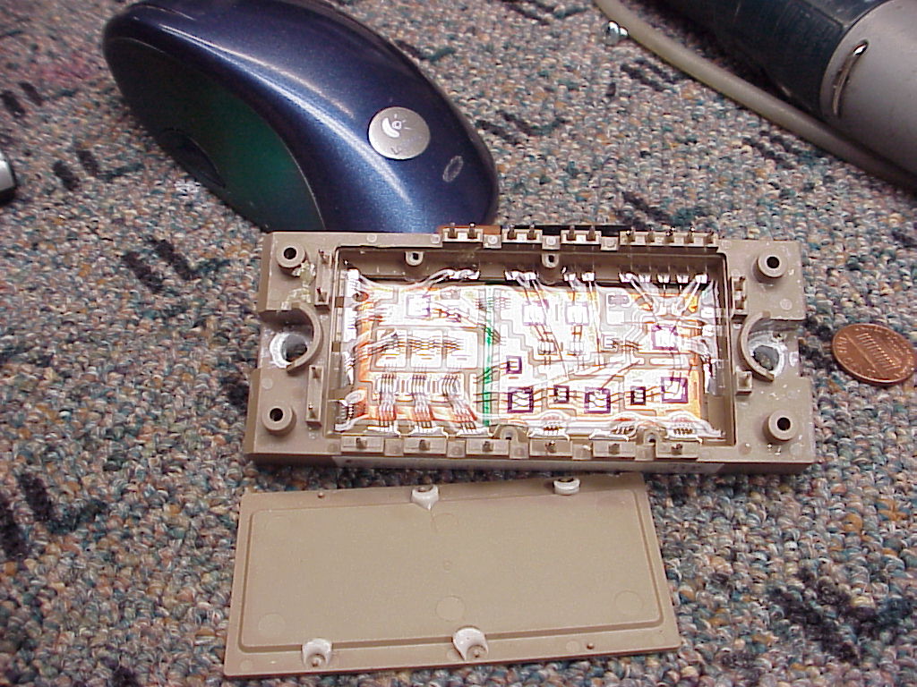

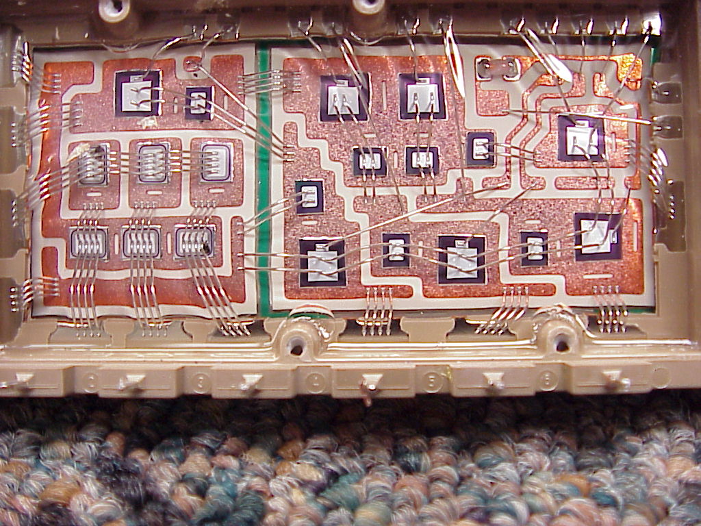

autopsy of a fuji 7mbr10sa-120 rectifier/igbt module.
  • kc8adu
    • Nov 2003
    • 8832
    • U.S.A!
    a spike got this one.
    note the black spots in the 3 ph fw bridge.

    Re: autopsy of a fuji 7mbr10sa-120 rectifier/igbt module.
    what kind of motor or something this is used to control with?
    And this is cool pictures btw. I thought I spot BeO plates soldered to the copper heatsink plate where copper tracks were deposited on the BeO plates?
