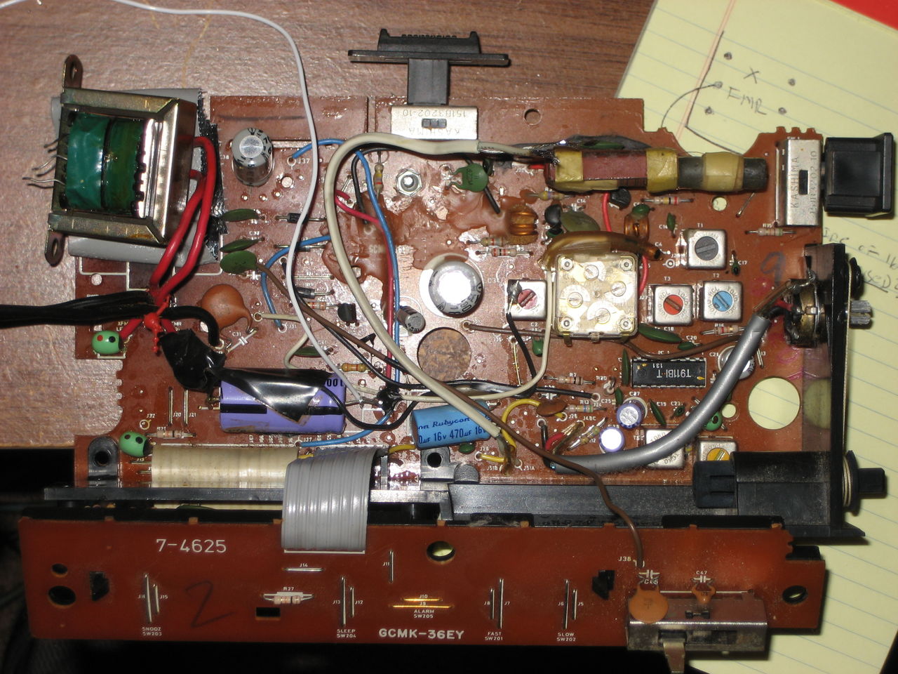

        Here are some pics. Maybe this is an exception. I'm seeing end of '81 era date markings on the caps and the original transformer. I'm sure it's a power transformer with multiple out taps. But I am still learning so correct me if I'm wrong. the transformer has been removed at this point, and is on it's side.
        https://www.badcaps.net/forum/attach...1&d=1454028404
        As far as I can tell, each of 3 taps has a single diode and a filter cap, so I think it's all half-wave rectification. Also - the highest rated cap is 35 volts, indicating a lower voltage than line voltage. The lowest voltage cap is 10v, as a dc filter to the speaker. The old transformer was a tamradio.

          That's an interesting unit. Early 80's GE, but has more "cheap" looking PCB of the later stuff. Definately a power transformer- the audio output transformers were about the size of that tuning cap, except about twice as tall.
          Even that far back, they used Tamradio...

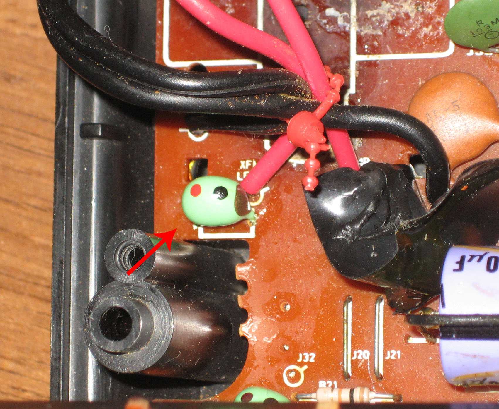

                    Arg.. .Just when I thought I was done, I've found another problem - an open inductor. Picture attached. It goes from the mains to the input of the transformer. It's got a red dot, a black dot, and a big brownish gold colored mark on it's right side. It's marked as L9 on the board.
                    When I patched a different transformer in there temporarily, I bypassed the inductor because I used the power cord already connected to the new transformer - thus I didn't spot this earlier. Anyone know how to read these old part values, and what a suitable replacement would be?
                    It's 120v/60hz here.

                      That attachment didn't work for me - brings up this error "Invalid Attachment specified. If you followed a valid link, please notify the administrator"
                        • 31246
                        Re: Help with a clock radio
                        brownish gold isnt good enough, it's brown OR it's gold.
                        you need to decide.
                        codes are like resistors,
                        so red, black = 20
                        now we need the multiplier/divider digit
                          Weird... it was working yesterday! Seriously
                          Here's attempt 2. I've reattached to this post.
                          The picture reasonably represents the 3rd color. Stj - it's sort of in the middle. I would guess gold but look at the picture and let me know what you think.
                          I've got two other opinions, one person thinks brown, one thinks gold. I guess this is the question of the day, for me at least.
                            • 31246
                            it's gold.
                            there is a brown one for comparison in the bottom of the foto.
                            so it's 2uH at whatever minimum voltage & current you need to put through it.
                              That inductor looks like a primary noise filter... 120V mains -> inductor -> transformer.
                              I was wondering if there's a way to tell whether that is more sanely 200µH or 2µH as I am not an AC power expert... though I'd say either will probably work just fine.
