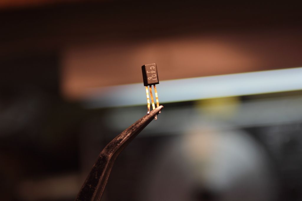

    I'm in the process of repairing a Sony DVK-2400. Yes, if you googled that it's a reel-to reel portable video tape recorder from 1967. Aside form +12v the thing showed up on my bench otherwise totally dead.
    Anyways, it heavily uses the 2SC401 transistor. I've found at least one so far that is bad in the power regulation circuit and I cannot find a modern substitute that will work.
    I've been recommended I try a 2N3904 in its place instead but I'm not positive that it's a close enough match. The link above also lists a few substitutes but a lot of those are also no longer in production either, or they're $5-$7 per transistor which is nuts to order considering I probably have more than one that is bad.
    Anyone got and pointers on tracking down a substitute?

    My equivalent book states a BC546 as a replacement,
    the 2N3904 equivalent is also a BC546,
    (with different pin connections), and available via EBAY

      pull a working one and put it in a component tester if you have one - see what the spec really is.
      otherwise, find a schematic for the equipment

        Archive shows a KSC945 as a substitute. I've got bunches of them in stock. http://www.datasheetarchive.com/2SC401-datasheet.html .

          A 2SC945/KSC945/C945/C460/C1213/... is is probably a good bet especially on audio equipment, it should be a good match. I think the 2N3904/PN2222/etc. have a different pinout and you'd have to do some pin switching (swap pins 2 and 3) to make it work. Test a working one for pinout to be sure, but it's likely ECB wherease 2N3904 is EBC.

            Mouser has several flavors in stock at .22 cents each. http://www.mouser.com/Search/Refine.aspx?Keyword=ksc945 .HFE of 120 to 400 it looks like.

              Looks like the 3904 did work after all.
