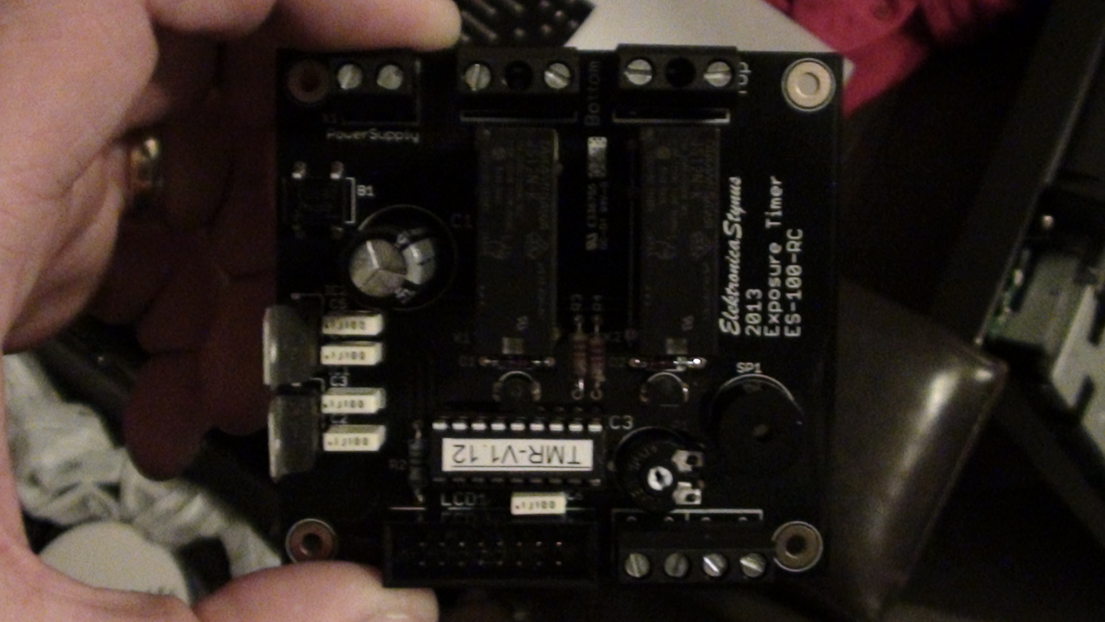

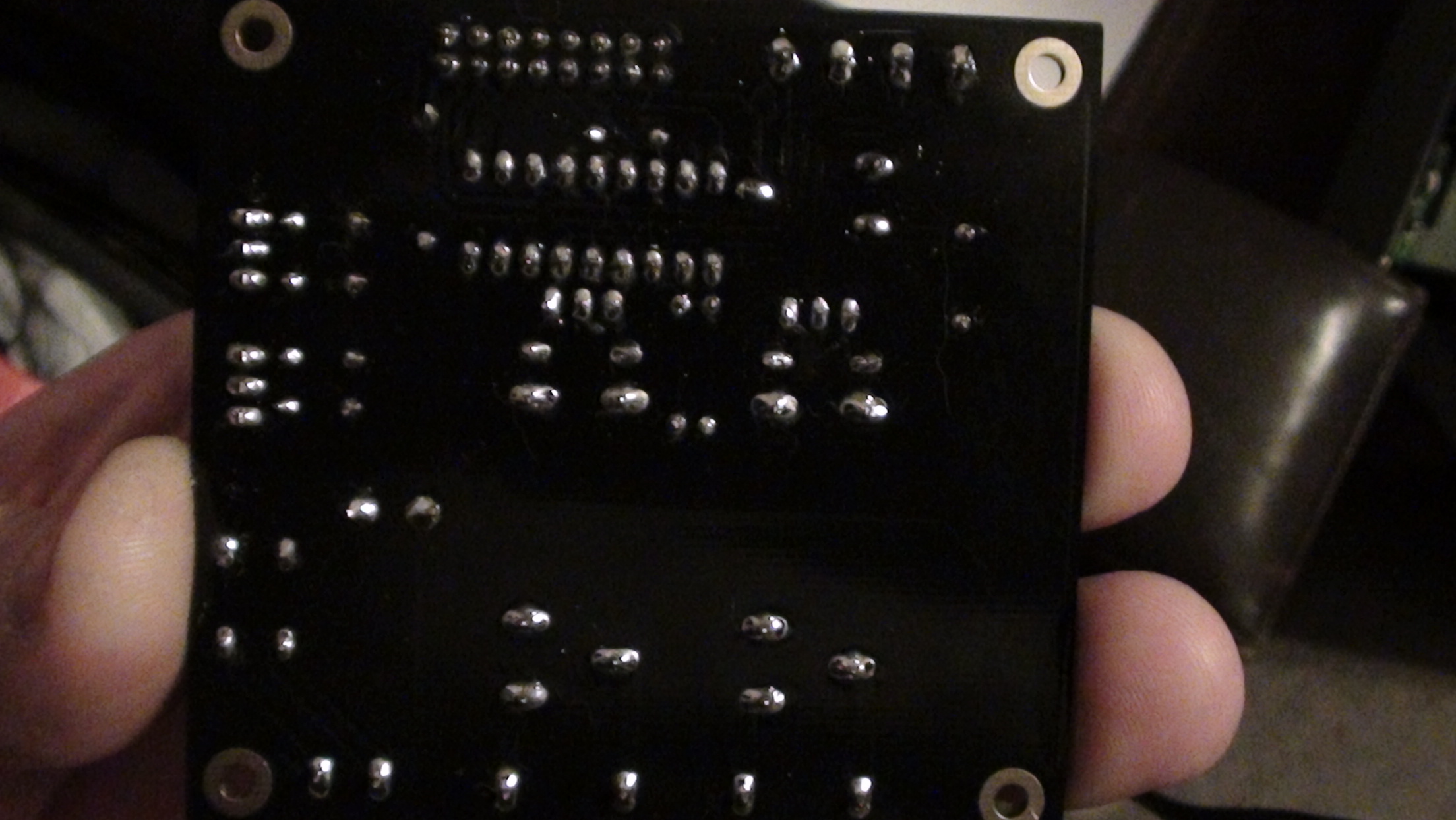

          #104
          Re: Need help reading a schematic.
          Originally posted by budm
          That is correct based on 12 boards, and then plus the control circuit and the display, so regulated 15V supply with 2A current capacity should be good.
          Oh, that's great! I think I understand this! Here's some pictures of the timer board and the UV LED PCB, what do you guys think? Thanks for all the help! Really appreciate it. This stuff is really fun when I'm understanding it and each day, I seem to understand a bit more!
          I know the resistors I could of done a better job with. They were really really tiny though and it was really hard with no one helping. I was thinking of maybe trying to use my hot air reflow station to add some hot are and try to get the solder to melt a little bit so it looks not so mountainy like. You know, so the solder on each resistor kind of levels out a little bit and looks more uniformed.

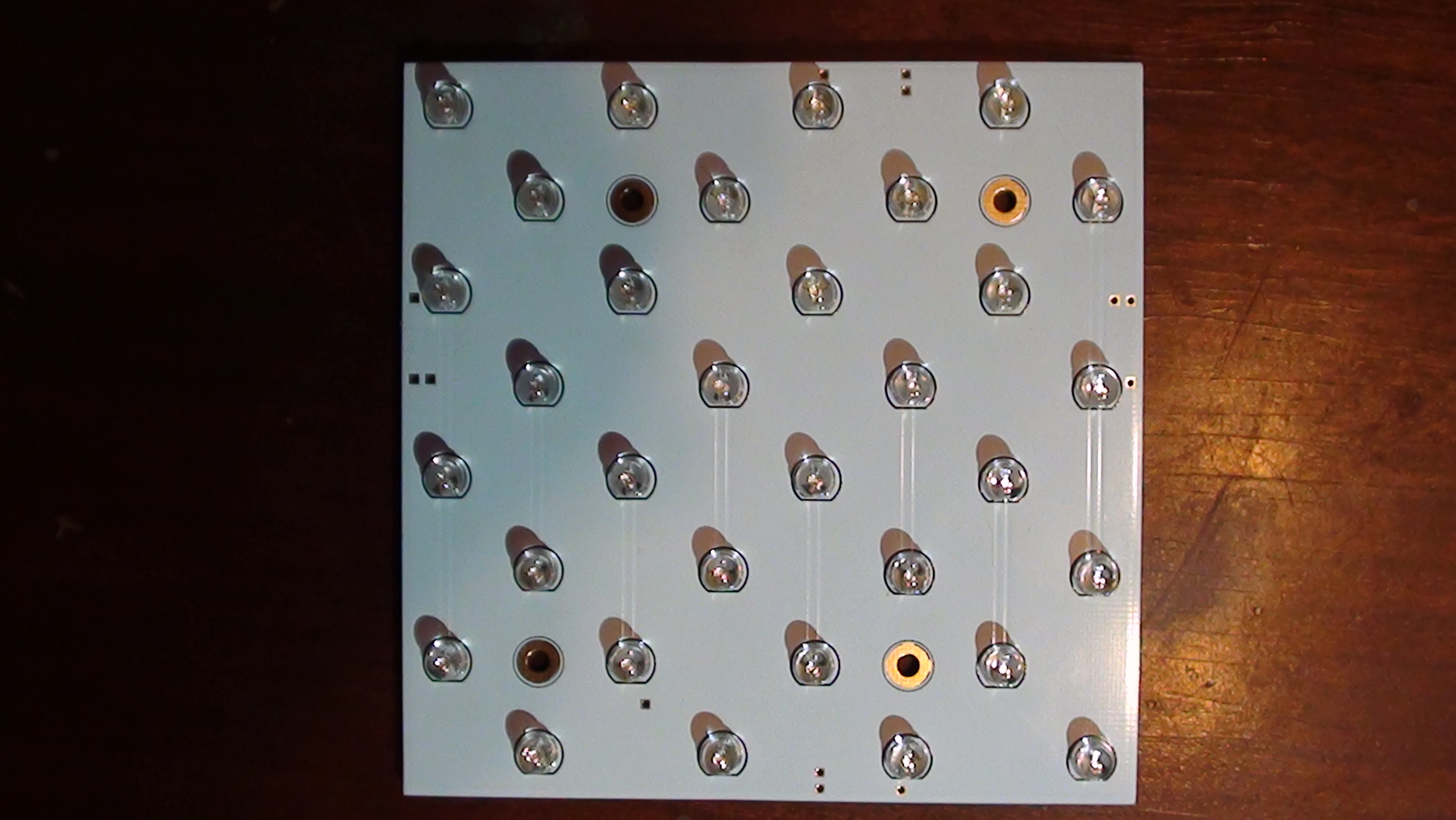

            #105
            Got the second board done as well! Looks a bit nicer with the SMD resistors. I think I'm getting better at soldering those dang little things! Lost one on the carpet and took us like 30 minutes to find!
            I wanted to find flat pieces of metal to solder to the VCC / GND pads there to connect the boards. Anyone has any suggestions for that? Hopefully, once I get this built, I can use it to make two giant LED boards instead of having to use 12 smaller ones.
