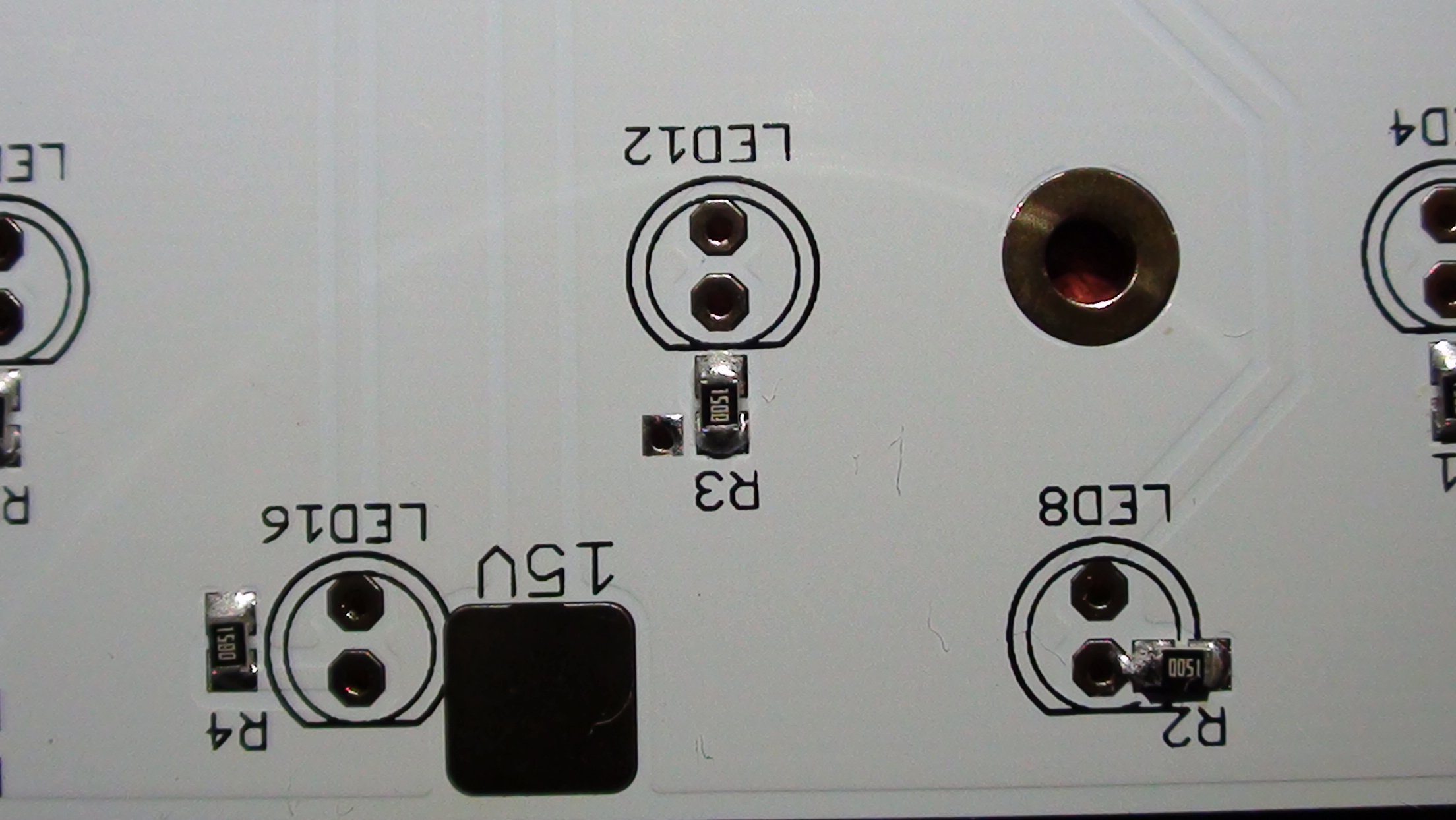

              So, what do you think of the solder job using solder paste and a hot air rework station? I think it isn't too shabby. I had a little trouble. The only problem was trying not to put too much paste on the pads. I had to wipe it off once or twice because too much came out. I checked every resistor to make sure there were no shorts or anything. Everything tested good. Two of the resistors ended up lifting off the board and staying straight up in and down instead of laying flat on the board. But I just used a pair of tweezers to push it back down.
              The preheater really seems to be the key for this stuff. Using the preheater, it only took a few seconds for the solder paste to melt and turn into solder. I used a low air speed, 3 on my system and a temp of around 650F or so.
              -- Law of Expanding Memory: Applications Will Also Expand Until RAM Is Full

                #127
                Re: Need help reading a schematic.
                pretty good,

                  #128
                  Originally posted by stj
                  pretty good,
                  Thanks! First time I've successfully used the hot air rework station to actually solder something. It's great for removing stuff. Glad I didn't have much problems.
                  On a side note, when I clip the leads off the through-hole UV LEDs, the wire snippers I use cut the leads leave them a bit smushy looking. They definitely don't look like a professionally done PCB. Is there a better way to cut these leads? How do they do it at the factories?

                    So the power supply powers the UV Exposure Time circuit board, which powers the UV LEDs. The power supply should have a fuse in it I'm thinking but is it possible that the power supply would break in such a way where it could fry the exposure time circuit board? Would it be a good idea to add a fuse to that circuit board or don't power supplies usually break like that?

                      #130
                      Man, I had a scare! Took me a bit to figure it out. Soldered all the UV LEDs on the board and one whole column (four UV LEDs) didn't light up at all! I thought for sure it was the trace. I went through and touched a soldering iron to each one, hoping it was a cold solder joint or something. No go. I looked at the schematic and board layout and studied how the lights were actually ran for those four non-working UV LEDs.
                      Then I went back in the work room and tried putting the ground on my PSU to the ground lead on one of the non-working UV LEDs. This got most of them working, except one. But the three that lit up weren't very bright. I started looking at the one that wasn't lit up and realized I put it in backwards! If I had cut the leads off the LEDs before testing it, I probably wouldn't of figured this out as easy like! Works like a charm now.
                      I went back through and checked the other two boards that I had already finished to make sure all of them actually lit up. One of them is different though. I even remember when I soldering, one UV LED had much longer leads. I want to say it's the same UV LED. It looks like maybe someone else made it. All the other ones glow the same colour but this one is much deeper in colour. Would this make a difference when I go to transfer the picture to the PCBs? Should I replace it with another UV LED? Thanks!
