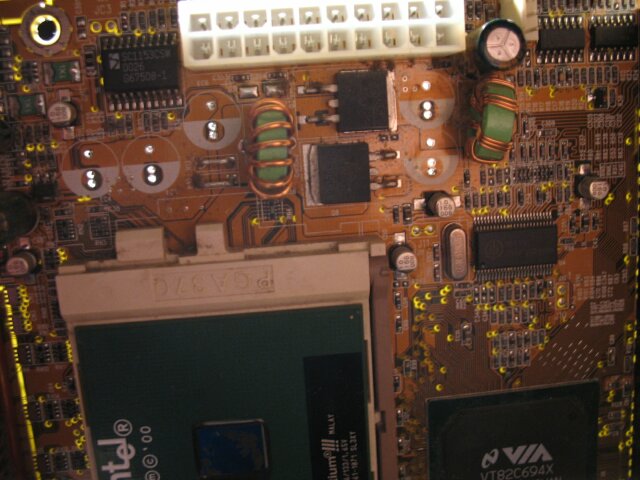

    Dunno if anyone else has really used them, but I've decided that they help.
    Here's what I'm using to work on motherboards, so that everyone can get angry at once
    1) Desoldering iron with built in bulb.
    2) 20/40 watt soldering iron (Radio Shack. May get replaced shortly)
    3) Vacuum solder sucker - yes, mechanical. Haven't had a problem yet, and have owned it for six years. (there are a couple of 'tricks' to it)
    4) leaded and unleaded solder.
    5) Stainless steel pick - one of the most annoying pieces of crap I've ever tried to use to repair motherboards. It goes quite nicely through a clean hole, but if you have solder in the hole, forget it. I don't know how you guys are doing it
    6) X-celite snips (Haven't nicked a board yet. Not sure how people are managing to do that)
    7) bent nose smooth pliers (jeweler's style)
    8) Jeweler's loupe (to see if I burn traces)
    9) infrared heat sensor.
    suggestions? flames?

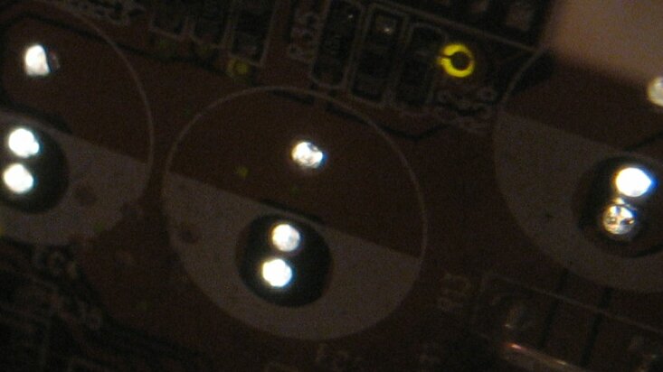

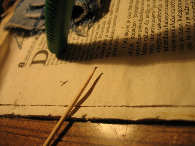

                              i've just cleaned 15 holes with one wooden toothpick.
                              worked better than steel needle.
                                Re: desoldering iron
                                and holes are surprisingly clean: no charcoal!
                                i guess i have high quality toothpicks!
                                      i bet it is...untill you try it.
                                      i was thinking about wood for some time now(as i wasn't satisfied with steel needle i was thinking about other materials...another material i thought about was aluminum wire), and i thought it probably won't work, it'll burn too quickly. but it doesn't, really.
                                      at least these toothpicks didn't(i would say they're melting much faster in my mouth..hehe).
                                      if somebody has trouble believing it, i can produce video-clip that proves it.
                                      buying used desoldering pump is kinda no starter for me because new pump is cheap.
                                      kinda like buying used..toothpicks...
                                      offcourse, if it was unused, i guess it's ok, and in that case only lack of experience can explain bgavin's disgust with it.
                                      i remember i felt simillar when i saw it for the first time.
                                      i was like "how the hell can you do anything usefull with this?".
                                      but you can.
                                      as op said
                                      "there are a couple of 'tricks' to it".
