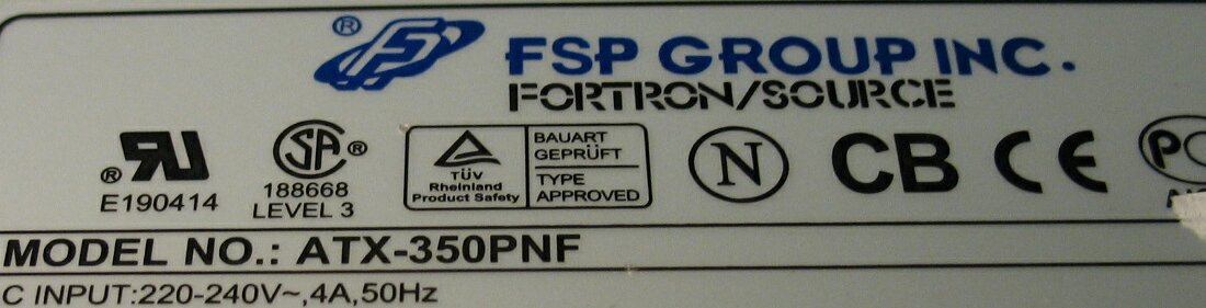

                      I had a few words with PC Power & Cooling about them touting all premium grade components, only to find OST, etc, in their PSUs.
                      I gave up on them entirely. Far to expensive for what you don't get. Like Antec, the most brilliant design is totally wasted when implemented with crappy or marginal components.
                      I have much better luck with Sparkle ATX350-PN supplies. They have a 120mm fan, cool very well, and seem to be populated with mid-grade caps. At $33 USD (newegg) they are priced right. I rotate PSUs in my client machines every 3 years. Same as disk drives.
                      this sparkle ( http://www.newegg.com/Product/ShowIm...W+Power+Supply ) seems fairly simillar(better to say 'the same') as fortrons i picked
                      (see attached pic).
                      all teapo and ost inside.
                      (i'll soon post inside pix in a new thread).

                        FSP (Fortron-Sparkle) has been using Teapo, OST, Jamicon, etc. for a while. They're mid-grade caps, and it won't hurt to recap them at the outset with Jap caps from the recommended list. Even otherwise, FSP designs are fairly conservative and the caps don't fail that quickly.
                          ...And secondary caps from CapXon too...

                            The Sparkle is an easy recap, and priced right. The 120mm fan does keep the internals quite well cooled.
                            The next step up for good caps is the Seasonic/Corsair. The price is more than twice the Sparkle. If you figure labor and materials for recapping the Sparkle, the price is about the same. The more expensive PSU are also active PFC.
