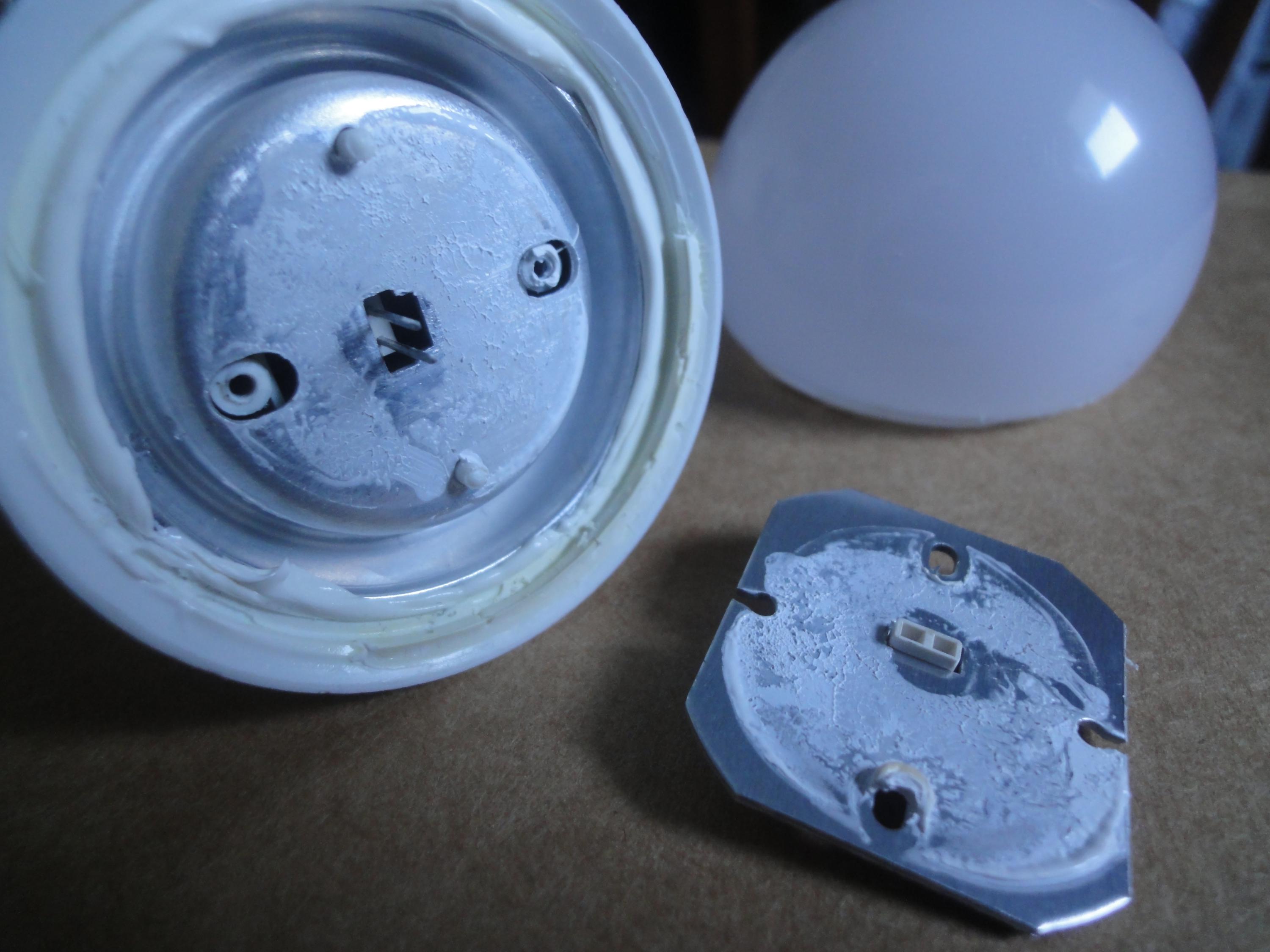

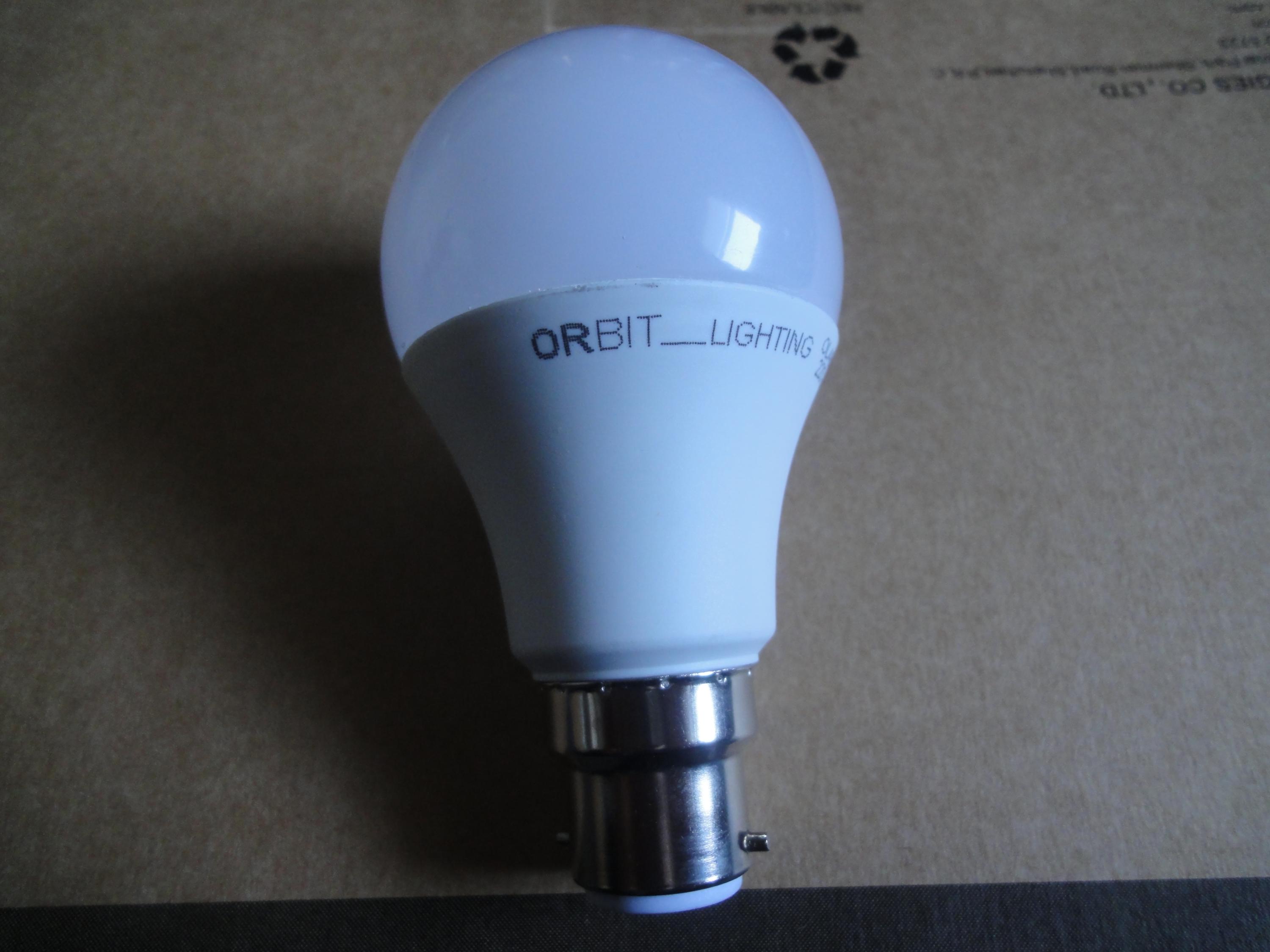

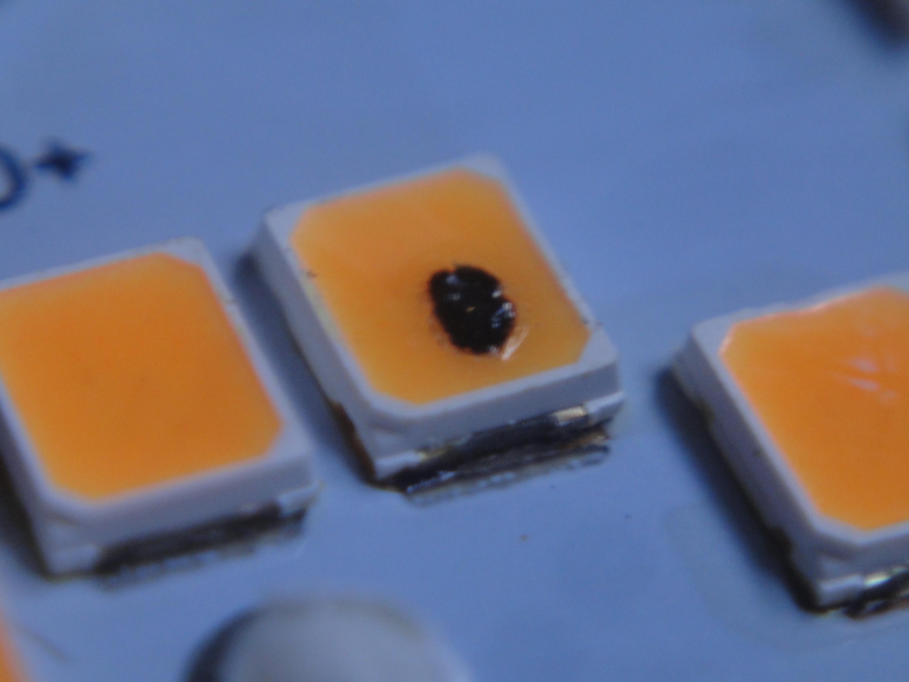

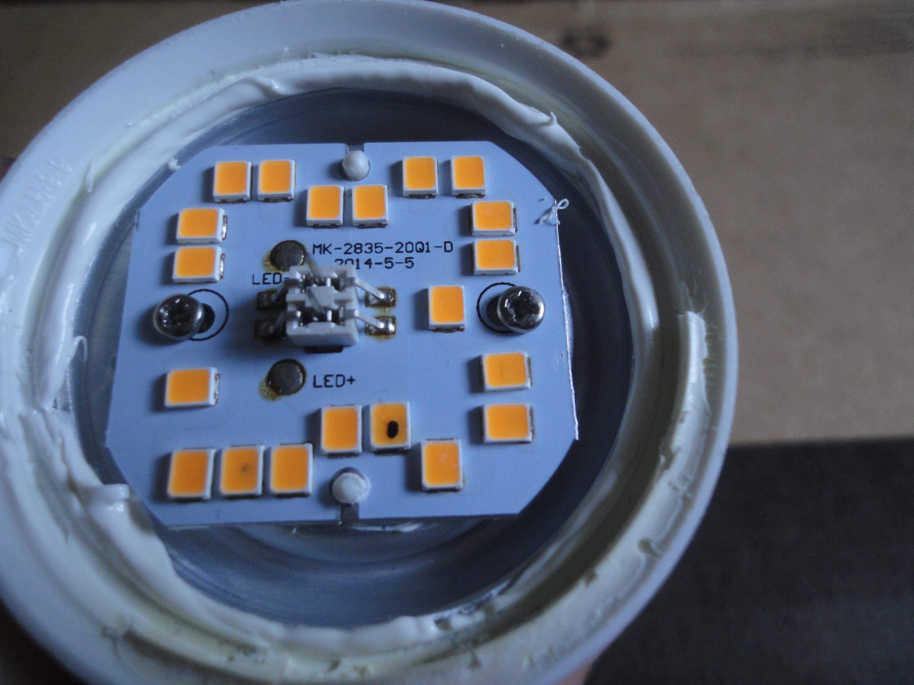

    Had this LED 'bulb' in a beside lamp because incandescent and CFLs were too hot in there. Cost $15 and claims to last 20 years (Yeah, right!)
    Worked great and ran cool for a couple of months, then started flickering sometimes, and eventually died. Funny how a 90 cent incandescent bulb lasts longer than CFLs and LEDs both costing $15.

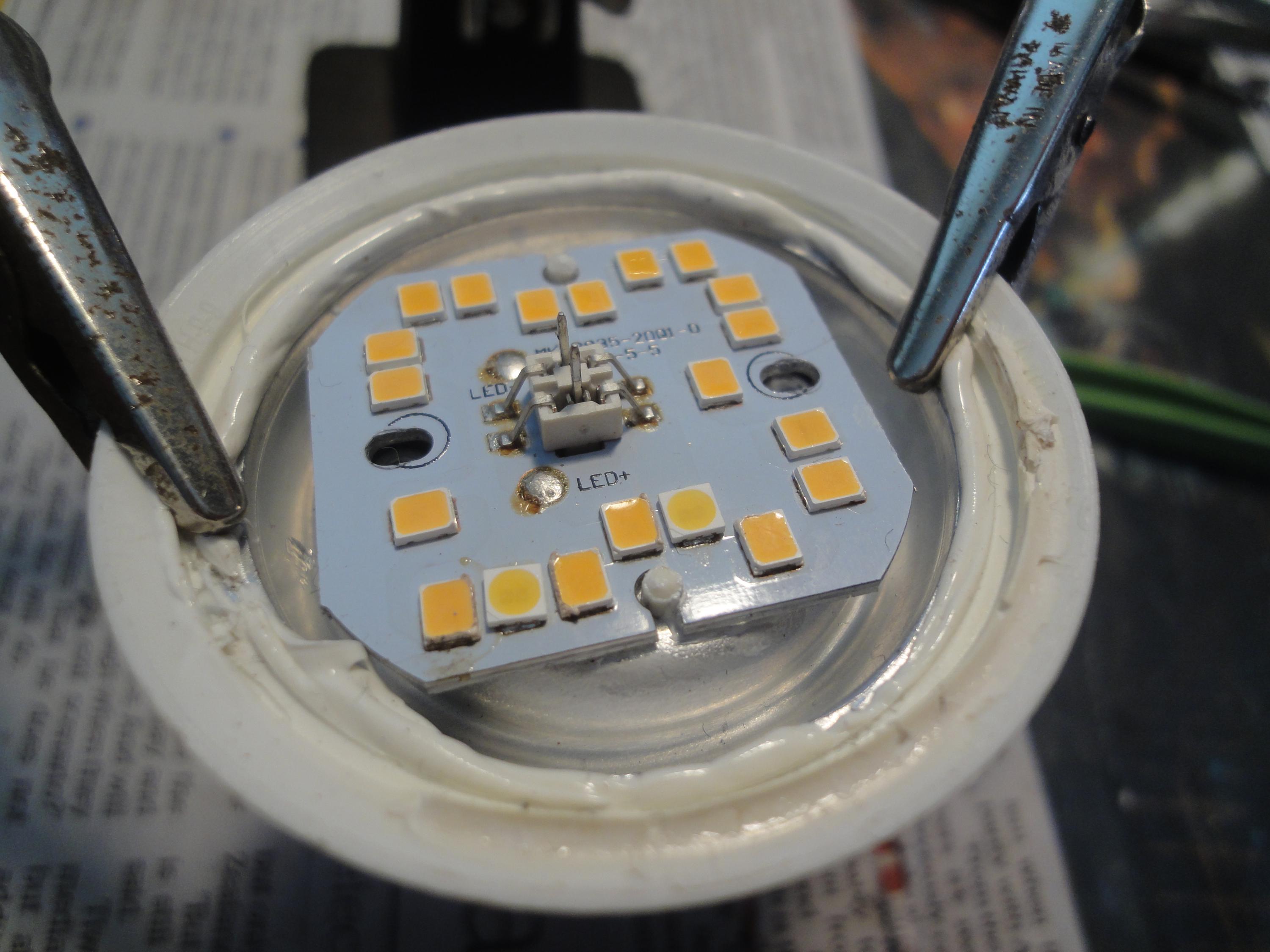

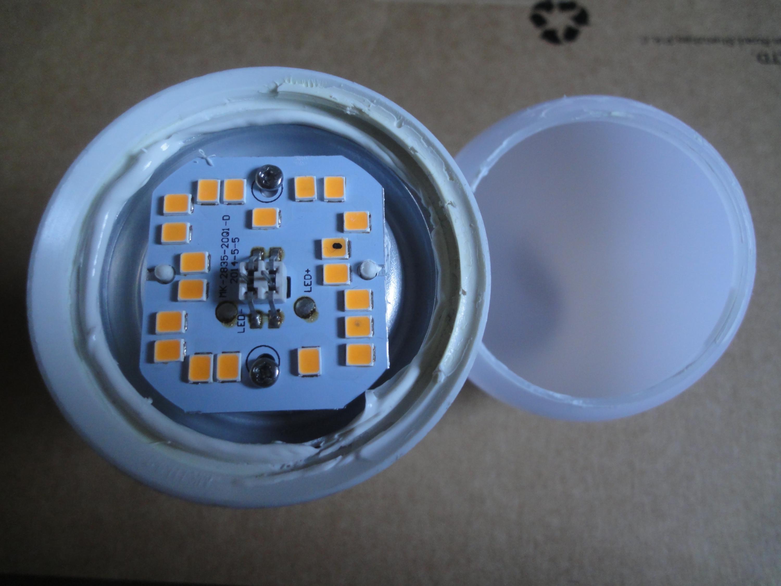

    I found that the light diffuser can just pop straight off, which reveals a small PCB with 20 SMD LEDs on it underneath. The PCB has a metal backing and is screwed to a metal heatsink underneath that. Below the heatsink is the driver circuitry, which outputs 120v DC unloaded. I didn't bother trying to get into that since it works and I didn't want to cause damage (at this point).
    It's clear from just looking what the problem is! Two of the SMD LEDs have burnt out.
    What's interesting is that assuming a working voltage of 120v DC for the 20-LED string, they have a 6v forward voltage. I haven't heard of any this high but I suppose they have two LEDs in series on the same die\in the same package. Makes sense going by the two little bumps I can see though the yellow coating, anyway.
    I removed the dead LEDs and measured them at about 3x2.5mm which doesn't correspond to any known LED package I know of.
    The closest I found were these: http://lumis-led.en.made-in-china.co...-LED-0-5W.html but it's not really worth it.
    If anyone knows a good source for new LEDs, I might give repair a try for a laugh. Otherwise, I'll probably just cut the end off and see how they built the LED driver, maybe re-use it and the rest of the working LEDs for something else.

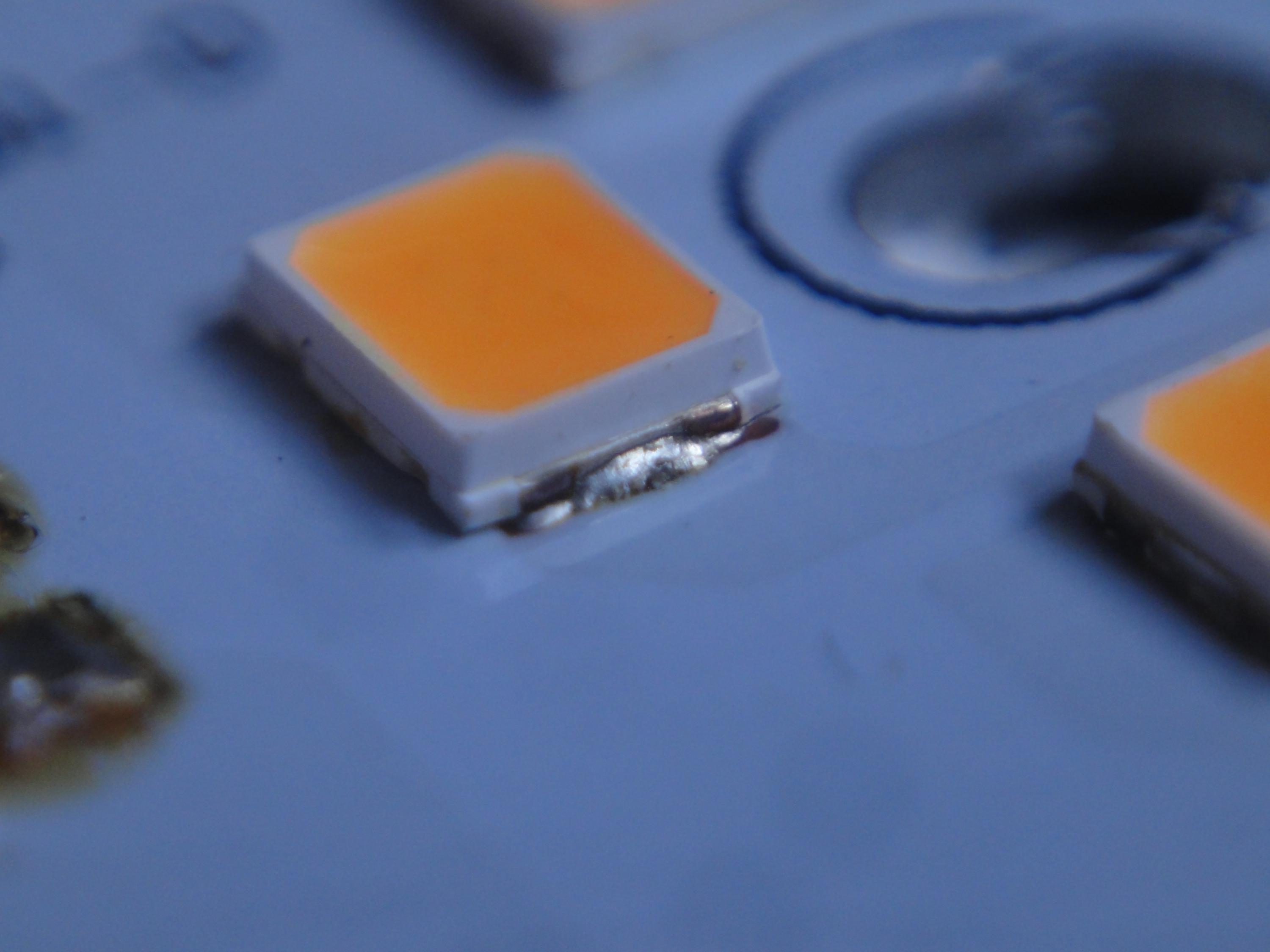

    desolder a bad one and see if there is anyhing printed / embossed on it.
    good luck btw, the leds are soldered on an aluminium plate coated in an insulating layer followed by the copper tracks usually.
    so you need a lot of heat
    that pcb says 2835
    are the leds 2.8 x 3.5mm?
    because if they are:
    http://www.rapidonline.com/Electroni...ount-LEDs/3528

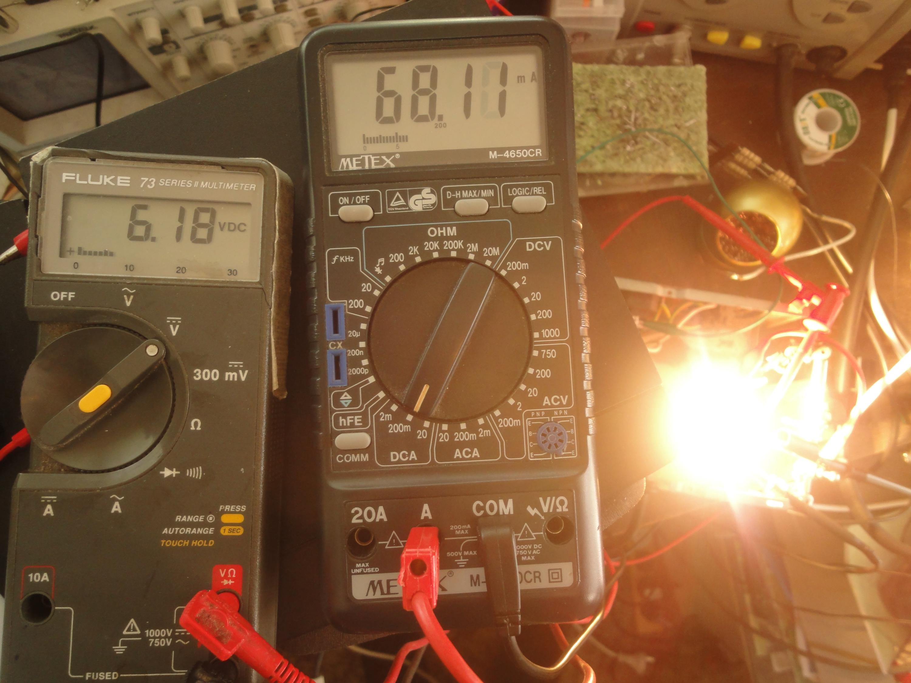

      What is the measured fwd V on a good led?

          Nothing printed on them but it looks like you're right about the size. I removed the bad ones (Hot air tool at 450C made short work of them, also I unscrewed the PCB from the lower heatsink first). With vernier callipers they measure 3.5x2.9mm.
          The lamp has 10 Watt printed on it. I guess each LED is 0.5 Watt.

          I don't know. How would I measure that? Remove a good one and hook it up to an adjustable supply and measure Vf when it lights up?
          Or could I short the pads of the two I removed and measure voltage across one of the others? I assume the supply is current limited as there are no obvious resistors. Or would having two removed and their pads shorted cause a problem?

            If the leds are wired in series you don't have to remove one from the board to test it. The easiest way to do it would be with a transistor/diode tester.

                I rechecked the layout and it's actually 2 strings of 10 LEDs in parallel, which is interesting.
                I jumped the pads of one bad one and put an ammeter across the other.
                I got 6.18v across a good LED, and 68.11mA through one string. Didn't leave it plugged in very long in case they were overloaded but the readings seem sensible enough, I think? Works out about 0.42 Watts per LED.
                Diode test on meter showed nothing even for a good one. Which makes sense if they are 6v, since my meter's diode test function only outputs about 4v maximum.

                        I'm wondering about the failure mechanism of this lamp. AISI, if one of the LED strings goes open, then the remaining string will carry twice its normal current, resulting in its early death. In this second string, one LED would fail while the surviving LEDs would be stressed. ISTM that you would need to ensure that each string remains balanced after any repair or modification.
                        BTW I'm presuming that the lamp failed with both strings open, and that the array is powered from a regulated current source.

                          Re: LED lightbulb - blown LEDs
                          I assume it's a constant current source, but I haven't looked at the driver circuit.
                          It was 120vDC unloaded, which would be 6v per LED if they were all in series, but they're not.. so that would be 12v each but they're not, from what I measured. I forgot to measure the loaded voltage, but I assume it's around 60v.
                          The lamp was flickering dim\bright occasionally before it died completely. Both strings must have blown an LED about the same time though. I don't know for certain, it wasn't in my own bedroom.
                          Since 1 LED blew in each string, I assume replacing with a new LED will keep it balanced even if the new LEDs are not the same as the old ones. I don't know how I could make sure the remaining string isn't overloaded if another LED blew though.

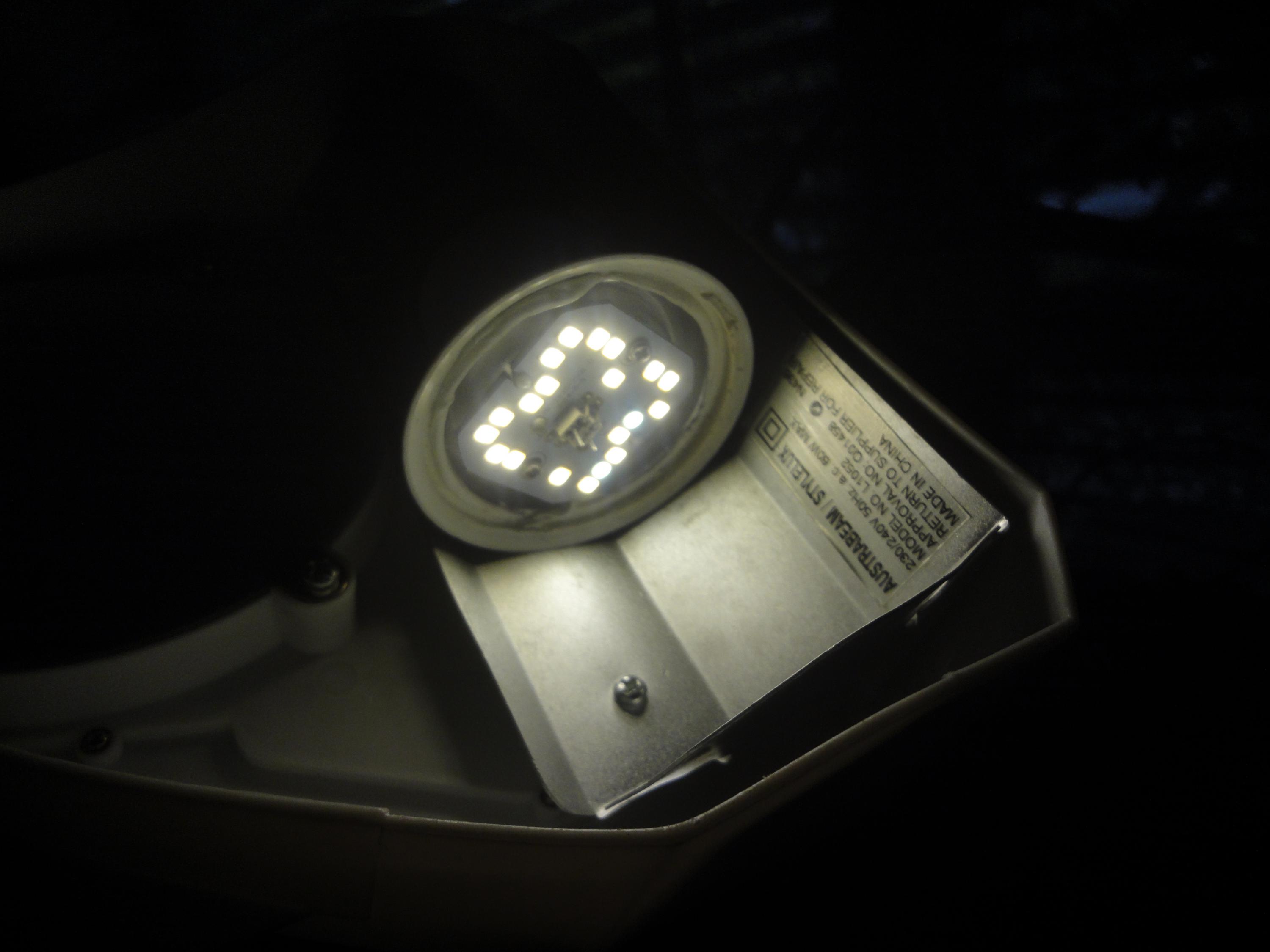

                            Well, I got the LEDs I linked to from RS and installed 2 new ones. It lives again! Ran it for about 3 hours the other day in my desk light and it worked well.
                            Yeah, the old LEDs got a bit melted on the sides... that was during my removal of the bad ones originally, I must have used too much heat.
                            Now I just have to find something to glue that diffuser\cover back on that won't be too hard to get off again if needed. Any ideas?
