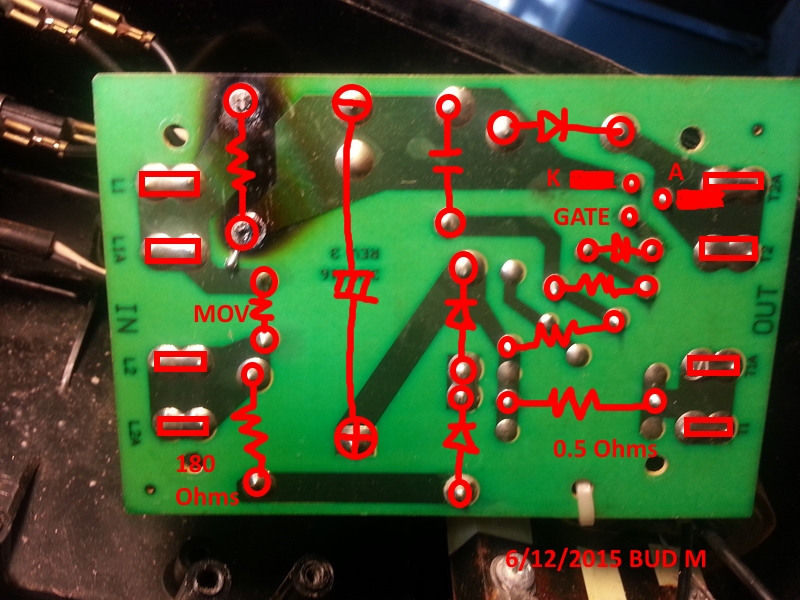

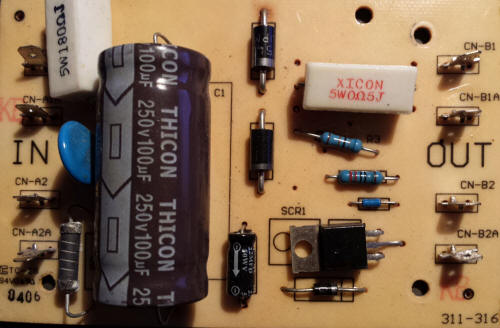

    Anyway I just have a quick question that I hope somebody can help me with. Below is a picture of the circuit board from an Electric fence energizer. The burn spot had, at one time, the oblong white piece that's just sitting above the two black wires to the right, it is blank with no markings or numbers at all. I gotta get this thing fixed before dark or my horses and 2 cows are gonna figure out its not on and mutiny will likely ensue!
    If In got to replace it , I need to know with what.
    It is a "SS-1000 Super-Shock" made by "Fi-Shock inc."
    This is the back of the board
    Thank you, Pesti

        OK FINALLY GOT THIS FIGURED OUT, LOL
        Here's the pic I didn't get posted...and yes two got out, man they learn fast...
        [/URL][/IMG]

          Re: Help, with fence energizer, I got 2 hrs left! Pictures FINALLY
          And Here's the back , I just need to know what to replace it with
          [/URL][/IMG]
          Thank you!

            is it by any chance the resistor floating on top of the transformer?

              All I can find is another picture of the same 311-316 Printed Circuit Board for SS-1000, SS-4000 & SACOXX fence charger.
              The part would not have cooked unless another part, like the SCR/diode/cap is shorted.
              It looks like a resistor, and there is another, so my guess is 180R 5W as part of a pair. Why is there a loose resistor on top of the transformer?

                I put that there, Thats the part that burned off the board, but it has no markings at all. Is there anyway to fix this?

                  did you measure the resistance of the loose resistor?
                    Yes I did ,there was none

                      We're stuck unless we know the resistor's value.
                      It may have burned up because of another part shorting, or you have a cooked cow somewhere... I would test the other parts.

                        You should check to see the resistance between Anode and the Cathode of the SCR.
                          More likely to be 180 Ohms.
