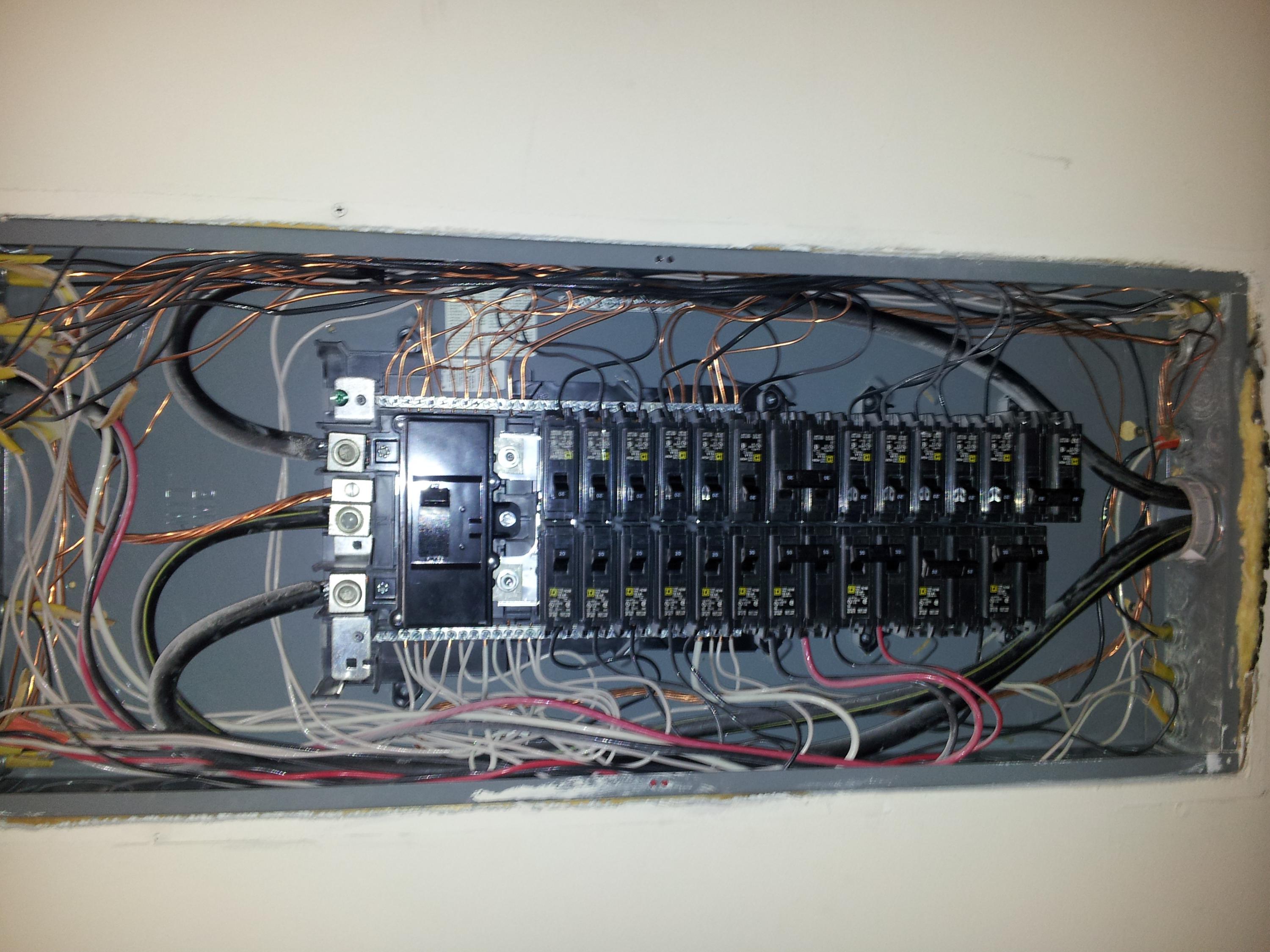

                          I know every single outlet in this house is 120V. Let me take a picture of the breaker box. I'm sorry if they're sideways.
                          -- Law of Expanding Memory: Applications Will Also Expand Until RAM Is Full

                            So essentially, those big wires in the first picture are the 240VAC's and the breaker box somehow splits them? I double checked with my dad, and with his, they didn't run a special wire from the pole. Just from the breaker box, thus confirming your suspicions. My dad says all the wire in our house, except for the washer / dryer is 12-2 (whatever that means). I'm afraid if I had all my equipment running from one power strip, it might trip the breaker. I wonder what the maximum size breaker I can have with 12-2 wire. Most of the breakers in our box are 20A. A few are 30A and a few are 50A. Usually, the 30A and 50A are tied together with another breaker. You know, you flip one and it automatically flips another. I'm thinking those 50A ones are the washer / dryer (which is probably 240V, right?)

                              Okay, another update, the dryer is 240V, the washer is 120V, the fridge is 120V, the ACs are 120V.

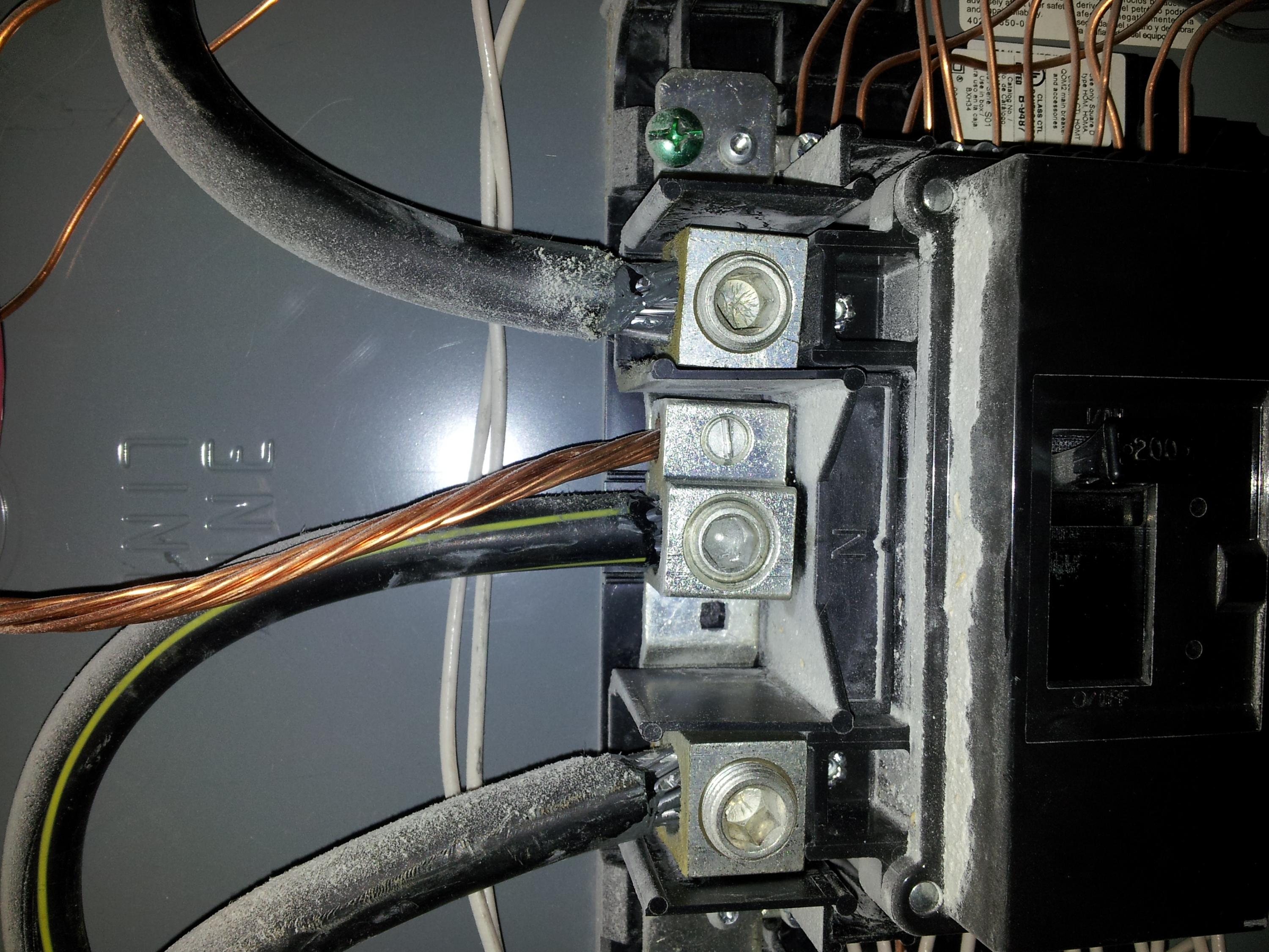

                                • 31278
                                Re: Whole house surge protection.
                                you have some pretty lax safety regulations there,
                                in Europe those incoming terminals would have to have TWO grubscrews to hold the wire in incase one works loose.
                                it also looks like you have aluminium wire - we had that but it's being phased out because of the losses.
                                  It looks like one of the incoming Phase wire (top) got hot.
                                  https://www.badcaps.net/forum/attach...0&d=1431030372
                                  Houses in the US are fed by 120/240VAC SPLIT-PHASE (120-0-120)
                                      Looks to me like it didn't, it seems that there was some sort of anti-oxidant grease put on there, which sort of makes it look like it has been melted.
                                        could be worth checking it's tight with an insulated allen key or hex-bit though.
