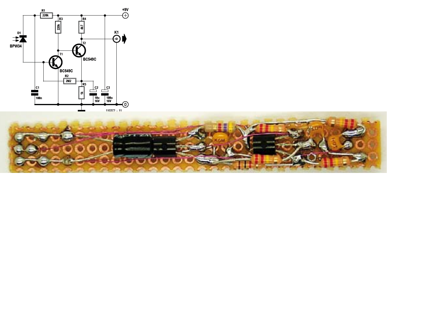

        Hi tried to attach a picture showing the circuit by B Kainka in Elektor.
        If you look at the layout the circuit is different ,some of the resistors are of a different value and it seems that the cathode of the diode is ac coupled to the amplifier.
        Thinking about it ,my BFY55 transistor is two diodes one forward biased and one reverse biased ( base to emitter) so perhaps that is making a difference.
        Also circuits I have seen do have a coupling capacitor to the amplifier .
        Barry Wilkins
          Re: BPW34 photodiode radiation detector
          You are right that the circuit board does not have parts installed per diagram. I do not see the PIN Diode BPW34 on the board.
          https://cdn.badcaps-static.com/pdfs/...8098d5cb9f.pdf
          http://www.emant.com/324003.page
          Using it for Geiger counter is another story.
          See example circuit (SHARP) how it is used.
            Hi, you cant see the PIN diode it is on the other side of the stripboard.
            Ac coupling the diode has stopped the circuit breaking into oscillation,all I need now is decent source of gamma radiation.

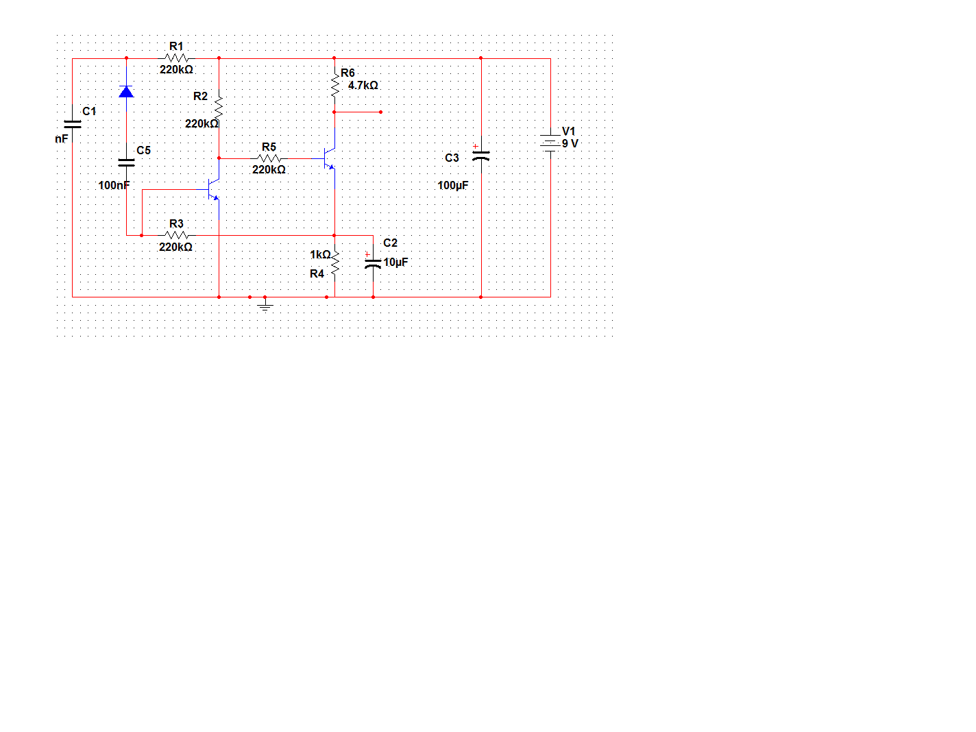

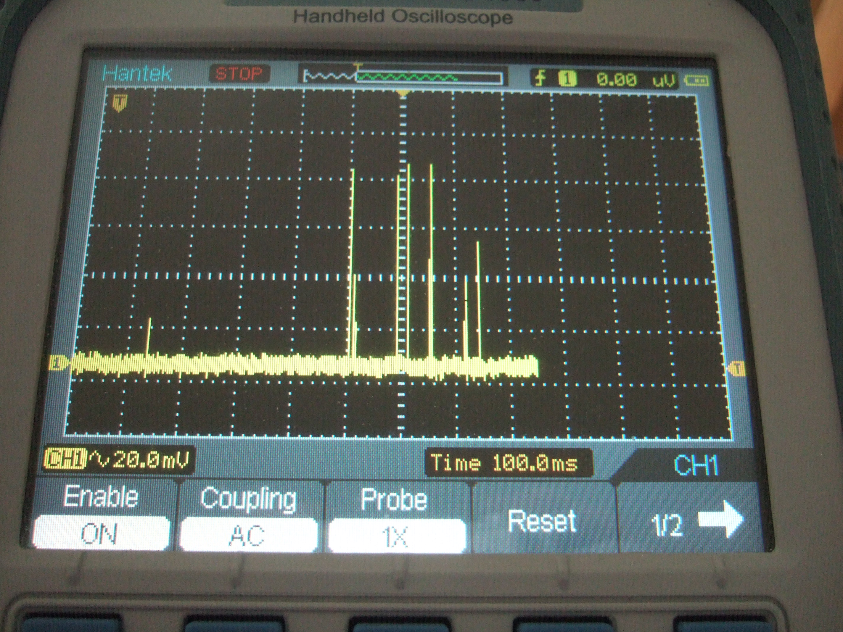

                              Attached a couple of pictures
                              The correct circuit and the results of Am241 using a naked BFY 55 transistor
                              The BPW34 diode I bought just dont work ?
                              Barry
