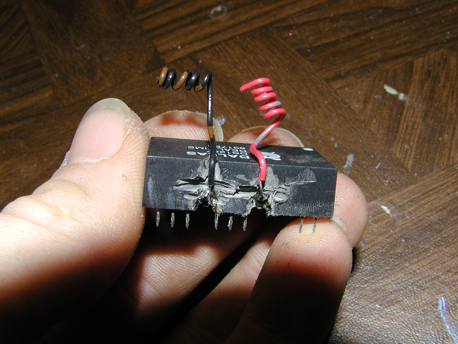

    Those stupid dallas chips that were put in everything from SGI's to IBM computers.
    My Model 30 greeted me the other day to a 161 and 163 error that could not be corrected and indicating that the dallas chip had gone south. Then today I managed to get hold of a handful of regular (but dead) dallas chips.

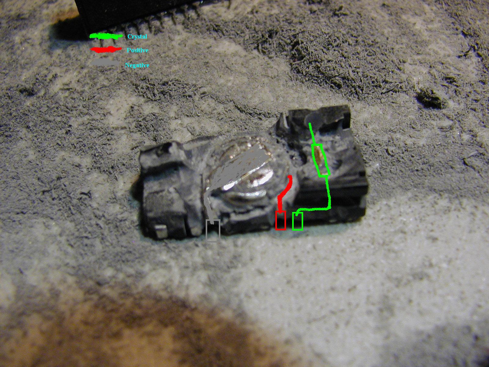

    I then thought about the battery hack for sun computers and got an idea. Please refer to the photos below for even more detail.

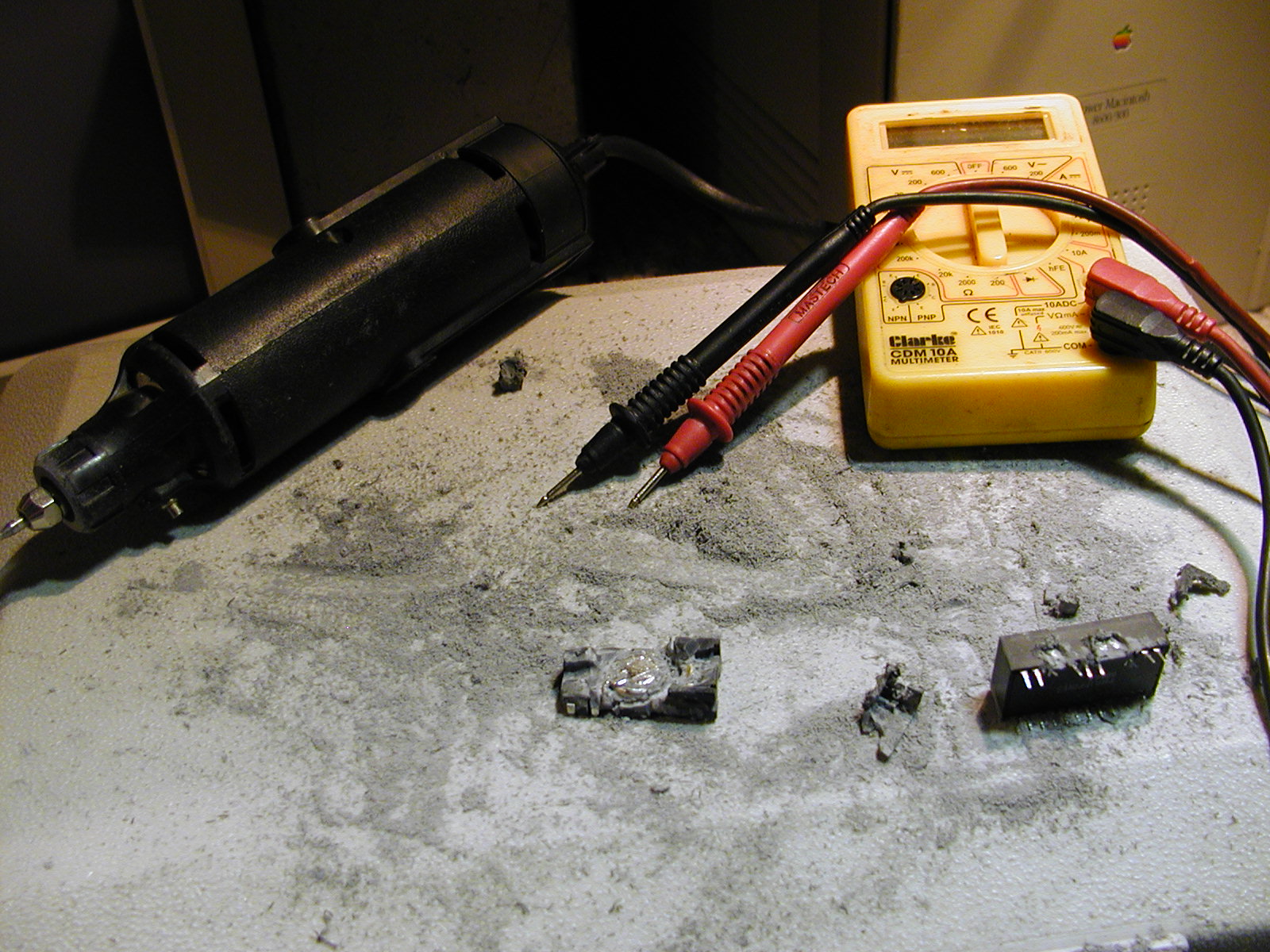

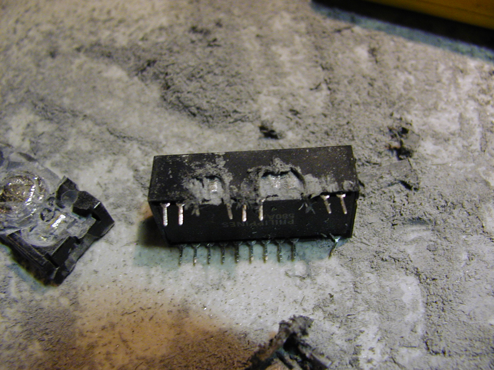

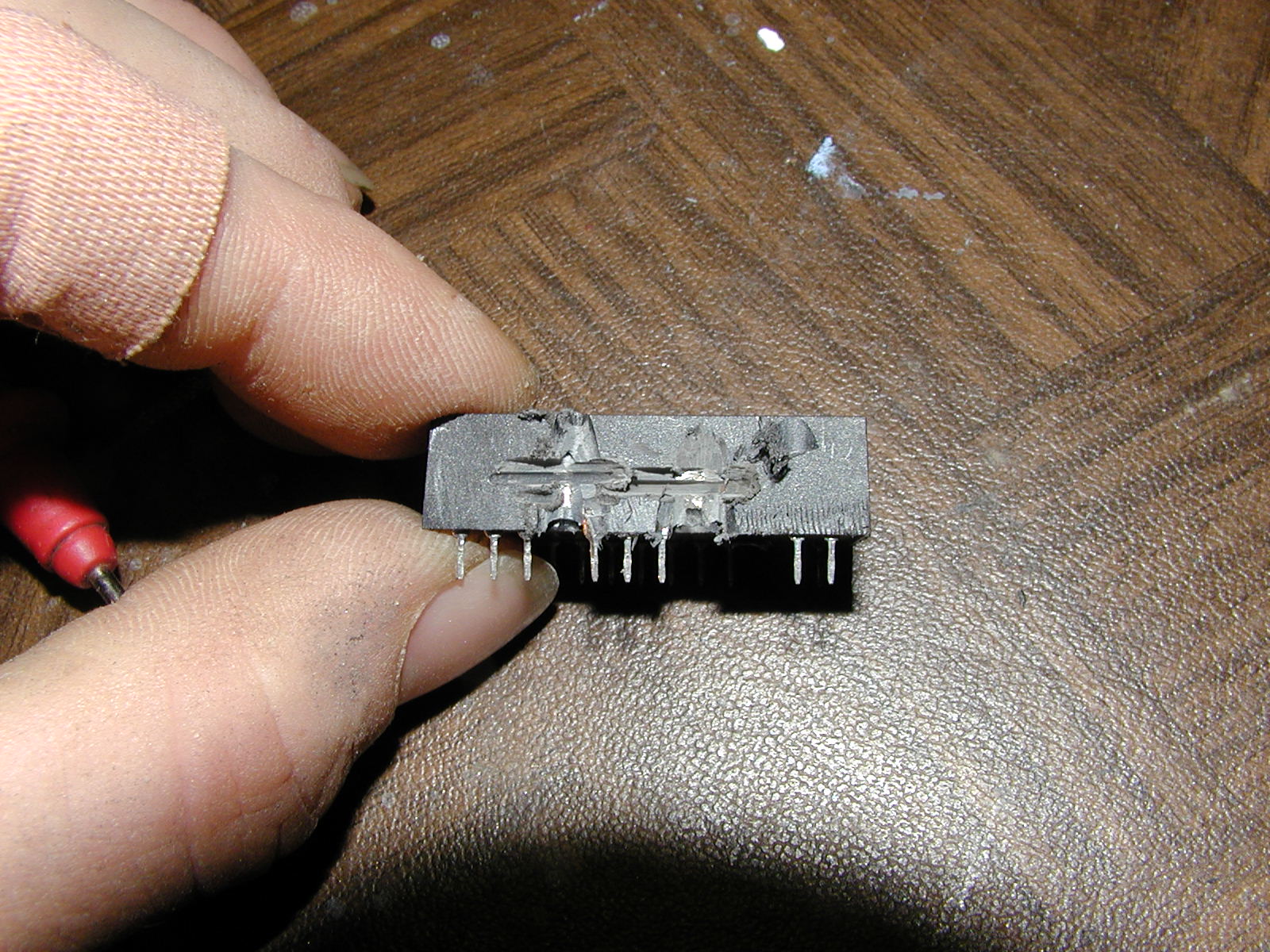

    I grabbed one unlucky subject and with my dremel set out to see what was under the hood. It took a while but I first found the crystal followed by the battery in the middle and then finally the battery terminals themselves.

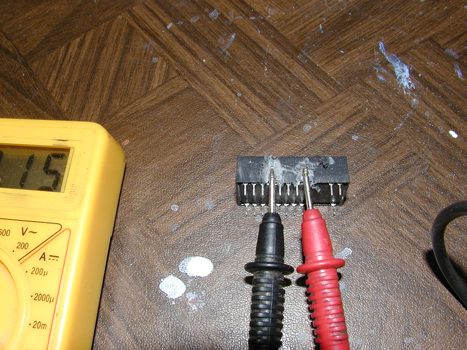

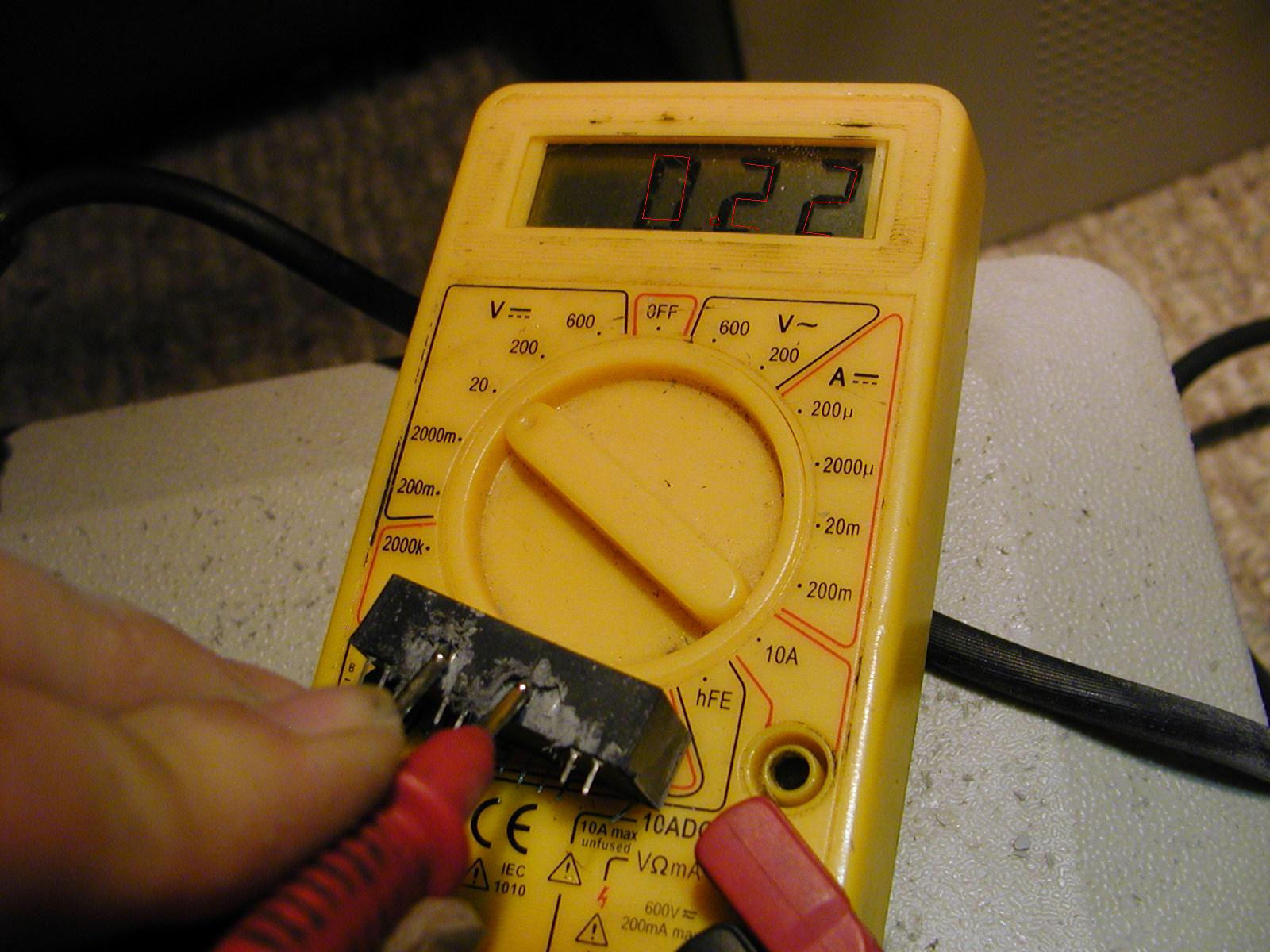

    Going with my volt meter I determined that the battery was indeed dead.

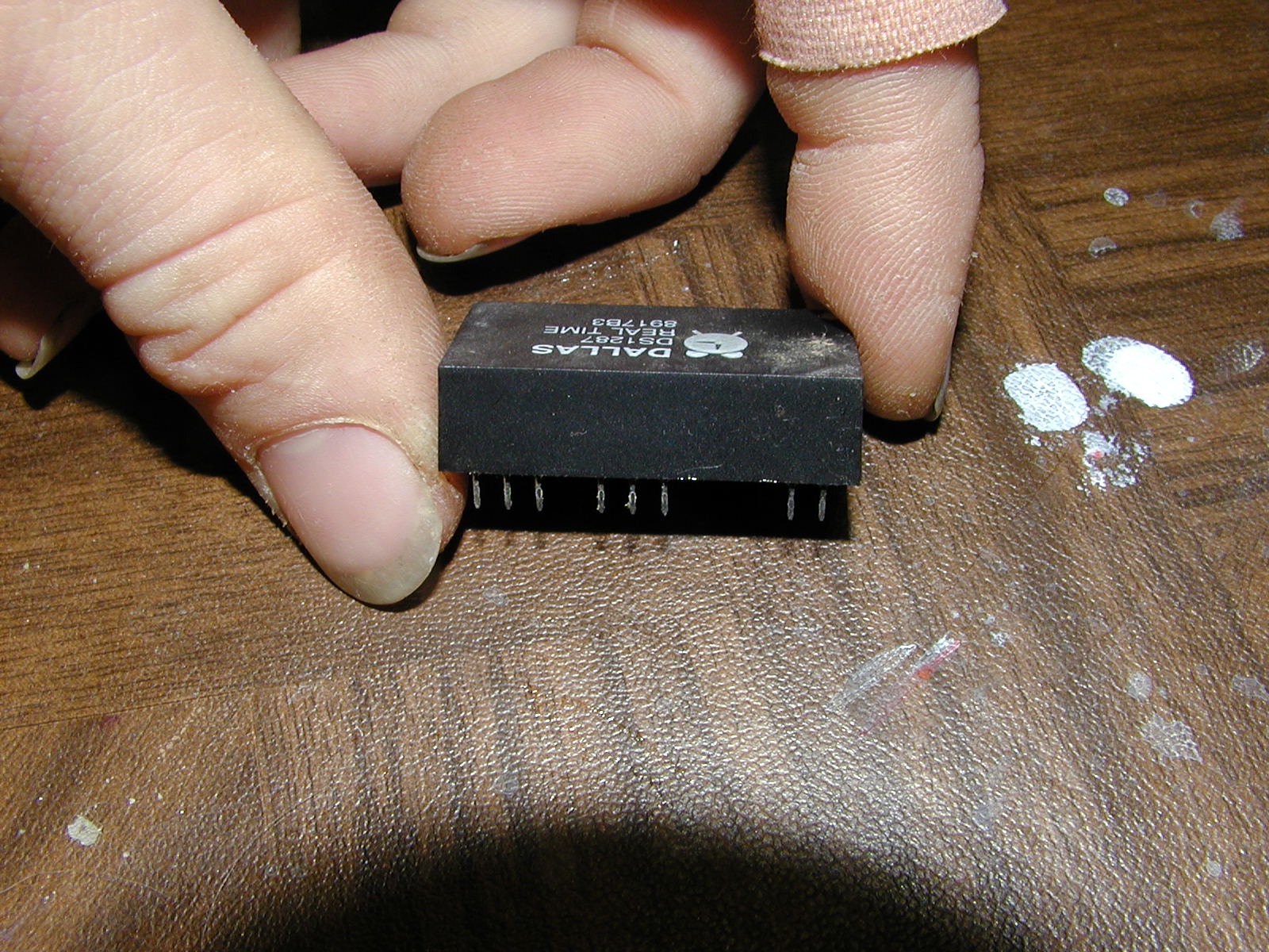

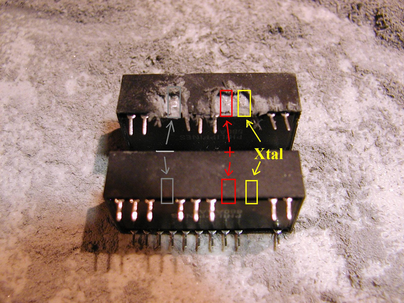

    now knowing where the battery terminals were, I grabbed another chip (of a different model) and with the dremel dug out a cavity to the two battery terminals. A quick check with the meter indeed proved it was the battery terminals.
    My theory is that if I were to figure out how to cut the battery leads (not soldered on like in a sun) and install a regular CMOS battery the chip would be as good as new.
    Do you think it's possible? I can see at least four computers I own that would need this.
    On another note. The powder made during the drilling closely resembles moon dust.

    Great work - you're kinda persistent, aren't you?
    Anyway, Lithium batteriess die into a low-impedance (almost short state), so you can't parallel another battery with a dead battery - you have to cut one of the leads (either +ve or -ve) very carefully, to isolate the dead battery before soldering another battery into the circuit. Perhaps a Dremel drill or cutting wheel could do the trick. Are both battery terminals passed through to the pins of the IC? That simplifies the new battery installation a bit - it can be anywhere in the system and connected by a pair of wires to the corresponding pads on the mobo.

        I am incredibly persistent and I was also bored.
        By the looks of it, They just bent two pins the opposite direction and...
        Wait, that means they used solder.
        Well in that case I just desolder the leads and wire up a new coin battery.
        My SS 1+ is happy with a 3V cell. I wonder if it's the same here?
        I think someone would make a replacement circuit to plug in the socket, using discrete componenets and a standard battery.
        It won't work, the battery pins are not visible from the outside, you have to dig to find them.

                Yeah, I was also thinking of my Indy and Indigo when I started working on this project. I presume their batteries will be going south soon too.
                All my older 486 and 386 systems all are equipped with an external battery connector
                I doubt you will see one though in a Sun or SGI system or we wouldn't have this problem. My three IBM systems don't have these connectors.
                making a functional replacement for the whole chip, except not sealed in epoxy.
                First off it would be expensive (some of the Dallas chips are no longer made) and don't forget about that crystal. I could just see my way being a little easier.
                Second, The battery seems to only be connected to the chip and lacks the pins needed to plug into the socket.
                  This sucks - it means that you need to access both leads, cut one carefully and still have enough metal surface to be able to solder in two new leads. All of this without damaging the chip and the plastic too much.
                  Maybe the approach is to drill two holes - one to cut the battery lead, and the other just reaching the surface of the lead on the chip side. Fill a drop of solder into this hole to make contact with the lead as well as bring it to the surface of the package - the rest is just a matter of technique.

                                  By the way, I finished my hack (which it seems has already been done. Rats.)
                                  I didn't find a way to desolder the battery so I used a disc attachment for my dremel to cut the lead in half and carry on from there.
