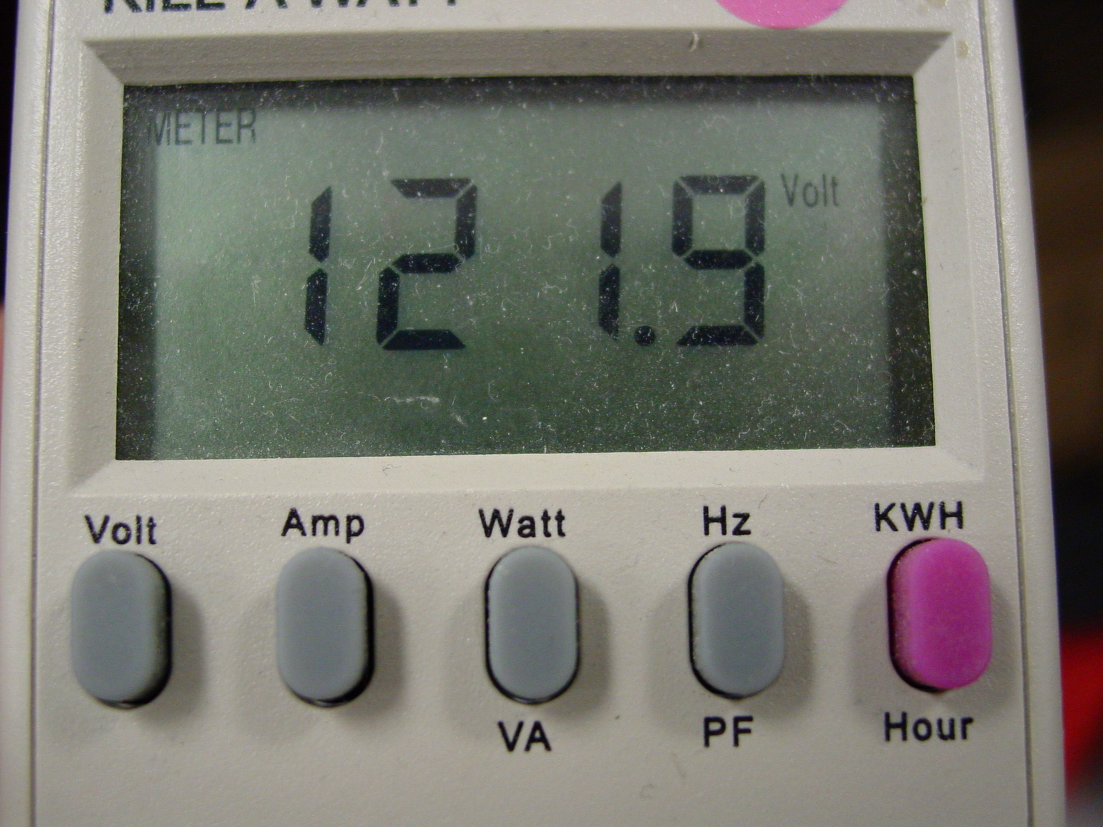

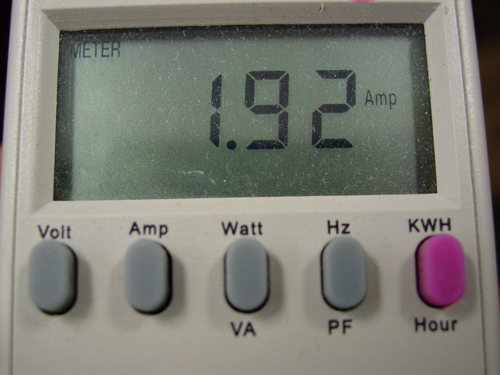

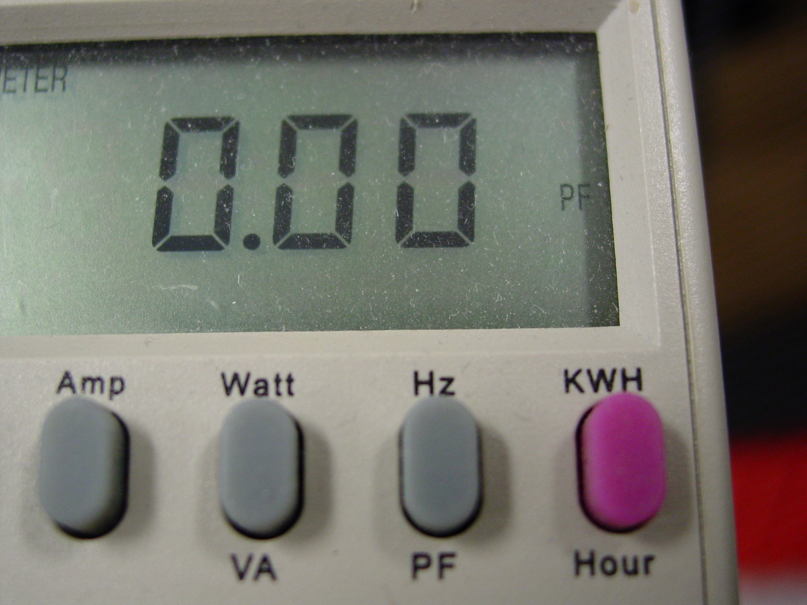

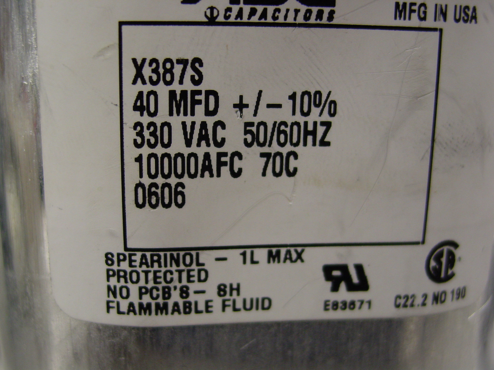

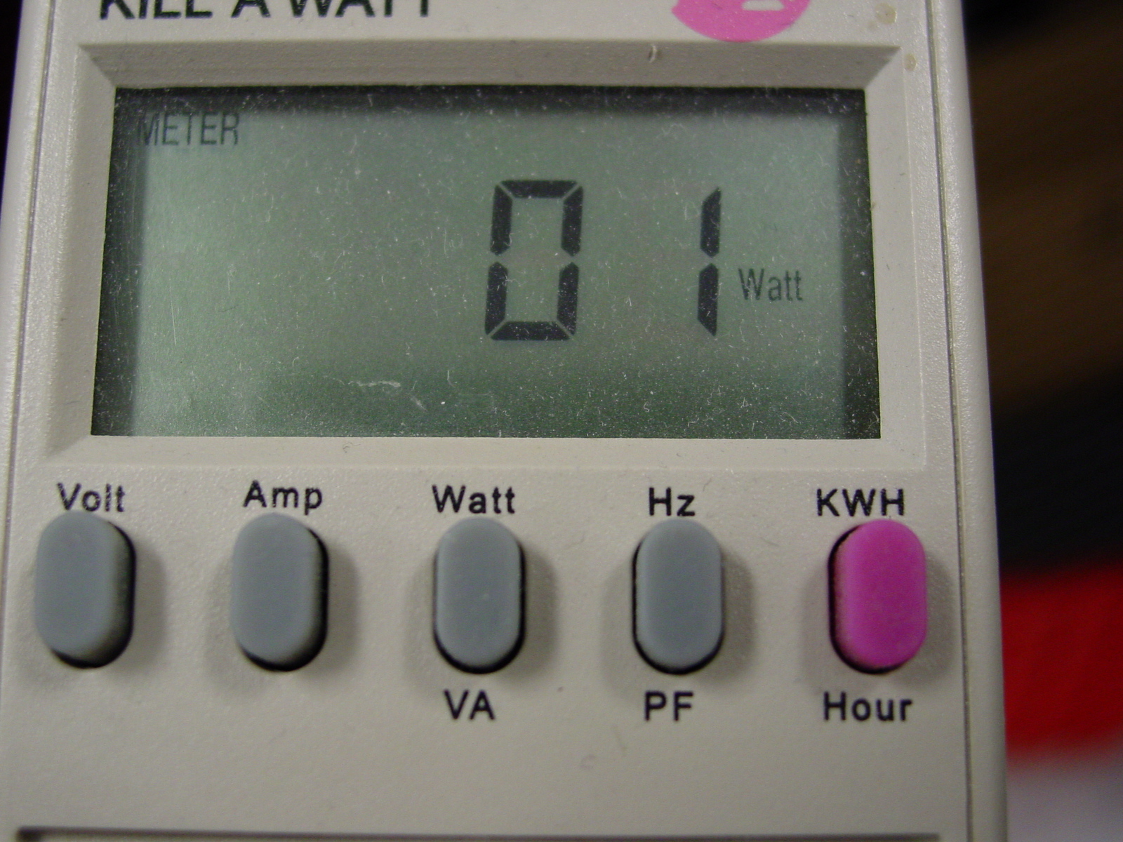

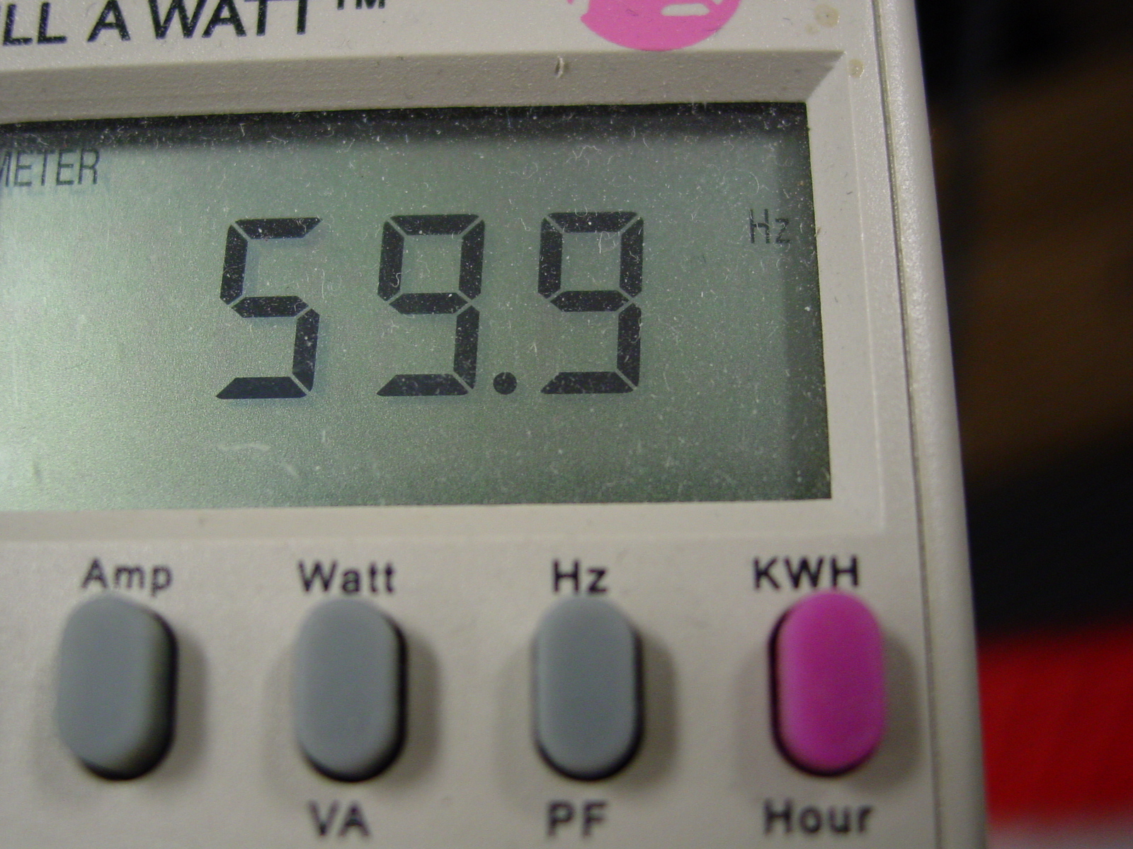

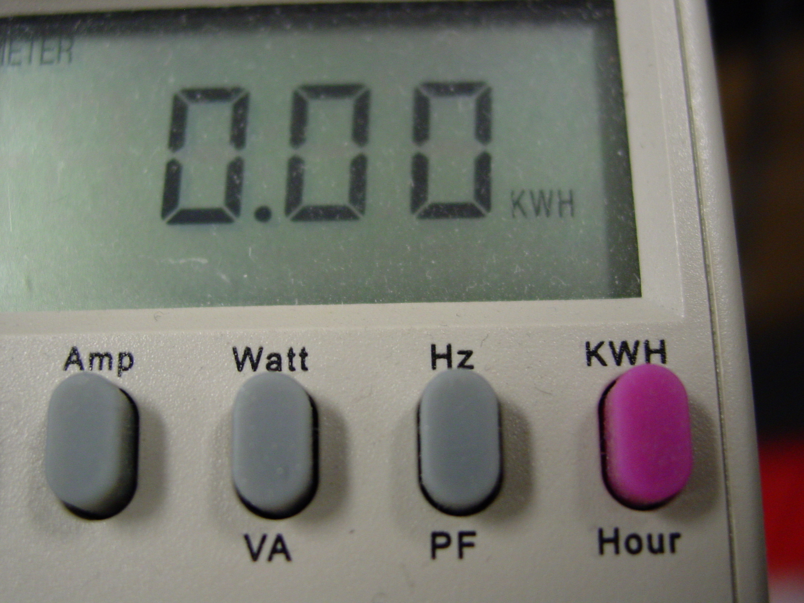

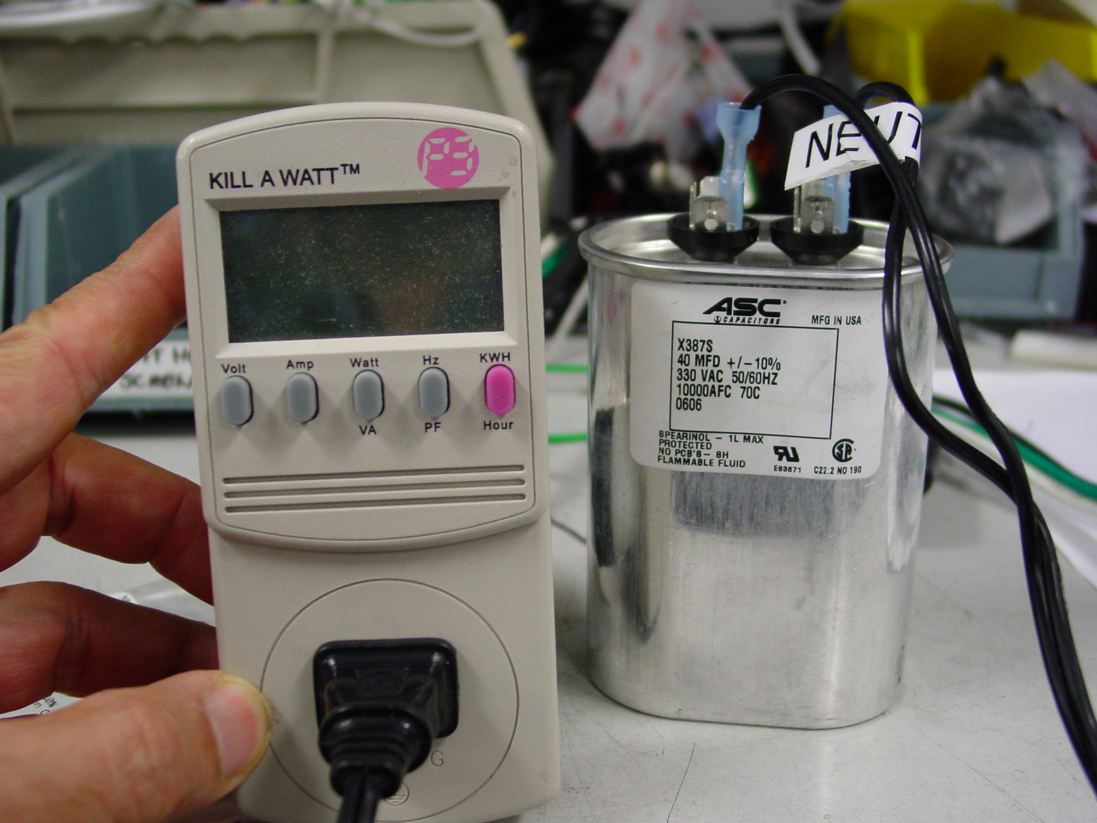

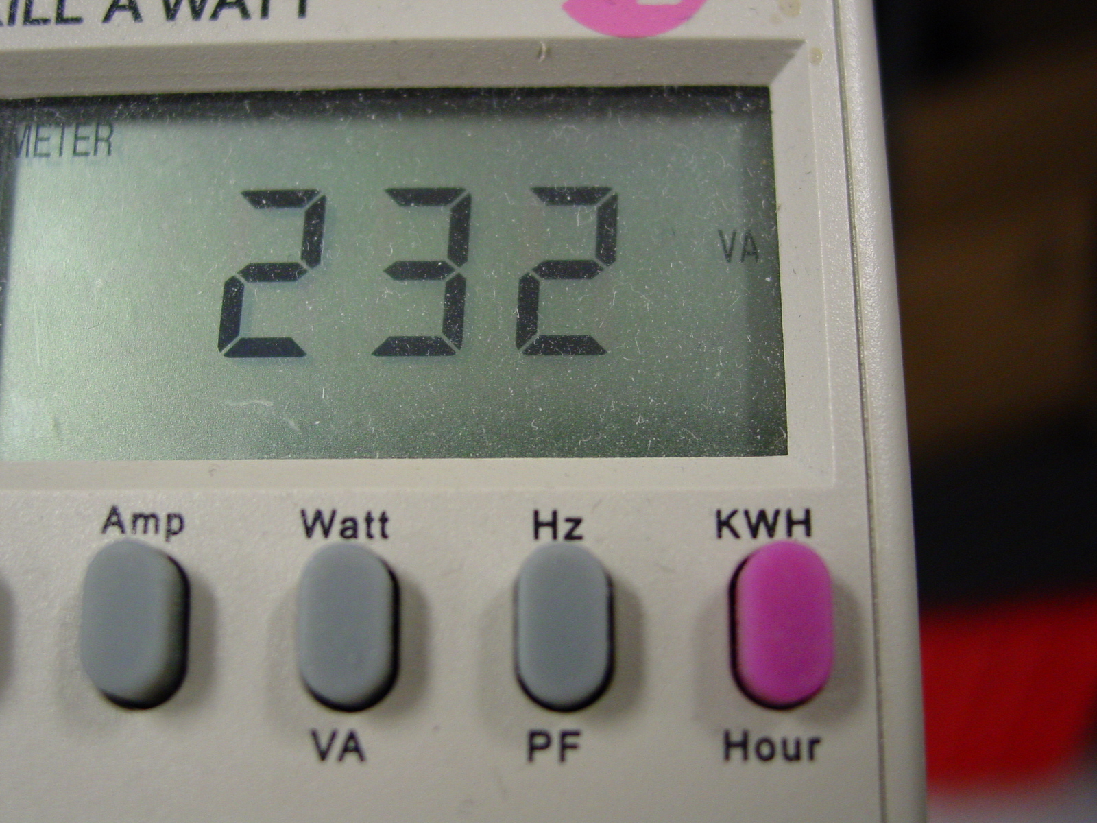

    The CAP across the AC line before switch will show current draw but will show close to 0 power (W) due to capacitive reactance.
    What readings do you get form both meters if you check the Wattage, Current, PF, VA using light bulb as the load?
    The meter that shows 28W, what does it show on VA and the current draw? AC line filter cap will not cause the meter to show 28W.
