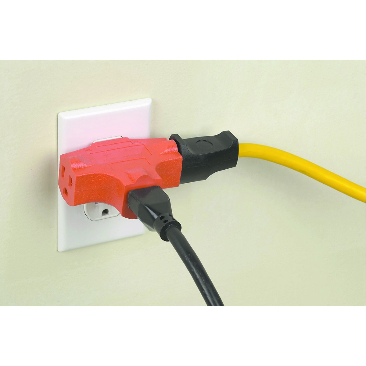

    If I were to try to solve this I think I would look for some clear male ends and solder a small neon with a resistor across hot and neutral. It would need replaced periodically as they dont last forever. If you couldnt find clear I suppose you could also drill a 5mm hole in the side of a opaque plug and fit an led (would also need a current limiting resistor).
    If you want to go really simple a 3 way with a night light plugged in at the block heater would work

      Thanks, Caleb. Could you elaborate on the 3 way idea? Thanks!

        just a standard 3 way plug with a mini night light into one plug, and the core heater into the other
        pictures not mine but this should give you the basic idea

          I might be able to make that work, if the light is at the male end at the plug in stand. (no room in the block heater socket) that would still show us if a GFCI has tripped. Maybe a plexiglass window in the plug in stand. Thanks, Caleb!

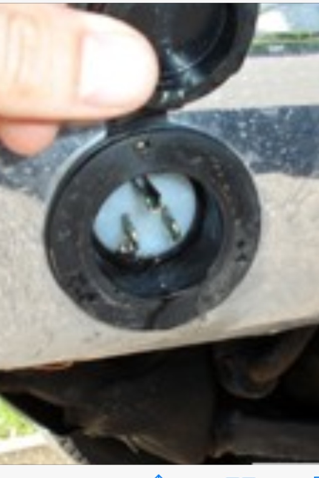

            Yours dont have a cord hanging out? My diesel has about a foot of cord. If you really want it at the bus you could make up a shorty cord with 1 male and two female ends using standard plug end and extension cording.
            Liberating magic smoke one part at a time
            • Poor Flick
              Of sound mind
              • Jun 2014
              • 3167
              • U.S.S.A. The flophouse of the world.
              Re: 110v inductive pickup type of light
              Caleb, most of our busses have weather resistant plug covers in the front bumper area. I found a similar picture on the internet. If we made 1' short cords we could put the lights at the bus. Easier and more visible than putting windows in the plug in stands. I am thinking your night light idea is the answer, may require some silicone sealant for weatherproofing. Thanks!
