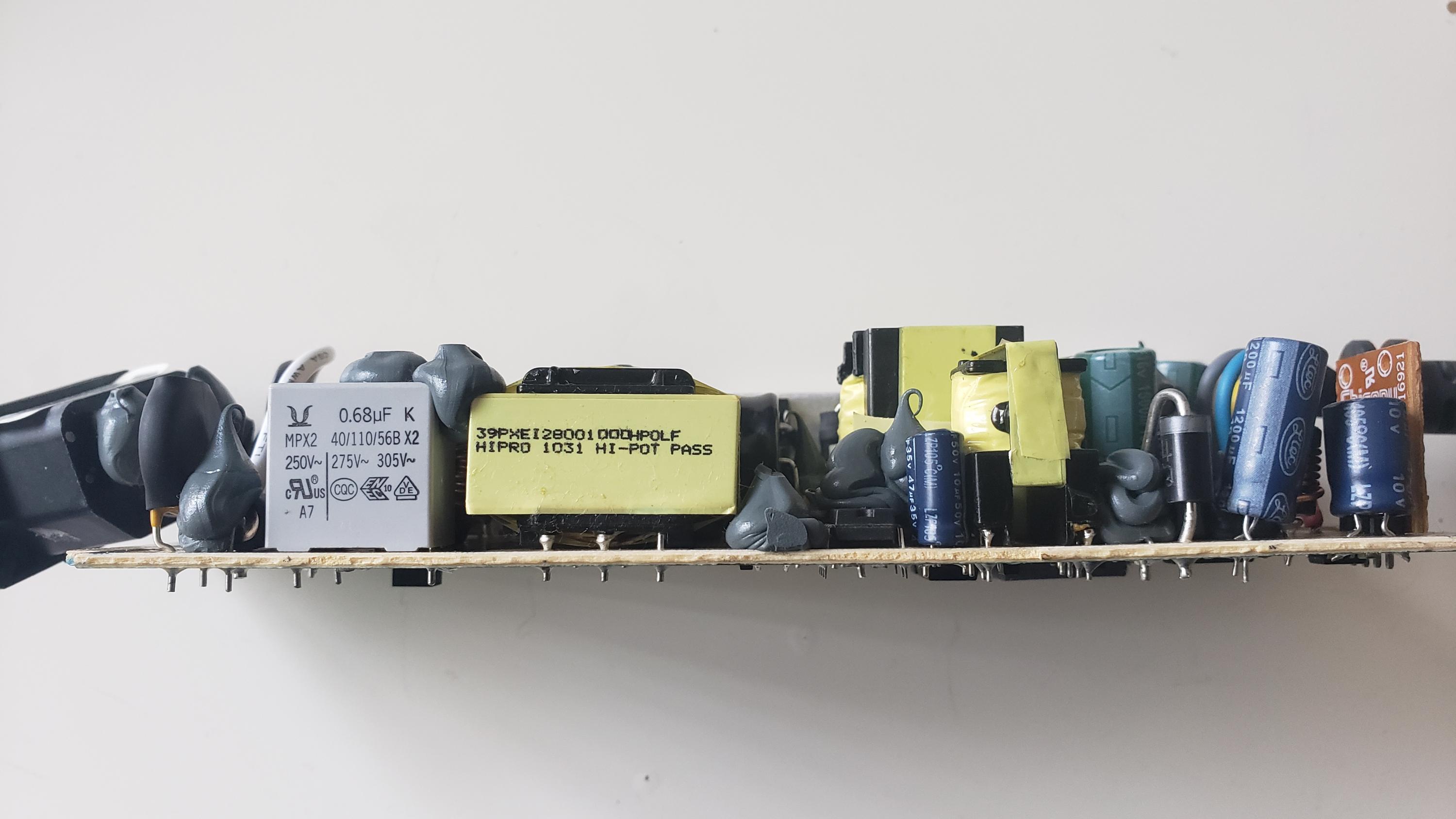

    I have got a xbox 360 console from India where it has an adapter designed to work with 200v-240v (135 watts) and has o/p voltages of 5v 1A standby and 12v 10A as operating voltage. Is there any way to modify the same to work on 110v in USA?

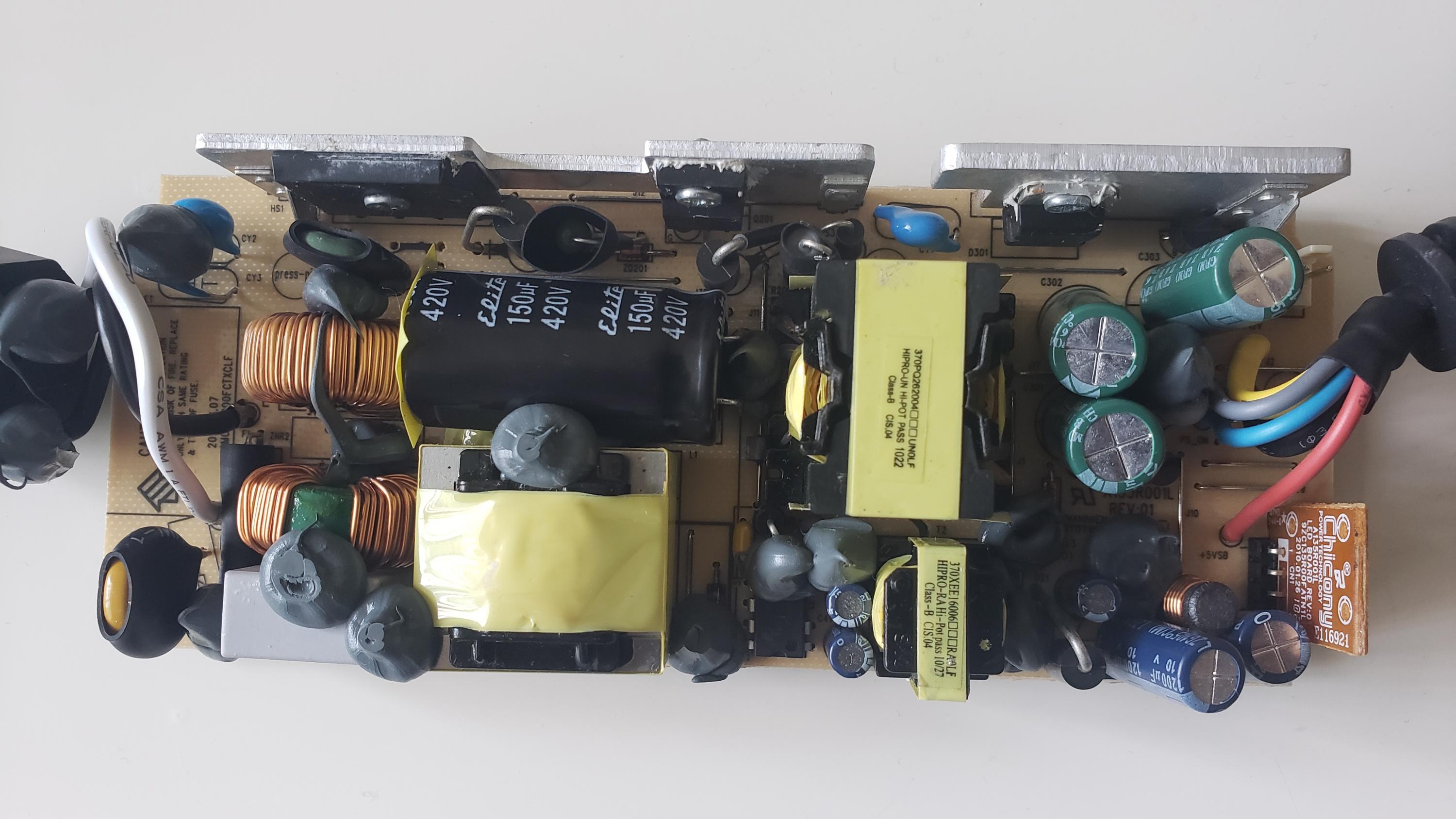

      Please find the attached pictures. I see most of the caps on primary side are rated for 420v. Do I need to replace them?

        the caps are fine,
        the fuse may need to be uprated, but i'm not sure if it has a PFC circuit and how it would react.
        did you try it?

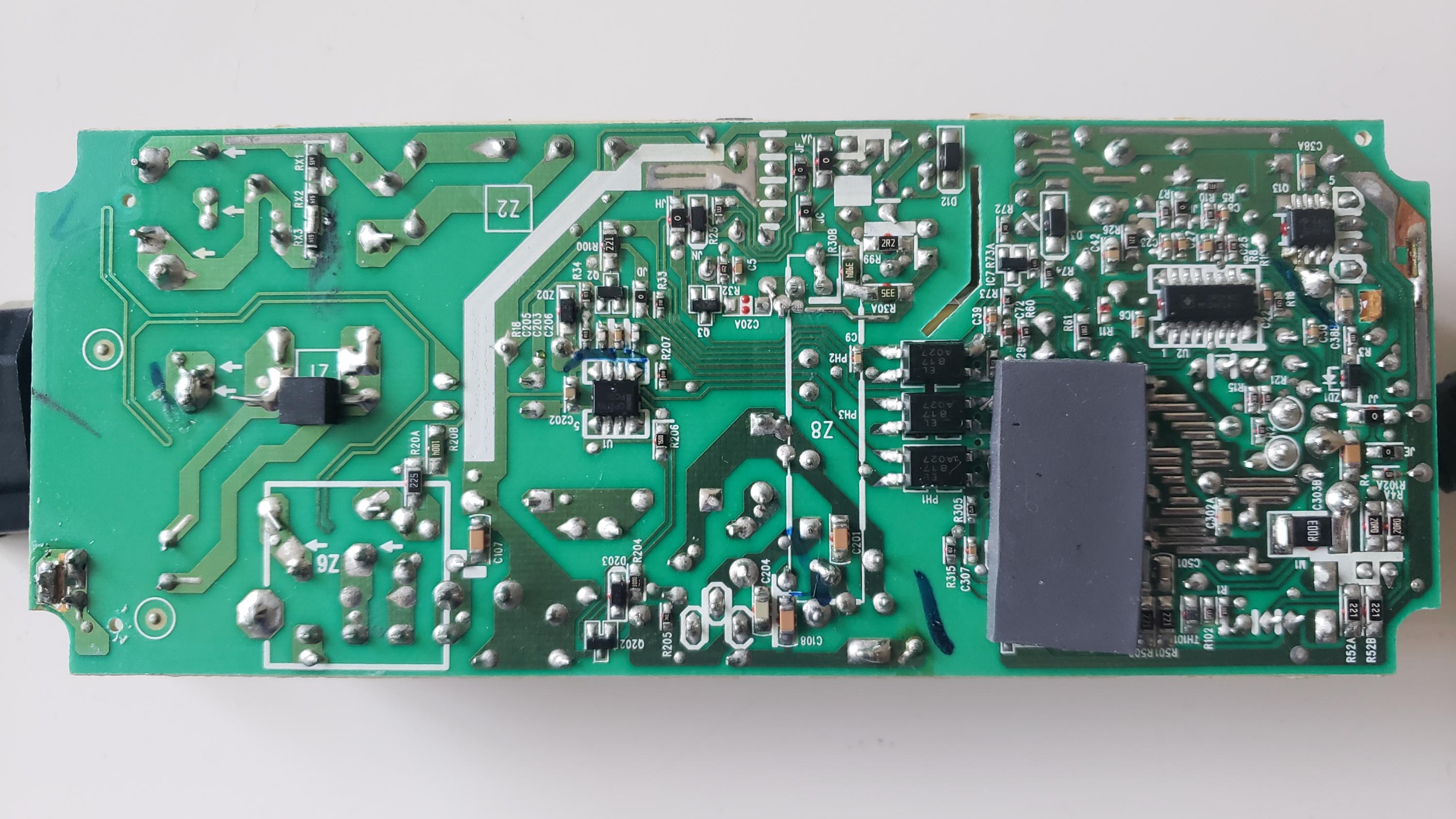

          Yes it has pfc circuit and I'm getting only 1.2v on the secondary which I think won't be enough.

              Its 172v on main cap and 1.2v on 5v rail on the secondary side, nothing plugged in.

                  The circuit was not designed to operate with an input of 110vac. It won't work unless you redesign the primary circuit for both the standby and main power supply section.
                  Just get a step-up adaptor for 110~220v, 200watt or replace the power supply with a north American one.

                    How about adding the voltage doubler circuit before the rectifier or in place od rectifier bridge? Will that work?

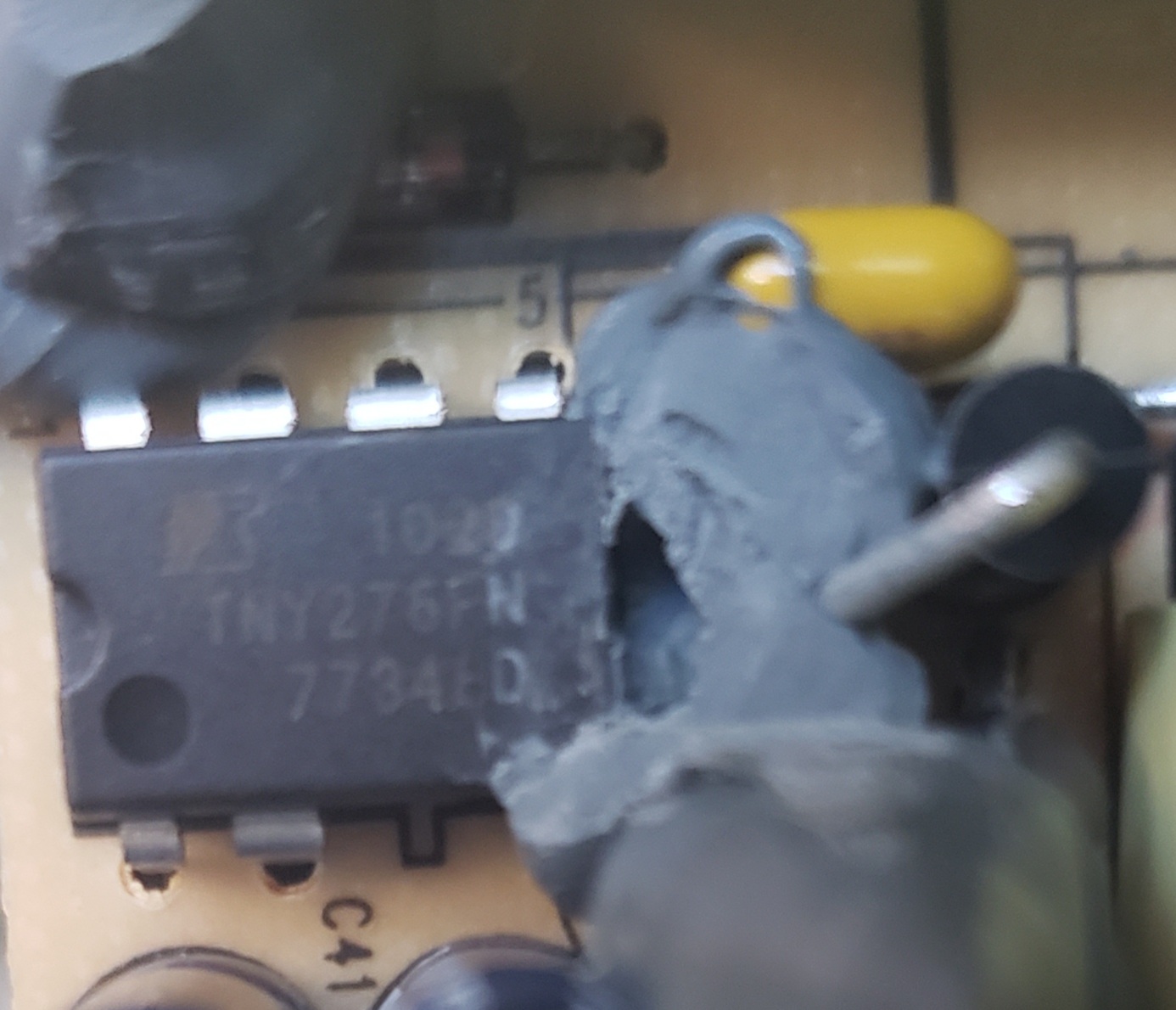

                        What is that 7 legged IC on pic 1, almost center on the bottom?

                          It's IC TNY276PN, I believe its for 5v standby voltage control. I'm getting 4.8v on pin 2 and 1.2v on pin1 of it.

                                Correct. That is the 5V standby, always on. Looking at the datasheet, the voltage you are measuring is below the min values. That is number one that needs fixing. After that you have to figure out if the PFC would work on 120V.
                                That's why I am saying it would be easier to find a used / aftermarket PSU or an transformer.

                                    I have already bought the 110V adapter for xbox however I'm just trying to modify this to work with 110v out of my curiosity. Most of the SMPS now days work on the range of 87v-240v input but this one is specifically designed to work with 240v so wanted under stand the components which contributes for this.
                                    As CapLeaker mentioned in the post above, it's the IC TNY276PN which is not working somehow and not producing the stb 5v. But not sure where should I start? I'm not a electronics engineer, I work as software engineer but this is my hobby so want to explore more.

                                      What will happen if I replace the bridge rectifier with the voltage doubler circuit as shows in this diagram - https://www.homemade-circuits.com/wp...compressed.jpg
                                      Will that work / smoke / burn / damage?

                                        Voltage doubler circuits require two bulk filtering capacitors, you only have one...
                                        Besides the last component to have a problem with low line voltage should be the TNY276PN
                                        It is literally designed to be a "keep it simple stupid" voltage controller accepting full range 85-265VAC.
