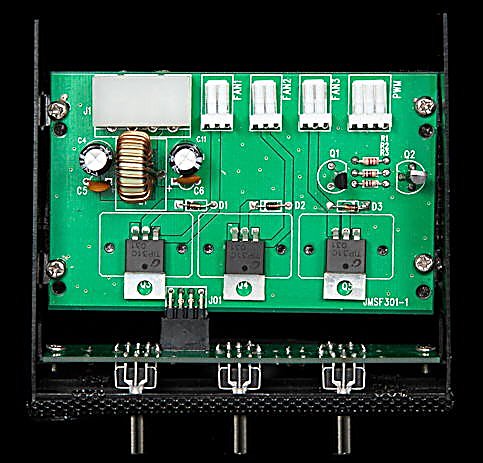

    I don't hide the fact that I don't understand a lot about transistors in general as transistor logic is still something I'm learning as I go along. Therefor there will be a lot of questions in here.
    However, I've been pondering over time to swap out the transistors in my Sunbeam PL-RS-3 fan controller. So far I've swapped the 470uF 'HUAHONG' capacitors out with Rubycon YK 16v 1000uF for piece of mind. The three channels are rated 30watts and each driven by a heatsinked TIP31C transistor. The reason I want to look into changing them out are for a couple reasons.
    1) Lower voltage drop (currently about 1.2v)
    2) Lower heat output
    Currently the TIP31C is rated for the following:
    Polarity: NPN
    VCBO 40v
    VCEO Max: 40v
    VEBO: 5v
    Saturation: 1.2v
    Max Current: 3A
    GBP: 3mhz
    Package: TO-220
    From what I understand, reducing the saturation voltage would produce less heat generation and voltage drop. However, what I don't understand is if a higher maximum current capability would result in less heat generation as well due to running lower than its' peak current. I'm blindly assuming that being a semiconductor it will be similar to a diode whereas higher current capability will result in lower dropout voltage at lower current throughput.
    What I'm aiming at is simply changing them out for something that won't produce as much waste heat and a lower dropout voltage. My fans already run at barely 11volts because of it. Considering they are being used for 12v linear voltage control of the fans based on a PWM input signal the majority of values such as maximum voltage and Gain Bandwidth is non-applicable.
    I'm currently looking at the KSD526Y series Transistors by Fairchild with the following:
    Polarity: NPN
    VCBO: 80v
    VCEO Max: 80v
    VEBO: 5v
    Saturation: 0.45v
    Max Current: 4A
    GBP: 8mhz
    Package: TO-220
    This is the closest match for a higher output/lower saturation voltage transistor in the TO-220/TO-220-3 package with higher VCBO/VCEO breakdown voltages and matching VEBO. Am I wrong to assume that the VEBO is also simply a maximum breakdown voltage only when reverse biased and that raising it wouldn't be an issue? Raising the VEBO would increase the possibility for a lower saturation voltage as well.
    .. if I'm off my rocker and being stupid please tell me. I'm still trying to understand transistors so probably sound completely bonkers with my assessment and thoughts (also exhausted right now so probably don't make much sense... *yawn*). Some helpful guidance would be appreciated for when I decide to do this in the near future.

      I had thought that as well but I find they aren't in fact. There is a small bi-transistor circuit at the PWM input to convert the PWM to a current-based control for the base current. So it isn't being switched full on like would be expected out of a FET as originally thought. This makes sense considering the use of transistors otherwise they would have not added the PWM->Current control for the transistors base current and instead had the PWM control the fets directly.
      Additionally, each of the transistors are alternatively controlled using manual controlled rheostats in manual mode where fets wouldn't be useable due to the hard on/off states. Again, controlling current flow to the base.

        Re: Swapping out transistors in fan controller.
        If the metal heatsinks aren't getting hot, you aren't losing that much, and no point in swapping them out.
        That leaves the question... what fans are you using? If you're just using the typical 2W PC fans you're not really losing much on the TIP31's...
        And if it's not PWMing, no matter what transistor you have their, it will dissipate the same power until you're on full-on - then sat voltage becomes an issue - and you might well just get rid of the transistor and hook it straight up to the power source.

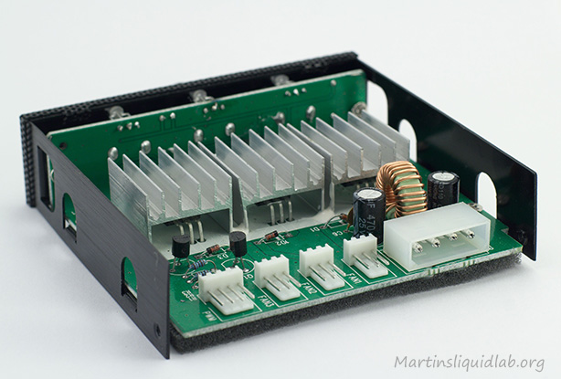

              Understandable and you've made your point. Still learning some of the ropes with transistors so this information proved very useful. I guess one could consider my isue... ECC Corrected
              [But really, thanks - it's greatly appreciated! ]
              Image attached of the unit as it comes with heatsinks pre-applied.

                    After staring at the actual device more, it does look like it may be running in PWM mode if you have a PWM input. I'd have to look at the reverse side of the board or do a full reverse engineer to see if it's correct but there's no reason why that PWM signal couldn't be used to generate a PWM base signal directly instead of converting it to a DC base signal and linearly controlling the transistors. Are you sure it's linearly controlling the transistors?
                    Ideally you should do a circuit extract and see how it's connected. You may very well be able to cheaply modify this circuit to use MOSFETs if the fan controller used the TIP31s as common emitter drivers. However the likely case is that it's using them in emitter follower mode and fairly extensive changes would be needed to convert to MOSFET including a need to charge pump (unless you want to really modify and use P-channel MOSFETs which would simplify the re-design a bit).
                      BTW, can we see the bottom side of the board?
                        Aye, will see if I can expose it later on today or tomorrow. The manufacturer pasted on a foam pad with strong adhesive on the bottom of the board. Was a pain in the rear just to get a 2x2 inch patch open and clear the paste out so I could change the capacitors a while back.
