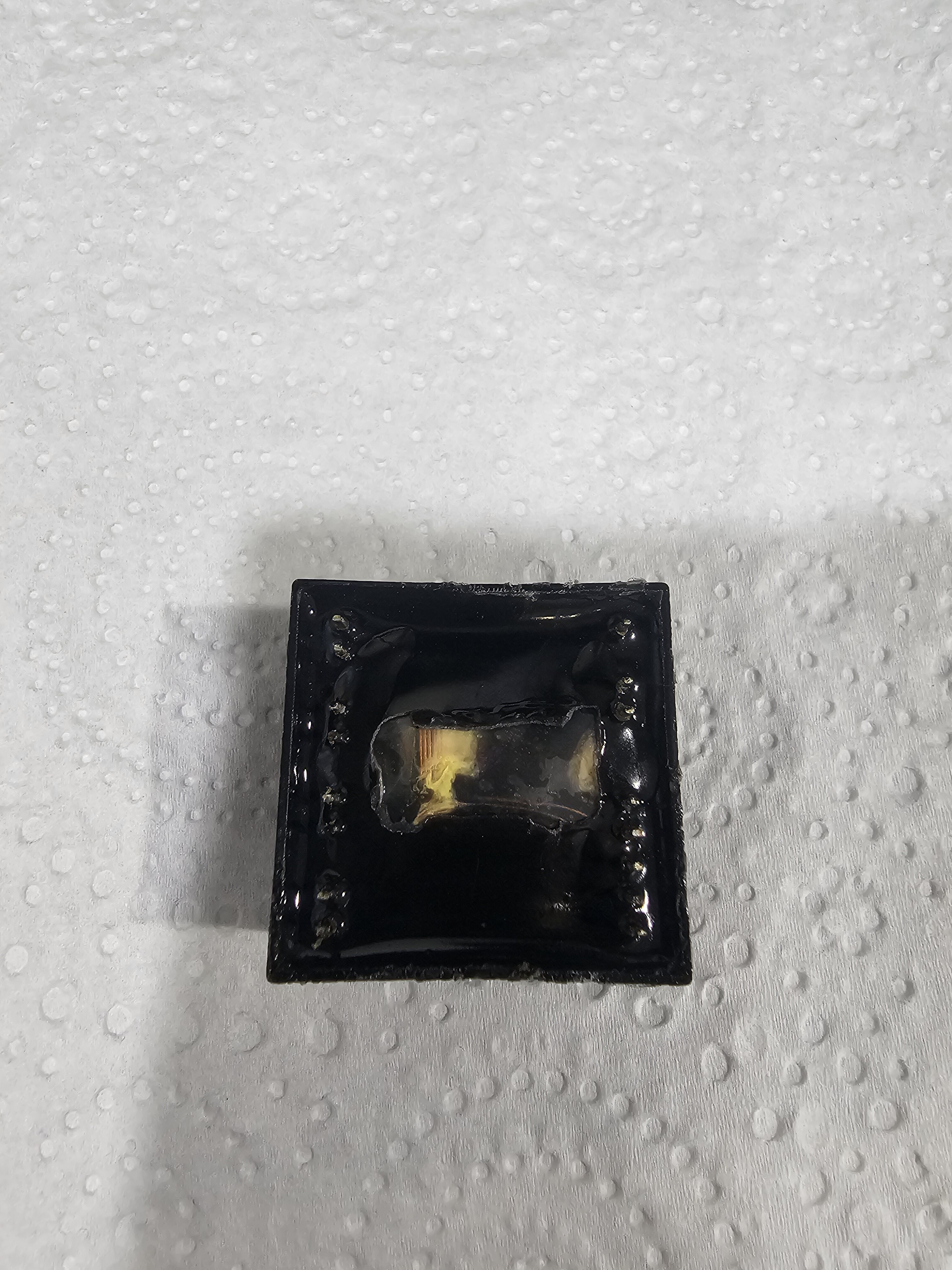

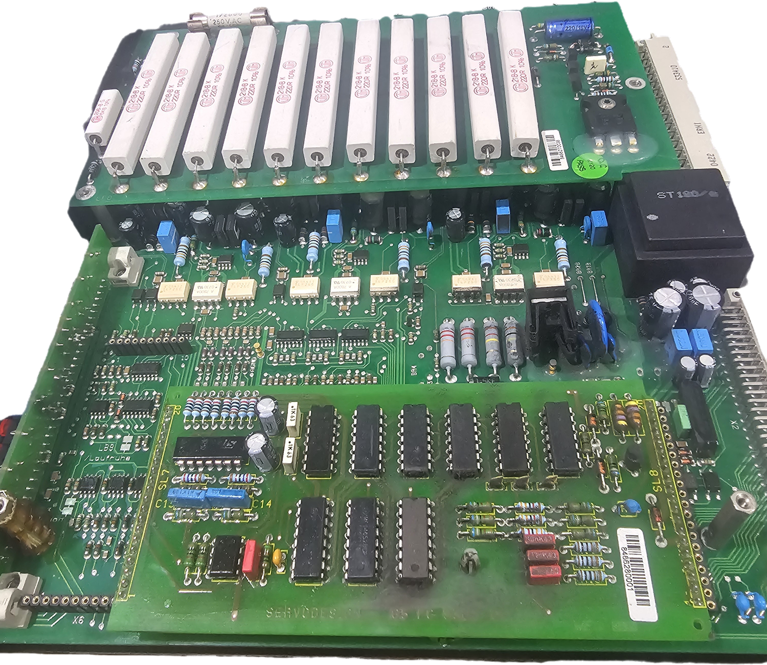

    Relay identification please :)
    Of a pcb with markings ST180 could anyone help with replacement part

    Please take a picture of the relay itself so we can see what type of package it is in

      worst design i think i'v seen in years.
      all those big resistors cooking a bunch of capacitors directly below them!
      also i see those soot stains - you need to clean that off when you replace blown parts because the carbon is conductive.
          terrible design is a complete understatement, worst I have seen

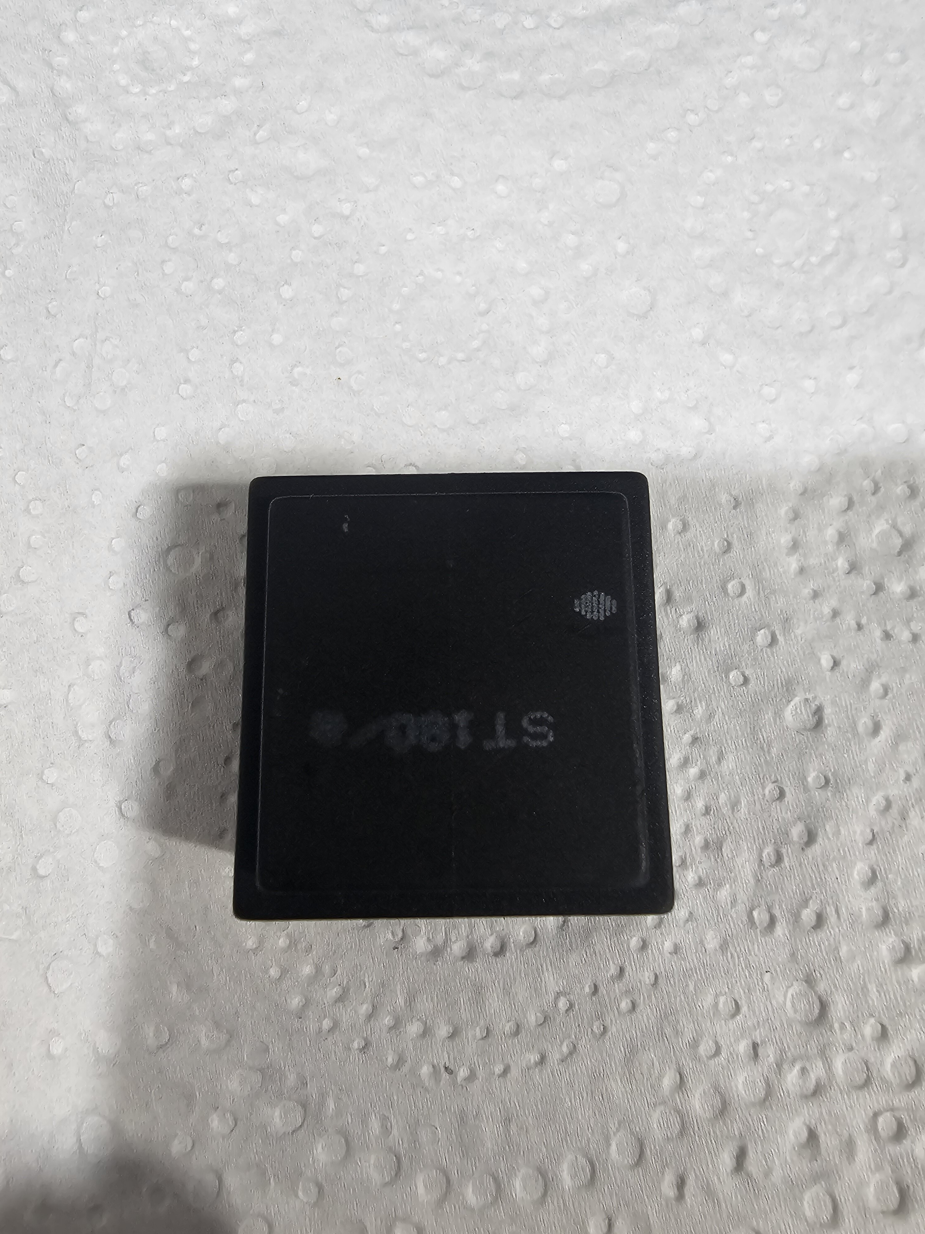

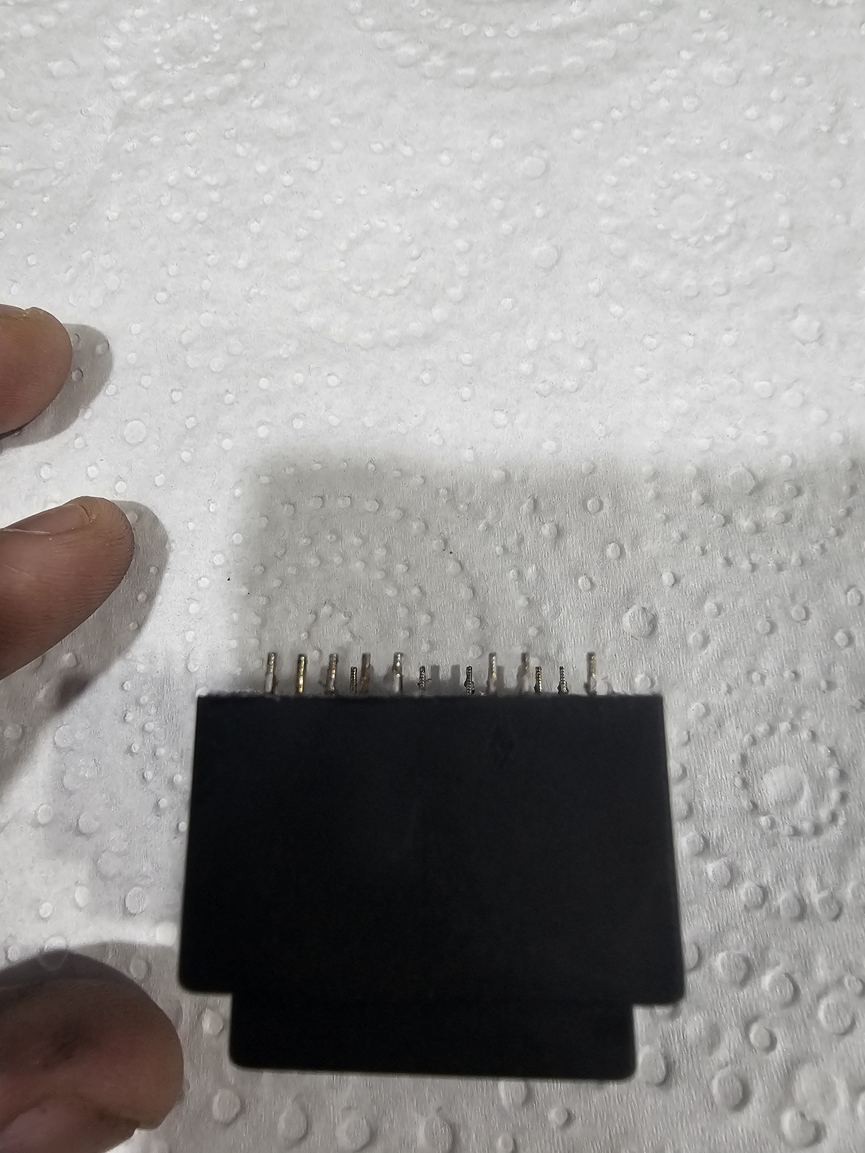

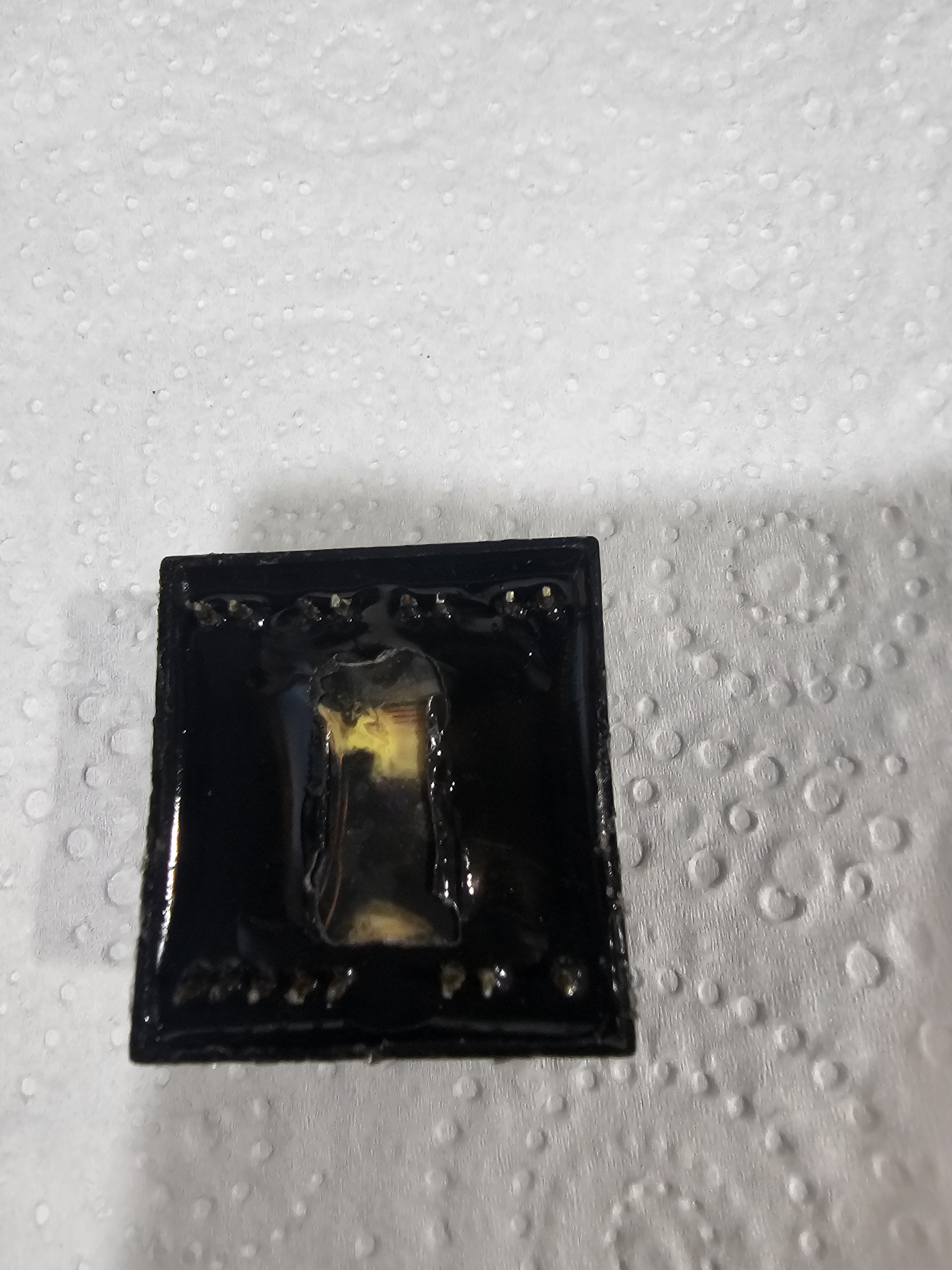

            HERES THE PICS

              That is a transformer, not a relay

                Great, any idea were i may find a suitable replacement

                  if you didnt know what it was, how do you know it's bad?
                  what is the whole board from anyway?

                    Fuse kept blowing, 0 ohms one side of fuse, inject 1v and transformer got extremely hot, after removal resistance is high kohms,no short and obviously its very burnt on bottom
                      • 31304
                      transformers are for AC, if you inject DC they will get hot - they are just coils

                        Transformers are supposed to look like shorts, it's just a long piece of wire inside after all.
                        Transformers tend to be custom for the design. Is this a switch mode power supply? Can't tell if it's an EI or ferrite core, looks like the latter and hence a switch mode, but the circuit around it looks wrong.
                        Will need more data, better pictures of board surrounding it...
