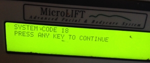

    First post here, hope to get a steer on an electronic problem. A friend of mine runs a beauty salon on her own and purchased a machine a few years ago - square box around 30" x 12" x 5". Paid a lot of money for it which she didnt really have.
    About 2 months ago it suddenly prompted for a pass code. The firm has gone bust and there is no way of her getting a code or support. I'm from a software background, but said I'd take a look, only thing I could think of trying was seeing if there was a cmos battery, and removing it to see if it would reset.
    Opened the box and was amazed to find only one very simple circuit board! I can see a battery but it appears to be secured by a weld. Before I force it out, I'd appreciate if anyone thinks it's worth a shot. Can post photos if it helps.

      1 - The message that displays which is "System Code 18 - Press any ket to continue". When you do it looks for a code.

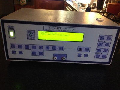

      2 - The Microlift box

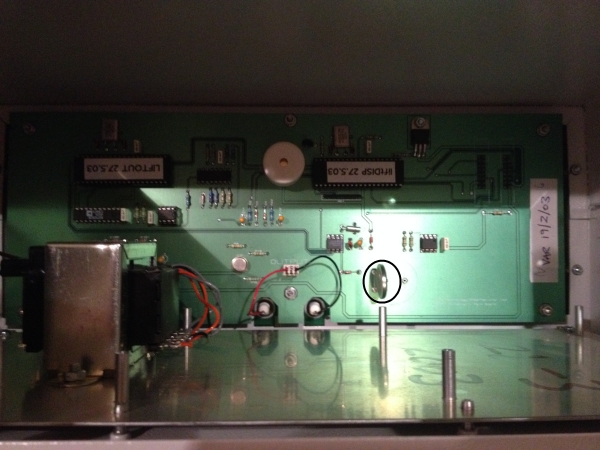

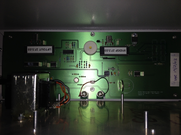

      3 & 4 - Two pics of the only circuit board. You can see the battery which is standing upright. I've no idea on the rest, but doesn't look to be much there.
      If I can send on anything else that may help please let me know. And thanks for the VERY quick response vinceroger69...

          I'll check re: manual but don't think so. It is a facial / body toner (whatever that means) and yes, looks like 2003 alright! Probably why I can't find anything to do with it on Google etc.
          She was using this fine up to a few months ago, but one day, switched it on and it started looking for.a code. Only thing I can think to try is to take out the battery and see? There's no jumpers etc. would be nice to help her out cos she spent a lot on it and hasn't had much in the way of luck recently...

            The design looks pretty old, I would guess late 90s. I'm not sure what it does, given there looks to be very little inside of it... There looks to be a socketed device which might be an EEPROM for settings and two microcontrollers, one for the display and one for everything else, I am guessing.
            Looks like it has two wires for electrodes, some kind of electro-therapy nonsense as we've seen before here?

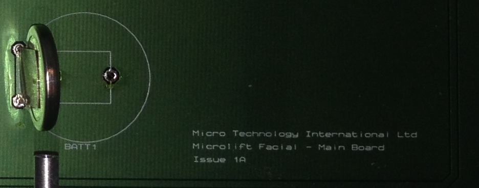

              what does that text printed on the PCB in pic 4 say?

                the battery is probably flat for a start.
                it looks like a glorified TENS unit btw.

                  12345?
                    Re: Machine - reset pass code
                    BTW, did you check the voltage on the battery? It is more than 10 years old so I will not be surprised if it is dead.

                      My God, how did you find that, it's the exact same machine!
                      I've uploaded a zoom of the PCB text. Thanks for the feedback.

                          Probably, the image above showing the PCB text includes the battery close up - it appears to be welded to the two vertical metal flaps so will require a bit of force.
                                    NO!
                                    that's a pcb mounted battery - the tabs are part of it.
                                    you replace the whole thing with another - or a socket.
                                    you need to get the part number etc from the battery so we know if it's a disposable lithium, or a lithium-thionyl rechargable.

                                      Stj - phew had the pliers in place when I read your post. I'll dismantle it tomorrow an see can I get the part # or a replacement.
