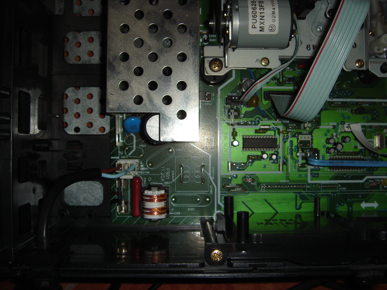

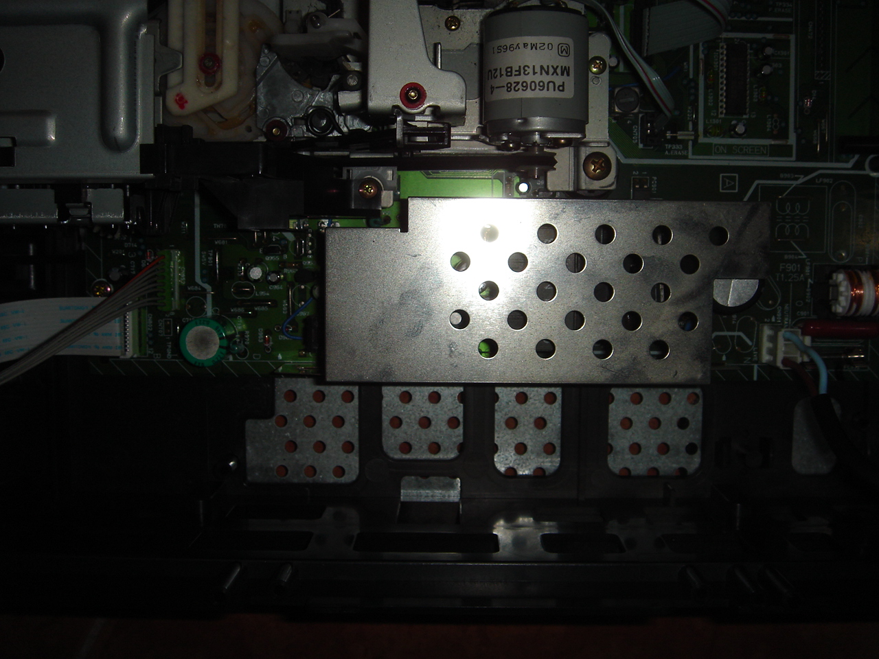

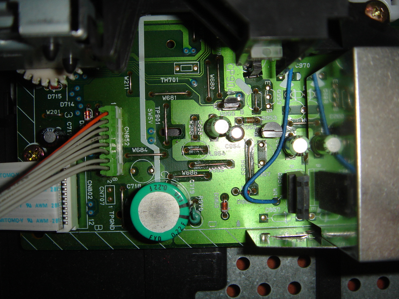

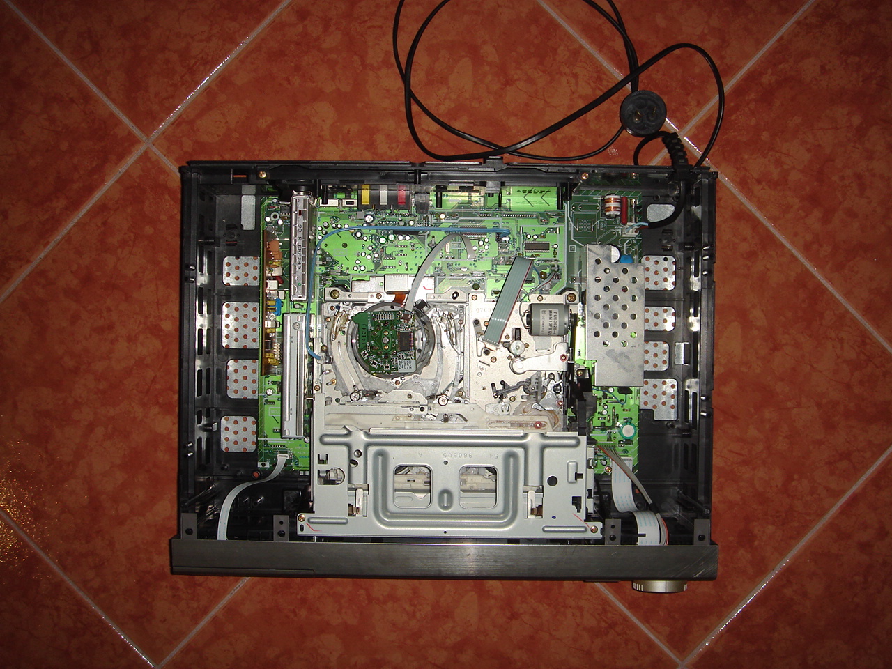

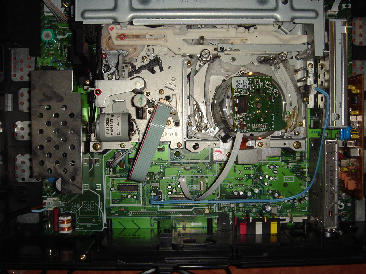

      Hello Everyone,
      My Camera finished charging, so here are some pictures of the internals.
      Originally posted by willawake
      maybe power surge?
      It could be a power surge, but I'm not very sure. This unit hasn't been used in months after it gave up on its owner.
      If i am lucky, the unit will give off a short buzzing noise, but thats all it can do for now, intermittently buzz....

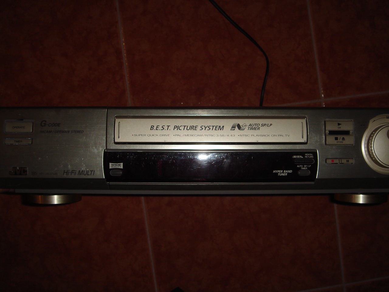

      The mechanic of the VCR look very clean except for a few dust particles. I wonder if we can have widescreen tapes?? I highly doubt it but.... there's a "Wide Quality" button on the front of this unit.... I wonder what that button does??
      Anyway, I don't know whats wrong with it apart from the unit not powering up. Any advice would be great.

        post a pic of the psu.
        iirc that one uses a switcher and had a 1@50 that would dry out.

              Re: JVC HR-J837MS no power??
              Pull the front plate off(the section with the door and controls) and remove the outer srews that hold the pcb down. The board should lift out with the mechanics still attached. Others I've seen, the assembly is held to the board with plastic clips.
                  I finally got around to taking the whole board and video machanism out (turned out quite easy to remove) and I measured at Elna cap right next to a Nippon chemicon 250V cap.
                  The Elna cap is a 2.2uf 50V cap and it has no continuity on my ohm meter. I think that cap is the culprit in the no power issue, all other caps had continuity.
