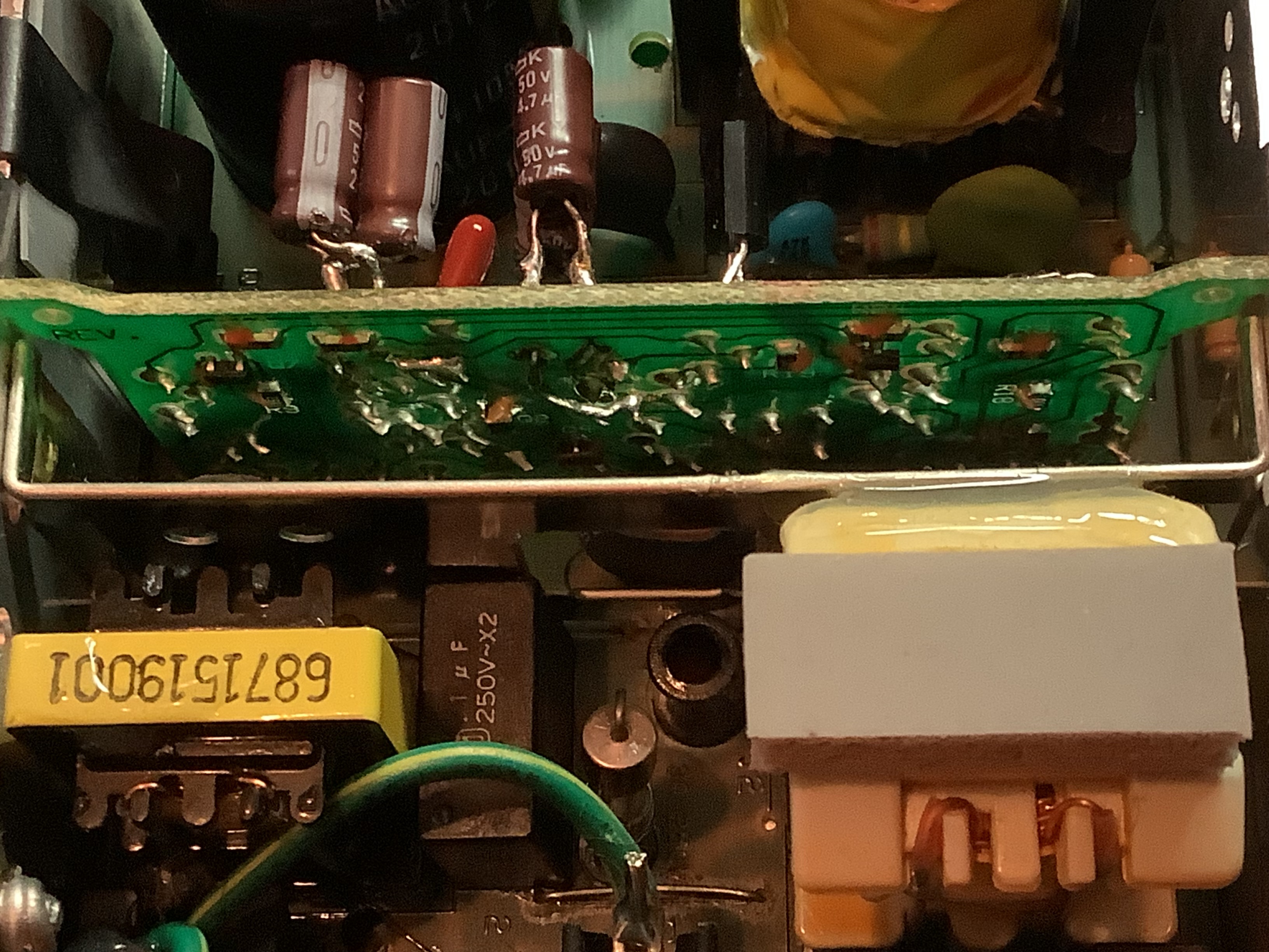

Panasonic switching power supply daughter board has two 27uf @ 50 volt capacitors which I do not keep in stock

    I don't see a main PWM control IC in there, but the two 27uF caps might be for the driver stage of a 1/2 bridge, they are to keep imbalance or maybe average current reasonable. They see action when the PSU is heavily loaded.
    Never seen a Marcon primary cap before 180uF 400V.
    Actually I did have a few 27uf @ 50 volts but they were in a container that is odd values or low voltage capacitors that I mainly use for 5 volt switching power supplies I did not even think about looking in this container because I was looking for some 3300uf @ 35 volt I have some but they are not brand name ones for this switching power supply but I am not going to change them because of the quality of these boards and that I had to do a repair job in four places

                  Originally posted by stj
                  well lets see the board
                  In post # 9 I showed one side of the board but I am not going to remove it again because of how poor the soldering joint traces because I plan on reusing it for a project that I want to complete I am going to replace the output capacitors I just have not got to this part of the recapping process of this board yet
                  If I can take a better picture of this board I will post it

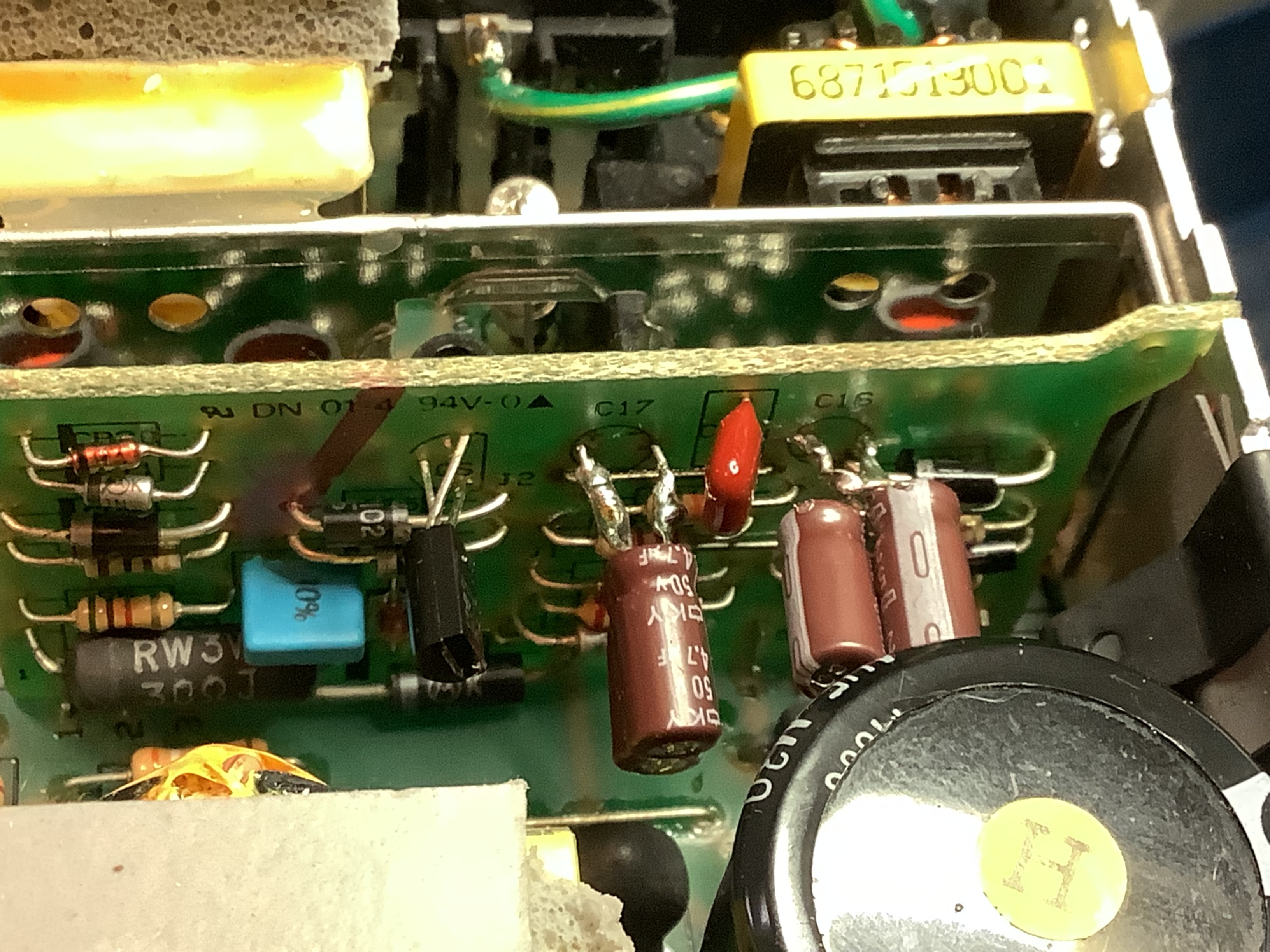

                    #29
                    I think today they can manufacture electrolytic capacitors within a few % tolerance. It's not the 1950's anymore for the -20%/+80% number, and its +/-20% nowadays still a 40% wide window.
                    Many larger caps I've bought are at basically at -18% lol. An old cap is 82uF 450V, the new one measures ~70uF (happened several times) so I end up upsizing and buying 100uF to get 85uF. This is Chemicon and Nichicon. Why would you give the customer more than what the spec is
                    Smaller caps seem to be closer tolerance to rated value, so a 27uF would be very close to that.
                    Wild guess this is a half-bridge SMPS and the 27uF is part of the driver circuit, like in PC power supplies.
                      • Jul 2011
                      • 6083
                      • Soldering Junkie
                      #30
                      These are the best pictures of the daughter board
