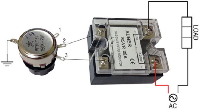

    I have a 220v 500w heater that i want to be able to control with a 25 amp DA fotek relay along with a 5 amp fuse. I have a potentiometer that i was using, but the ssr light would not come on when i wired it and i am not quite sure if i actually need to get a rheostat, the fuse is bypassed during this test.

              i have about 5 pcs SSR relays http://www.amazon.com/40A-SSR-Solid-.../dp/B004HZLMTW that were lying around so i figured i could just use those instead of the faulty SCR to make it analog using a potentiometer
                Re: Controlling heater with rheostat and fotek ssr
                SSR is fully on or fully off (it done using SCR or TRIAC for switching instead of electro-mechanical relay with mechanical contacts) so if you try to adjust the output with POT is not going to work.
                SSR input control can be anything from 3-32VDC without burning up the Optoisolator inside is also isolated from the output circuit so it can be controlled by logic circuit.
                The amount of the SCR or TRAIAC conduction time is done with RC Phase angle firing control circuit.
                That one from EBAY, you can see the pot and R-C circuit for Phase angle firing control, as shown, it is a 2000W Dimmer.
                We also do not know if the load side has to be isolated from the control side for safety or not for your requirement.

                  I understand. So this is a special SSR then basically an SSVR as it mentinos? http://www.auberins.com/index.php?ma...roducts_id=332
                  It would be great if you could point out a product that will allow me to control the heater via analog without use of PID controller.
                  I found some information on this forum as well http://www.homebrewtalk.com/f170/pid...s-ssvr-429498/
                    That SSVR is the high current dimmer module with Pot for adjusting the power applied to the load.
                    What do mean by via ANALOG, the pot is the analog which will control the output of the module. Are you talking analog output of the black box that put out variable DC voltage from 0~5VDC, 5VDC= MAX output of the module, 0V = no output? Clarify the word analog and what is it that you will use to control the module instead of using the Pot that comes with the module.
                    The pictures as shown for the connection and function is very simple:

                        Check the Fotek SSR part number you are using.
                        Fotek have some (VA=adjustable series) that have a potentiometer input which does phase control.
                        Their (DA=on/off series) is for only switching loads on or off (zero cross).
                        I think you have the two mixed up.

                          Seems like the OP is confused about what that product is and how it is used. The product detail indicates that it is a phase fired device, similar to a light dimmer and is capable of handling a load current of 25 amperes. You can use it to control either 120v mains or 240 volt mains.
                          The SSR device has a built it phase controller. In other words, it has the controller circuit built into the device and requires only the external pot. Very simple. Heater control IS done using "on-off" devices due to the high currents. Just mount the SSR on a heat sink and fuse it. My numbers indicate that the heater you desicribed will draw just over 2 amps @ 240v. So a 5 amp fuse would be sufficient. Use an industrial fuse like this:
