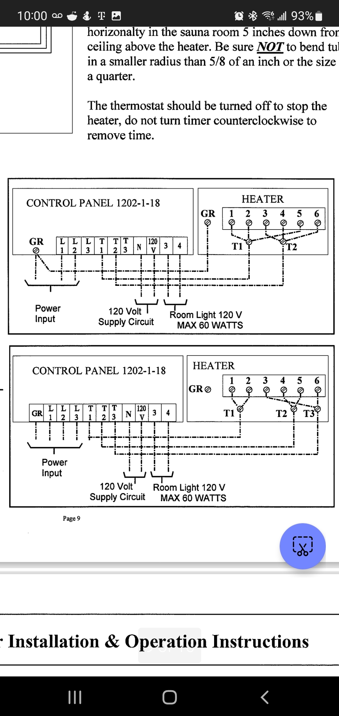

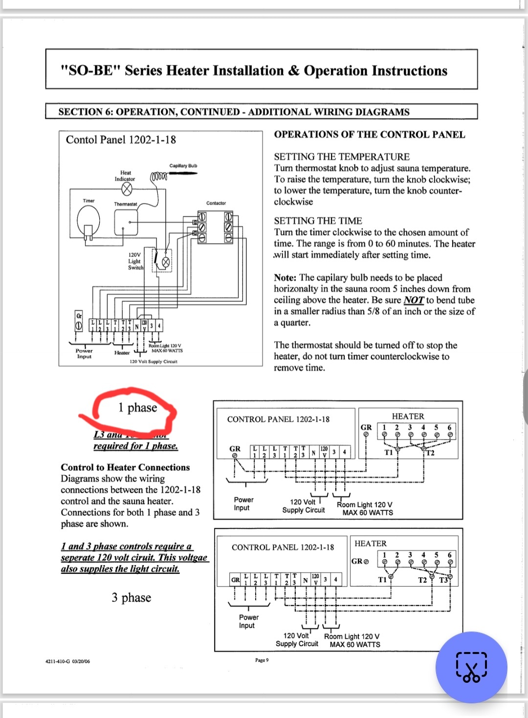

            The new and improved wiring diagram,,,
            Thanks to the guys at Sauna360...
            Pg 9. The 1202-1-18 unit...
            Looks like the "contactor" (I was wondering about that) is built into the controller itself (unless I'm mistaken) which is good...
            I am a little confused about how and which wires will be run to the individual elements. I think I understand the load connections,,, but am uncertain about the the line back. Anyways, I'm a ways away from that stage.
            My elements are 2100watts each 😬

                    #49
                    Good Morning! Thanks Sam.
                    So what I discovered is that there is NO neutral to the heating elements. Each element leg (3 of them) gets 120v for a total of of 240 +/- in each of the 3. I was confused and then talked with a electrician at work who cleared things up for me. That N on the board is for the 120v light circuit only, on a separate line, and that is it.
                    My controller is the 1202-1-18 model/design. See manual.
                    Thru the controller, three element legs will get its 120v from the T1 connection, 3 will get 120v from the T2 connection.
                    I will be working with (see page 9 of the manual) the 1 phase layout. L3 and T3 are not used... Power input from the panel into L1 and L2, out to the coils on T1 and T2. It is a residential home and I don't have 3 phase capability.
                    Now I have to figure out my limiters...and how to place them in the circuit. See page 6 of the manual...

                      Please post a website link to the manual that you are using so we are on the same exact page and we can get the same information together
                        #51
                        I got this from the company. It's an attachment. It was included in post 45...

                          One thing I do not like about this manual is that it does not have how you hook up the three heater element are they jumpers plate or are they jumpers wires with eyelet terminals to the wire terminals because you are making the three heater elements in a parallel circuit configuration which 3 heater elements @ 7 amps each for a total of 21 amp current load
                          One note if your wiring runs are more than 100 feet go to the next wire gauge for best results because you do not want to have a high voltage drop to the system this is my personal opinion and what I go by when doing wiring up a device to a breaker panel
                          The circuit for light fixture does not need to go to the next wire gauge even if the run is more than 100 feet because your wattage is only 60 watt please make sure that you use a moisture tight light fixture for this space
                          One thing that is going to be very important thing to do is that you make all your connections to the heater elements are tight and the wires are not over tight enough to strip the thread out of the nuts of the connector board or connector block probably made out of Bakelite material if your connections are not tight enough you will destroy the terminal plate connectors and probably not replaceable so make sure that they are tight enough
                          Make sure that you use a GFCI type breaker for your sauna system for your safety yes they are more expensive than a conventional breaker but because having steam in this space I would recommend using this type of breaker
                          I just realized that the way that this system is setup is that one heater element is always on and the other two heater elements are going through the limiter which is interesting concept to do it this way so I am assuming that when the temperature is close to desired temperature it goes down to one heater element it is possible that this device has a two stage thermostat switch this not a common thermostat it is probably a special type of thermostat
                          The reason I know this is because of diagram number 5 shows how the control system and main system are connected to each other one note the contactor coil is 240 volts which is a little unusual for a control circuit to be using this voltage generally speaking it is 24 volts DC or AC sometimes it can be 120 volts AC
                          Also pay close attention to page number 14 and follow it very closely for best results how to construct the sauna room

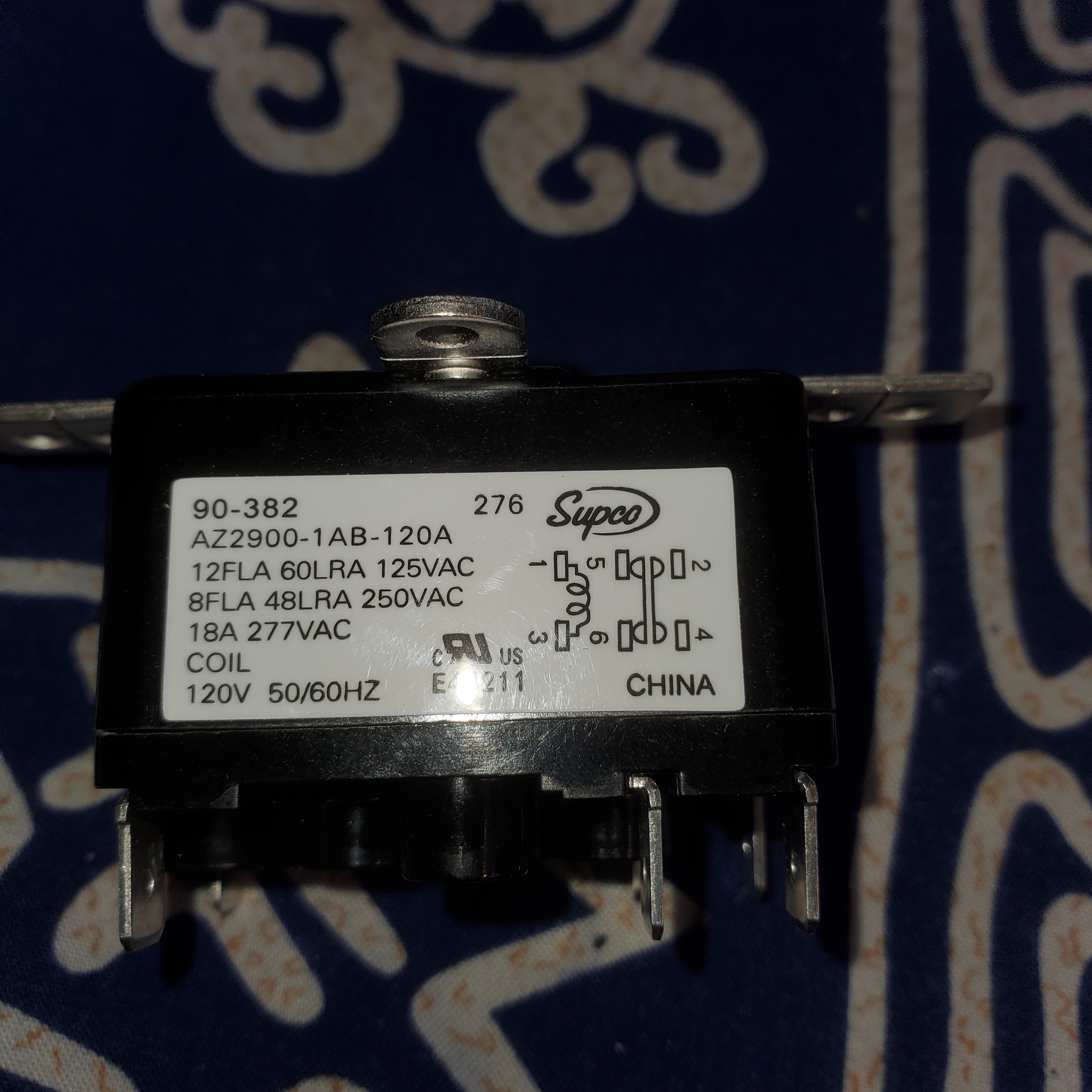

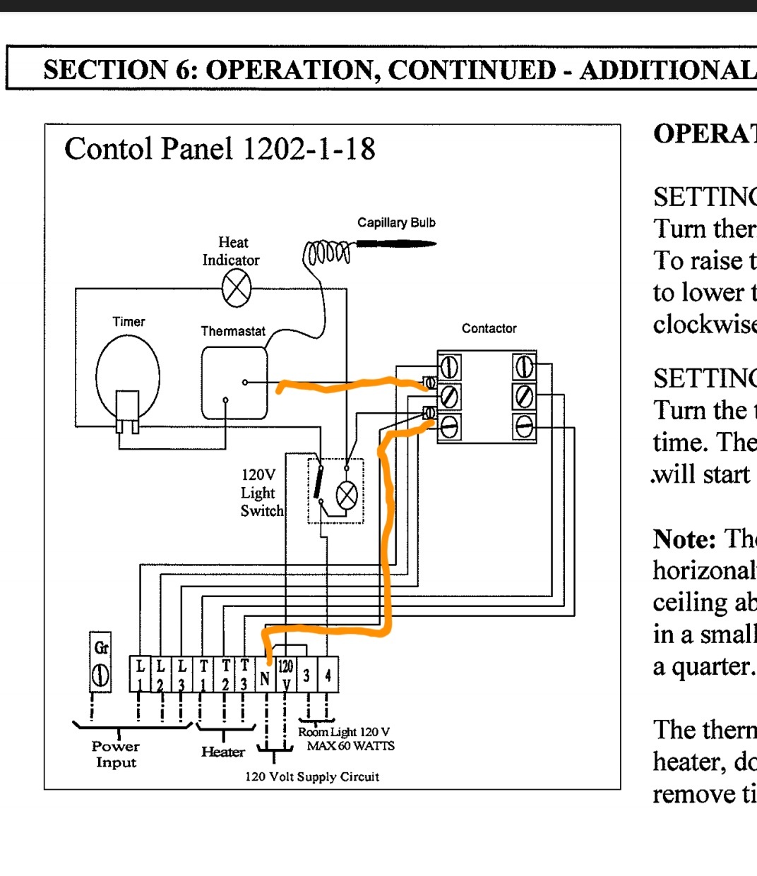

                                Good Morning All...
                                Just to say, I got this thing working and working well. I built the fire brick chimney, got a nice fab'd shroud to direct air flow, a nice 36 inch grill/grate for inside the sauna and a surprisingly nice vevor fan to push air thru... And it works. Max temps I see coming out of the vent (without ceramic insulation on the ducting) is about 250F with fan running in medium... I'll be come forward with some pictures shortly.
                                Q: I want/need the fan to run WHENEVER the system is on. I have the relay you see and the wiring diagram (I'll attach a picture) and I am having trouble figuring out how to wire the coil side of the relay to trigger it when the power comes on. Can I just put the coil side in one of T1 or T2 circuits. That way when the elements are getting power, the relay will be triggered?
                                Help please.
