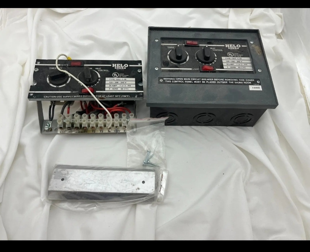

                              I have this controller and want to see if I can get it working on the enclosed element furnace brick fan stack. Do y'all care to see the ED for the unit? I could use some help with the T's and understanding wiring it up.
                              • JayPoorJay
                                • Jan 2022
                                • 149
                                #35
                                This is all the company that I contacted had
                                This is challenging, lol
                                • JayPoorJay
                                  • Jan 2022
                                  • 149
                                  #36
                                  Looks like the thermostat (capillary bulb style) is necessary and controls the on off. The guy who supplied the ED gave me a part number for the thermostat BUT the thing is like 100bucks...! I'll go dig that number up (they are readily available) and it's like companies KNOW that people are using them for saunas so I'm wondering if there is a capillary style thermostat (or even a digital one) that can be used in its place...? Any ideas?
                                  (edit) The numbers...
                                  Timer 3140-505
                                  Tstat 3155-623
                                  Light 3160-118
                                  Knob timer 2140-578

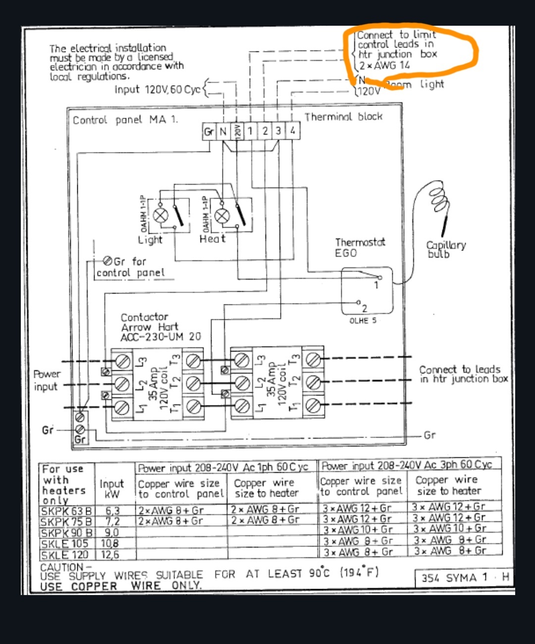

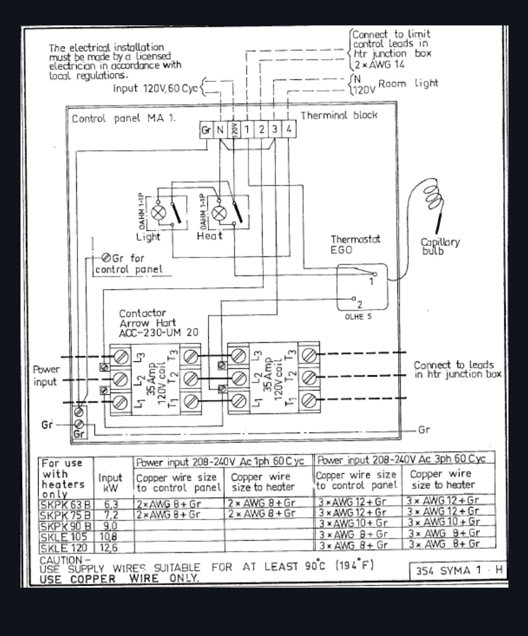

                                    Can you help me decipher "limit control leads in heater junction box"? Circled in orange in the attached image.
                                      • Jul 2011
                                      • 6033
                                      #38
                                      You need to be careful about using the wrong type of “thermostat (capillary bulb style) is necessary and controls the on off”
                                      Two reasons one is the contacts of the switch part that can handle the current the other concern is the temperature range of the device plus and the dead zone of the thermostat sensitivity to temperature change these are different do not think that they are the same because they are not
                                      You could probably go with a digital thermostat however you will need to experiment with the temperature on and temperature off and the dead band to keep the system from short cycling which is a detrimental effect on mechanical switch type of contacts
                                      Now you use a sold state relay instead of a mechanical switch type but you still need to have a dead band where you have no ON/OFF state because even if it is digital type of switch you can still overheat the module even if you have a heat sink on it
                                      Now this would require a PID controller to have the best possible result you could possibly do it with out a PID controller but you would have to have the right type of temperature controller that can handle the current rating of the heater unit but if you are using this type you need to know the amount of dead band the temperature controller you plan on using not all of them are the same the best ones are the ones that you can set the ON temperature and you can set the OFF temperature of the heater unit this is the best type to use now some of them have what temperature off set which a predetermined difference between ON and OFF which still can be used but make sure that you have at least 20 degrees difference at a minimum for best results
                                      Now they do make thermostats switches that can adjust the dead band to certain extent but this type of thermostats are more accurate and more expensive to buy that is the reason the thermostat that is recommended is more expensive than a general use thermostat type switch is
