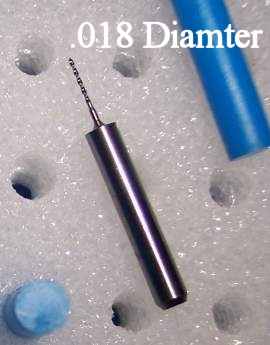

    I have a question about soldering -- or avoiding the soldering iron as much as possible.
    After removing an item from a board, is drilling out a hole an acceptable method of "cleaning out" a hole? I ask because my husband has these german-made (Kemmer Prazision) drill bits that are for printed circuit boards. The ones he has are really tiny in diameter, .018, and sharp as a son of gun. He was fooling around with one when he first got them by putting one on his fingernail and twirling -- it was going through the fingernail with no pressure and no effort!
    I tried this method with the MSI board that I have been working on and I was comfortable with this, but not sure if it is not acceptable because of contaminates from the old solder maybe?
    Here's a picture of the cool drill bits and a link to Kemmer's website. I am sure they cost an arm and a leg - I have no idea where my husband got his from and he can't remember either (obviously didn't pay for them ha).

    very risky.
    not recommended.
    rip out the thruhole and junk the board.

      definitely don't do it. Search in the FAQ and how-to's, there's a lot of info on exactly why not. Too many have destroyed their boards doing it. Hit up a local dentist and sweet talk them into selling you one of their stainless picks.

          The reason why its not recommended to drill out is that the pcb is made up of layers of tracks and insulation like having a multi story sandwich.
          The Via or plate through hole goes vertically from the top to the bottom
          Some of the tracks in the middle will be connected to (cylinder of metal)
          plate through hole.
          So if you drill it out there is a chance you will cut away part or all of the cylinder.
          This of course will leave tracks in the middle open circuit.
          So thats the risk you take doing it that way

            Thanks for the reply starfury. Ya, these bits are so small and sooo sharp - no additional pressure would be needed other than by a very light hand. However, I got to thinking about the dangers of damaging the sidewalls of the hole as you mention and little bits of solder falling into places unbeknownst to me and possibly shorting something else out.

                    as to where such bits come from:
                    Folks who fabricate PCBs use such bits by the jillion (did you ever wonder how all those holes come to be in the boards?). They discard them at a wear point which still leaves them able to drill for lesser uses. Plenty of surplus places will sell them to you in large lots for practically nothing.
                    Even the new ones are surprisingly cheap if you don't mind buying 50 at a time.
                    BUTTTTT... They are hard and brittle (need to be hard to last long enough to be useful in their original application), and thus very unforgiving of chuck wobble and such. If you use one be sure you won't get hurt if it shatters.

                      "BUTTTTT... They are hard and brittle (need to be hard to last long enough to be useful in their original application), and thus very unforgiving of chuck wobble and such."
                      Absolutely tried and true! Hehe. If one is dropped from a height, it easily breaks also! They don't like to be wobbled and used at an angle.

                              I have done it fine, though I don't prefer nor like to, you just have to be aware of what you're doing.
                              The bit has to be small enough with a little margin for being a little off-center in the hole, but at least as large as the component lead. This means it's not always possible unless you have larger holes or a very good selection of bit sizes and know the component lead size (which you might).
                              There can't be a solder bump that puts it off-center. You don't want to break the bit and get a piece of tiny metal lodged anywhere you cant get it out. It also throws tiny pieces of solder out which is a pain to get off anything.
                              The easy answer is find a better way like a solder sucker, but yes it is possible in an emergency if you are careful.
