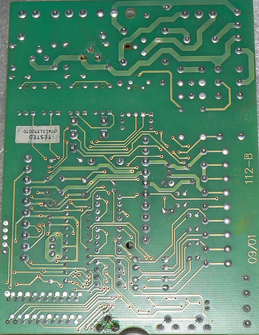

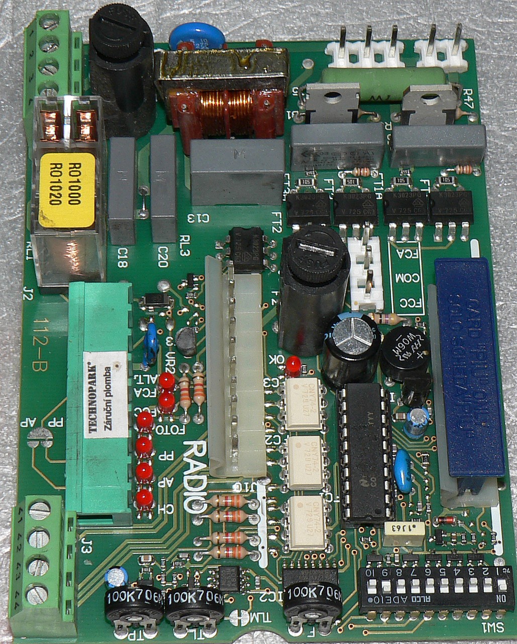

    I got this board from motorized gate control unit with the issue of powering motor only in one direction. One of two triacs is blown which seems to be the one and only problem.
    There is BTB24-800BW triac, that is 25A, 800V, 50 mA gate treshold. I can get similar triac but also another one with 35mA treshold, for less than 1/5 the price. Since I am not familiar yet with it and can only conclude based on transistors, I can asume lower gate treshold current is not a problem?

                  Can we see the pictures of the board, and any info on the motor (labeling on the motor)?
                    Re: Triac for motorized gate controller
                    Been told there's 1uF cap on the motor, that's all. I am giving the board back today so we'll see by tomorrow if it works or not.
                    EDIT: enjoy
