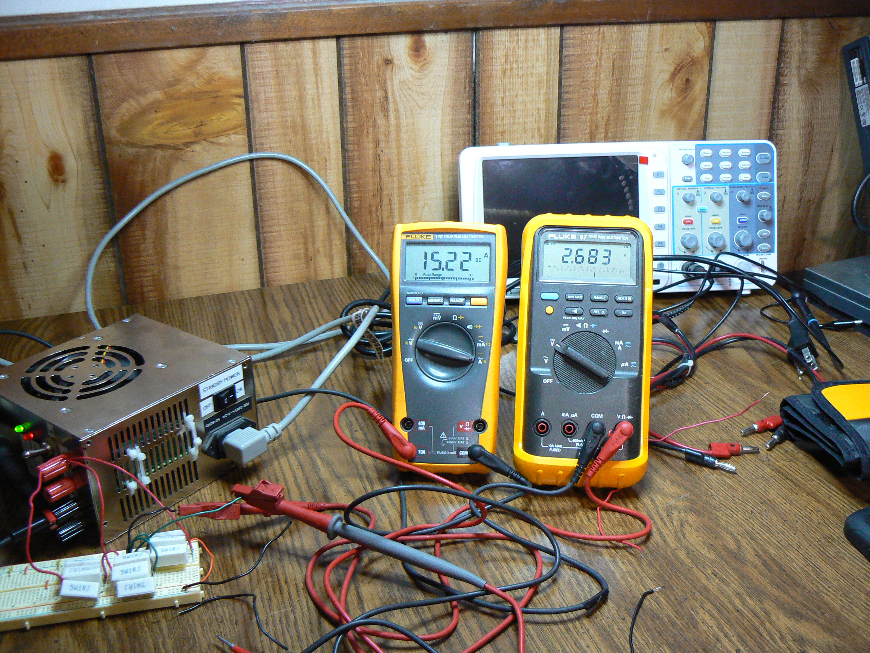

                                I was wanting to find a short on the 5V section of a motherboard and I thought the best way to do this was to use a lot of current to heat up the bad part. I wired nine 1 ohm resistors in parallel and connected the 5V of a modified ATX supply to provide power.
                                As you can see in the picture I was trying my best to blow the fuse in my meter as I put over 15A through the breadboard and meter. I know it is low voltage but that is still a lot of current.
                                  The 175 can do 20 A overload for 30 seconds maximum and then requires 10 minutes of rest minimum.
                                    Thank you for that information as I did not realize it could do that. I guess I was not the fuse daredevil that I thought I was being
                                      At $10 a pop, I don't take any chances.
                                      I did buy some cheap generic 50 cent 10x38mm 10A ceramic fuses, but I haven't tested them yet. I may put them in one or two multimeters where I know I will only use them on low powered circuits.
