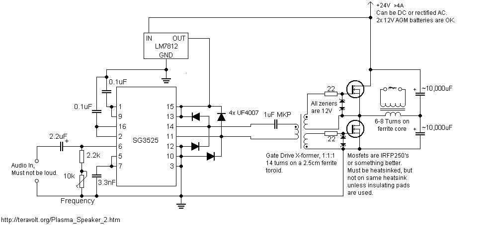

    I am building a project that uses a toroidal transformer with one input and two outputs at a 1:1 ratio. The instructions for the project say that you can use 24awg wire from phone wire or Cat5 for this purpose. I have already learned that using a powered iron toroid will not work, it has to be ferrite.
    I want to know what the best technique to wrap a toroidal transformer is. In my attached pictures you can see my various attempts. The easiest way for me was to twist the three wires together before wrapping it around the toroid but I am not sure how good this is to do from an electrical standpoint. I also have some wire that has the strands joined together but the problem with this wire is that the insulation is thicker than the other wire. When I tried using just three wires paralleled they would not stay tightly together. Of these three options which would be the best choice or does someone have a better idea?
    Also what effect would using a larger toroid have? What would using more turns do to the transformer? The plans call for 14 turns, which works, but the chip that drives the transformer gets hot after a short period so I would like to make it us less power, any suggestions on how to accomplish this would be very much appreciated.

    What is the transformer for? A DC-DC converter, audio etc. Pics? For most apps, the primary is wound first with the secondary on top. For audio applications, sometimes windings are bifilar wound (as you have done) but it increases mutual capacitance between all windings.
    If your driver IC is heating up, you need more turns or increase the frequency or your core is small or the windings are not phased properly.
    Where did the 14 turns number come from? You can do some math to verify, if you know the ferrite core type/size. Less primary turns = lower flux
    A larger core will have a lower flux for the same number of turns, so you should compensate buy adding secondary turns. Slightly higher losses because each turn needs more wire.

      This is for a plasma speaker.
      http://www.instructables.com/id/A-re...speaker/#step1
      I have the two following toroids.
      http://www.digikey.com/product-searc...ds=495-3862-ND
      http://www.digikey.com/product-searc...ds=240-2139-ND
      Right now the speaker will work, but I think it can be better. The distortion seems to get worse as the driver chip gets hotter.

        The SG3525 seems to be setup for about 31kHz PWM.
        The Laird core is for EMI filtering 300kHz-30MHz so it's not what I would use. These cores are lossy and for HF; it prob. saturates.
        The Epcos core is best, doing some math it will run about 140mT with 14 turns; lots of headroom before saturation. Junkbox PC power supplies are also good source for cores.
        If the chip is roasting with the Epcos core, check the phasing (dots) and your windings match (one winding is reversed).
        You can add a small resistor 10R-22R? feeding pin 13 to limit the IC's output current, as long as you still get over 10V gate drive for the big MOSFETS.
        I don't like the missing output cap on the LM7812; I would have a 100-470uF to GND there for stability. Try that.

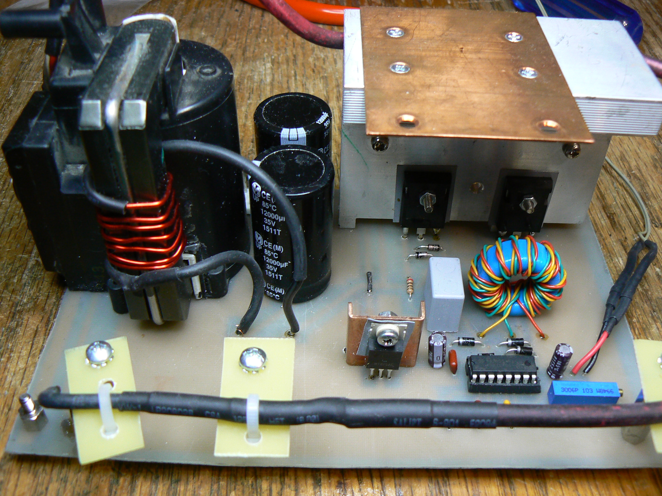

          This is the core that I am using and the one in my first picture where I twisted the wires prior to wrapping the toroid. Would there be any benefit to wrapping the toroid with the wires parallel?

            This is weird, you shouldn't be dissipating much power in the toroid transformer unless the core is extremely lossy at the frequency you're working at, or your drive is too high. And due to the nature of a transformer/inductors the gates can't be stuck on, which will help against frying them (current too high or gate drive too low are usually what kills mosfets.)
            Is there a reason why you're using 7815? I'd be worried that the output of the PWM is too high (sorry did not read the datasheet for the pwm on its output driver and how close it gets to the rails), resulting in the transformer voltage output getting very high, and it won't help drive the gate because the zener diodes will just cut you off at ~12.7 V anyway. Anything higher will simply heat the zeners, 22R resistors, and that transformer.
            I don't know if there's a reason why the original designer chose a toroid. I hate winding them and try to use split core bobbin transformer with just because they're a heck of a lot easier to wind.

                I have drawn up a new PCB that uses a driver chip between the SG3525 and toroid. It just may be a while before I have time to etch it and move the components over to it.
                You could try run it with no power to the big mosfets, just to see if they're loading down the toroid too much.
                I may give this a shot to see what happens, I will just have to cut a trace on the PCB.
                I originally wanted to make this because it looked neat and relatively simple but it is actually a lot of trouble to make it work. It is becoming way more of an educational experience than I anticipated but that is not necessarily a bad thing but it is tiresome. I am attaching a picture of the speaker as it is now in case that helps any.

                  That looks great, a good build. I can't see anything wrong there.
                  Grasping at another straw, the gate-drive transformer (output) is clamped by the zeners, and with a 1:1:1 ratio assume say 12V in and 12V out. If you run a 7815, the zeners might be conducting and contributing to the SG3525 heating up. The IRFP250's max. is 20V on the gate but 10V is enough for full on.
                  An LM317 can take >40V in max. vs. 35V for the LM7812/15
                    Re: toroidal transformer questions
                    I would add diode in parallel with the Gate's resistor, Cathode to the left, Anode to the Gate, they will help discharge the Gate/Source cap faster so it will not be on when the other Mosfet is turn ON.

                                    Well I finally had so time to mess with this speaker again. I put the diodes in parallel with the resistors as Budm suggested and replaced the 7815 with a 7812. The chip barely gets warm now.
                                    After these changes I then had another problem. The bottom arc point like the top one is a solid piece of copper that I got out of some romex. While I was messing with it I noticed the sound quality and the arcing were acting flaky. I then noticed smoke coming from around the bottom arc point. Then there was a blob of solder on my table. The solder holding this pin got so hot it desoldered itself from the PCB.
