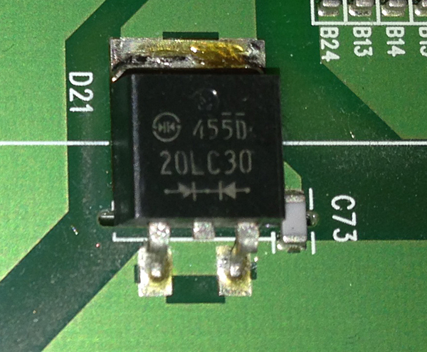

    Hi guys,
    I'm wondering if this is a mosfet or transistor, and the proper way to test it.
    Thanks,
    Mark
  • capkid
    • Oct 2010
    • 1339
    Re: mosfet or transistor?
    That's a diode. Perform these testing procedures in diode mode on your meter (pins numbered from left to right). You may have to remove the diode from the board if the readings are funky.
    Test 1:
    Pin 1 - Pos lead, Pin 2 (or the tab) - Neg lead. Expected Result: Reading of around 0.5V
    Pin 1 - Neg lead, Pin 2 (or the tab) - Pos lead. Expected Result: Open or "OL"
    Test 2:
    Pin 2 (or the tab) - Pos lead, Pin 3 - Neg lead. Expected Result: Open or "OL"
    Pin 2 (or the tab) - Neg lead, Pin 3 - Pos lead. Expected Result: Reading of around 0.5V

      That is Dual diode with common Cathode (the Cathode of bothe Diodes are tied together) in the middle big tab, the other two pins are the Anode, in this case, they are also tied together by the the circuit traces. So you can just treat and test this as one SINGLE diode.
        Thanks capkid,
        Here's my results of my test, there are two of these diodes on the board..
        Test 1: doide1
        Pin 1 - Pos lead, Pin 2 (or the tab) - Neg lead. Expected Result: Reading of around 0.5V .046
        Pin 1 - Neg lead, Pin 2 (or the tab) - Pos lead. Expected Result: Open or "OL" .OL
        Test 2:
        Pin 2 (or the tab) - Pos lead, Pin 3 - Neg lead. Expected Result: Open or "OL" 0.000
        Pin 2 (or the tab) - Neg lead, Pin 3 - Pos lead. Expected Result: Reading of around 0.5V 0.000
        Test 1: diode2
        Pin 1 - Pos lead, Pin 2 (or the tab) - Neg lead. Expected Result: Reading of around 0.5V .392
        Test 2:
        Pin 2 (or the tab) - Neg lead, Pin 3 - Pos lead. Expected Result: Reading of around .392
        I removed diode 1 from the board to double check and getting the same reading. I take it this diode is bad.
          According to your testing, both diodes look bad. Did you remove diode #2 from the board to check it?
            sorry capkid,
            for diode 2
            where i have
            it is
            reading is OL
            would you still consider this diode bad? (since I'm getting .392)
            • capkid
              • Oct 2010
              • 1339
              Your second diode appears to be fine.

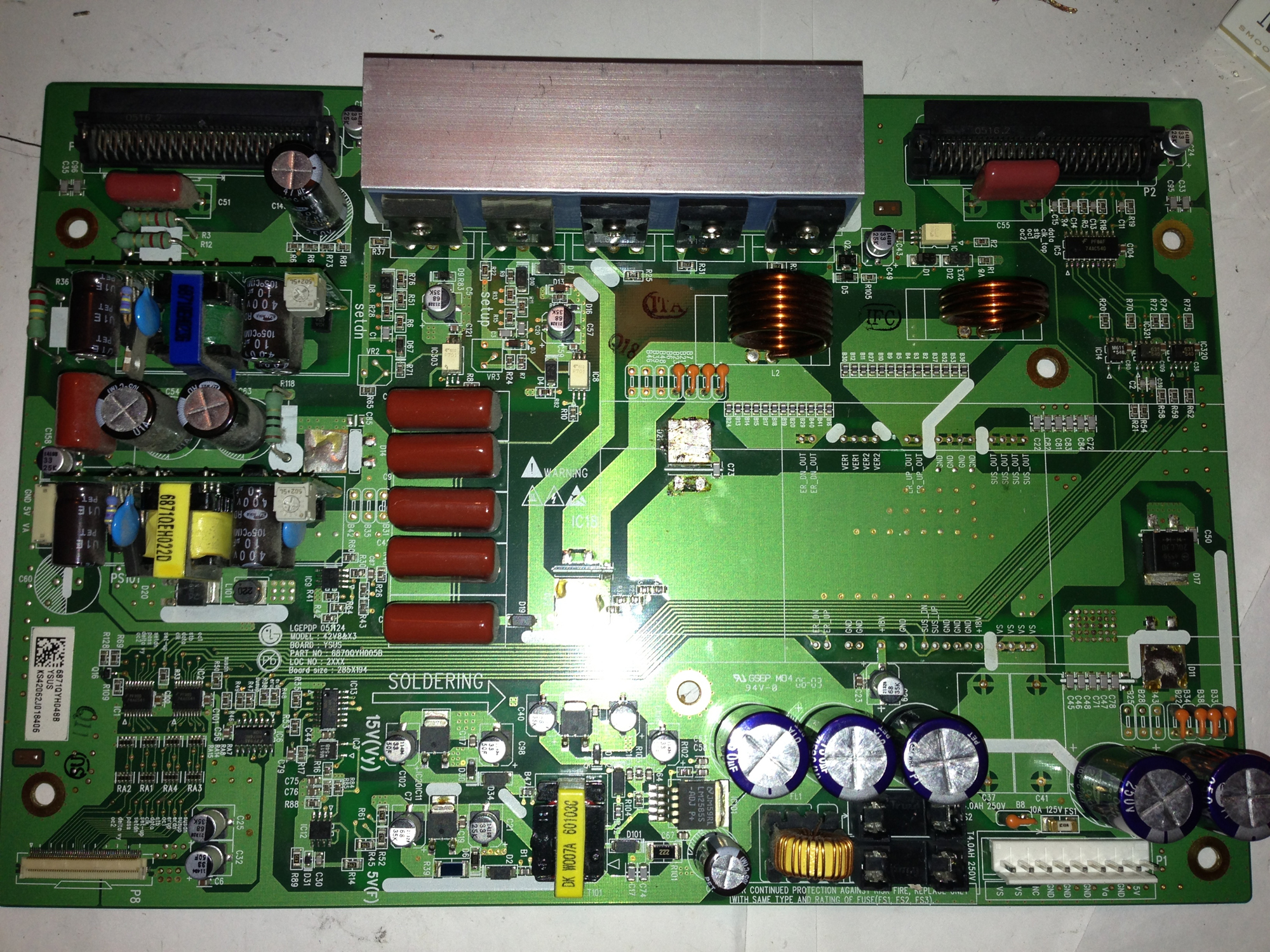

                    "The two anode spots on the board have continuity to ground". That depends on how this diode is being used, if the Anode is connected to one wire of the transformer winding, and the other end of the transformer winding is connected to ground which is typical for half wave rectifying circuit, then you will see very low Ohms reading due to low transformer's winding resistance.
                    We need to see bigger pictures of this board to see how this Diode being used.
                    I see you mention Diode 1 and Diode 2, are they the same as shown in the picture?

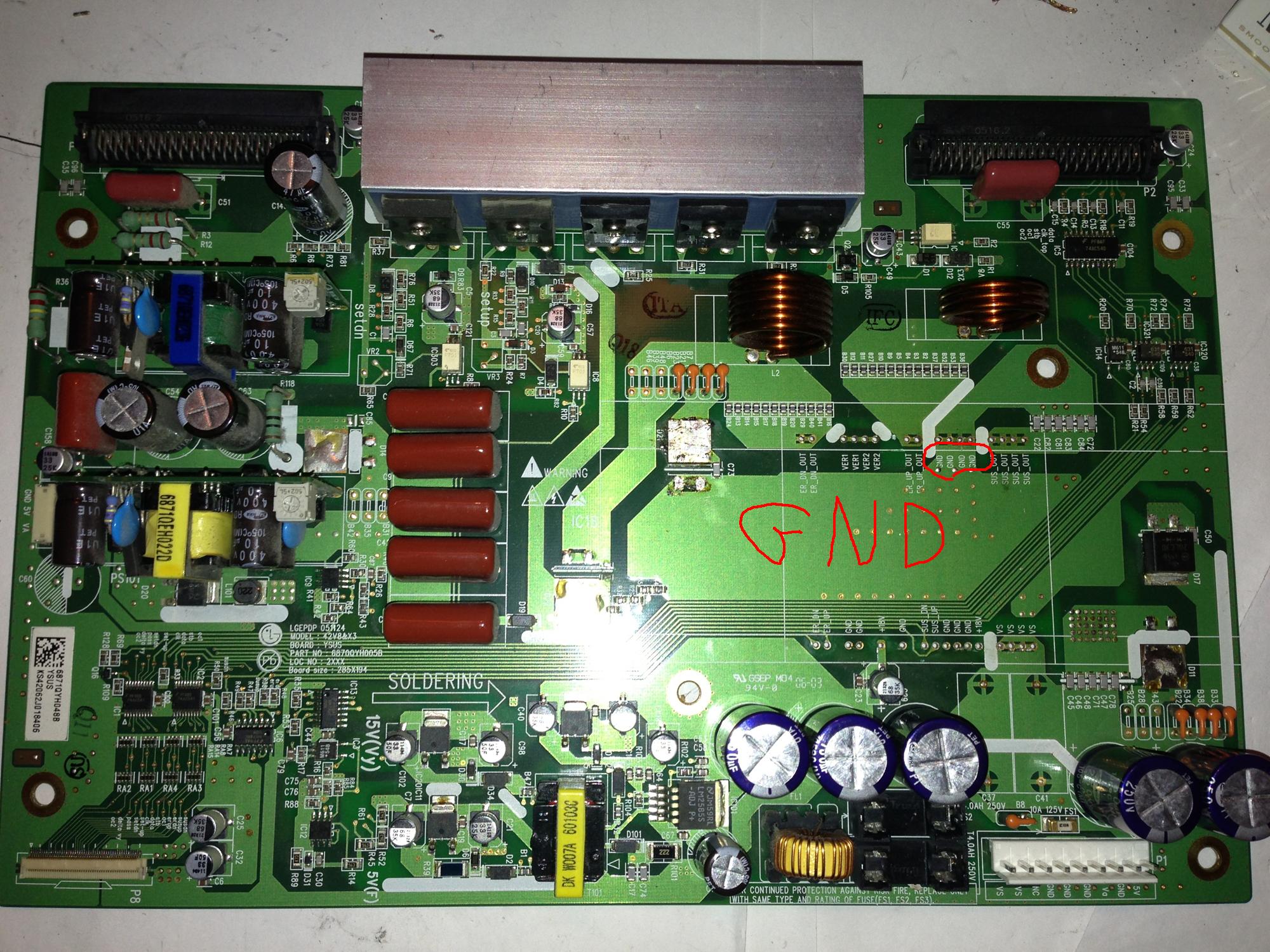

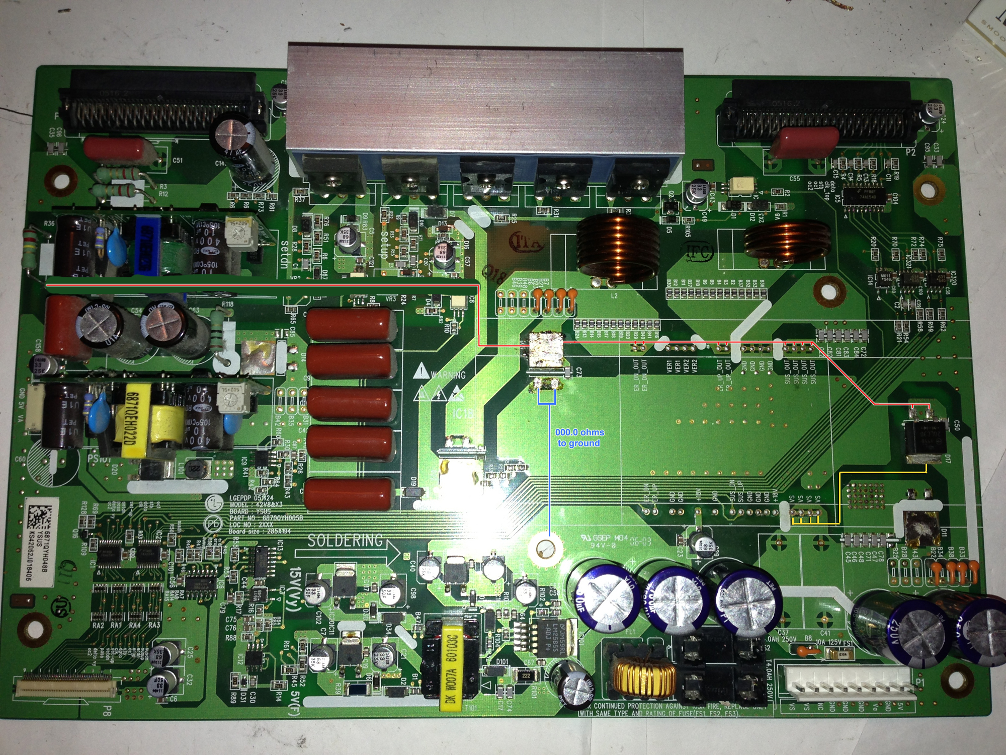

                        Hey guys,
                        cashkennedy,
                        Both sides of the anodes traces are continuous to ground. Ohm reading 000.0
                        The diode is off the board
                        budm,
                        I attached two images, one marked up and one not. Yup diode1 and diode2 are the same shown in the picture.
                        I'm just trying to rule out there's not any other problems before I install the new diode and ipm
                        thanks guys
                          The Anode of that D21 (both pins) are connected to the Ground plane, you can see the GND label on the PCB. It looks like it is for Buck regulator switching power supply. Cannot see D11 traces, but it may be the same for another buck regulator.
                            Thanks budm,
                            Just so I understand, where is the ground label on the board? Is it the dark green mask?
                              Gnd
