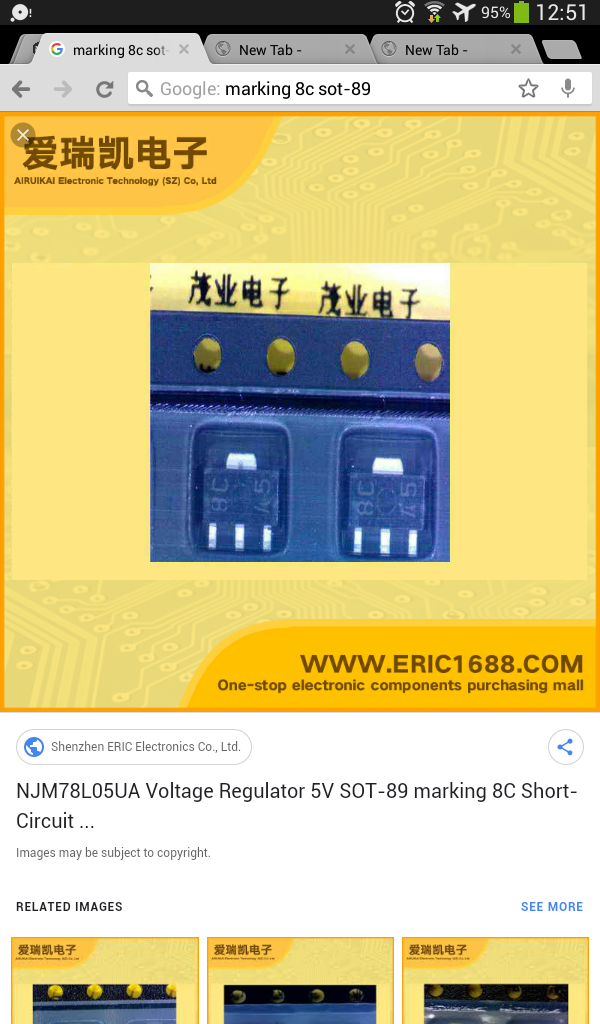

    mosfet or transistor ?
    I'm working on a LED circuit board and am testing a 8C 1A component, it has a wide ground tab on one side and 3 tabs on the other and the center tab is grounded also. the circuit board has it as a V2 component ,so is this a mosfet or transistor ?

    http://markingcodes.com/search/c/8c
    Photos would help a lot.

      Maybe 7805 in sot-89...

        If it's a transistor, that tab and center pin are probably the collector. The pin-out might be, left to right, Base-Collector-Emitter. There would be a P-N junction from base to emitter and from base to collector.
        If it's a MOSFET, the tab and center pin would be the Drain. The pin-out might be, left to right, Gate-Drain-Source. Using an ohm meter, there would be very high resistance or an "open" between any two pins.
