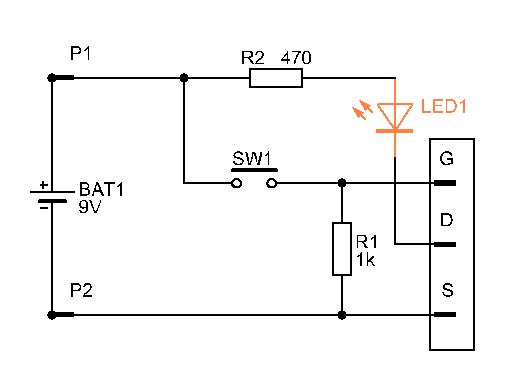

              Here's how I test N-channel mosfets with my Fluke 87. P-Channels will be the opposite:
              (1) + Drain, - Source = Open
              (2) - Drain, + Source = Reading around 0.5V
              (3) + Drain, - Source then quickly touch + to Gate and back to Drain = Voltage climbs steadily as mosfet is charging
              (4) Touch Gate and Source simultaneously with your finger(s) while maintaining probes in position to discharge = Open
              (5) Repeat step 3: + Drain, - Source then quickly touch + to Gate and back to Drain = Voltage climbs steadily as mosfet is charging
              You can also build your own cheap mosfet testers (see attachments).

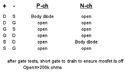

                        Re: Newbie Testing P Channel Mosfet
                        I made this table, I think it might help, or add confusion...

                          @redwire
                          thanks redwire
                          your post and table really help us to understand the testing method of the mosfet
                          can you just clarify for us, as to wether we short G-S (as in #8 post) or G-D (as in #12 post) to turn off the mosfet, or is it okay to use either method to turn of mosfet.???
