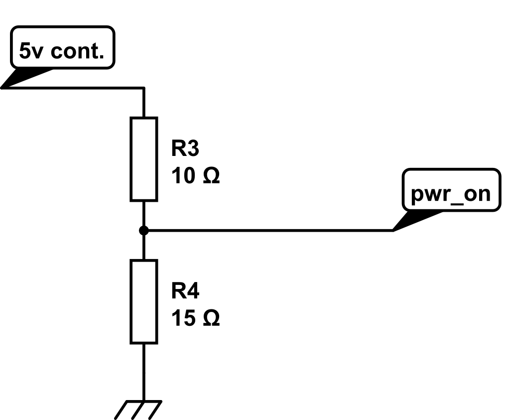

    voltage divider for vizio hack
    i have attached a small diagram for the voltage dividers the purpose of the dividers is to provide driving voltage to an older vizio lcd tv inverter board to cause it to act as a lighting fixture. my question is: will it provide the correct current at 3v to switch the inverter?
    Follow the white rabbit.
    Re: voltage divider for vizio hack
    Power on can be connected to the +5V through 1K resistor, same for the BL_ON signals, the ON signal is used for driving the BASE of the transistor, so it only need the current in mili-amp range. You will also need the dimming signal control signal which can be PWM type or analog 0~5VDC variable signal.
    The bl_0n signal should be delayed on after the power supply on signal is applied because you want the power supply to be stable first before trying to draw lots of current when the inverter is turned on.
    You should look up the spec of the LCD panel, it will give you all the pinout of the boards on the panel.

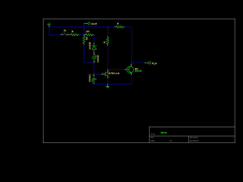

                          ok i get it now, could i replace A1 with a switch and 1k resistor to 5v stby?
                          • goontron
                            5000!
                            • Dec 2011
                            • 4108
                            • US
                            do you think this schematic will work?
                            btw the voltage on these things can cause an arc to jump, in this case to my finger! ouch
                              That is excessively complicated.
                              Just use a 10k resistor and 47uF capacitor in series; output across the capacitor. 10k limits current due to 3V logic input. Delay = 3 * R * C = about 1.5 seconds.
                                At 10K x 47uF = 1TC of 0.47 second. At 1 TC the cap will charge up to 63% of the applied voltage, so at 5V after 1TC, the voltage on the cap will be 3.15V which will be within the ON volatge range. 10K can be too high since we do not know the input resistance we are feeding, it may be enough to bias the transistor.
                                  OK, 470 ohms usually works, and a large capacitor of 1000uF gives 1.41 seconds, assuming charging up to 5V. Charging stop voltage can be lowered by adding a resistor in parallel with the cap, around 680 ohm would work.
                                    See COMPLEX CIRCUIT for parallel/sereries RC circuits.
                                    http://openbookproject.net/electricC.../DC/DC_16.html
