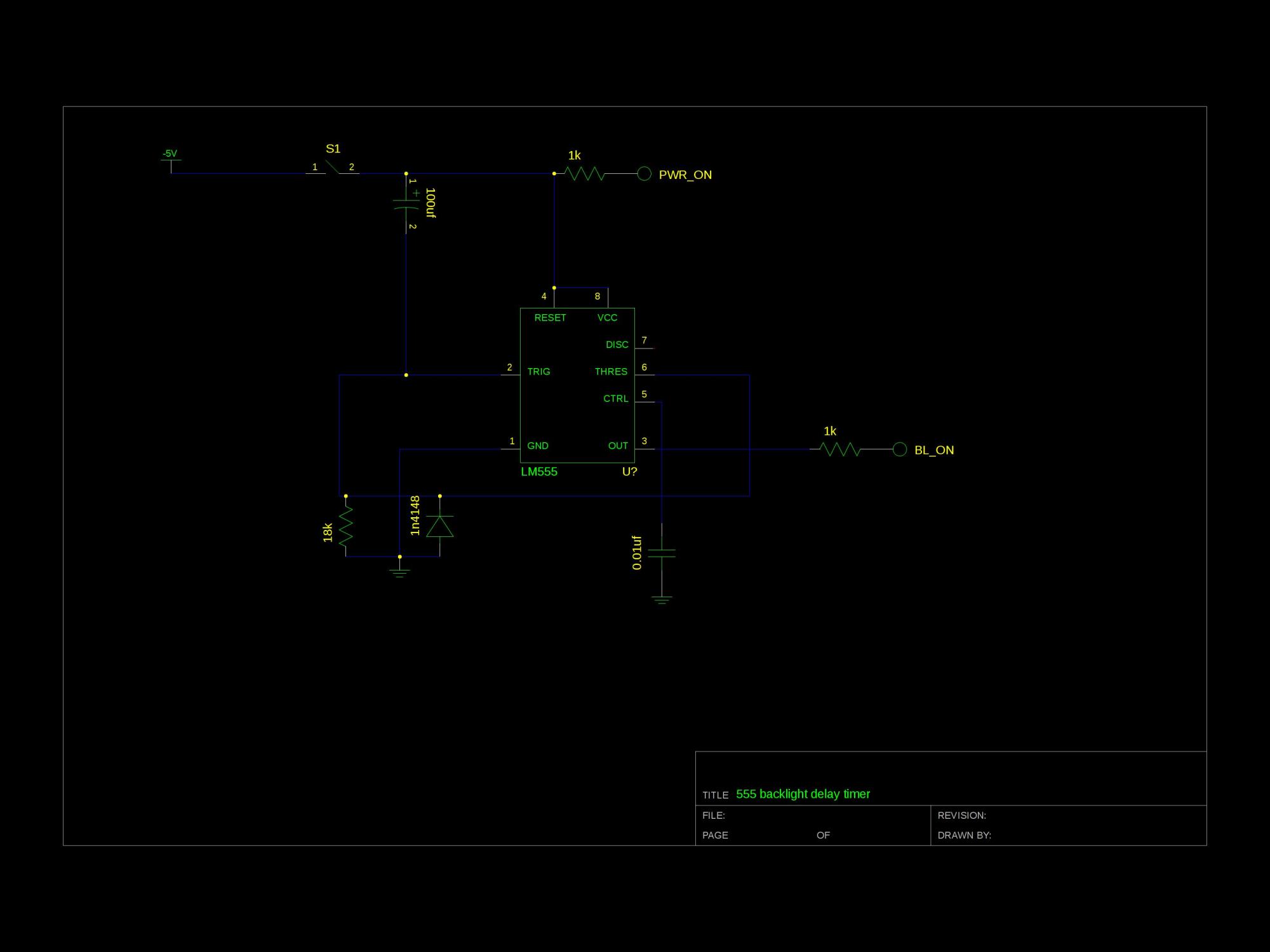

voltage divider for vizio hack
  • goontron
    5000!
    • Dec 2011
    • 4108
    • US
    Re: voltage divider for vizio hack
    ok bigger image and ziped sch file to.
    Follow the white rabbit.
      Dark back ground with dark lines, I cannot see well as is. Can you change to white back ground?
        not sure if you can in geda

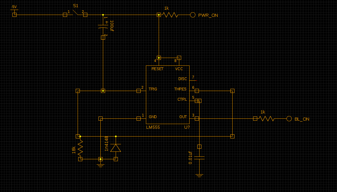

          heres on that can be seen easily
            You can change between light mode and dark mode in the options menu somewhere. But you can also edit colours from the config file. I'm quite fond of the light-on-dark schematics myself.
