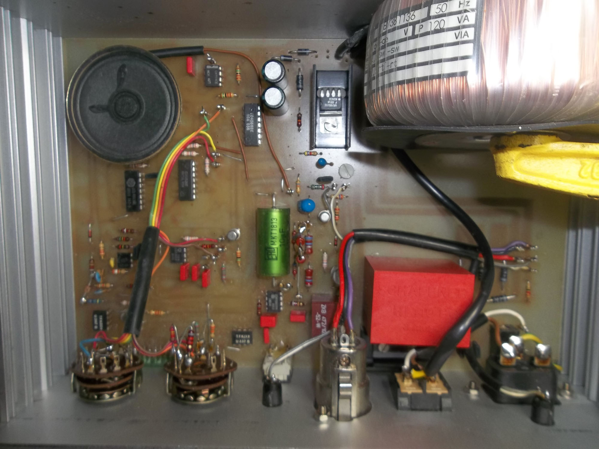

    So anyway, the machine powers up and everything seems to work correctly but, there is no output signal to the pads.
    The machine is supposed to send electric pulses to the pads, the pad has a coil inside, so if a magnet is place next to the pad you can feel the magnet pulsating, but that is not happening.
    After some troubleshooting (i'm just a hobbyist trying to learn as much as I can about electronics) I found a bad zener diode mzp4732 conducting both ways, you can see the bad diode just on top the black cap.
    I ordered, replaced and when I hit the power switch the fuse blew .
    I did desolder the diode, got another one, put it with aligator clips and another fuse blew.
    then I put it in opposite direction trying to check all the possibilities and again another fuse. So for now i'm out of ideas, if anybody can help me with some ideas I would gladly appreciate it.

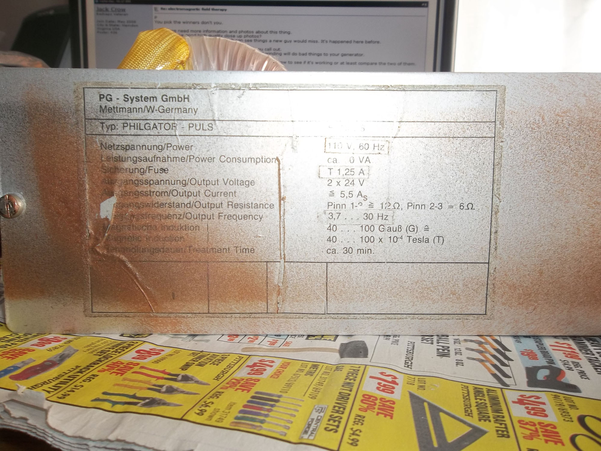

        Photos of the front panel, OEM's name and if there is a plate on the back with the tech data? Some have FCC ID numbers or UL data. Might be able to back into the service info that way.

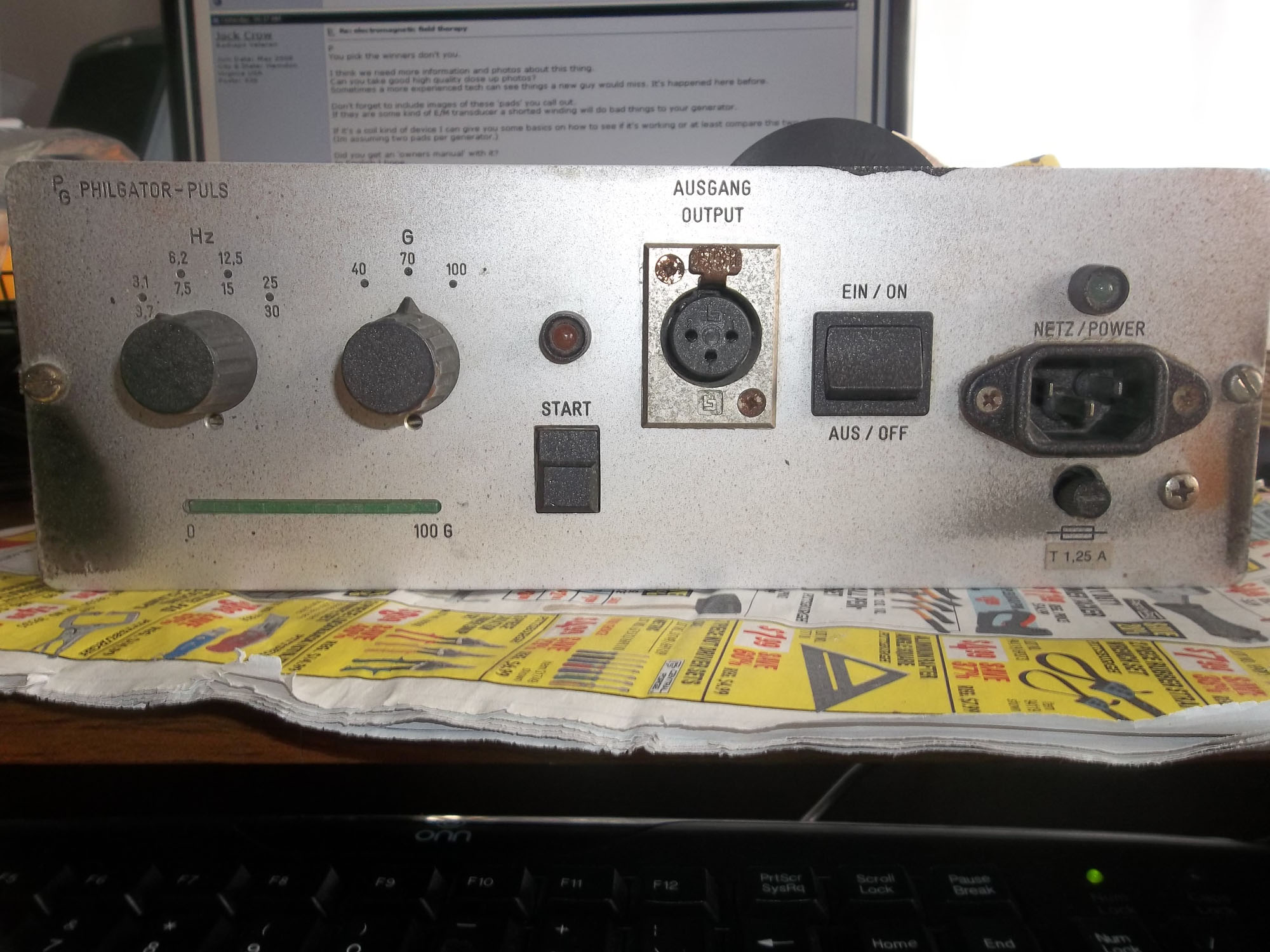

          Front panel pictures of the unit, back panel, how the transducer is connected to the unit. The board looks like home made board since there are no designators at all for the component on the board.
          Also pictures of how the wires from the Toroid transformer are connected to the board.

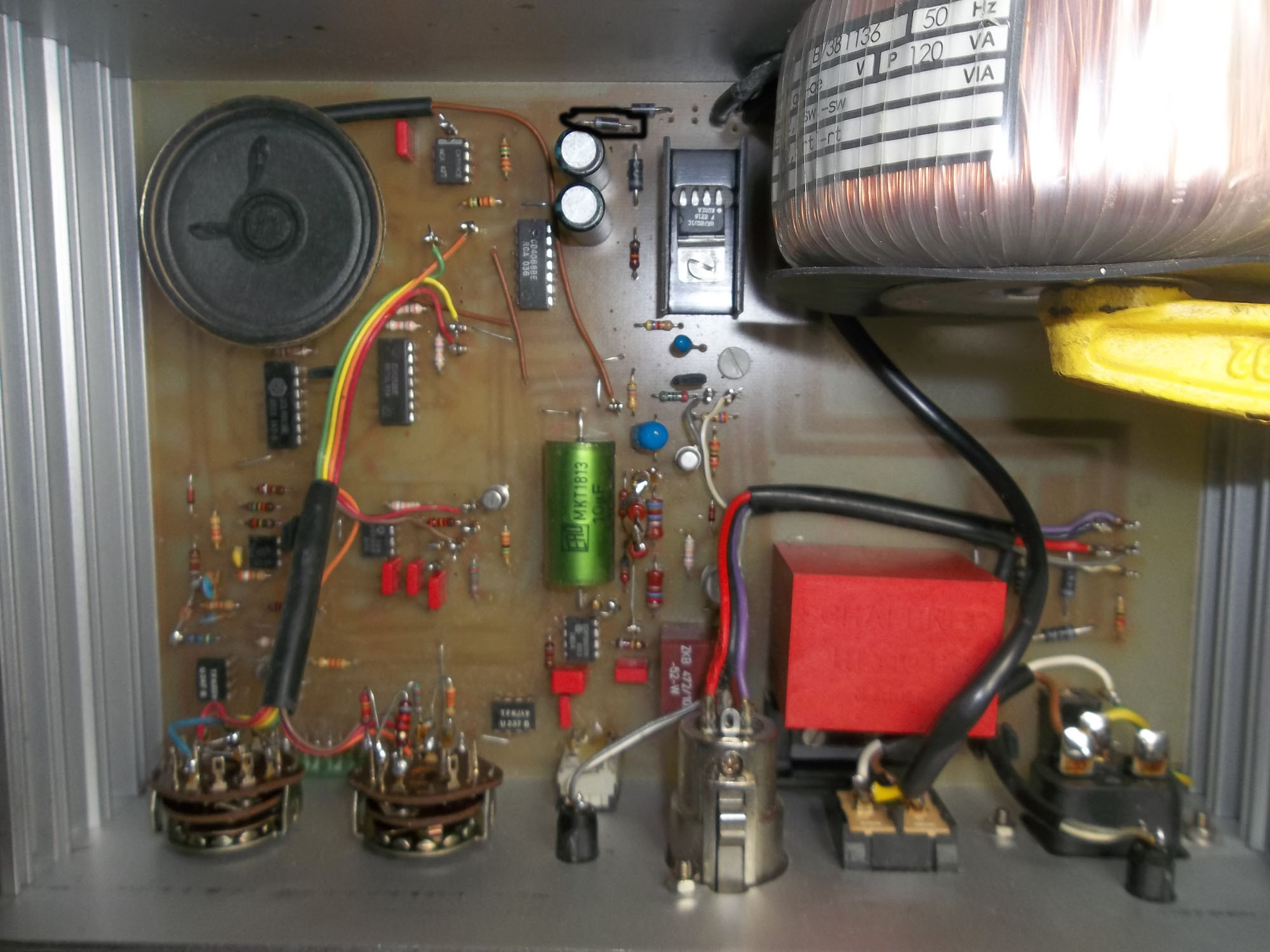

              Looks homemade or given the vintage, a prototype/short run. The PCB layout was done by hand.
              Also a bit of bodge work... I see a lot "jimmied" components (axial parts soldered between component terminals, bare leads intentionally shorting pads, etc.).
              I kinda doubt you will find a schematic... unless, of course, it was out of a magazine or other publication.

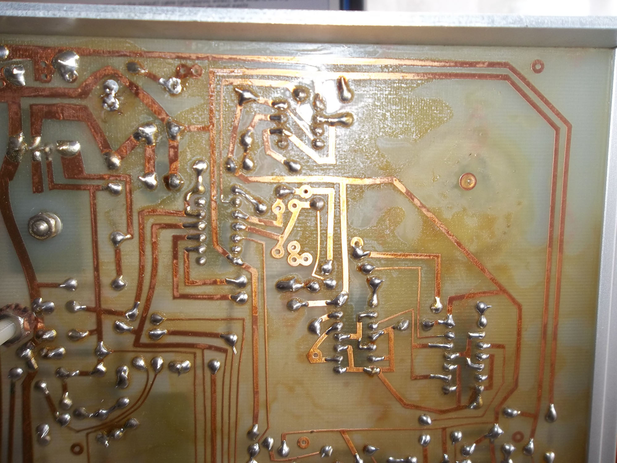

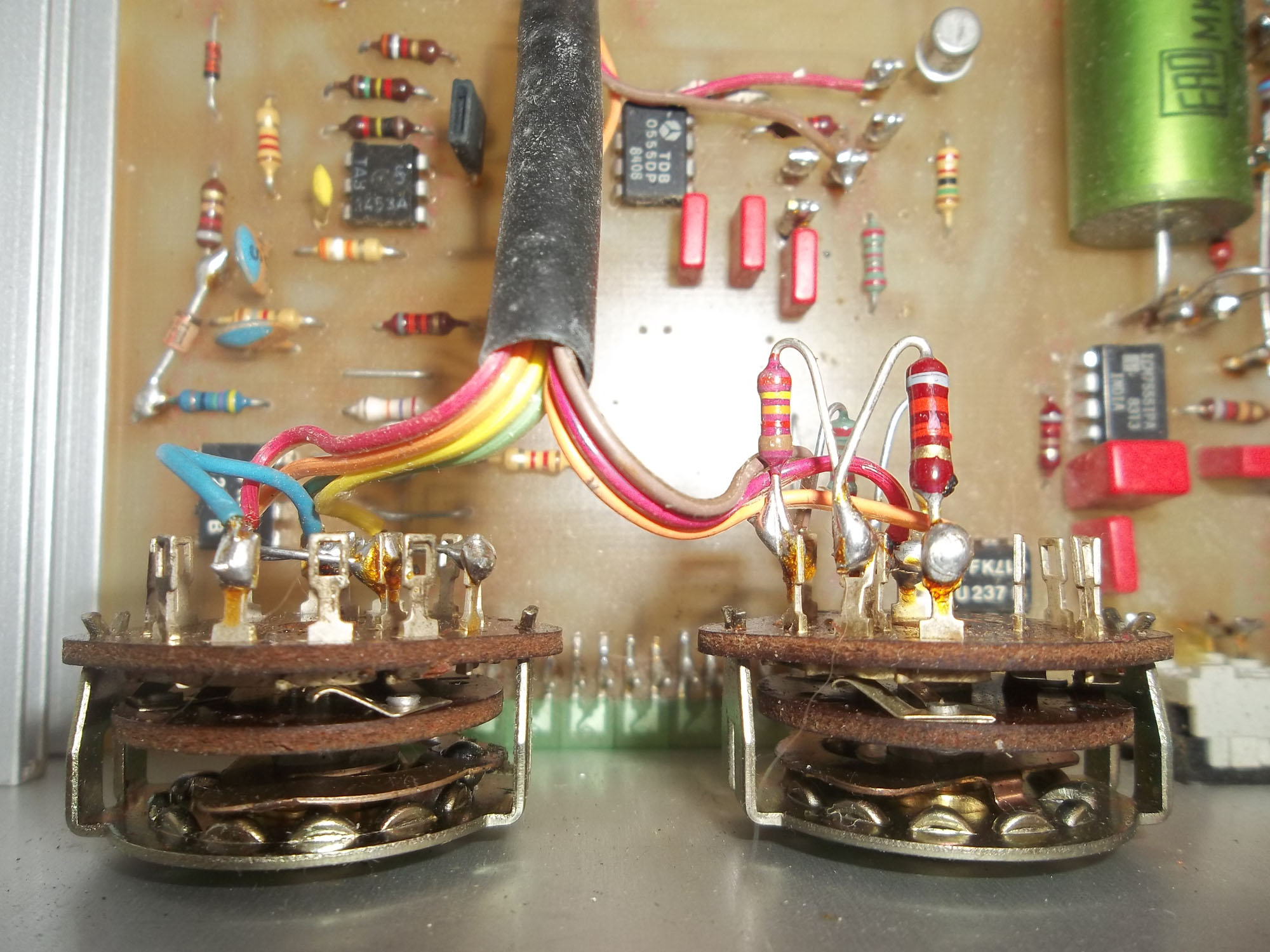

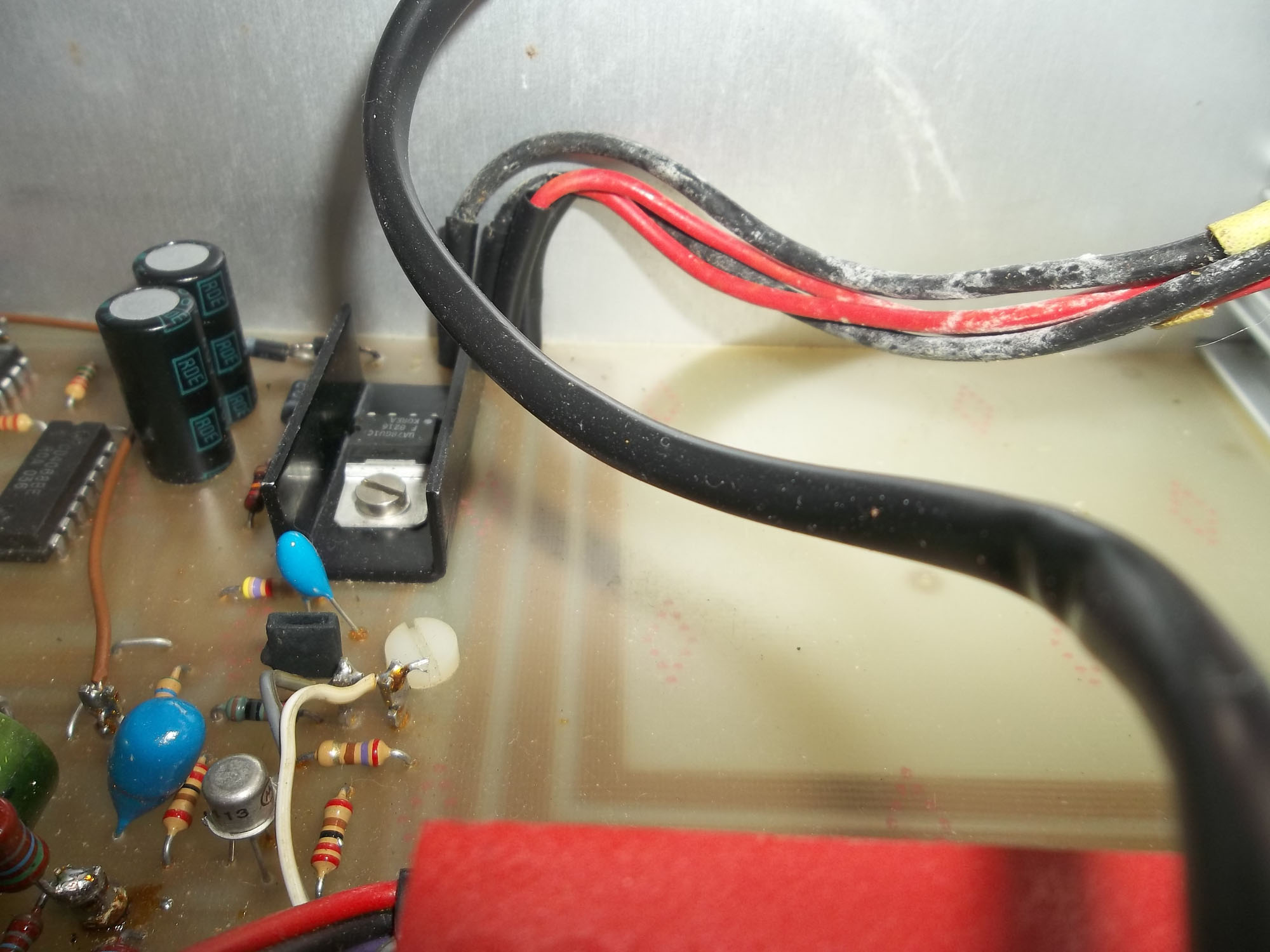

                i took some close up pictures this morning like Jack Crow suggested yesterday.

                The zener, (if it's between the two caps and the heatsink) is in series with the neighboring diodes. It seems to function as rectifier/power-feed for the UA78G voltage regulator (on the little heatsink). The diodes would lower the incoming AC to a voltage the Vreg can handle (max. 40V) and something the black electro's could take. What rating are the caps? A shorted zener might over-voltage them.
                the caps are 220 microF 40V, and yes, both zener are in series and both are 4732 4.7V. the next diode is a regular 4003. also what's up with those zener in the same direction and both being the same value? to me the second zener would only see the fixed voltage from the first, am i right?
                Originally posted by redwire
                I would check all the diodes, by the black caps and the output? cable (gry/red/vio wires), and what is the big heatsunk part below the big red box (mains EMI filter?). It looks like an SCR or triac. They do short easily.
                i have checked those three diodes around the black caps and the bad one was that one (the one on top of the black cap).
                i have also check those wires, it was the first thing i did because the only problem with the machine was not getting signal to the pads, everything works, even the led in the front cover blinks as fast as the pads should, that's why i though the problem was in the output.
                the diodes next to the red box looks fine, but the one next to the red box has the brigde under, so i dont know what they were trying to achieve there.
                in the big heatsink below the red box there is a 2N4444

                i attached a pic of one of the pad, the machine can work with one or two pads, in order to use two pads there is a extension cord with two outputs.

                What concerns me is that ugly wire bridge on the bottom of the circuit board.
                Is that photo of the 'stock' condition of post repair?
                you have good eye! i have the same concern,i dont know what that bridge is doing there either! that is the diode next to the red box, it doesnt sound very smart putting a diode, and then make it useful soldering a bridge under.

                the first zener i soldered blew, the second one i tried with alligator clips in series with the neighboring diodes, and this one survived. but the fuse didnt

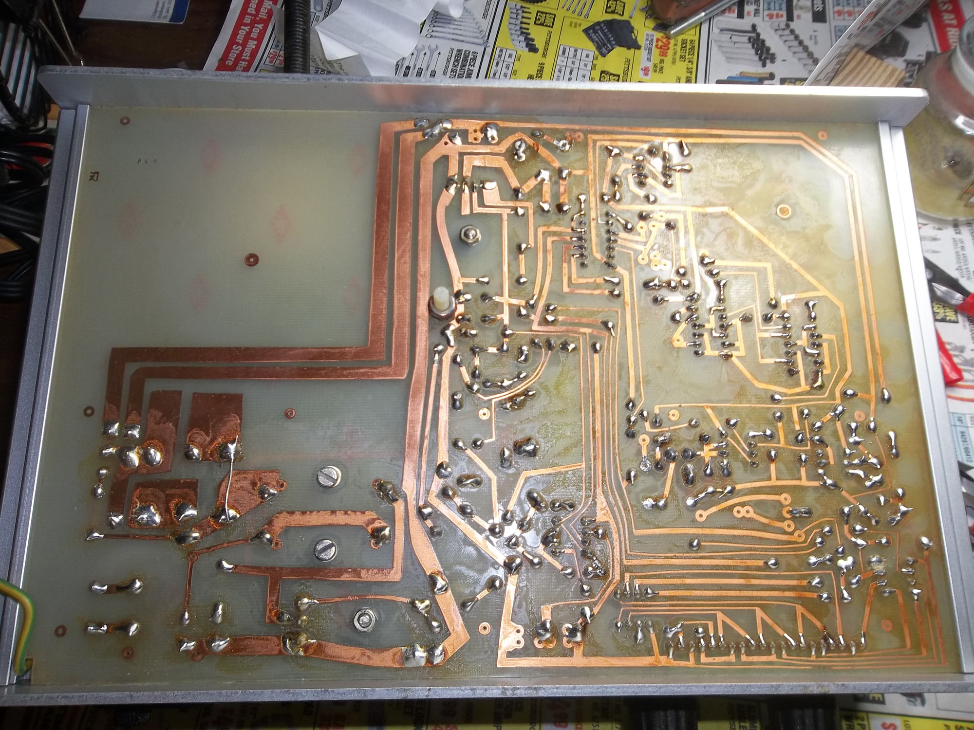

                it really looks homemade, but he paid more that 4 grand in the 82 for it, just the machine with no pads, but he has helped hundreds of animals with it to recover from bone fractures, dogs and cats after being hit by cars...the machine really works.

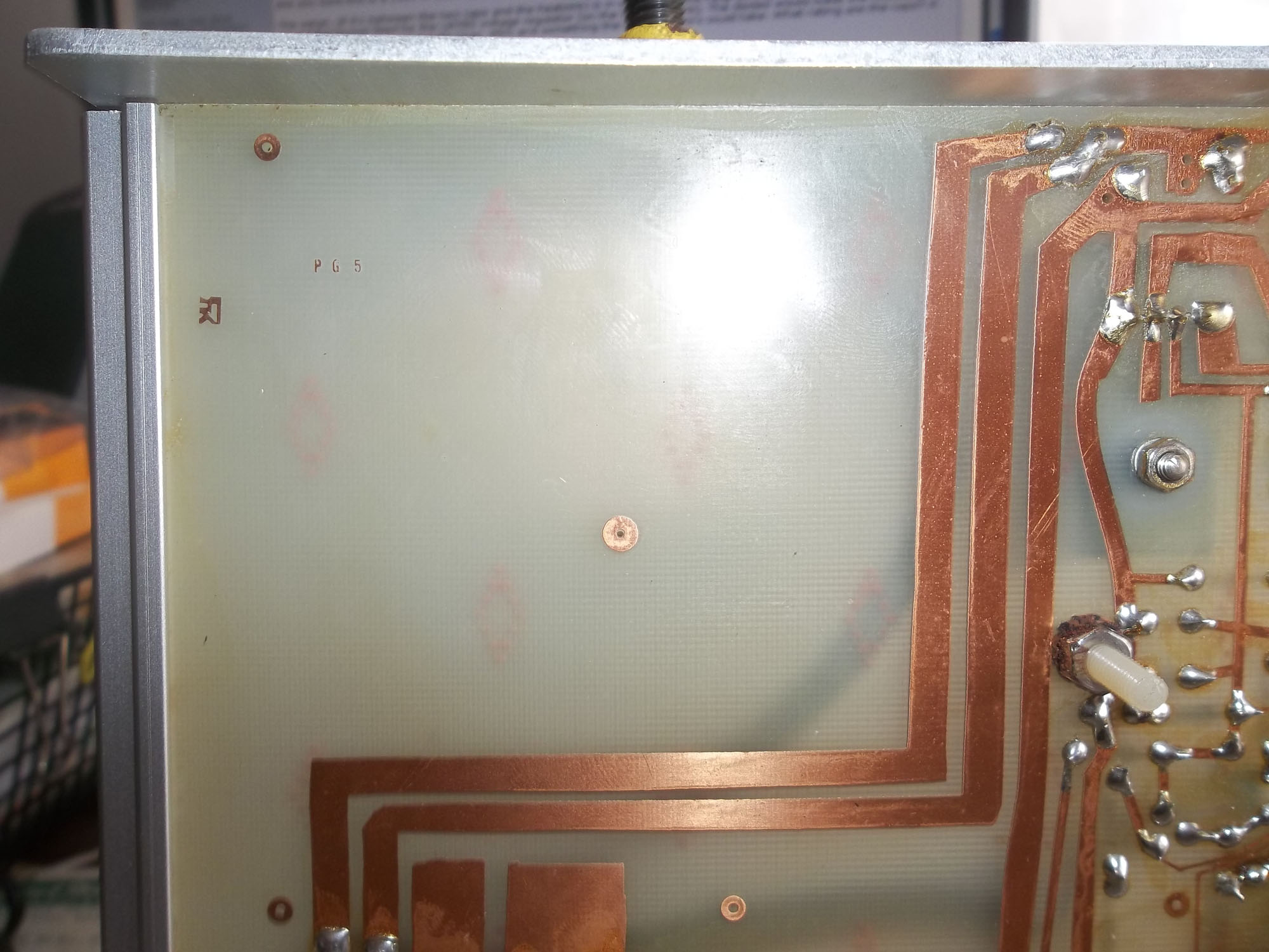

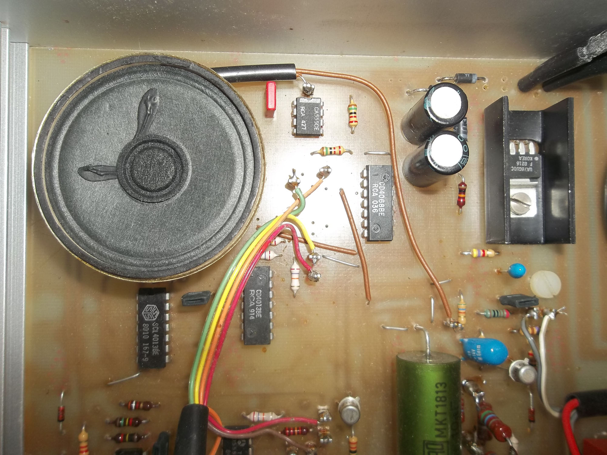

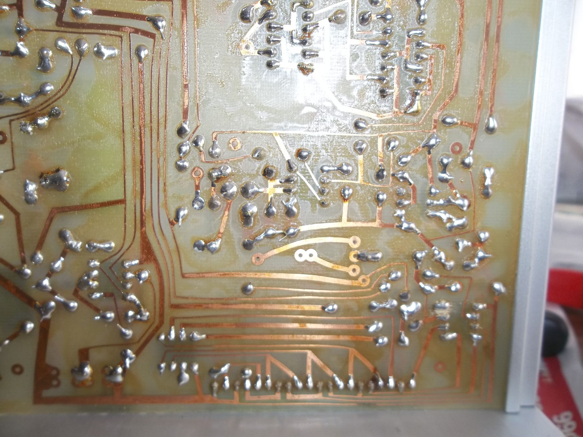

                  Re: electromagnetic field therapy
                  sorry, forgot the pics!
                  have a great day!

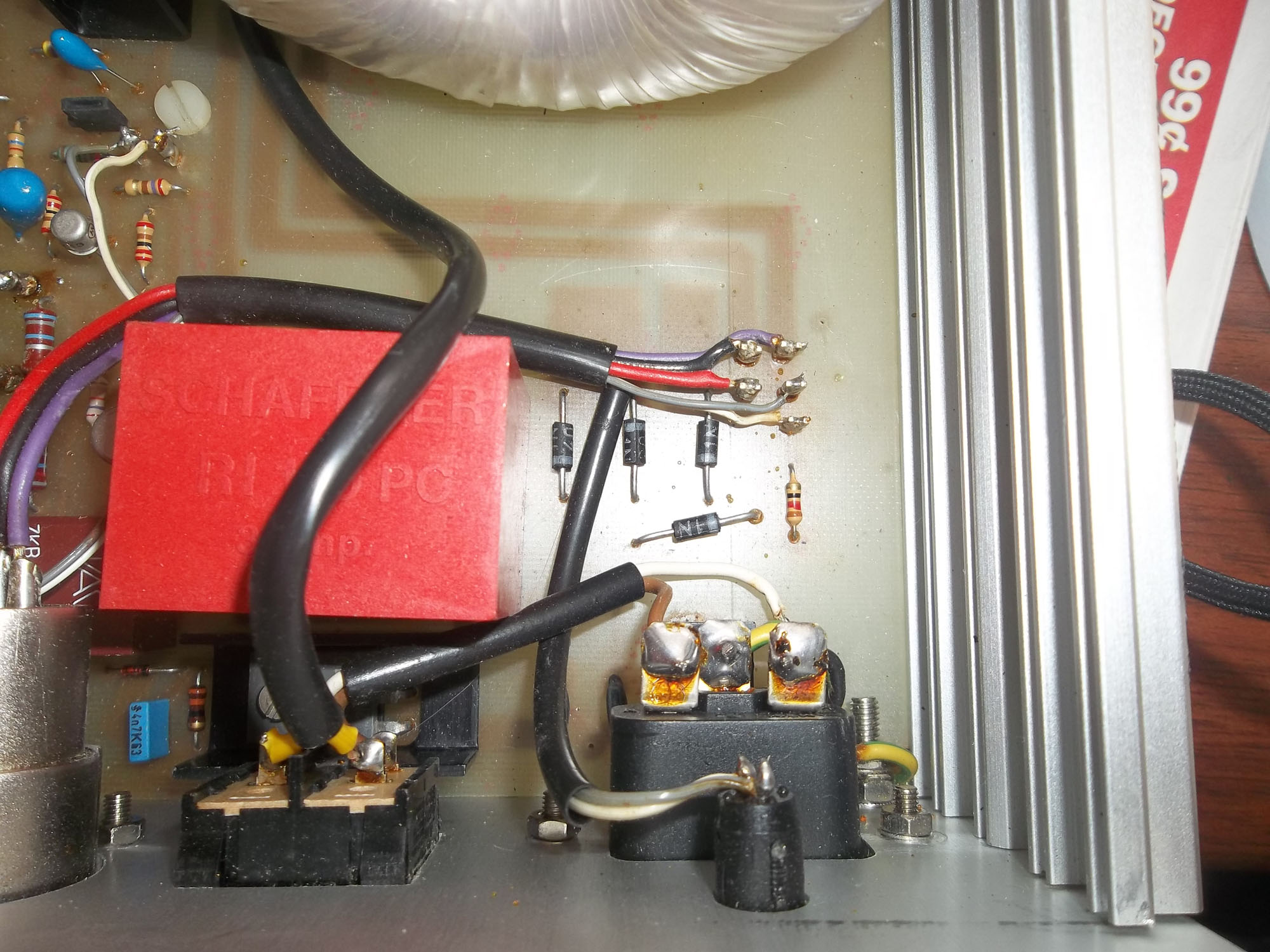

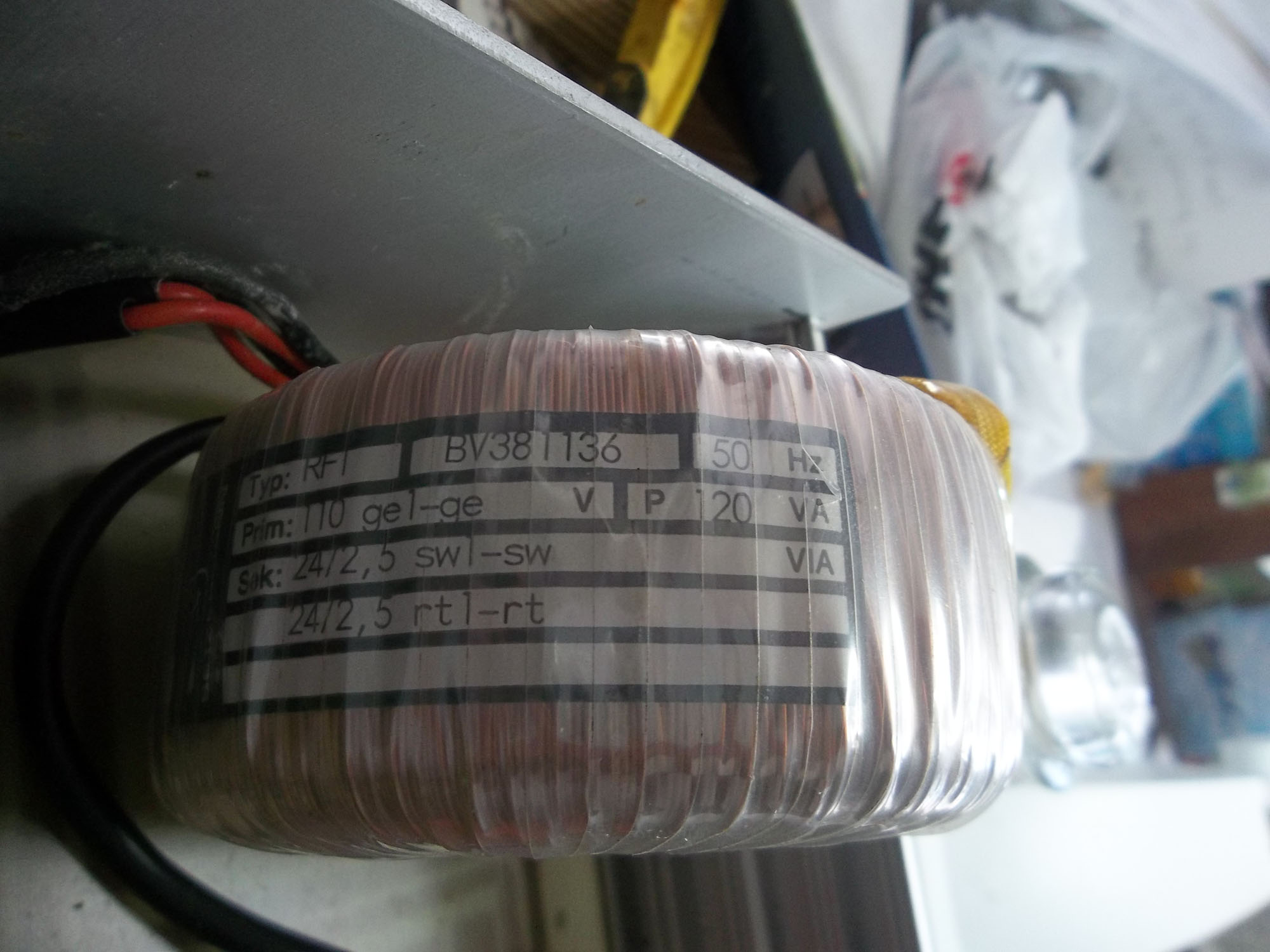

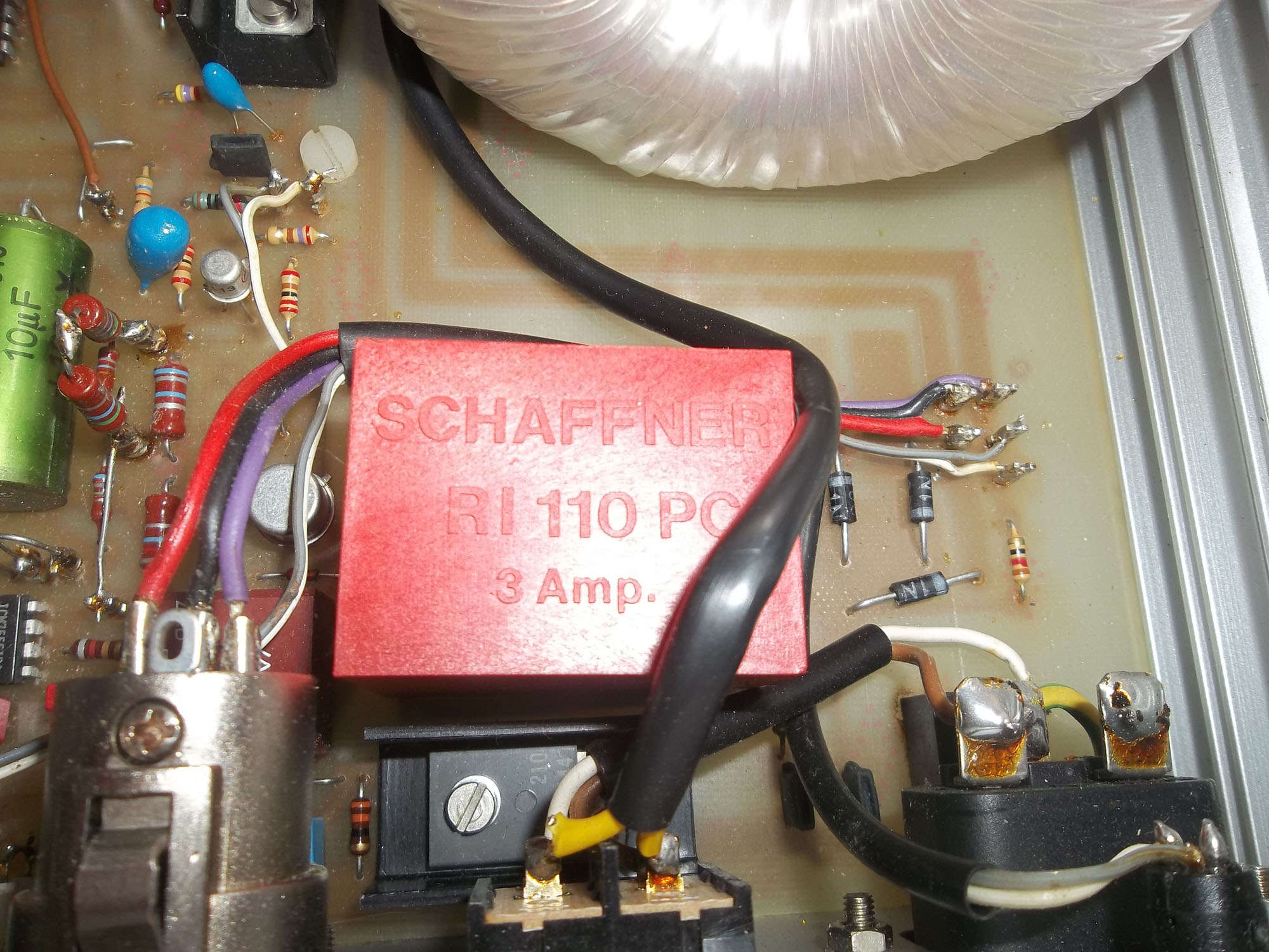

                    Is there any labeling on the Toroid transformer? I see two red wires and two black wire connected to the PCB, any info on the transformer as to what they are?
                    Also that red module, do you have the name and P/N on the top of it? I cannot see it clearly.
                    • petit
                      • Jan 2013
                      • 119
                      a picture is worth a thousand words!
                      yes two red and two black to the PCB
                      Thanks!

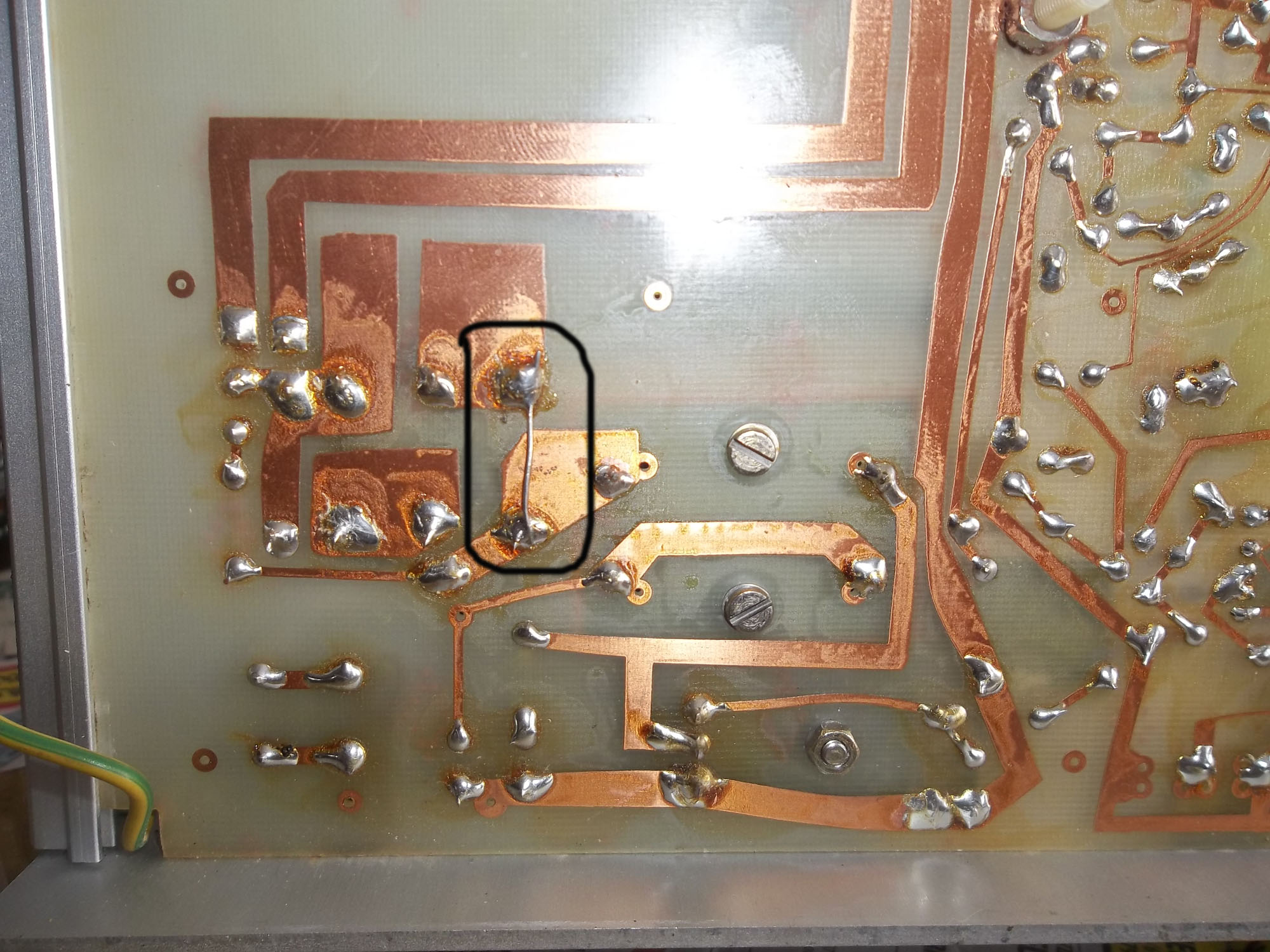

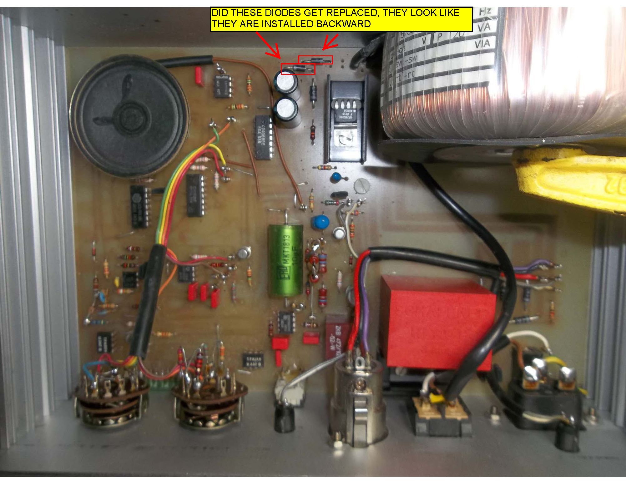

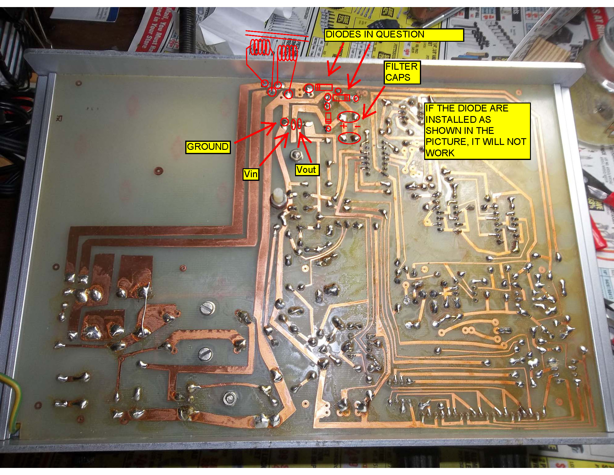

                        OK, I am trying to draw up the diagram. Can you please circle the Zener diode you have replaced?
                        • petit
                          • Jan 2013
                          • 119
                          there you go!
                          thank you
                            Please the picture.
                            Hmm, I draw up the connection, that Diode should be regular rectifier.
                            The mzp4732 is printed on the Diode? How about the other 2 Diode closed by?
                            • petit
                              • Jan 2013
                              • 119
                              i didnt replace them myself,
                              that is why i think those people messed it up! i just spoke to my friend and he told me the machine was in their custody for some time and after that they refuse to fix it for him.
                              what do you think about that wierd bridge shorting that diode? (pic pemf11)
                              thanks a lot!
                              • petit
                                • Jan 2013
                                • 119
                                yes, mzp4732 is printed in both, the top ones are both the same in series, and the next one is a regular diode 4003 and after that split to the capacitor and to the voltage regulator
                                  OK, please look at my redlined based on how the two diodes are installed.
                                  That RED modue is slome kind of power suply module (not 100%) that are being fed by the second power supply.
                                  Did this unit work at all before you have done any repair to it?
                                  • petit
                                    • Jan 2013
                                    • 119
                                    the machine powers up, and start the treatment, when i hit the start button, led diodes blink but nothing happen in the pads.
                                      But right now it is blowig the fuse? The same size anf type of fuse being used? since Toroid transformer has VERY high inrush current.
                                      • petit
                                        • Jan 2013
                                        • 119
                                        Yes, right now blowing fuses, after i replaced the bad zener diode (the black one is the one that came, that i put back for the picture)
                                        i put a lower rating fuse, the original one is 1.25A, but couldnt find that one locally so i put a 1A. I have the 1.25 ordered. maybe that is a posiblle problem beside the diodes?
