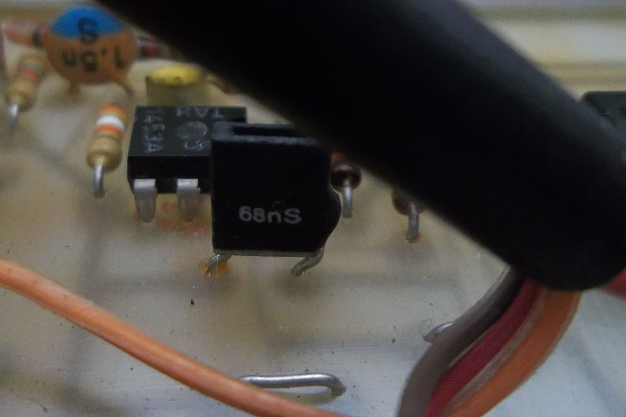

      Re: electromagnetic field therapy
      Hi!
      anybody know what is that part with 68nS printed?
      there are two of them after the SCR gate and before the choke that look pretty toast
      Thank you!
        On the pcb I see a few of those oddball black square parts and guess that they are boxed MKT film capacitors 68nF Siemens? They are pretty reliable and look okay, no toast.
        I'm not sure what the unit is doing now? Is it still blowing fuses? Do you get +15V from the Vreg? You put in the bigger 5W zeners, changed a few cmos chips and I'm not sure where things are at.
        For the two blue blob capacitors (tantalum) can you read the #'s off, as they can short if over-voltaged.

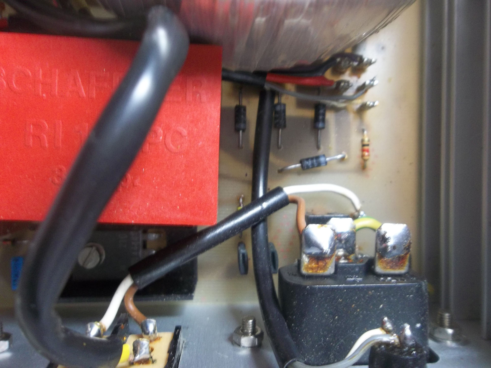

                          output side, grey/white wire goes to Red Led
                            #73

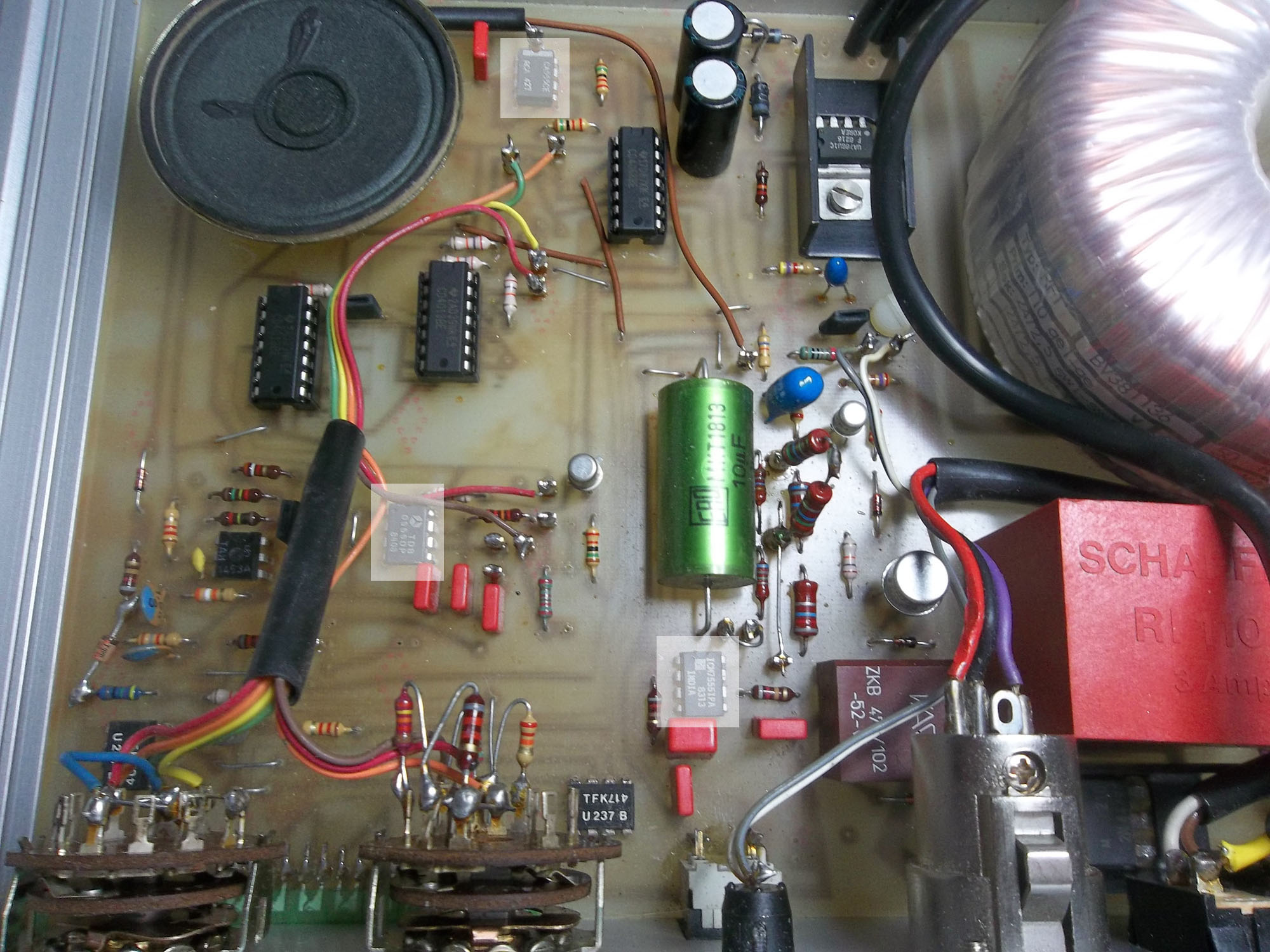

                                #75
                                I was thinking maybe one of the 555 timers is damaged? the one that trigger the pulses to the pads?
                                the machine has three, one for the speaker, another one for the green LEd's and the other for the pads?????
                                  #76
                                  You can check at the output pin (pin3) to see any action on all of them.

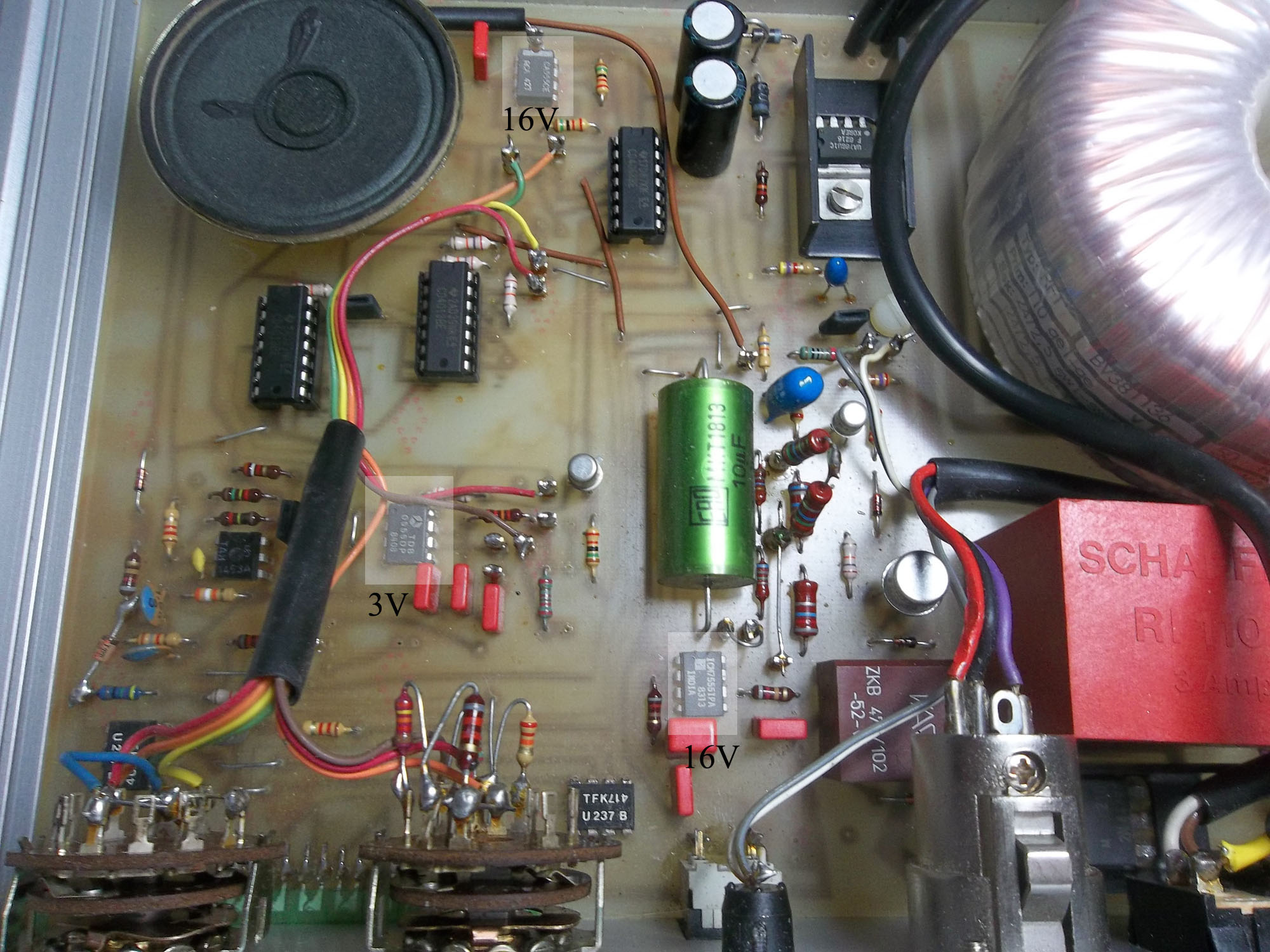

                                    #77
                                    I just checked the 555 and the results were 16V in two of them and 3V in the other. is that possible?
                                      #78
                                      What DC voltage do you get at pin8? If you are seeing 16V at output pin 3, then the VCC on pin 8 must be even higher which means that the Voltage regulator IC is putting out too much DC, redwire had indicated that it should not be higher than 15V or 16v on thread 49
                                        16.19V on pin8 on all of them. i double check and still getting 3V in that one. could be that the problem? damage 555 timer?
                                          #80
                                          May be, it depends on how the 555 is set up to be, the one with 16V out put may not be setup as Oscillator. You can put your meter to AC mode and take the reading at the output pin of all 3 555 to see what you read.
