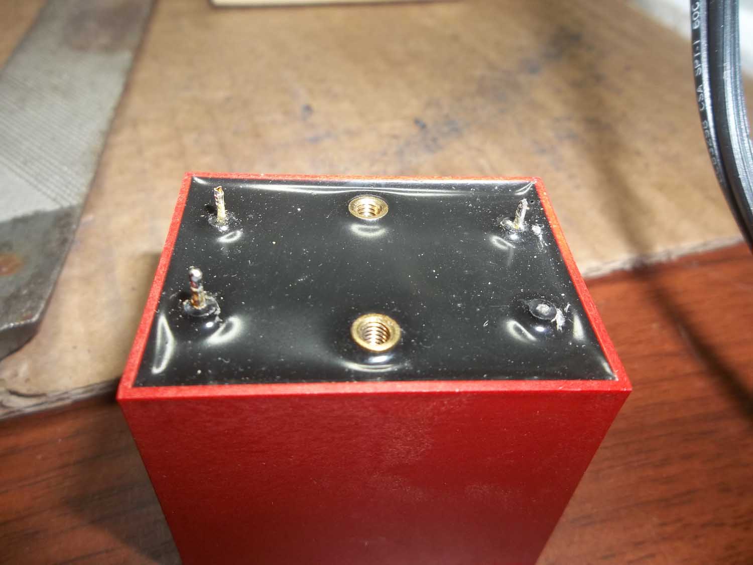

              there it is! it's not shorted
                #207
                Re: electromagnetic field therapy
                is that the choke? Broken pin?
                • petit
                  • Jan 2013
                  • 119
                  #208
                  Yes, , as soon as i apply heat to that pin, it started moving, what's the best way to fix it?
                  make a hole next to it with a hot needle????
                    #209
                    Well, it is a goner.

                      #210
                      i'm going to try to fix it that way, if it works, fine, if not, i'll order the replacement. the replacement takes 8 weeks or more to get here, so in the meantime...
