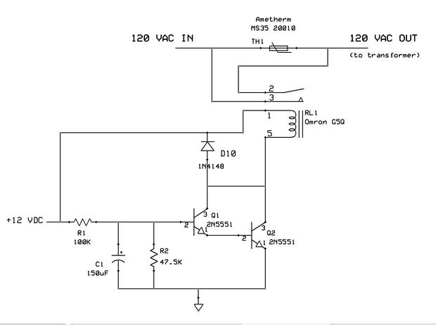

    The idea is to switch off the thermistor after a couple seconds, to keep it cool and ready to manage the next inrush current (as opposed to always hot).
    What do you think of this circuit? Could it be simplified any more?
    Could it work as is for 230VAC?

    Simpler than this would probably be to use a single PIC microcontroller, a decoupling cap, a 5v relay, an npn/darlington and a diode. This way everything can run on the 5v standby rail... the relay shouldn't use more than 50-100mA.
    The pic would have internal oscillator, brown out reset, watchdog timer etc, resets automatically when power is lost, and gives you the ability to set a proper timer until you trigger the relay.
    http://www.digikey.com/product-detai...%2FP-ND/665881
    For 0.58$ it's a nobrainer.
    With the above circuit, I'd be concerned if there's a half a second or so power loss, the system may reset suddenly and your circuit still overrides the thermistor and the capacitors pull more amps than the fuse.
    But in real life, the capacitors probably won't discharge that fast.
    In regular power supply, it's not the transformer that pulls current, it's the large capacitors. In linear power supply it's the transformer, especially if it's a toroidal one.

      Looks very simple already.
      As for it been able to do 230 vac no problem if using a relay with contacts rated for 230v.
      This circuit is only one time though, If the ac drops long enough for the transformer to demagnetize and short enough for the relay/12v to not dropout will still get high inrush current from the transformer.

        Re: Relay controlled PSU thermistor
        I'm thinking about applying the idea to a typical PC power supply.
        Many middle/high end PC PSUs came nowadays with relayed thermistor/s, v.g.:

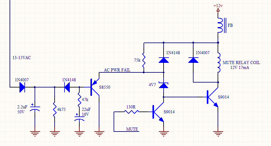

              That style of relay time-delay has never worked good for me. As the cap charges up (to it's whopping 1.4V), the transistors gradually turn on and the relay pulls in "soft" and slow. It does not have crisp switching action. Also, I don't think you'll get a few seconds delay with 150uF/100k to only 1.4V. You would add a zener so the cap has to ramp up to, say 6-9V. If the 12VDC supply ever fails to come up, the PTC will get cooked.
              Here's a schematic of a (audio mute) circuit that I found works well although it takes a while to figure out. It's not my design but clever enough with one transistor doing a lot of work.
              On power-up the S8550 is on (=relay off) until AC is present (which biases S8550 off) AND the 22uF cap has charged up. The mute input is a manual override to turn off the relay and mute things.
              The power-up delay is set by the 47k/22uF/75k to a couple seconds.
              The hold-timer delay (for AC mains sags and brownouts) is set by the 2.2uF/4k75 pair

                Can't you just use a relay that switches on at ~220 VAC with the coil between out and ground?

                  I think cheapie's suggestion is right (and cheap!), instead of using the output of the +12 or +5VSB just have the relay turn on whenever the main high voltage capacitors are charged up to their appropriate voltage - perhaps just use a 220VDC coil relay across the input high voltage capacitors. Once the capacitor's voltage is high enough the "inrush" is over and the relay can just short out the inrush resistor and we save a few watts of power there.
                  This should work fine if we lose power for a second, depending on how much the caps discharge the relay would open up only if the caps discharge enough and thus need to worry about inrush again.
                  The question is how much is "enough". This will determine how feasible this solution is. Ideally the open threshold should be fairly high so that we don't have real inrush problems, but not so high that a temporary drop on cap voltage will open up the relay and now the psu needs to draw power through a really resistive inrush resistor... and the computer crashes...

                    You may well be right eccerr0r.
                    But it catches my attention that all, or nearly all, OEM PSU thermistor relays I see feed coil with 12VDC.
                    I'm just wondering ...
                    · As the worst of the inrush current is over very quickly, after just a few milliseconds:
                    · And since there must be (I guess) some time delay in milliseconds from the instant of switching the PSU on until the +12V rail is fully alive and kicking.
                    · And since the relay takes some milliseconds from receiving the +12V juice to the closing of contacts.
                    Could it be possible that the 'natural delay of things' is just OK for this task, no extra delay circuit is needed, and that's what OEMs are doing (feeding the relay directly from the +12V rail)?
