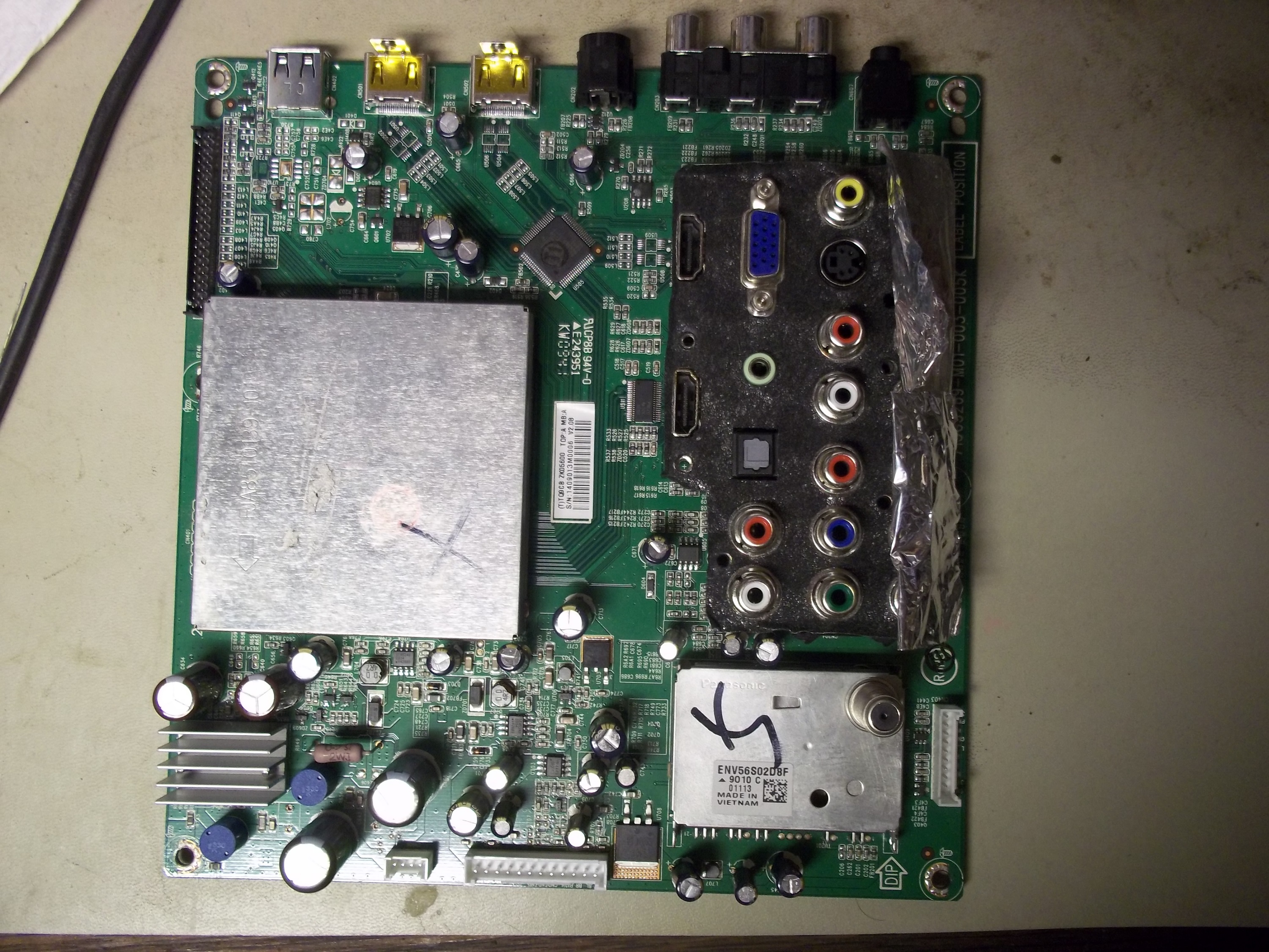

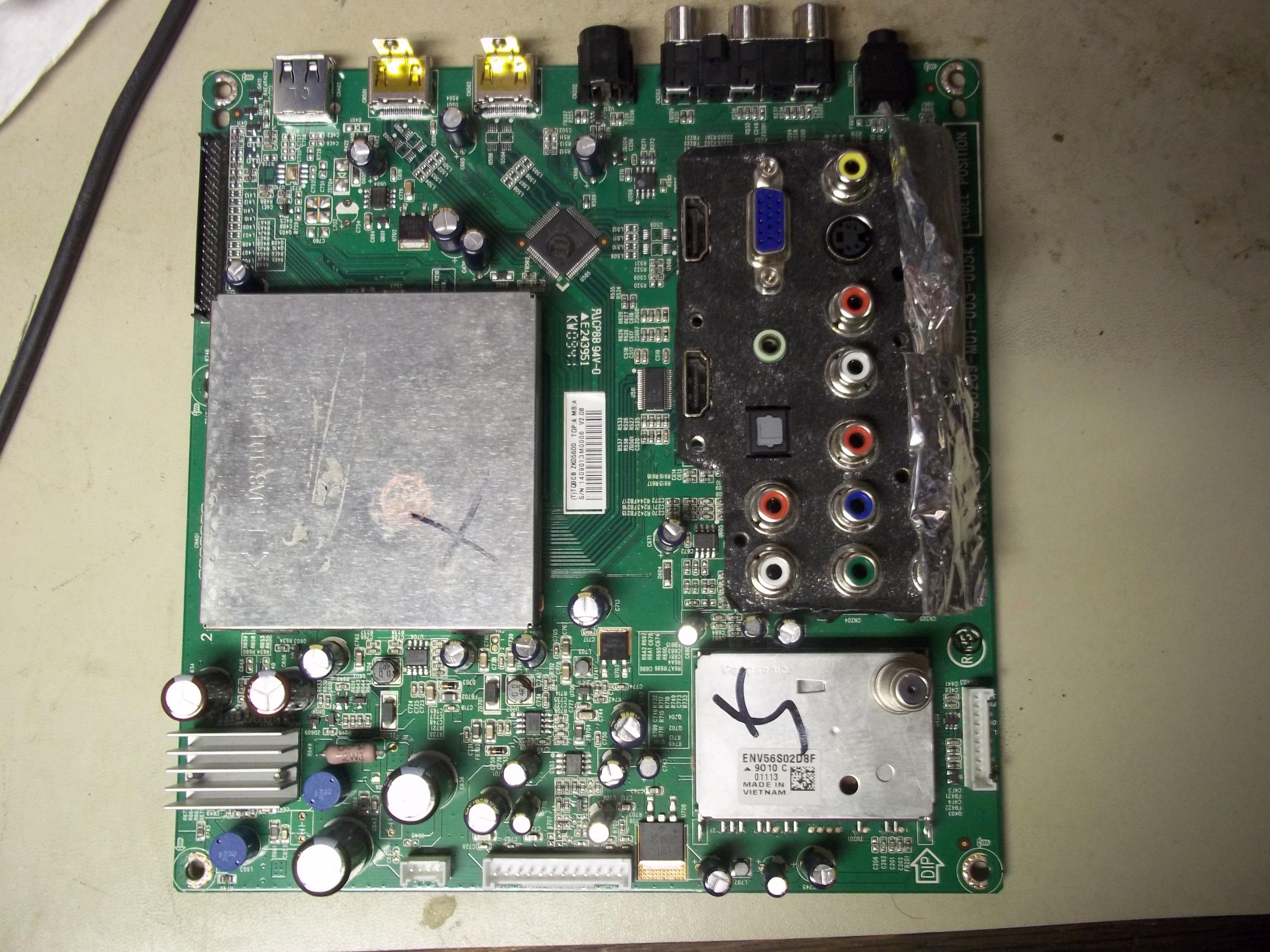

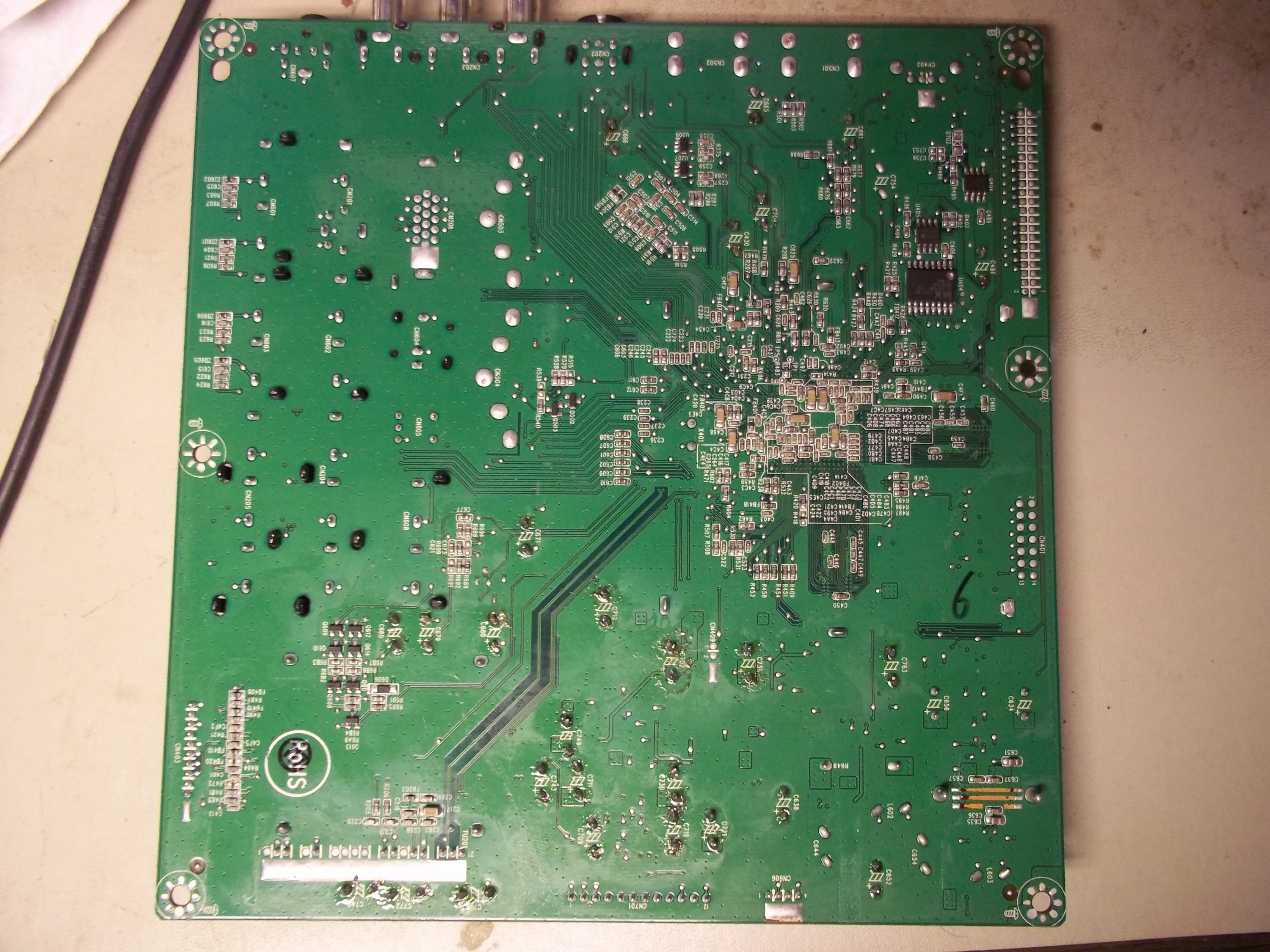

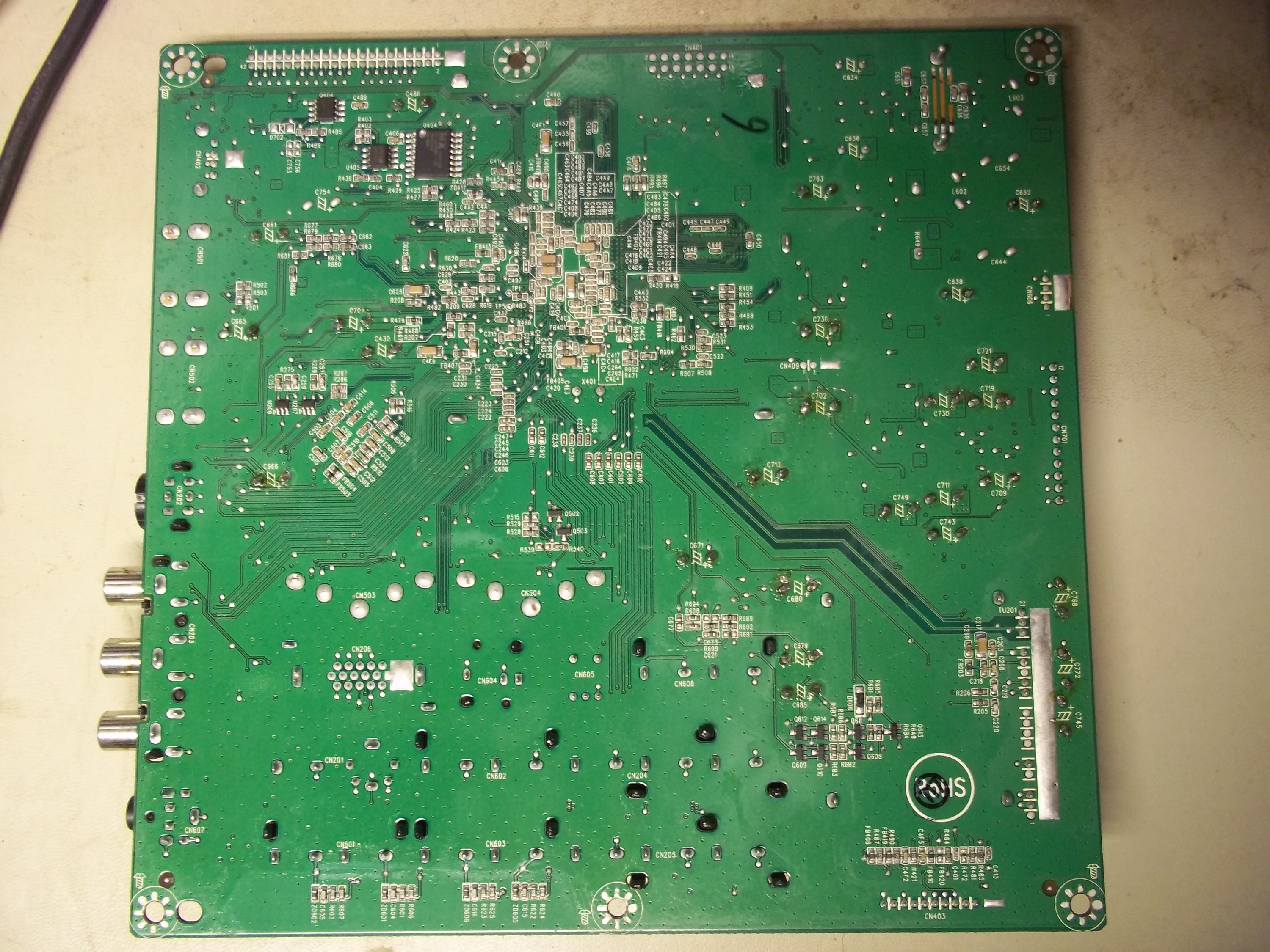

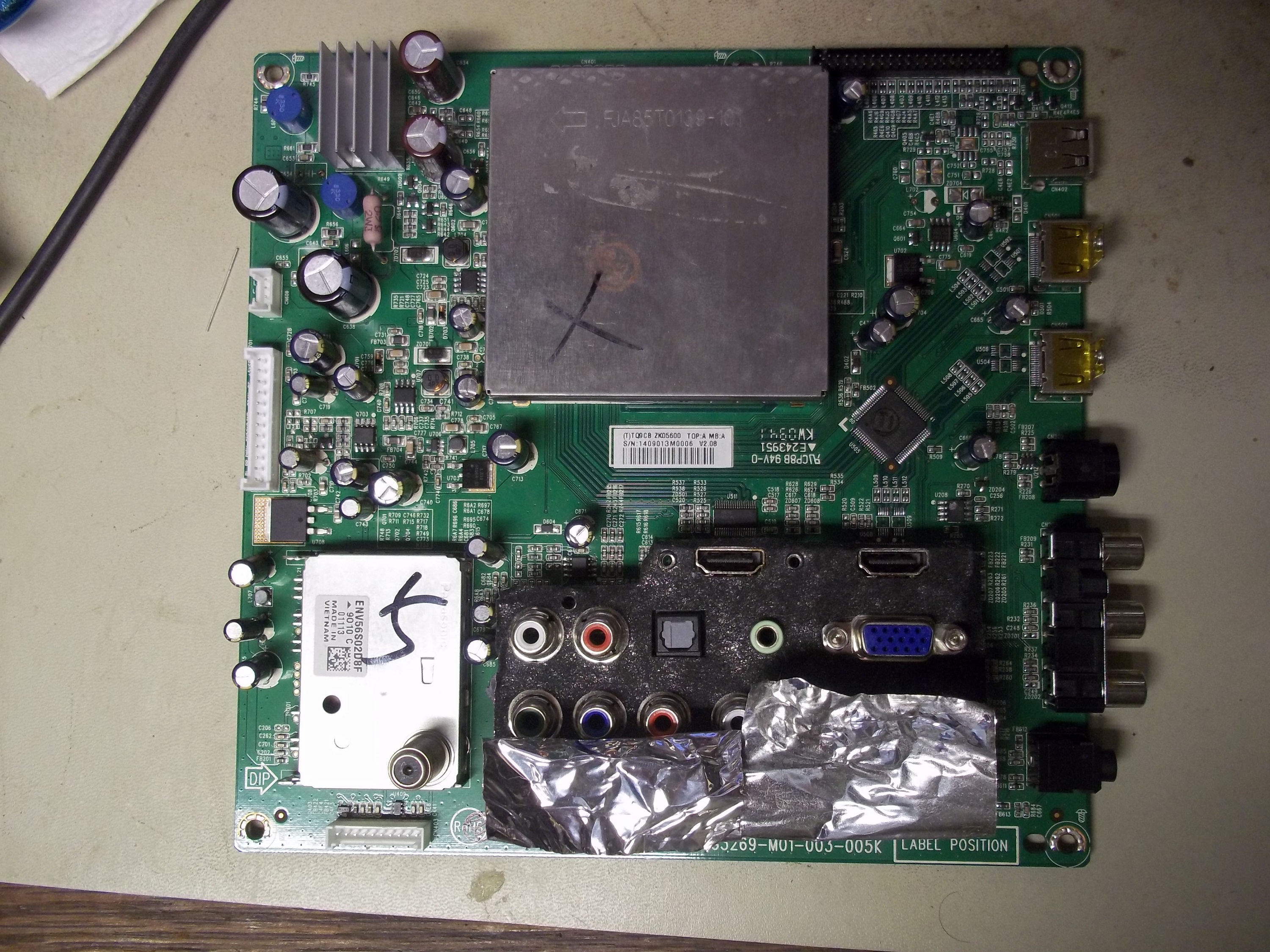

                        I know you included some pictures on page 1, but to have someone help you trace stuff through the board, you will need many high-resolution pictures of the entire board, front and back. In the key areas near the plug, even the smallest traces will have to be visible.
                        Is this good enough? Otherwise I will have to contact one of my friends and use their nikon.
                          master hoarder
                          • May 2008
                          • 12170
                          • Bulgaria
                          #32
                          Re: CAP ID and what to replace?
                          Yes, these are pretty good. Sorry for the no reply. Was sick for the past week and a half and didn't log-in BCN before that.
                          Anyways, I'll probably look at it in more detail next week since I have a big project this week and not much time to complete it.
                          In the mean time, check all of the diodes and zener diodes near the connector (like ZD701, ZD702, D701, and D703). Ceramic cap C767 looks a bit dark. Maybe it's the light, IDK, but check for short circuit.
                          There's also a transistor that looks slightly darker, but again, I'm not sure if it's the lighting that's causing this. Cant see a designator for it, but it's right next to one of those small electrolytic caps C709 by the connector. The "transistor" I'm referring to is in a SOT-23 package.
