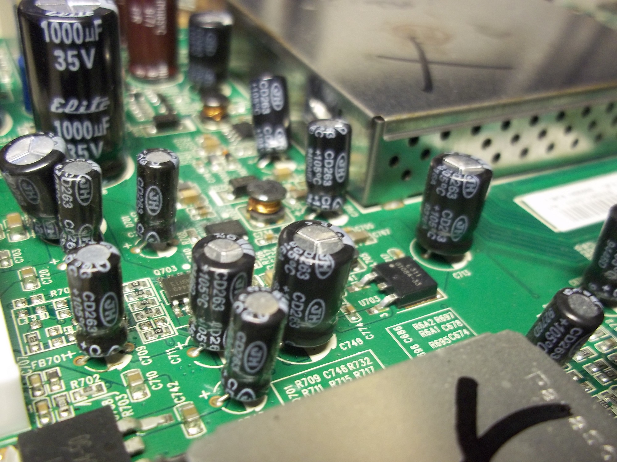

    I got a bunch of these caps labelled JH cd263, I also got two elites, EJ.
    datasheet? what to replace with?

    As "JH" is a brand of Jianghai, the datasheet should be the following:
    They are pretty standard 105 °C capacitors.
    You can find the matching Elite datasheet here:

        Are Jianghai any good?
        • nnname
          • Jul 2010
          • 20
          Re: CAP ID and what to replace?
          @ Mad_Professor:
          They're okay if not running too hot, but not qualitative enough to recommend them as replacement capacitors. Furthermore, the CD263 series has a load life of only 1000 hours for cap diameters of <= 8 mm.

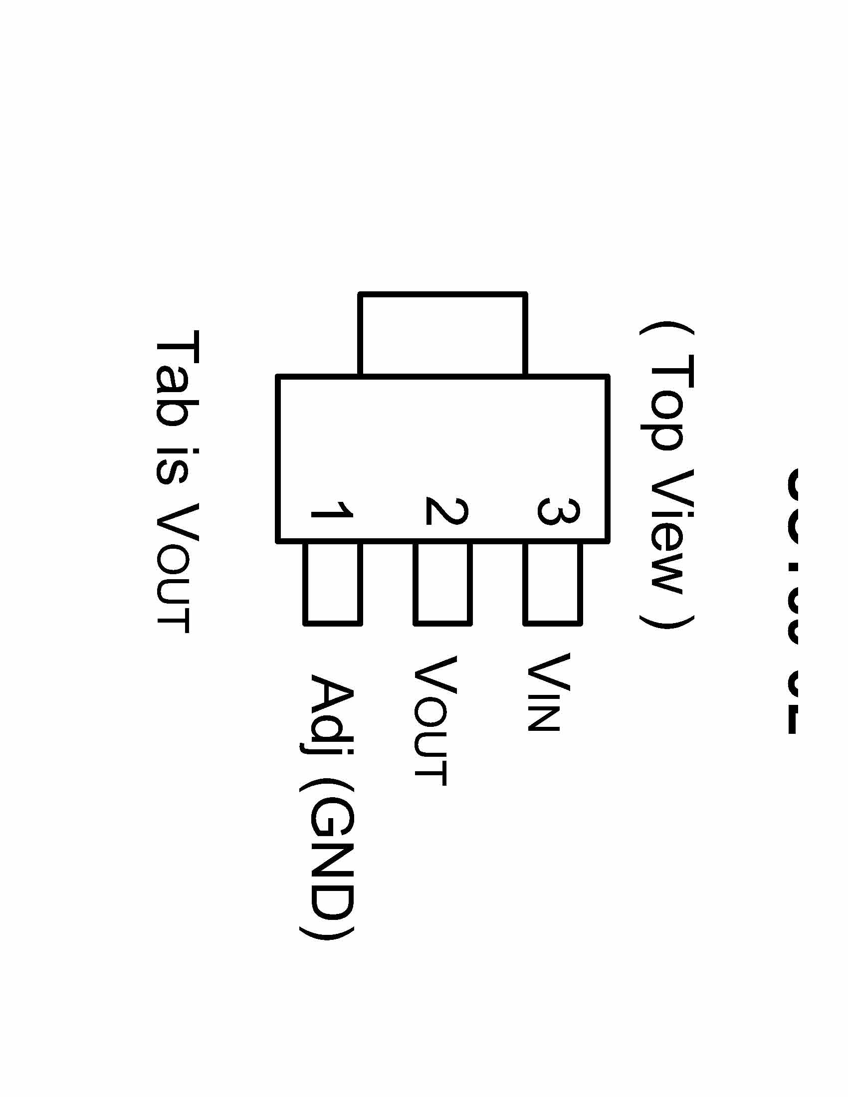

            Well if they are ok, I decided to look for the voltage regulator. I had my meter on 3.3v pin and accidentally ran my other probe across the shielding of the tuner, and it beeped at me. I thought that was funny so I went to the main connector put black probe on gnd and my red probe on the two 3.3v and they both are shorted, how can VR be ground too, it help me trace it back to L311 G1084-33, but it doesn't appeared shorted, so it must be a decoupling cap near by right?
            What's even more funny it's on pin 1 which is ground to begin with. Looks like C702 appears to be shorted, it's JH 220uf 10v, but I can't tell if it's intentional, I will have to remove and test again.
            I hope this is the correct datasheet
            https://cdn.badcaps-static.com/pdfs/...4ed2bf5adf.pdf

                    But that's still with it in circuit. but the datasheet shows pin 1 to be the V-IN and pin 3 V-OUT. Pin 2 is not even connected, so it must be using it's back plate for a ground, I assume.
                    That doesn't make any sense, since pin 1 goes to the two pins in the connector marked as 3.3, so unless I'm reading the connector wrong, or pwr is actually the voltage supplier, or I fucked up.

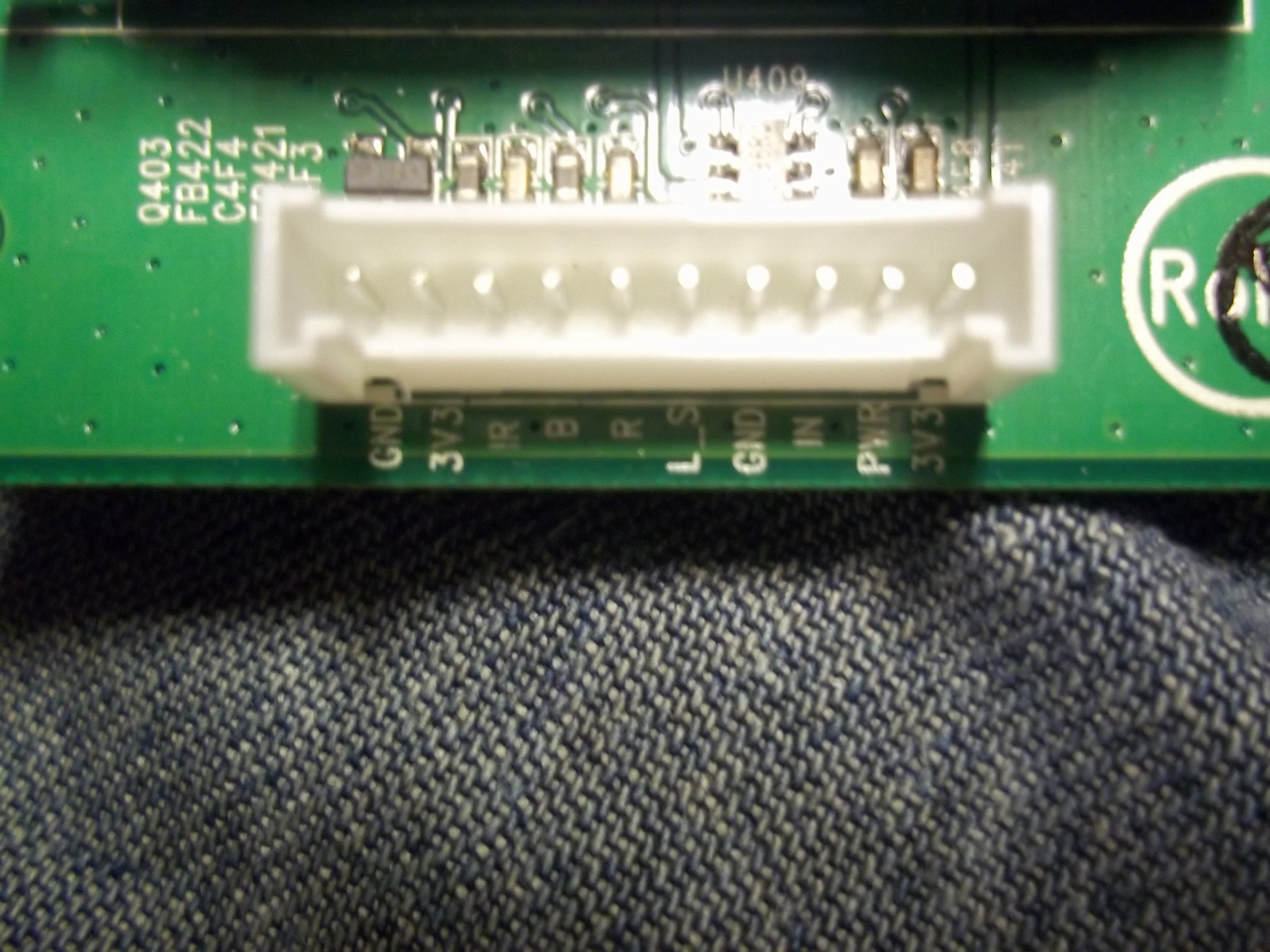

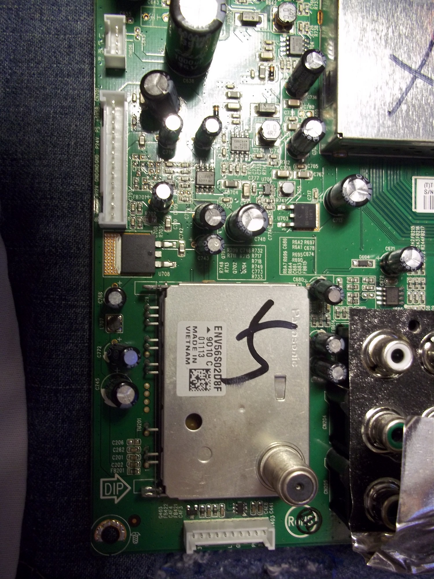

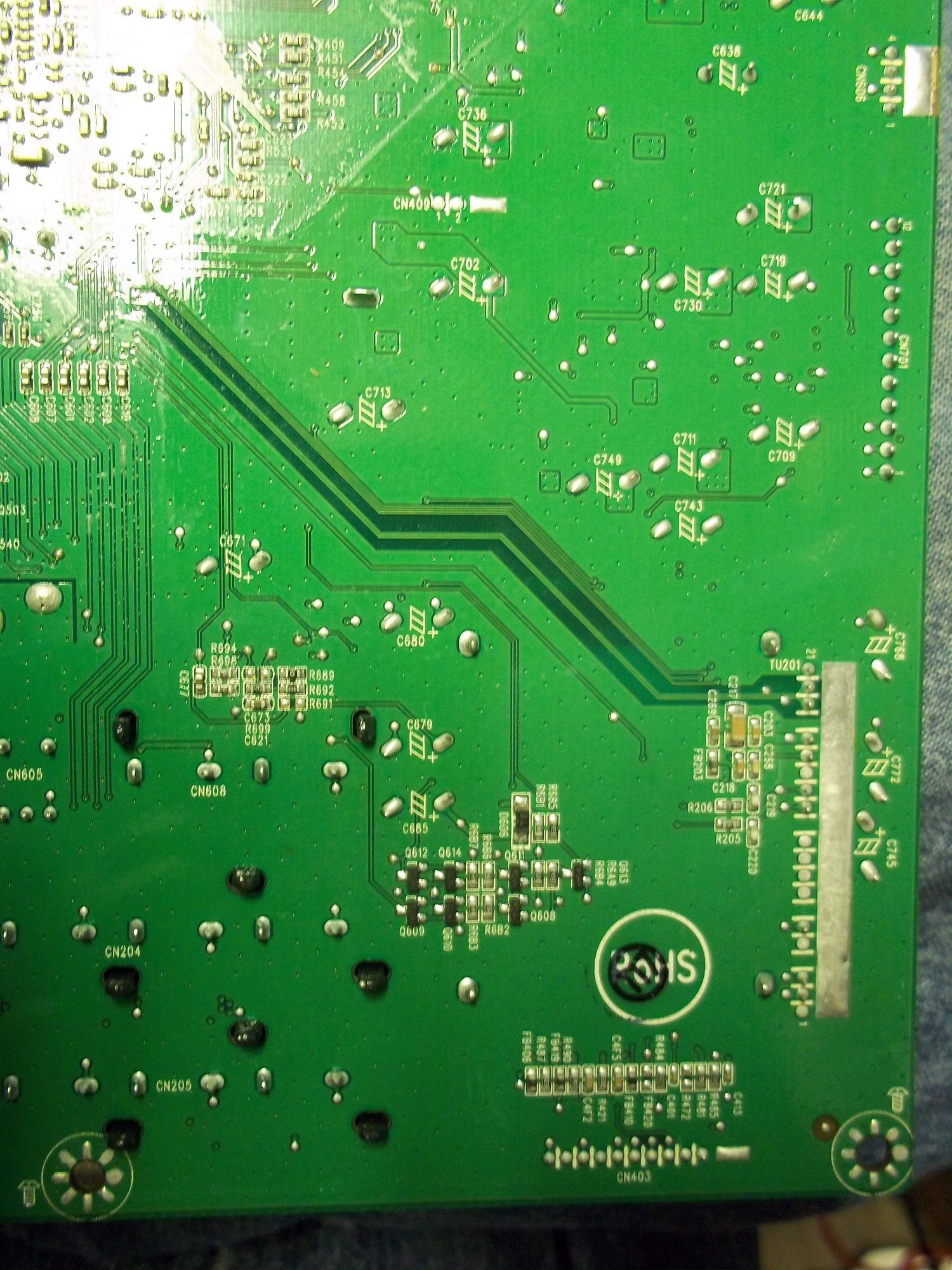

                    I got some more pictures below.
                    and yes I'm making sure I have my probes on 3.3 pins and not the GROUND PINS!
                    circle in red is c702

                              I am talking about the Big tap (Output pin) of the U703 and Ground reading. You can also see MLC cap C717 ocnnected to the big tab and ground.
                              Pin 1 of U703 is the ground pin since this is a fixed out put regulator IC.

                                  No, pin 2 (big tab or center pin, they are tied together inside the IC)
                                  When you look at the regulator, with big tab up;
                                  Left pin is pin1 (Adj/ or Ground), pin 2 is the output pin (middle pin or the big tab: tab and middle pins are tied together internally), pin 3 the right pin is an Input pin.
                                  We are looking to see if you have really low resistance between the Big tab and the circuit ground (chassis).
