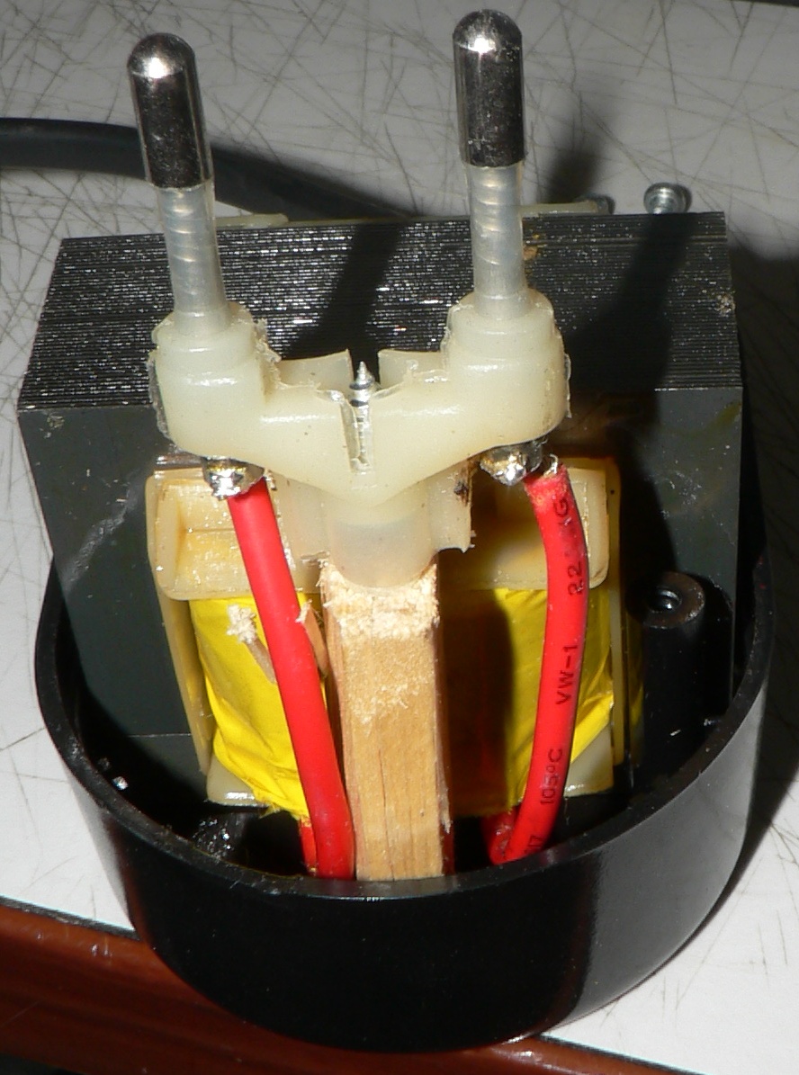

    Got this PFC thingy from CCFL Ikea lamp with the plug pushed inside. Obviously somebody tried to fix that with this
    Well, the thing is, it is only a huge coil, output is still 230 V. Does the lamp even need it? My guess is not

    It appeares to actually be a 1:1 transformer. Well, does the lamp even need such a thing? Yeah, it has some high starting currents, but as long as the CCFL is only 11 W I don't think it would be so drastic to pull breakers or something. On the other hand, efficiency of these huge low-frequency transformers is low as we now so it is wasting power all the time the lamp is on. Not mentioning the space
    ADD// OK, practical test shows the spikes are enormous One burned CCFL and one pulled breaker. OK, will attach cable to that transofmer and be done

      Is it ISOLATION transformer? May be they worry about safety.

        Re: Professional repaired PFC
        Seems that kind of. As long as startup currents for CCFL are so high, the transformer prevents that. Thats also the reason these lamps always blink several times before they start: the spikes reduce voltage on secondary. But after couple of tries the electrodes stay warm enough for it to start.
          If the lamp blinks a couple times, then it sounds like they are using old design with ballast transformer with a starter circuits in stead of electronics driven to light the lamps.
          What does the rest of the lamp assembly look like?
            It is G23 so ofc there is no high-frequency starter (no room in the CCFL). From disasembly of the destroyed CCFL I learned there are two components, one which looks like a piece of coil and second most likely starter. Both actually fused in glass, most likely as an insulation.
              that is a simple choke ballast.without it as you found poof! goes your lamp.
                That is an old style starter/ballast setup.
