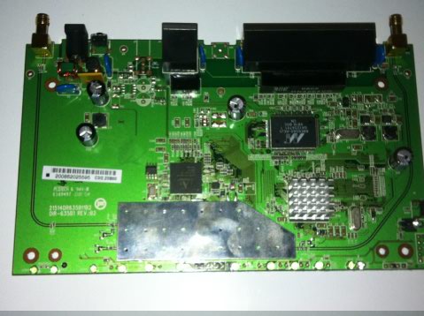

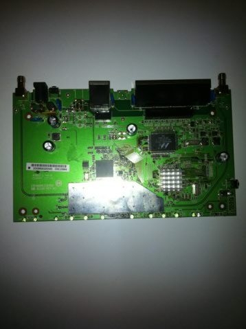

    The other day a friend bought me some stuff in the stuff was a nice D-Link router.
    Plugged it in with correct power supply and flicked the switch on the side.
    No go.
    Tested the power supply that puts out the right volts.
    Tested power supply plugged into the device that stayed at 0.2 the whole time.
    Now I'm Unsure what to do next.
    None of the IC's look fried or discolored.
    written on the board.
    PLOTECH 6 94V-0
    E169497
    21514DR635B11B2
    DIR 635B1 REV :B2

                Could be a bad joint on the connector if it buzzes? Pictures will need to be a
                great deal better if you want people to suggest what to test next.

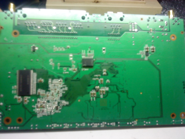

                      Re: D-Link DIR615

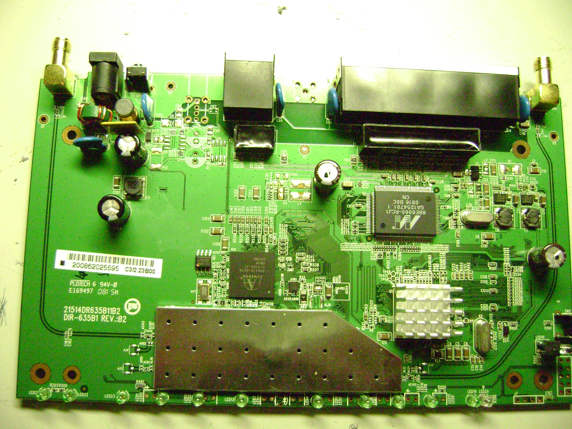

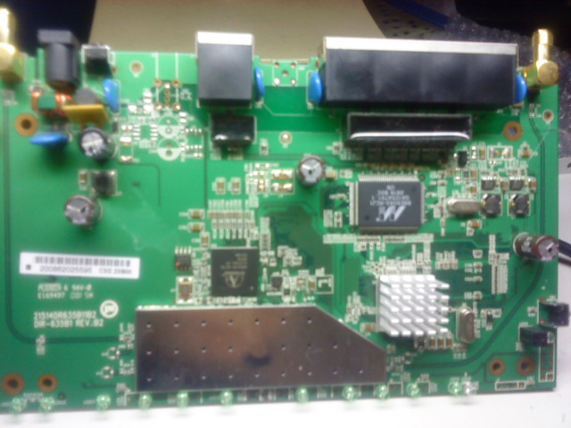

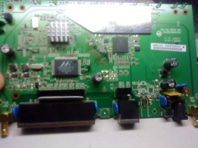

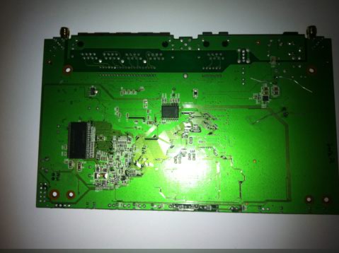

                      some more photos.
                      I have notice that the buzz will take awhile to come on.
                      when you switch off from the power point it sounds like a motor slowing down you hear a tick tick tick.
                      not sure about these photos I think they got down sized when they were sent to me via mms.
                      also i replaced the caps closest to the power supply.

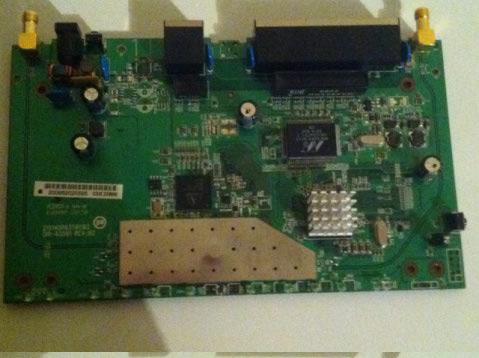

                        pics useless for troubleshooting
                        • Amraks
                          • Nov 2011
                          • 725
                          Re: D-Link DIR615
                          agree...
                          got a lend of my old mans camera I must invest in one myself.
                          here you go hope this helps

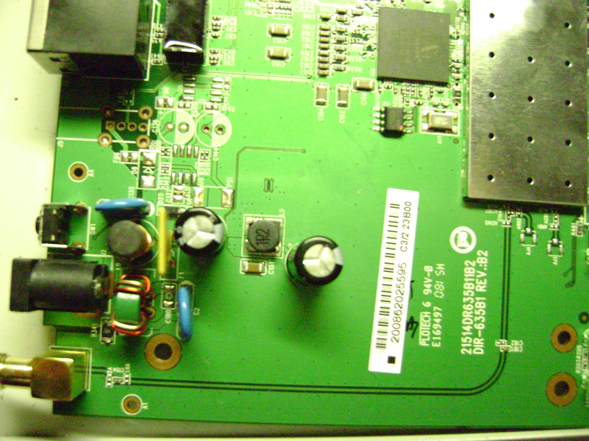

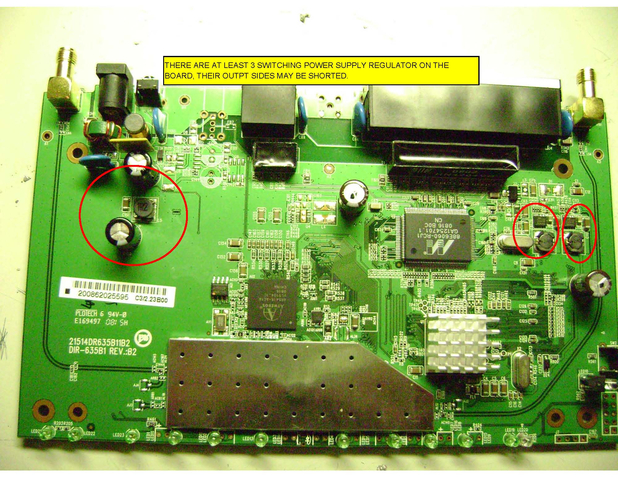

                            with the psu connected, look if those two small square chips in the upper right corner are hot, or look burned.
                            • Amraks
                              • Nov 2011
                              • 725
                              Re: D-Link DIR615
                              do you mean 105 & 112 or the smd inductors below it?
                                Re: D-Link DIR615
                                Well, nothing is going to get hot because the switching power supply will go into shutdown mode to protect itself from trying to feed current into shorted circuits. You still do not tell us the resistance reading at the DC input pin jack (no power supply attached to it) as shown in post 3 and 9.
                                There at least 3 switching regulator power supplies on the board.

                                  checked the jack with meter it says 0.00
                                    Re: D-Link DIR615
                                    There you go, now you just have to start isolating the loads and find out where the short/shorts is/are.
