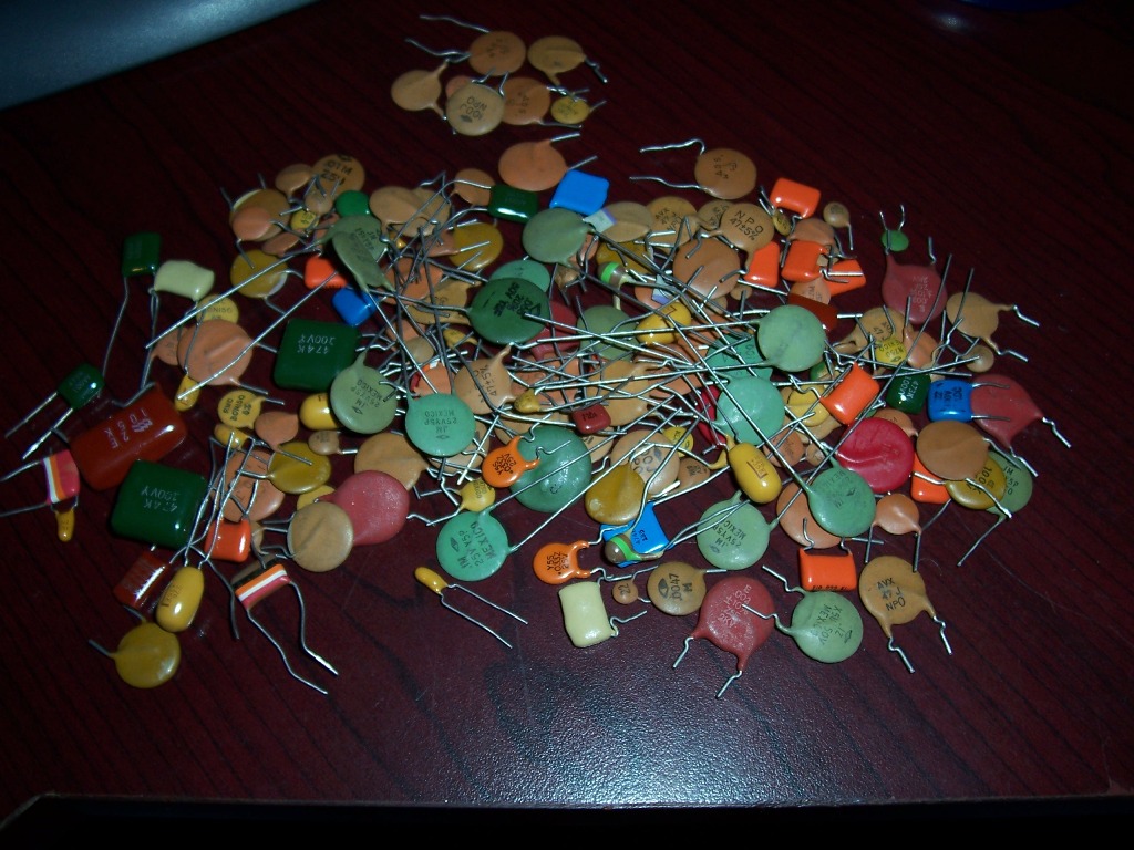

    i have a Bunch of these things which i originally thought were caps of some kind. but i recently blew up a thermistor and it looks just like these things. where i get confused is the units of measure printed on the side of these things, they all seem different i have K,n,V,J,u and some have strips like a resistor. I'm not sure what they all are or where to start cataloging these things or if i just throw them all away.
    K I'm guessing is Resistance?
    V volts?
    u micro farads?
    the J and the n have me most confused and J is on most all of them. any help would go a long way. i need a 2K ohm thermistor (QAD0012-202) and I'm wondering how to go about finding one in this pile.

    Those good sir are ceramic caps.
    http://en.wikipedia.org/wiki/Ceramic_capacitor
    The labeling defines capacitance, volts and series and sometimes have a manufacturing logo stamp somewhere.

      all of them are? even the ones with stripes on them? can i measure them with a fared meter and just look for 25v,100v, etc... and use them like i would when replaceing a regular cap?
      are you sure they aren't thermistors?

        Those bean sizes ones with a L on them could be tantalum capacitors.
          Re: what are these things?
          They sure are.
          Unlike cermic/mylar caps they ARE polarized... like 'lytics, the stripe marks the negative lead.

            some of them may be SCK's or thermistors hard to tell from the picture...

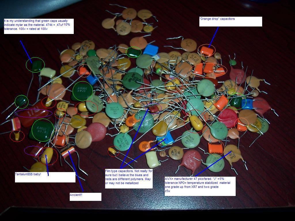

              The red rectangular ones are polyester film capacitors.
                Remember, the red L on the tantalum caps indicates polarity. Tantalums are right opposite of aluminum electrolytics... the L indicates "+". NEVER subject a tantalum capacitor to reverse voltage or overvoltage, they WILL explode violently!
                  I see a mix with mostly disc ceramic caps, some film caps (probably polyester), some solid tantalum caps (the tear drop shaped parts) and a very few probable monolythic ceramic caps. That white or light mint green part in the center front of the pic may be an R-C snubber. That large brown part at the left marked "105K" is a 1uF, +/-10 film cap.

                    can i test them with a esr meter? or a farred meter? to check if they are good?
                      Usually the preferred method is to use a DMM with capacitance capability to do the ceramic and foil caps, and use an ESR meter on the tantalums along with a DMM (provided the total capacitance is not over range... I think my DMM tops out at around 20uf).
