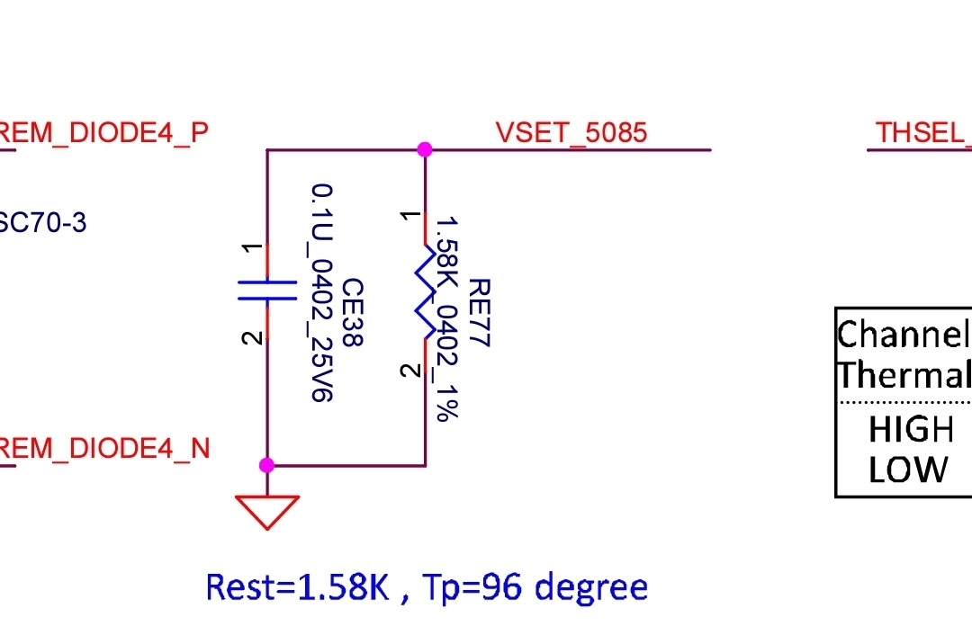

    Ambient thermistor out of range
    dell latitude 5570
    LA-C841P
    i am check ph601
    ph602
    ph603
    ph604
    ph605
    ph1302
    all is ok and flash bios
    and didn't fix
    Can someone please tell me where to find this sensor and how to correct the problem?

    From what i have heard a possible workaround could be to change the value of RE77 to a lot higher resistance, e.g. 10 KiloOhms.
    Try and report

        Thank you, my friend. The issue has indeed been resolved.
        ​Can you explain to me why we changed the value of the resistor?

          hello sir. i am also having this error and i have checked everything i could. also couldnt find anything relating to the issue im having.
          error : ambient thermistor out of range -128
          tried your mentioned method as well but the issue is still here.
          looking forward for some guidance.
          thanks
          board part number : la-c841p rev 3.0 (A02)
