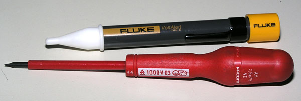

        Re: Hazardous-voltage primer
        Fluke 1AC-E Voltalert and 1000v insulated screwdriver

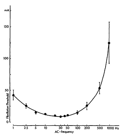

          As important as the voltage/current involved is the nature of the current:
          From Basic Res. Cardiol. 78, 604-616 (1983): graph showing fibrillation threshold in mA vs. frequency of sinusoidal AC:
          Note how the most lethal AC frequency is around 30Hz, although as you can see 50-60Hz isn't much safer. This experiment was carried out on isolated heart tissue - in "real life" the highest AC frequencies are even less likely to cause VF due to their reduced degree of penetration into the body.
          PS. If any of you are interested, let me know and I can forward you the "full text" of the experiment.
